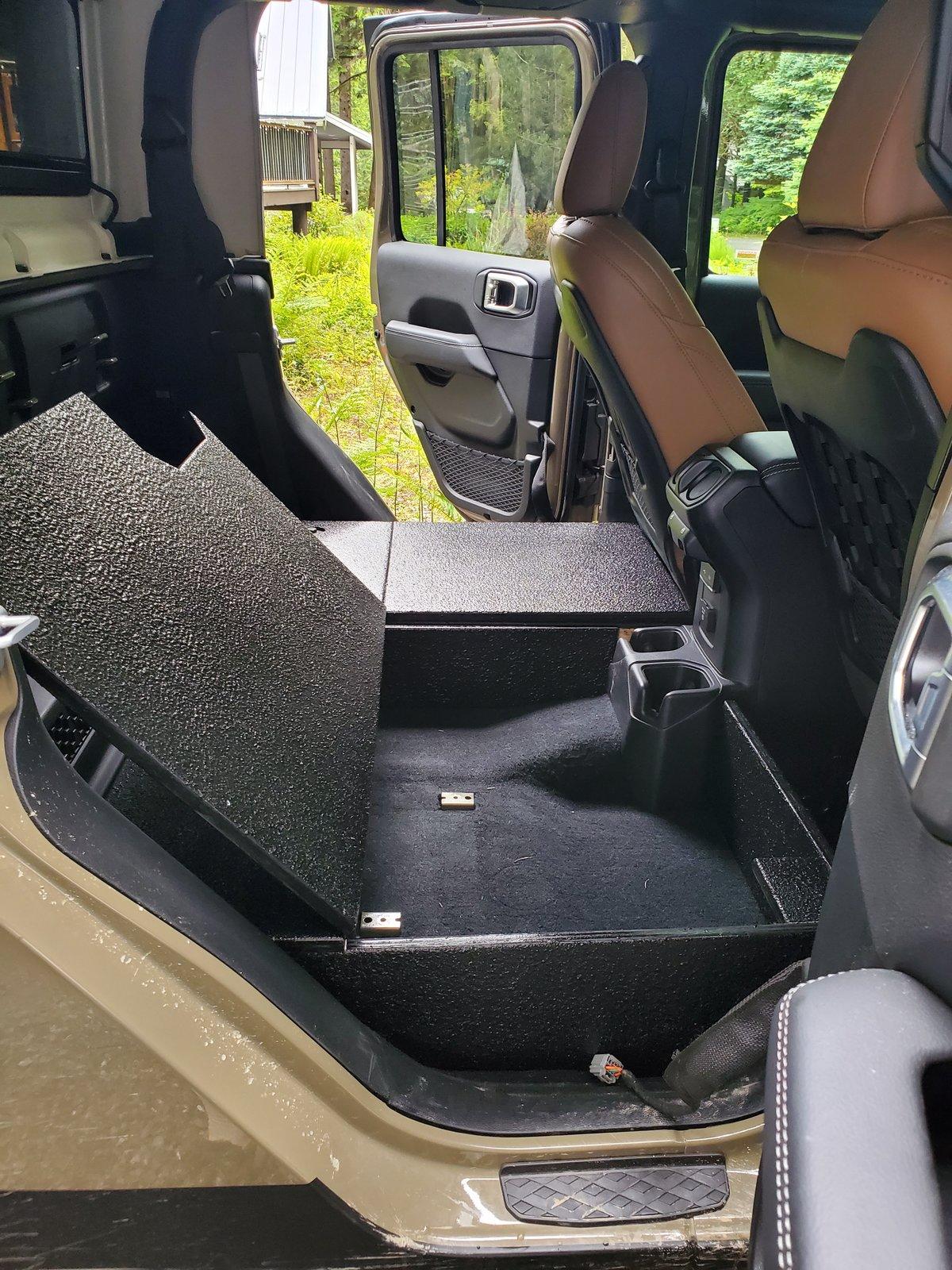

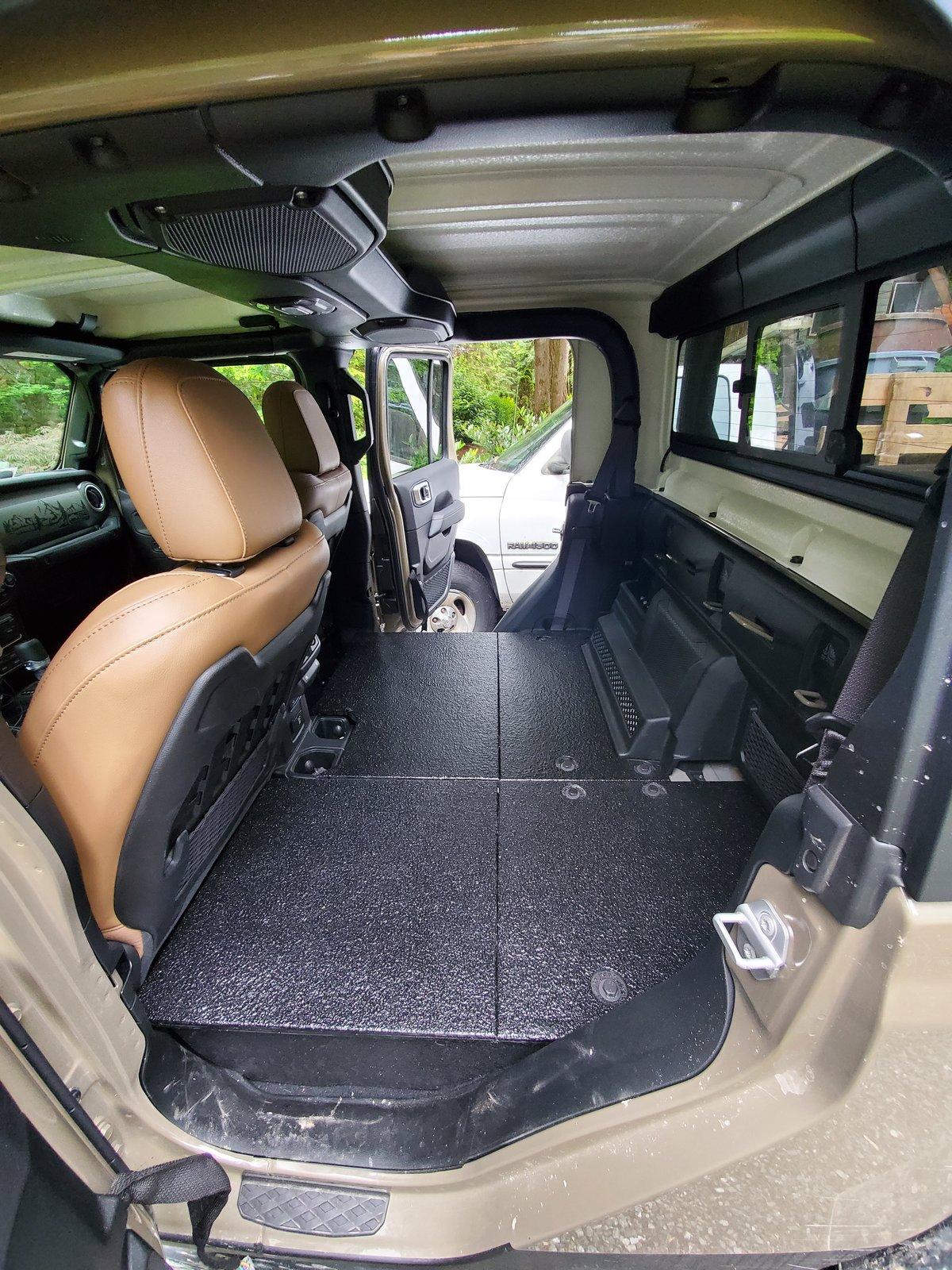

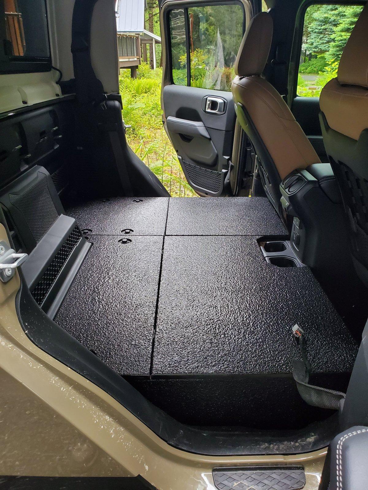

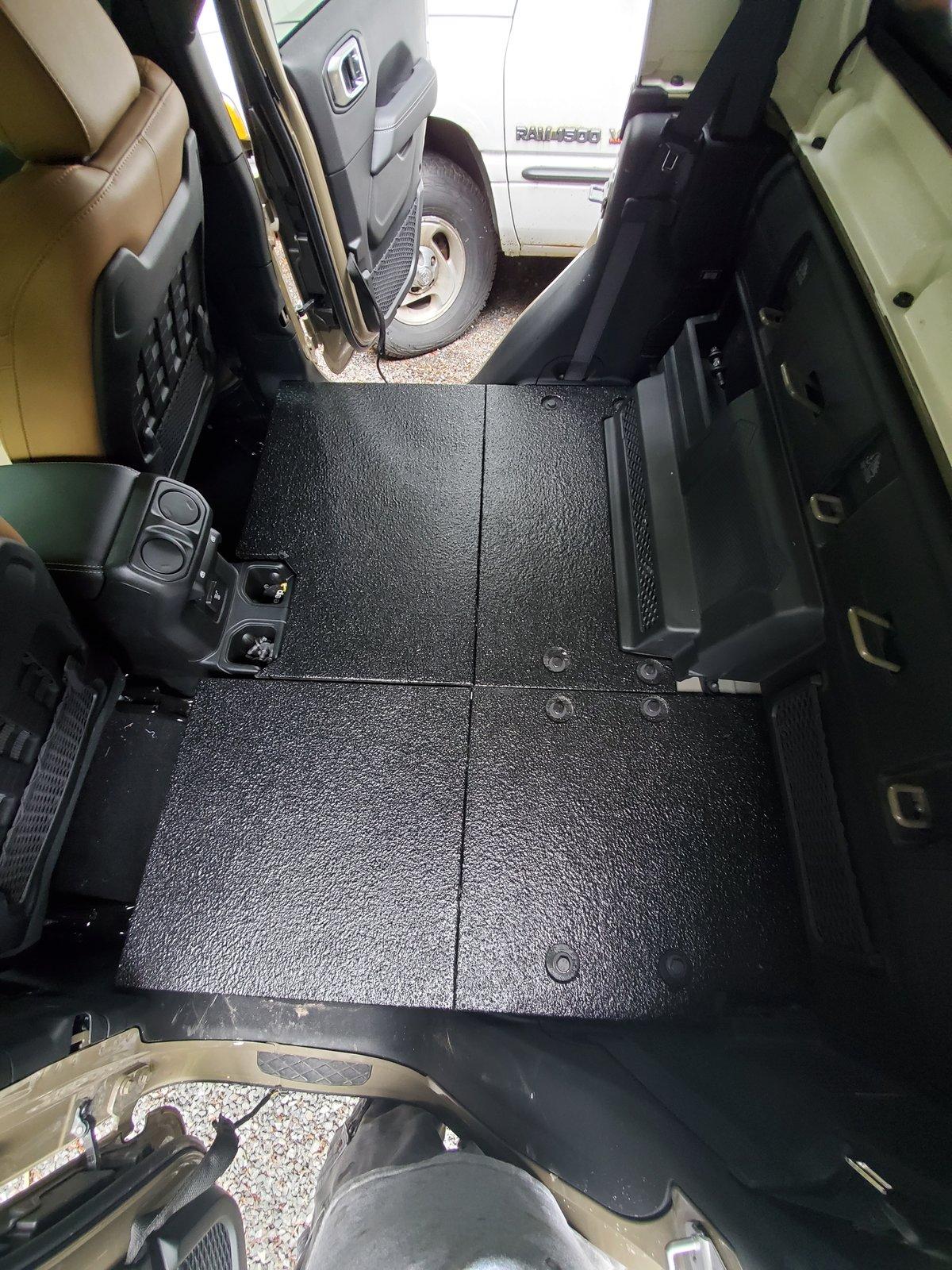

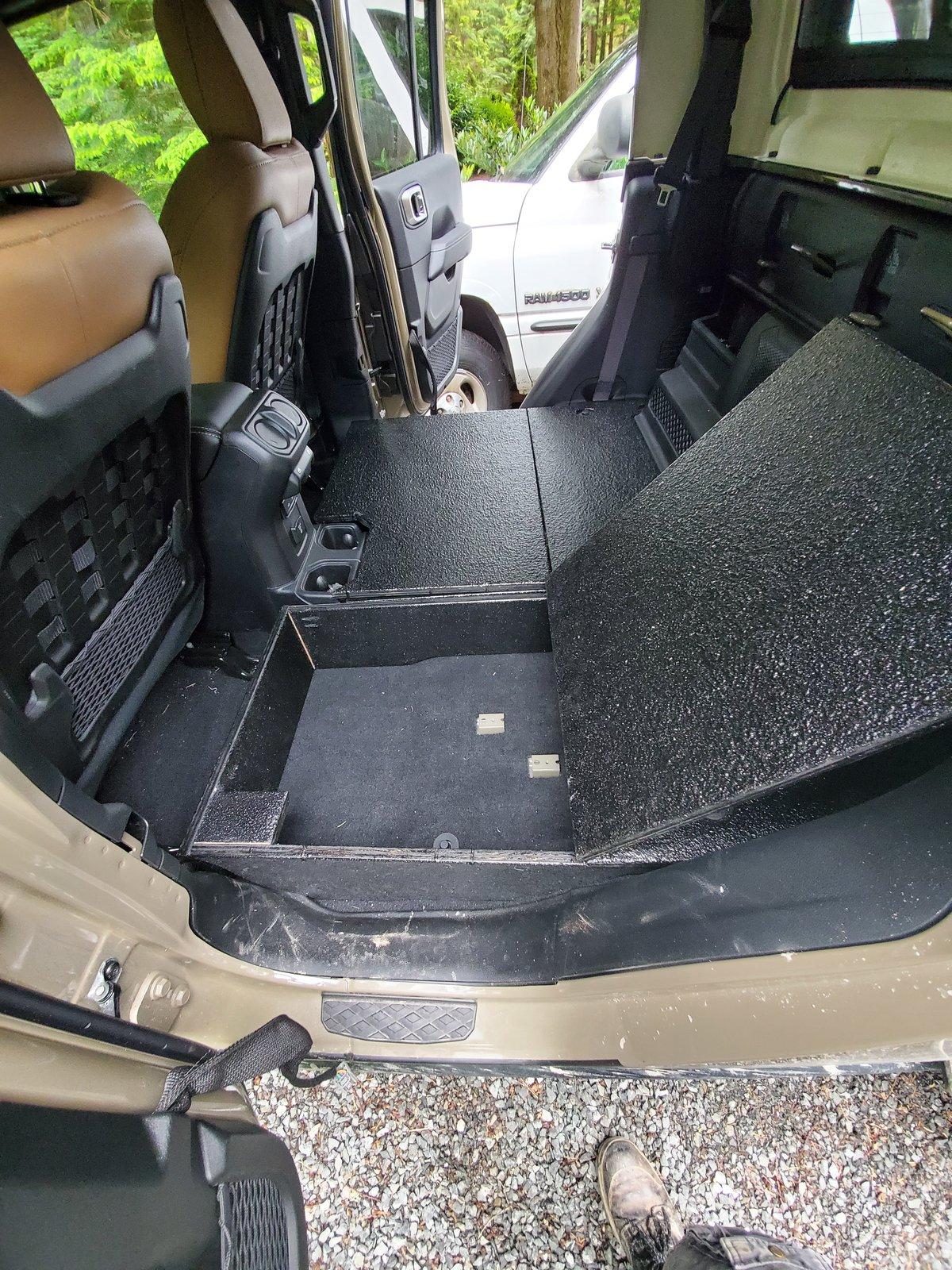

seat delete platform is done! Concealed SOSS hinges lift the platform to gain access to the space below. Also removed the plastic storage bin onbthe back drivers wall for an additional 6" of platform space. Covered the whole thing with paint on bed liner. I will eventually add a keyed lock to one of the lift up lids.
I couldn't justify spending the money on GG seat delete. I feel these turned out just as good if not better than the GG ones.

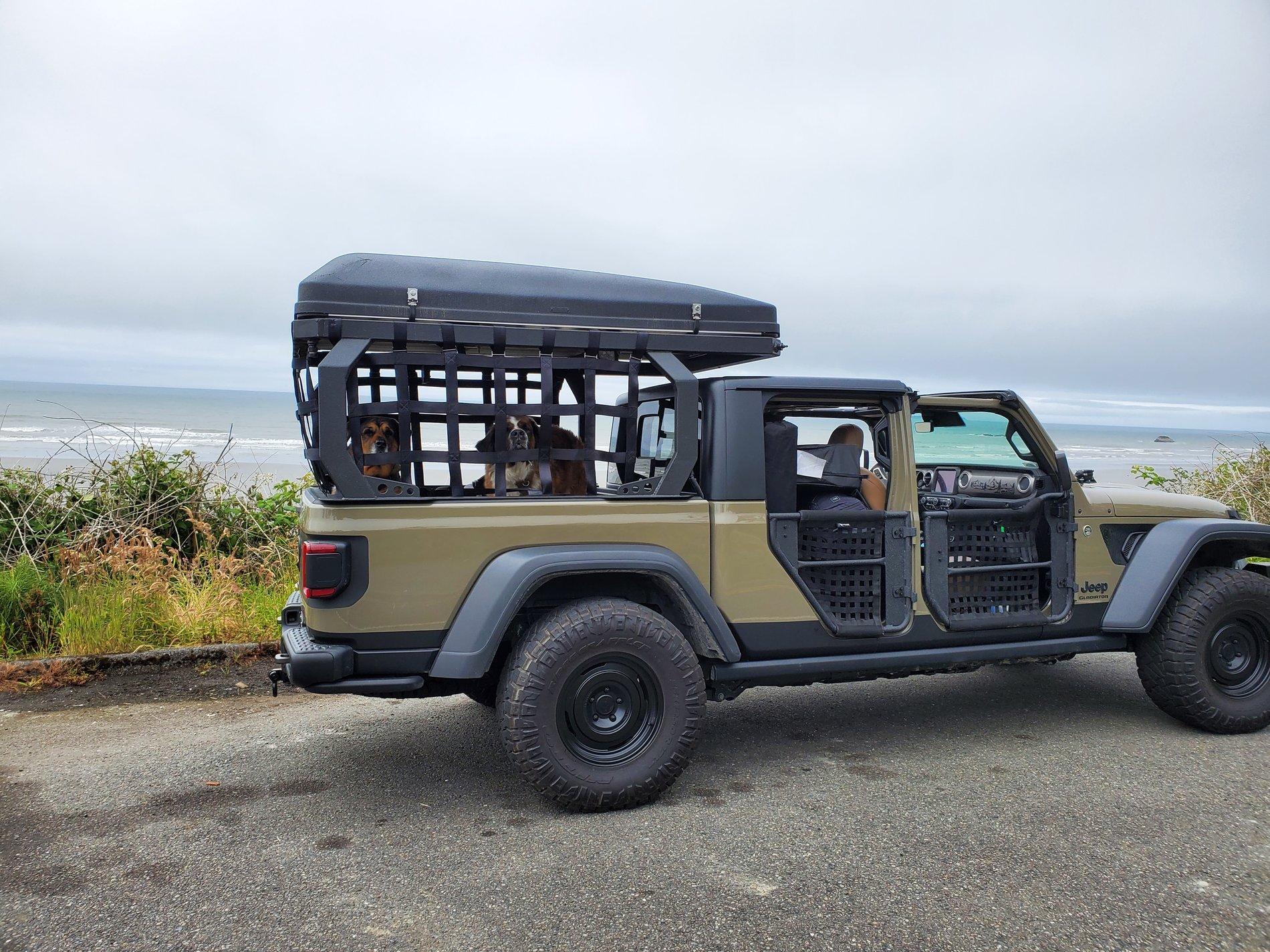

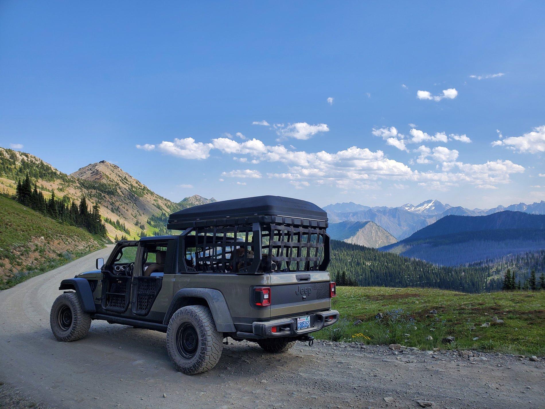

Added a cargo net surround to my bed to house my 2 big dogs during overlanding trips.
Purchased some large cargo nets and cut each to fit between my rack. Looks good with the tube doors. Dogs are happy and it keeps them safe.

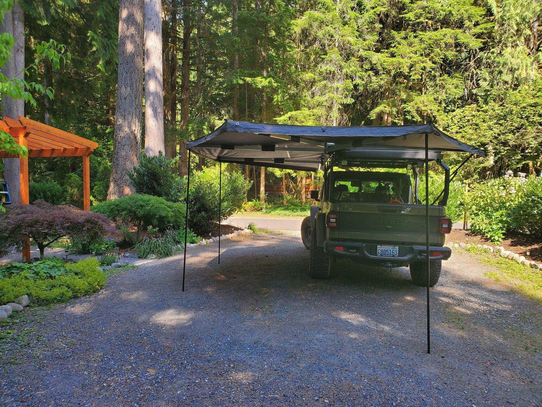

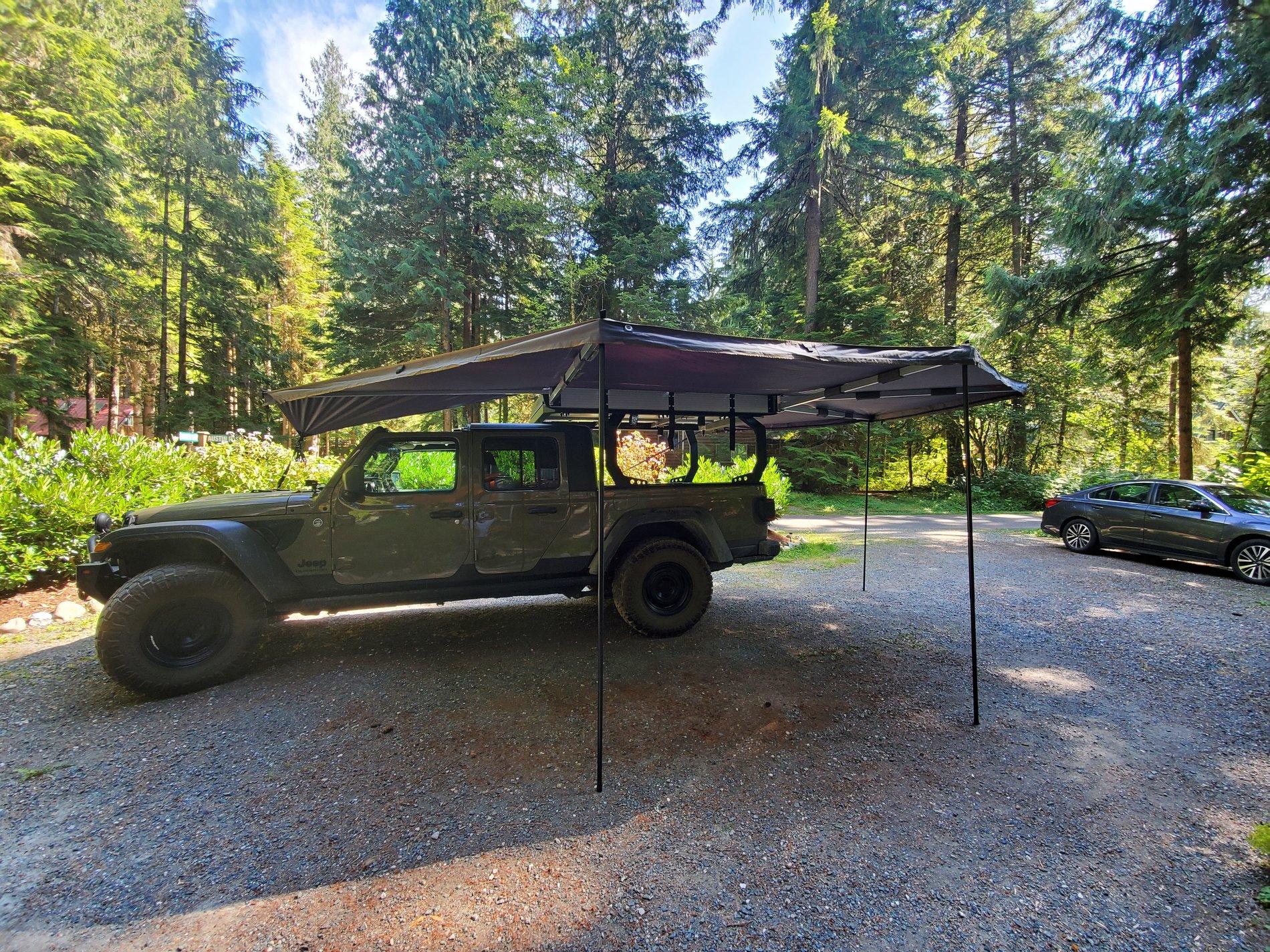

Completed my last major addition to my set up.. the OVS 270 degree awning.
From here on out my pocket book will be much happier. All mods from this point forward will just be small tweaks to my full overlanding set up.
Still plan to come up with a custom soft top set up to include a tonneau over the back seat area and a Windjammer. This will probably be accomplished over the fall & winter.
