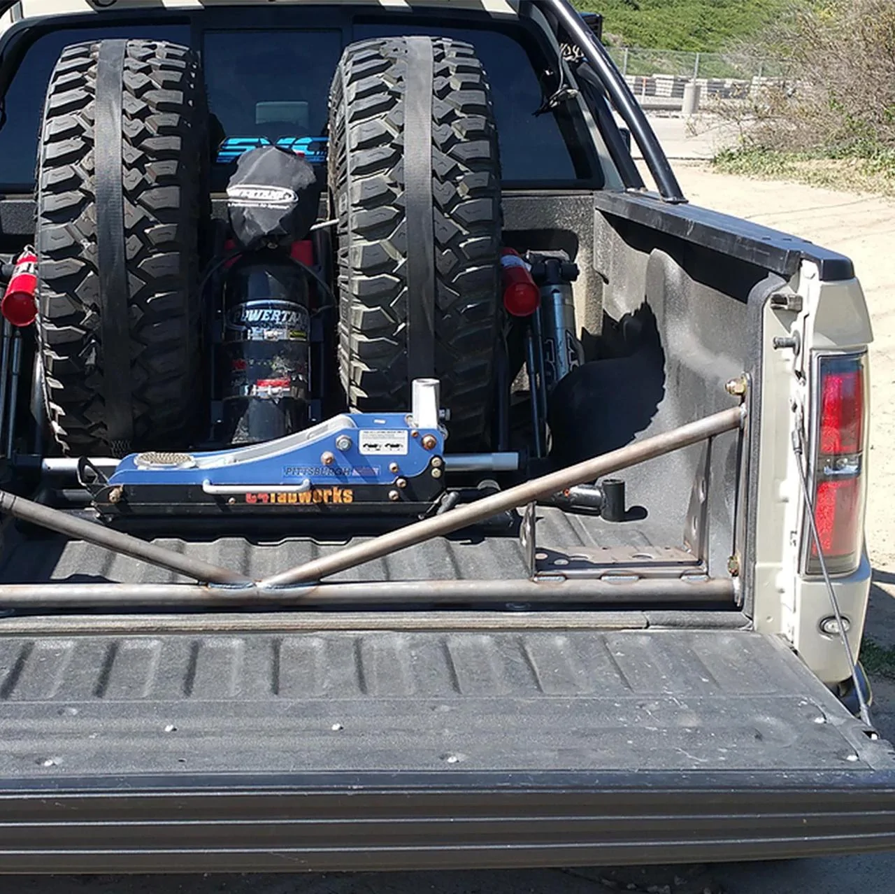

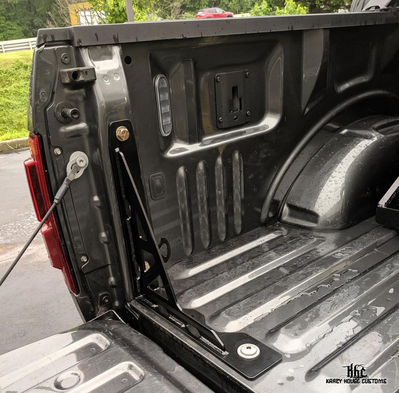

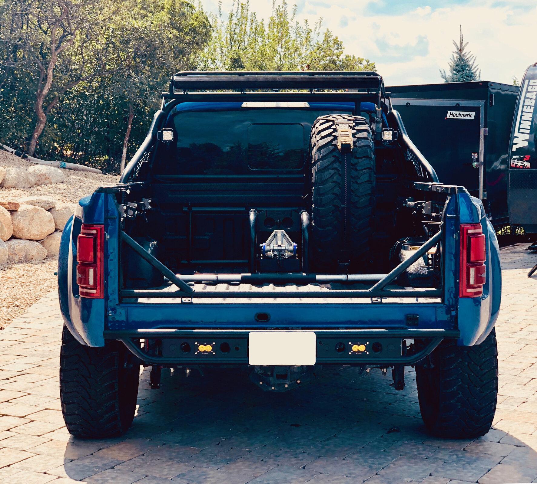

Friends, I was talking with my brother-in-law, who owns an F-150 Raptor, the other day, and he was mentioning that a bunch of the Raptor and Tacoma guys run a bed support brace (see photo). Apparently a three-point brace at the back of the bed is desired because higher speed offroading causes flexing issues with the bed sides and floor. A Google search doesn't turn up anything specific for the Gladiator, so I'm wondering if this is something we should be using. I figure since most Jeeps are used for crawling or maybe because the Gladiator is only a few years old we haven't had these issues yet, but the Mojave is set up as a desert runner so I cannot imagine why this issue wouldn't come up.

I didn't know about the Raptor, but yes, the Taco has them because the bed is a composite bed and because of this, inherently flexy. I'm sure that to some extent all beds flex, but it's not a worry on my part.

The gladiator has a steel bed. The Tacoma is composite and the Ford is aluminum, which is why these are desired. This is not needed for our Jeeps

Unless you are blasting through whoops at 100mph I really don’t think you’ll have an issue. Most of the dudes that run those have fiberglass bedsides for tire clearance and no tailgate so they need a little something extra to hold it together.
