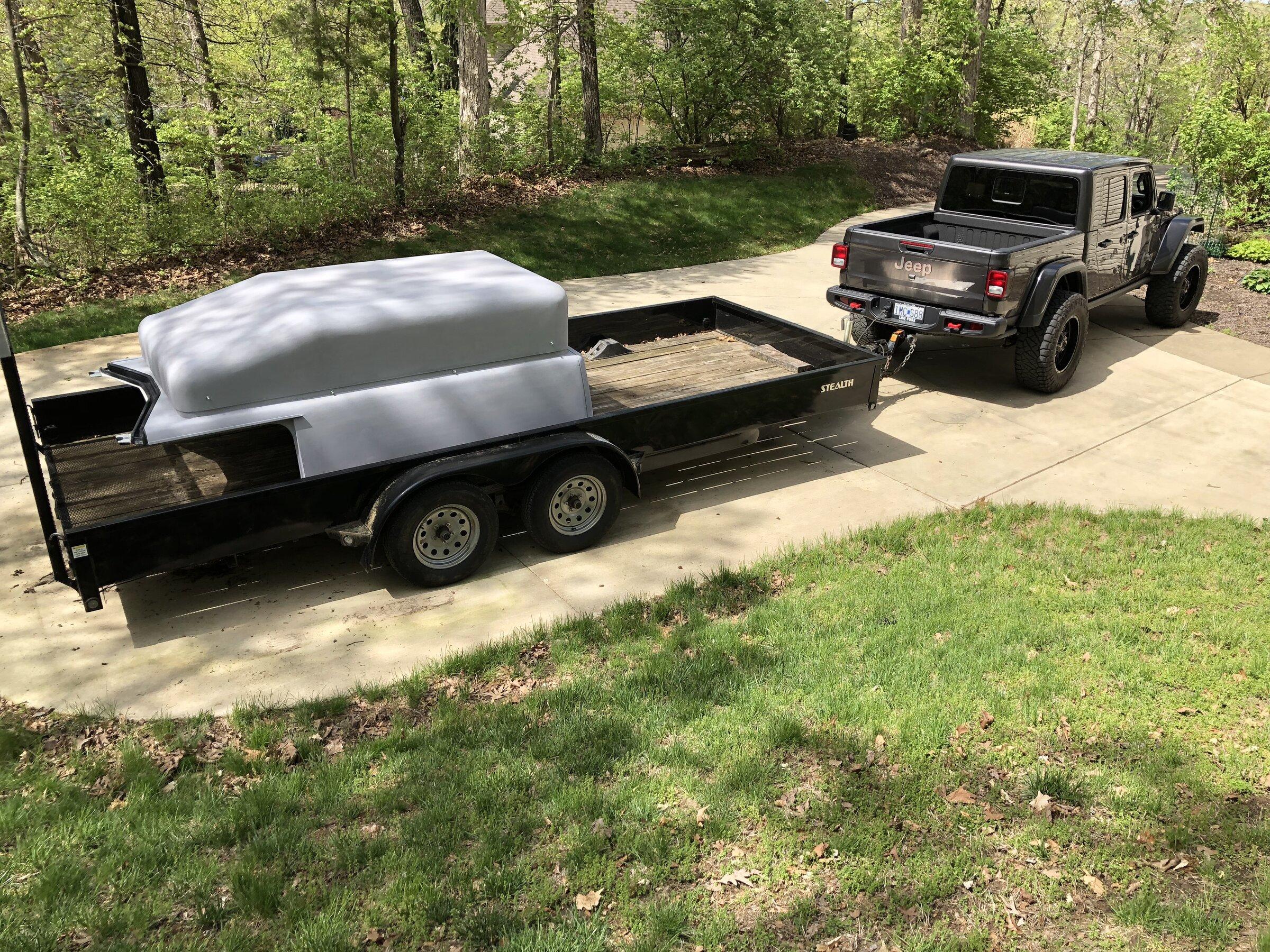

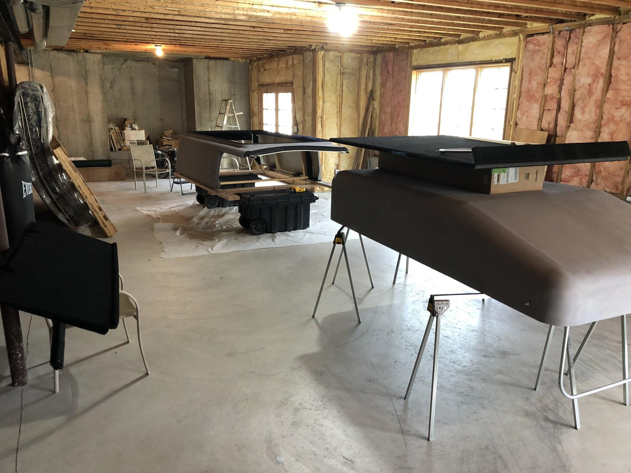

It was nice building this in my basement over the winter, but now it's time to break it down and get it out of the basement. Next up painting.

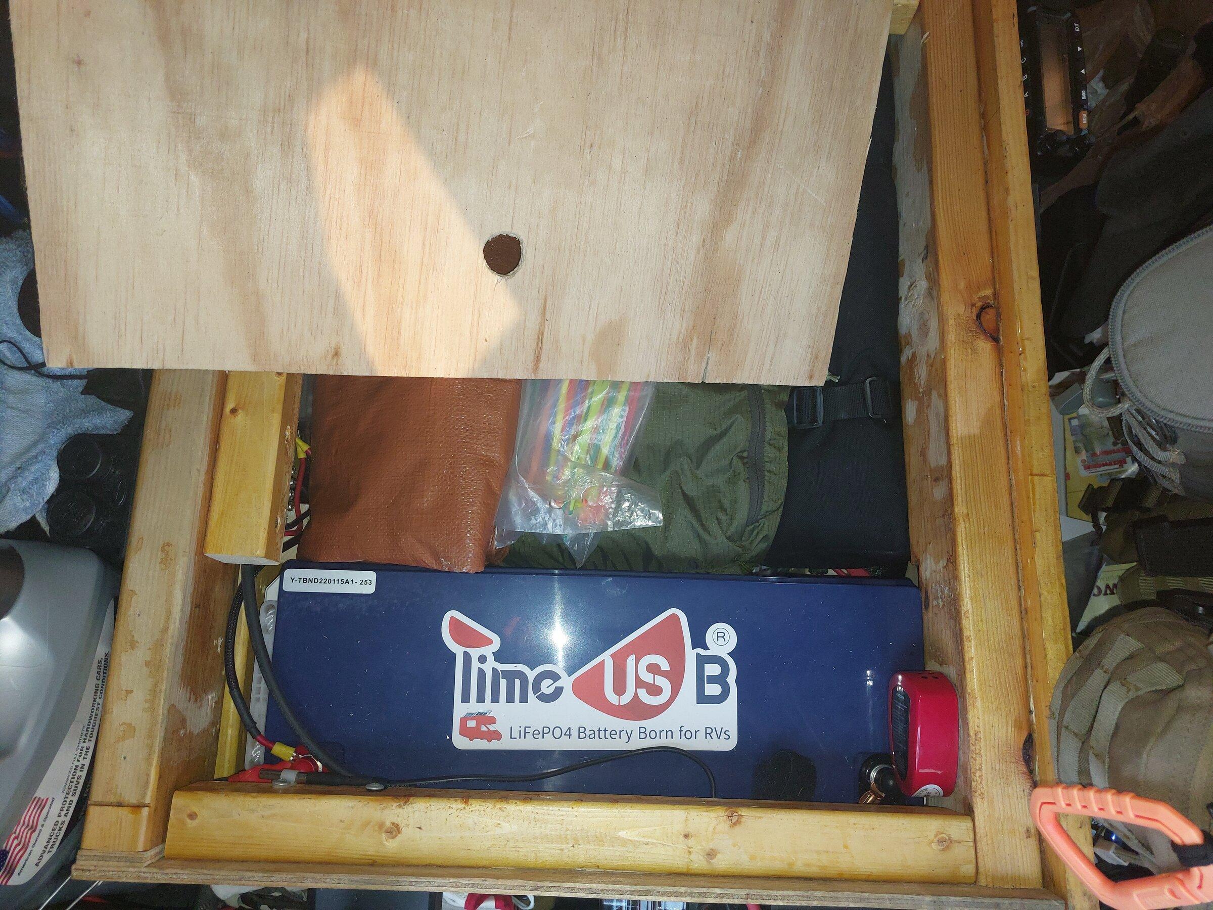

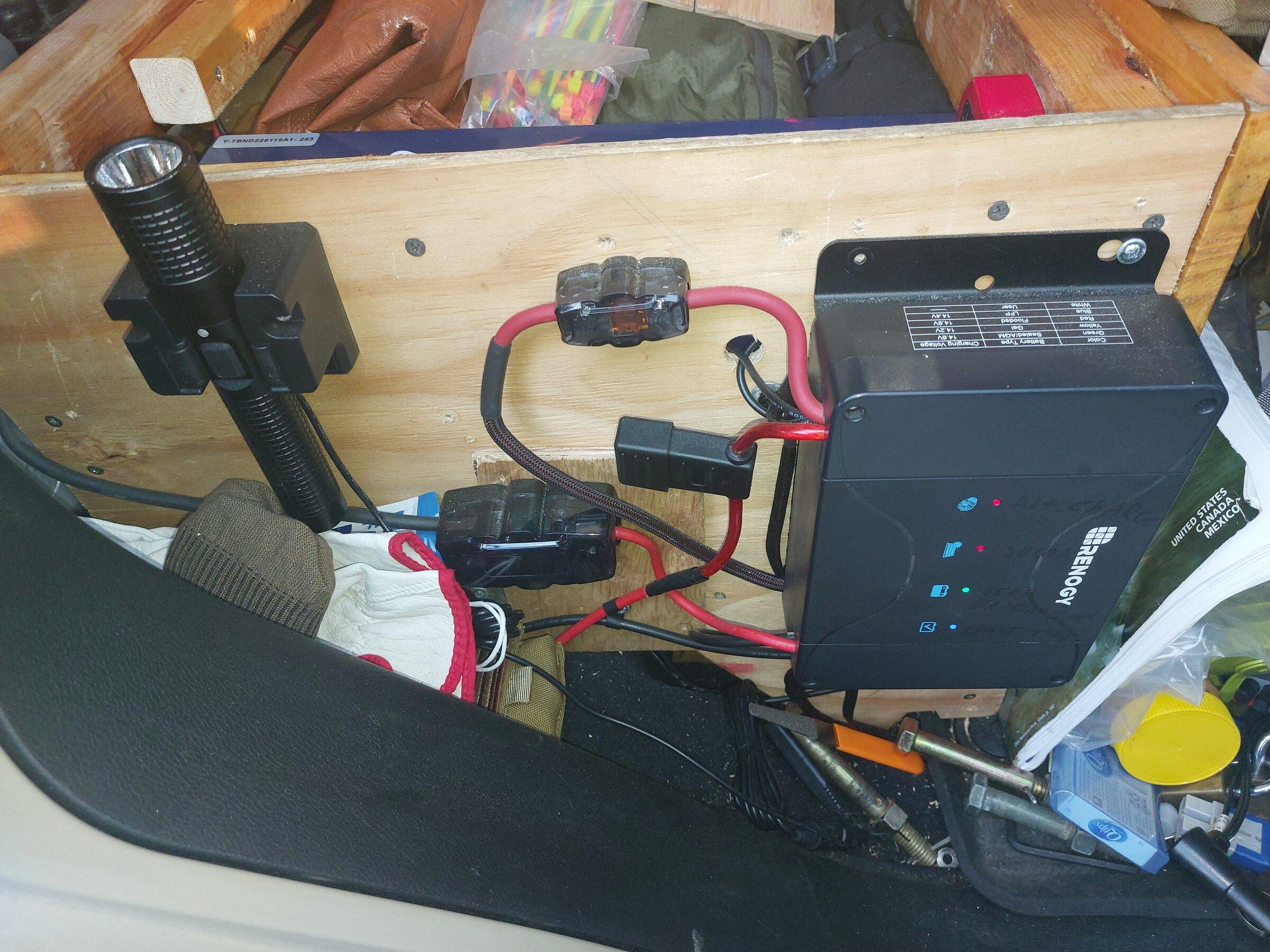

Alright, time to talk power supply for the build. Tell me about your systems and recommendations. I'm sure you've got some opinions.

Now on with my steps in system. I started just on vehicle stock battery(ies) but with 85 w Cascade system. No problems unless it was clouds and rain for week.
Second step 2 36amp LiPo batteries w 100w panel with Renogy control. It doesn't show any draw down with fridge freezer running full-time. But I recently swapped up to a 100amp LiPo battery, and plan on changing 100w panel for 2 100w panels and using the original one as a portable one.
Now what I did with the 2 36amp batteries is configure similar to a Jackery in usefulness to me. But I try to stay away from 120v being needed. I've got a few voltage inverters I might put one in to charge few cordless tool batteries.

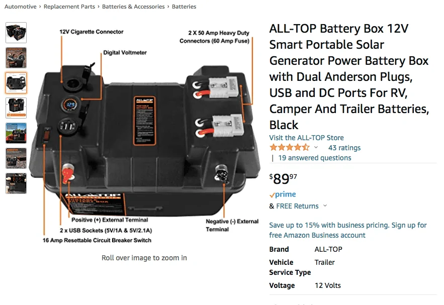

Thanks for the post! I didn't know they had battery boxes, with outlets build in. Now to find out what battery to use.
Jeep Gladiator Gladiator Expedition Rigs Screen Shot 2022-05-01 at 8.10.49 AM
Or build your own.

It was a bit tough getting it through the 3ft. basement door. Glad I could break it down and my son and I could lift it.

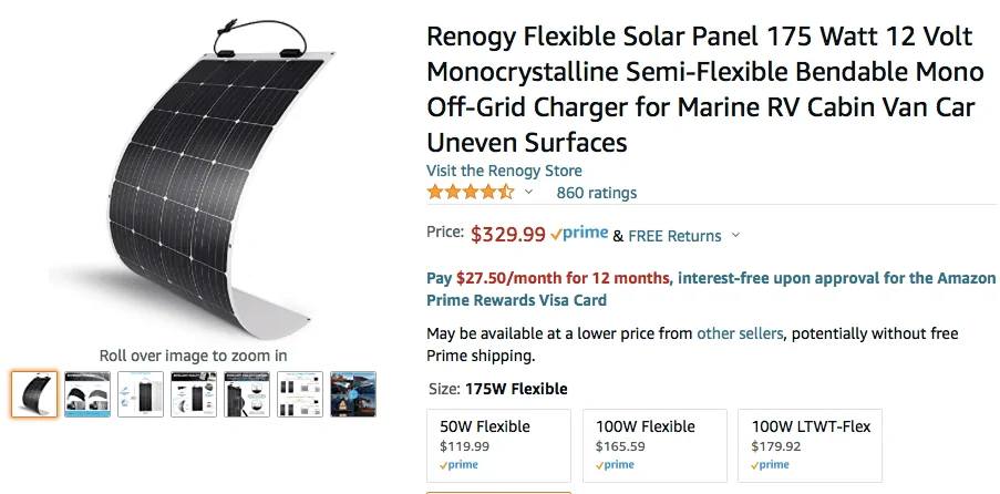

Since I have a curve/bend in my top I was thinking about a flexible solar panel, like the one below. It would also be very low profile and adhere directly to the top. Does anyone have experience with flexible solar panels?
Jeep Gladiator Gladiator Expedition Rigs Screen Shot 2022-05-02 at 5.44.44 PM
Jeep Gladiator Gladiator Expedition Rigs Screen Shot 2022-05-02 at 5.31.10 PM

I had a 100 watt flexible solar panel glued to my roof top tent for about 6 years the only issue that I had was that the leads from the panel had broken, might have been caught by a branch, so I had to remove it and replaced with a new flexible panel, hope this helps.

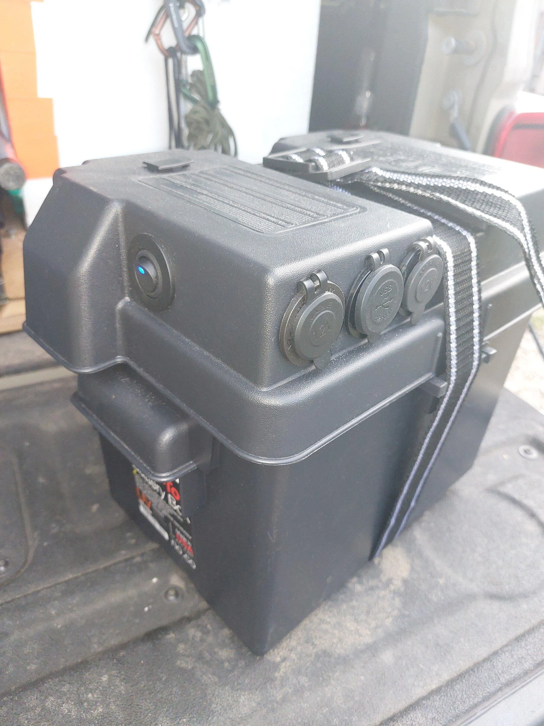

Or build your own.

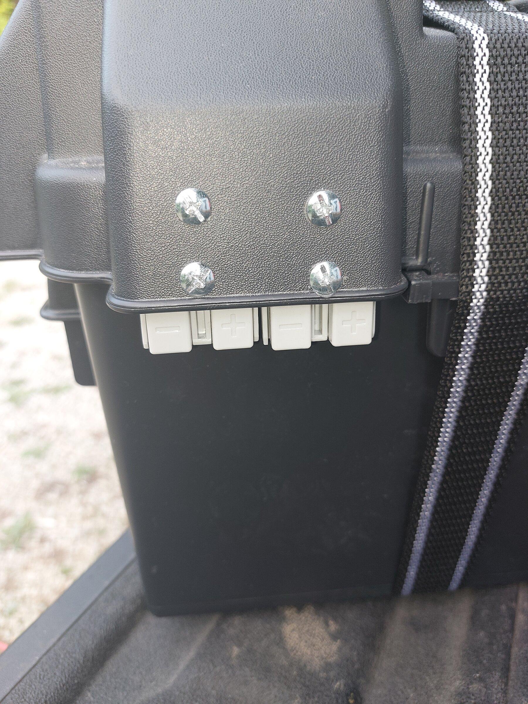

I installed them myself on the battery box. That way I decided what and where the different ports are located. The one you showed looks to not like rainy weather. And OH Damn it cost a lot less DYI

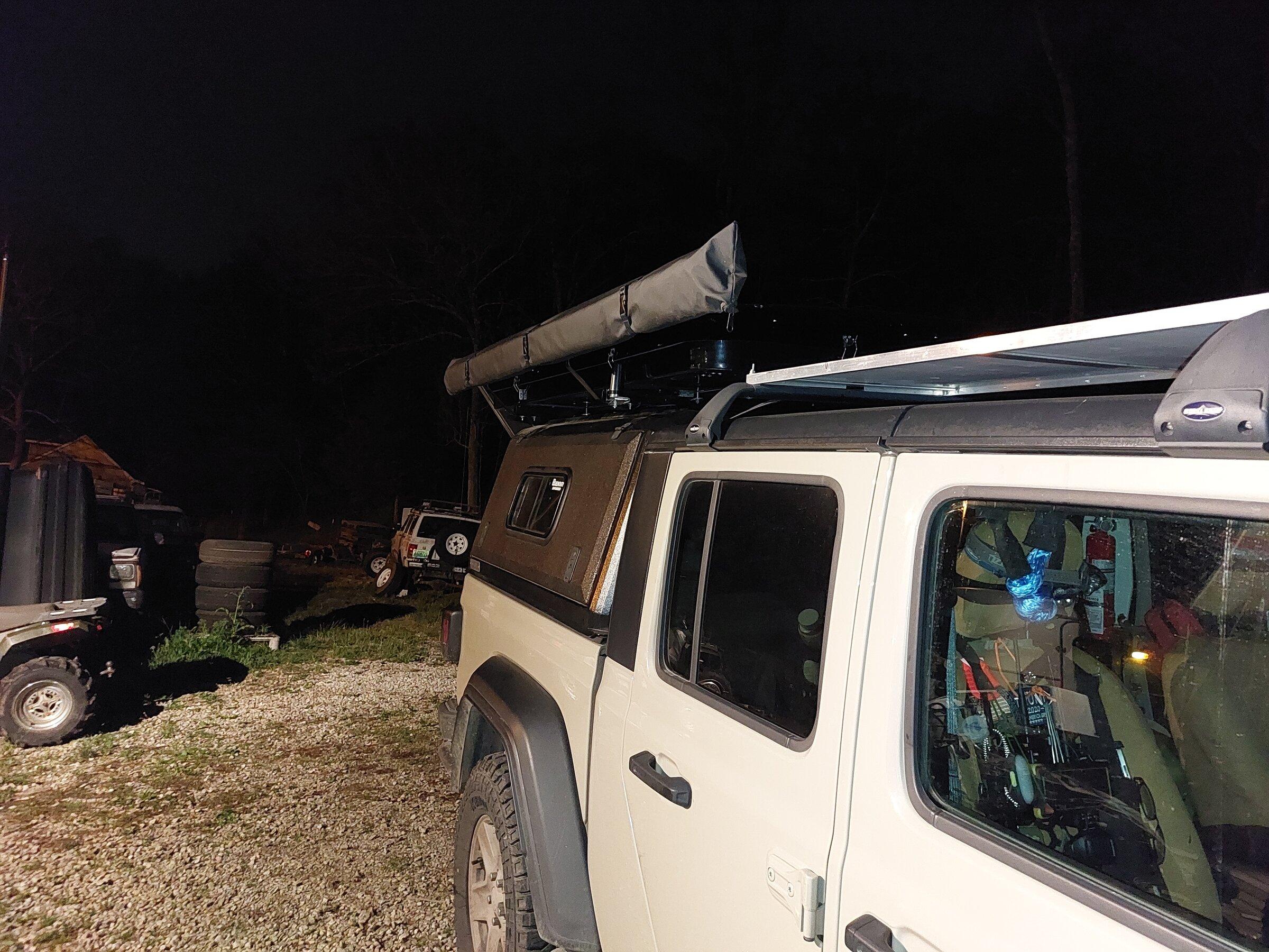

I've currently got a flexible 100w panel but mounted in a aluminum frame I built for it, it's mounted on a set of low cost roof rails on cab area. The aluminum frame is visible on the picture in front of the awning.

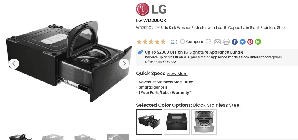

Please, no one tell my wife that there's an overlanding washing machine available!
Jeep Gladiator Gladiator Expedition Rigs Screen Shot 2022-05-06 at 7.02.58 AM
