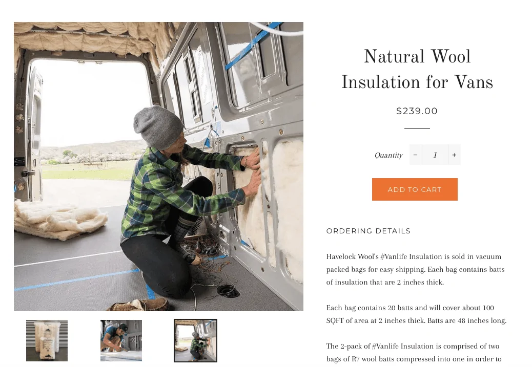

Check out Havelock wool.
I am a big fan of Wool. I don't know of a better natural material that is water resistant and a great insulator.
This would also make it much easier to work around if adding wiring/plumbing down the road.

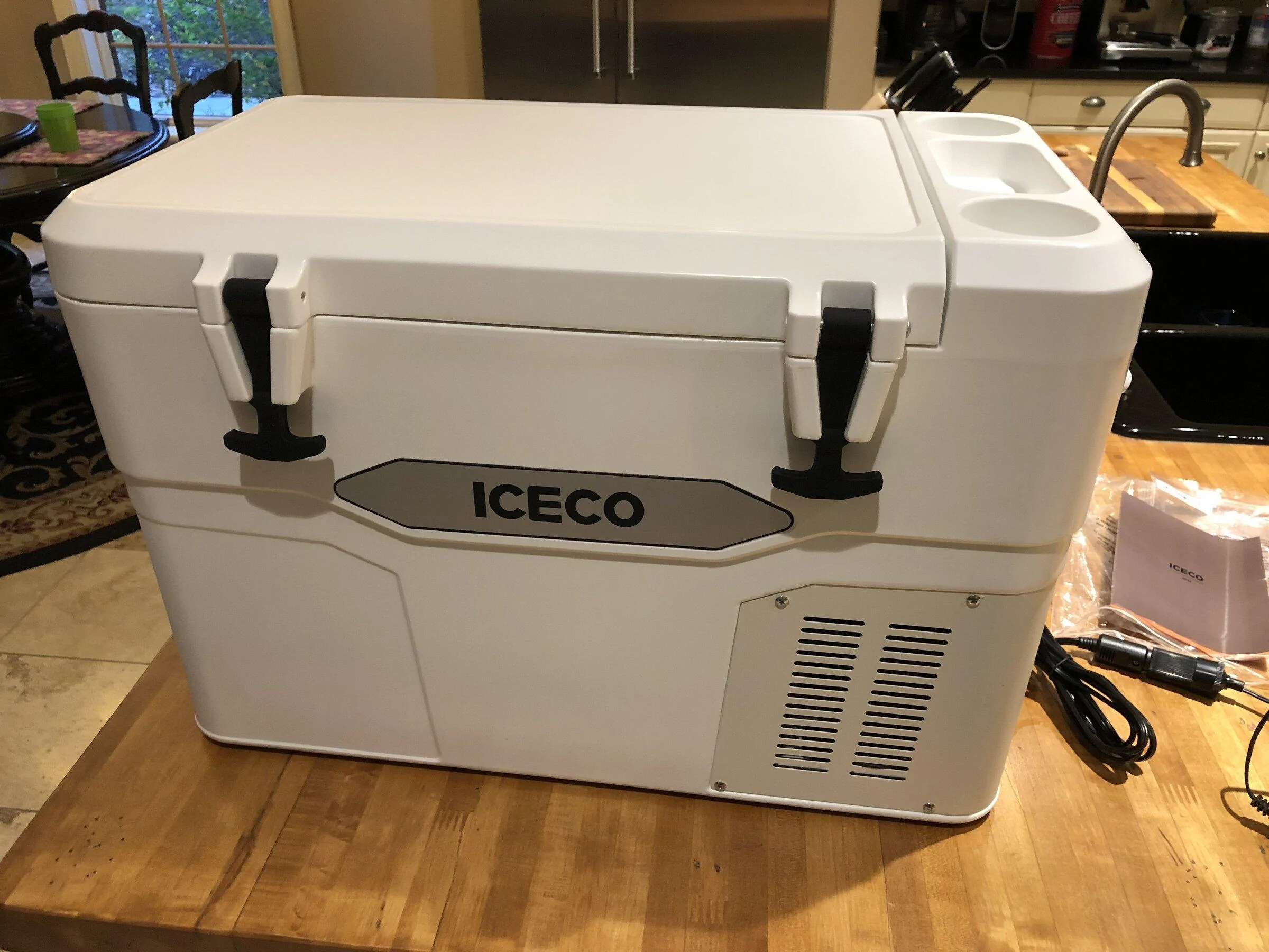

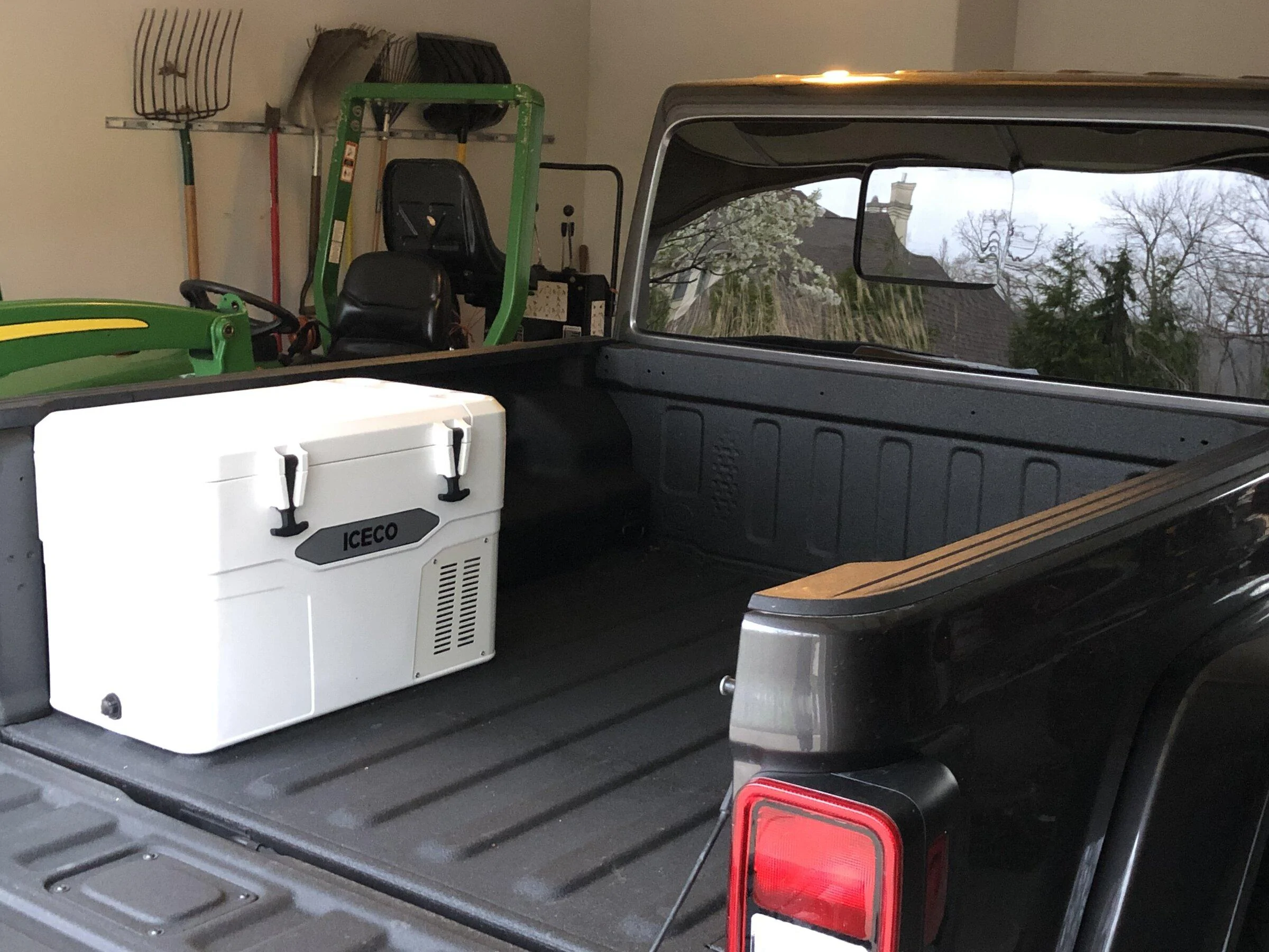

It just arrived. I’m pretty excited about not needing ice this summer.
Jeep Gladiator Gladiator Expedition Rigs 97D4E6B2-BB12-4E58-AC0F-863CDD57401E

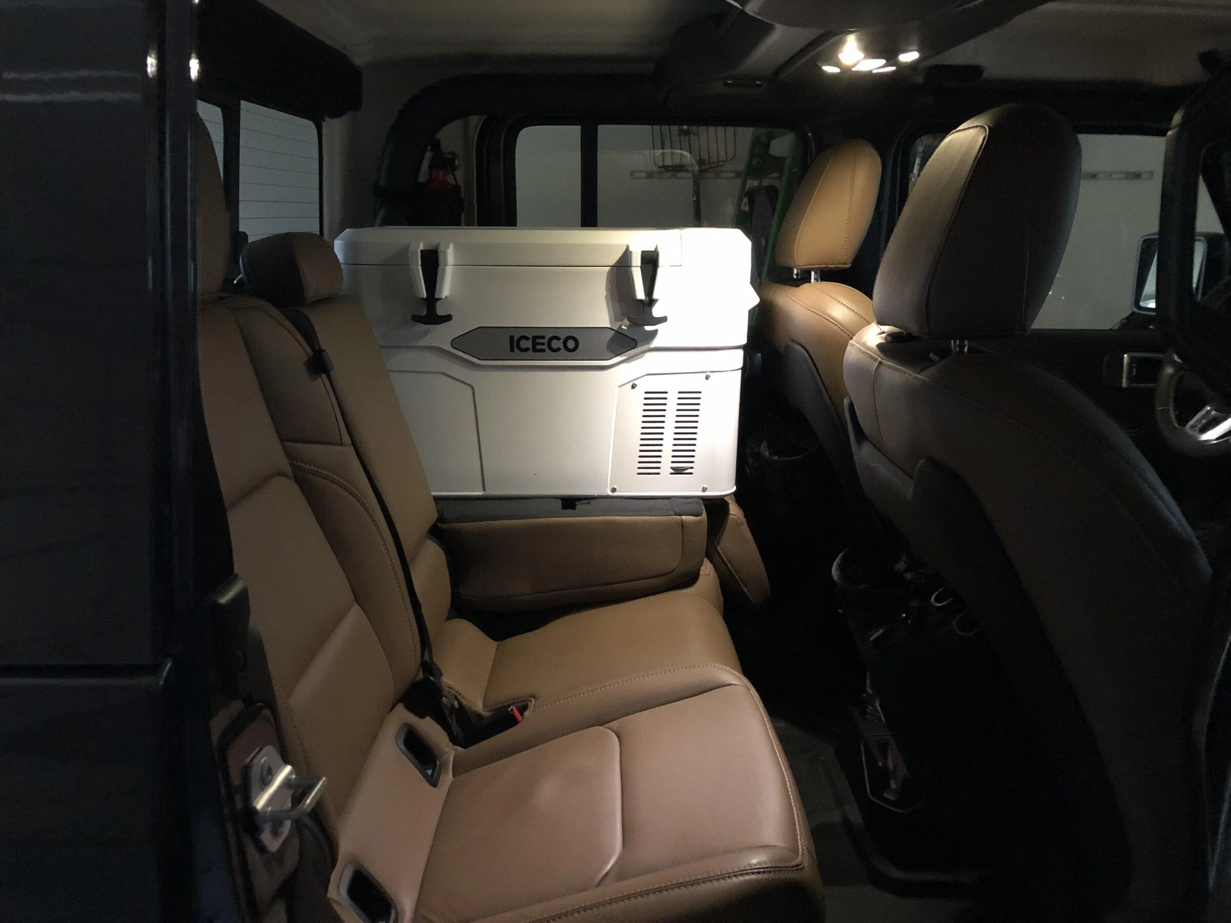

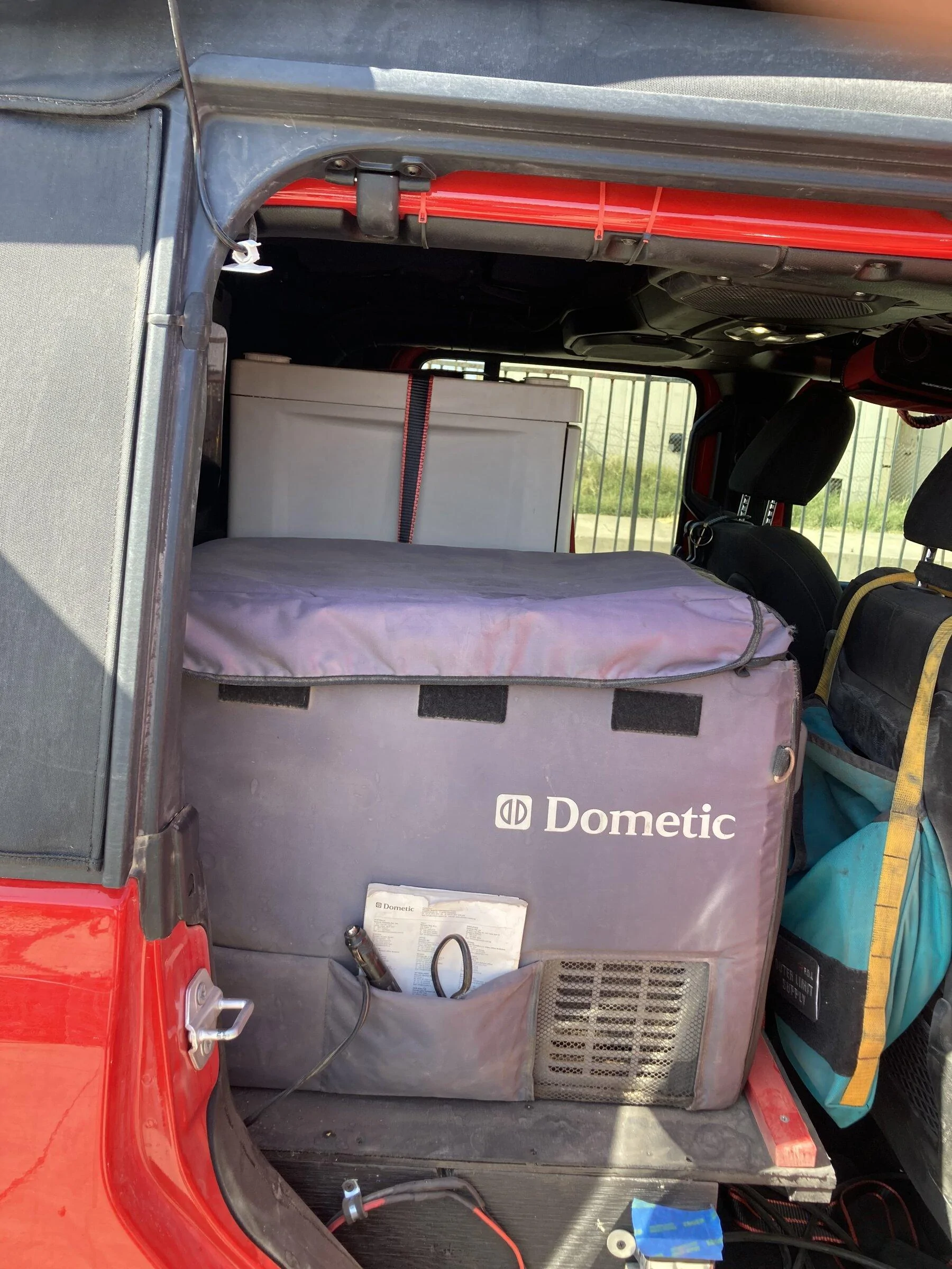

Here’s the two locations dependent on use. It fits great!
1) Back Seat when my short hardtop is on.
2) Side of bed when camper is on.
Jeep Gladiator Gladiator Expedition Rigs FC1577A3-4EC4-42D7-A9DA-5C2DB4248AF8
Jeep Gladiator Gladiator Expedition Rigs 10E5C954-1280-43F0-98A6-8F37CD638F7C

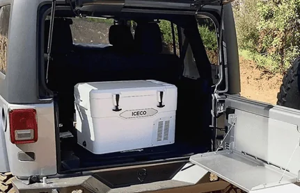

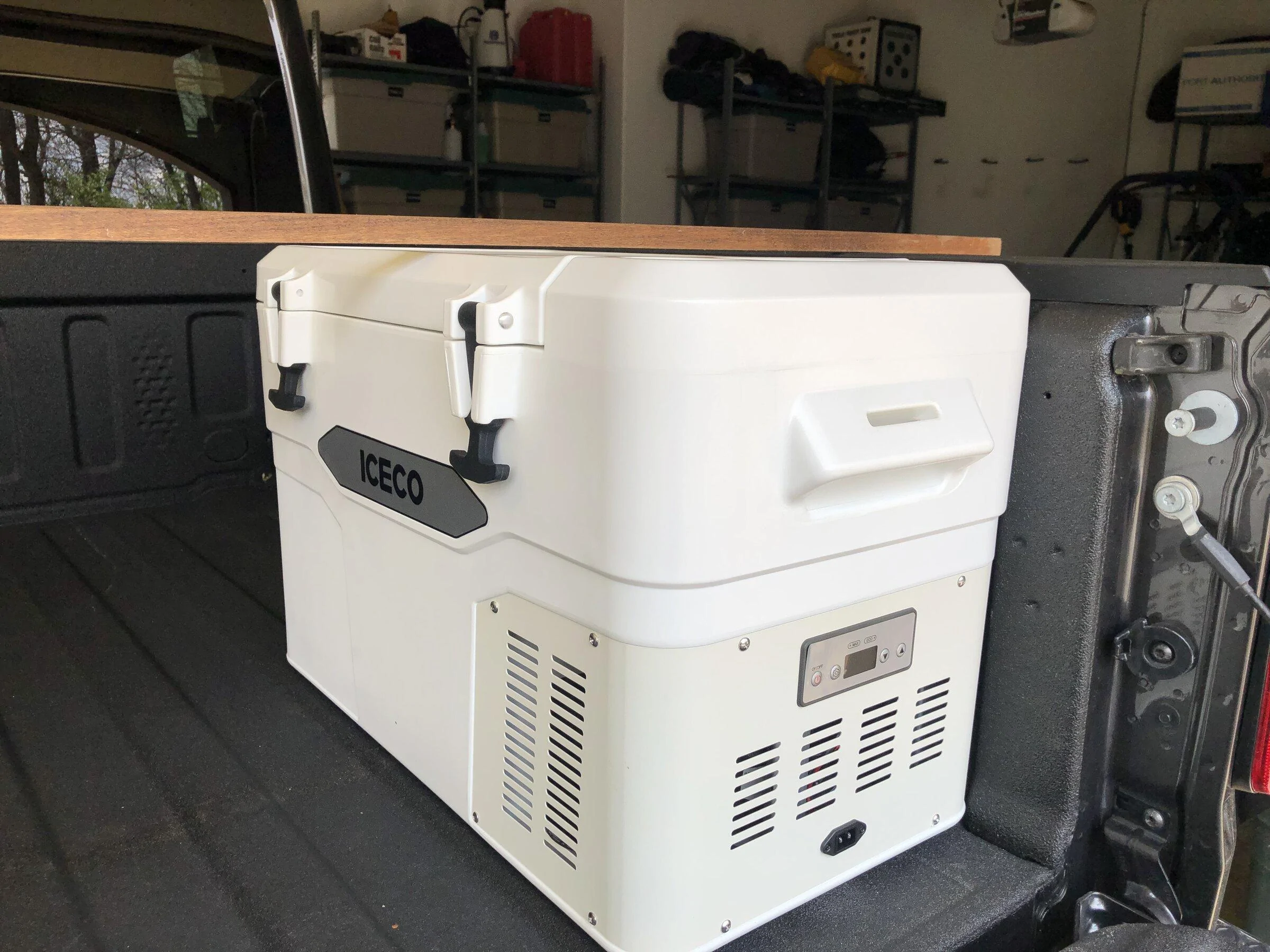

I have been looking for a cooler like that but I want one that will fit under my tonneau cover. Most the ones I have seen have been a little too tall but yours looks like it is just about in line with the bed rails. How much space is there from the top of the cooler to the bed rail?
Mules
Mules
Aug 27, 2020
1,203
3,287
St. Louis MO
'20 Gladiator, '93 Landcruiser, '77 CJ, '88 Bronco
Engineer
Looks like 1/4” clearance.

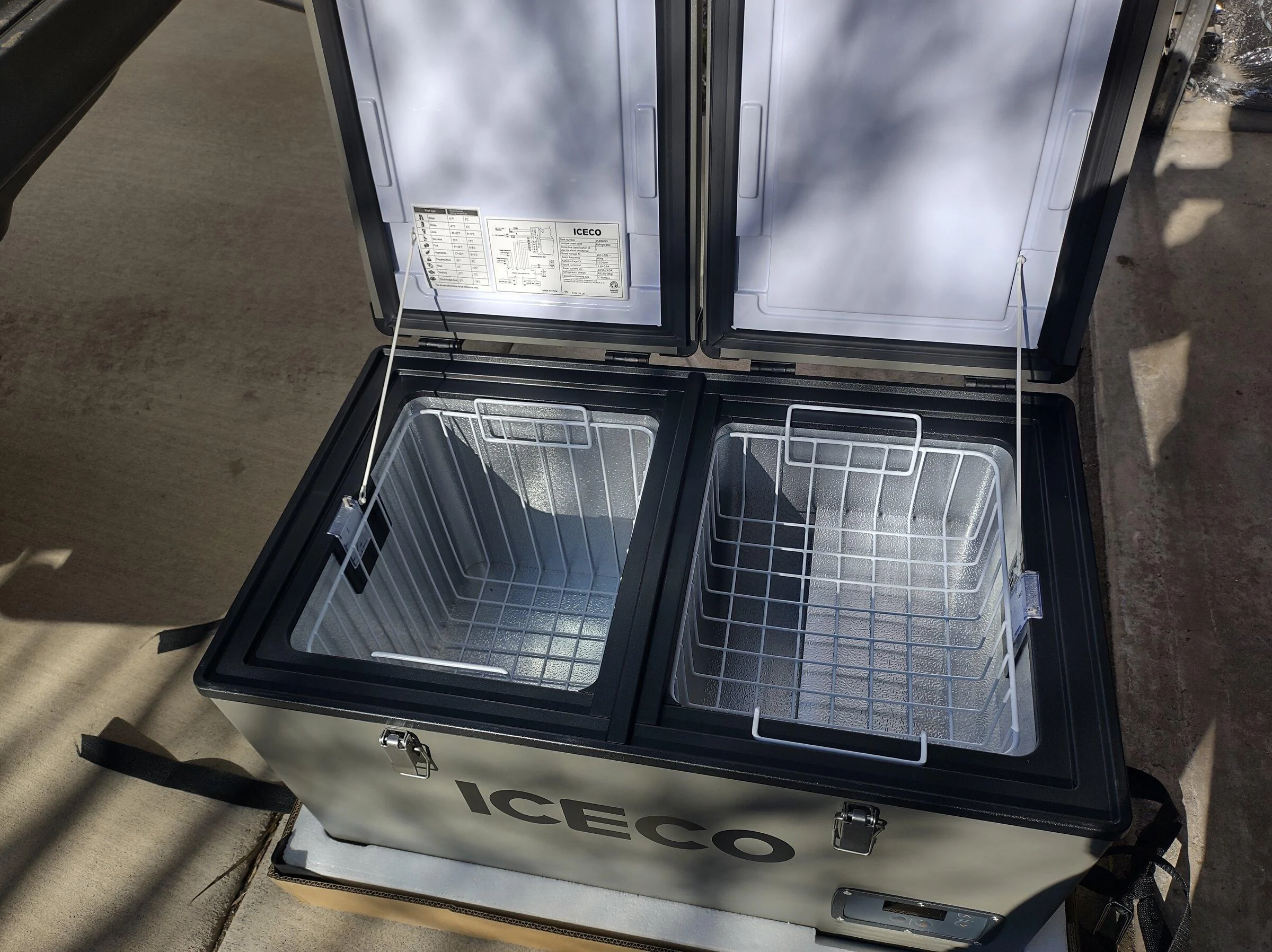

Which one is this? I ended up going with the VL 60D.

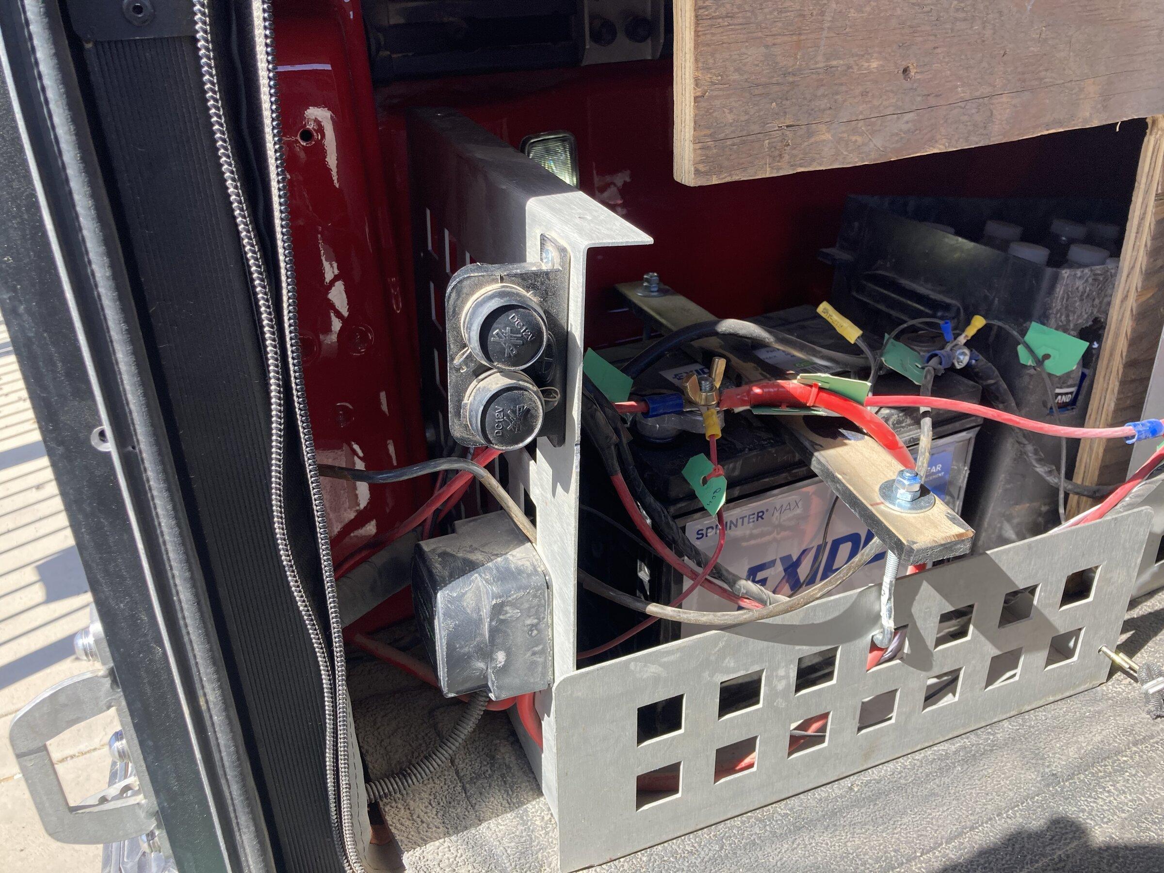

I deleted the rear seat and installed my frig there and ran power from the auxiliary battery that is set up in the back of the Alu Cab that is powered by a 100 amp solar panel to a sealed battery that is also connected to the Jeep battery with an isolator so that In case there is no sun as I’m driving both batteries are being charged, the longest that I have sat without running the Jeep is 1 day and I did not have any power issues,my investment for this set up is under $300.00, hope this helps
