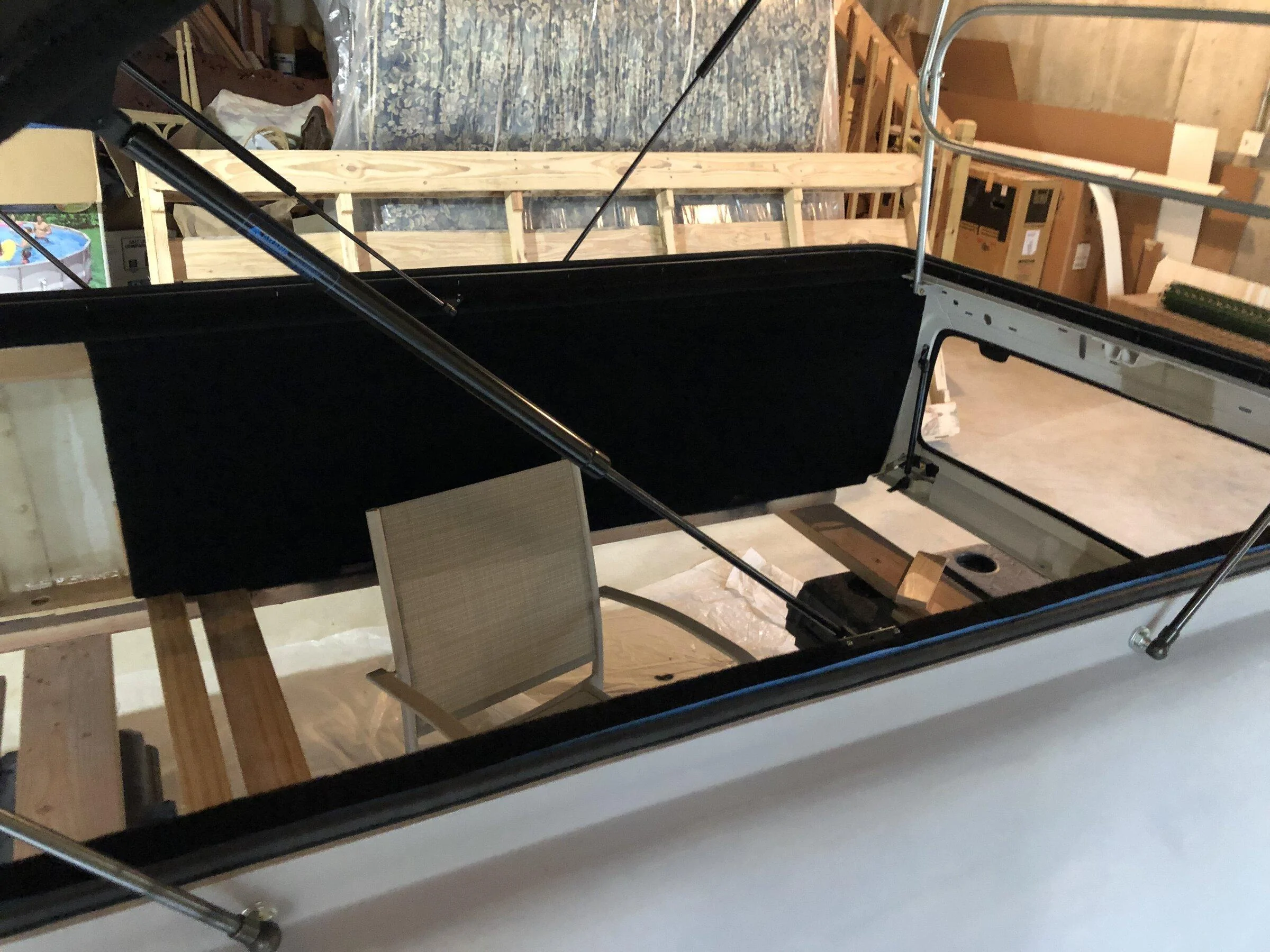

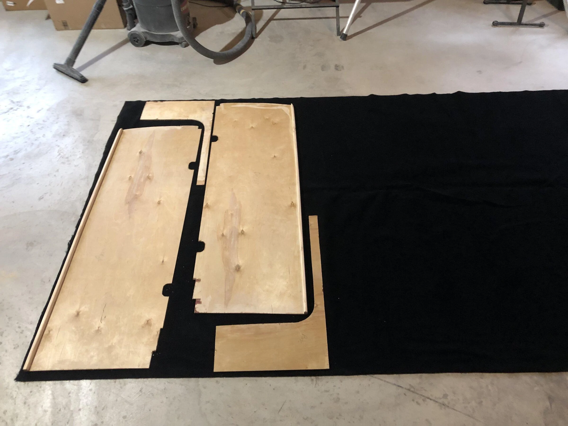

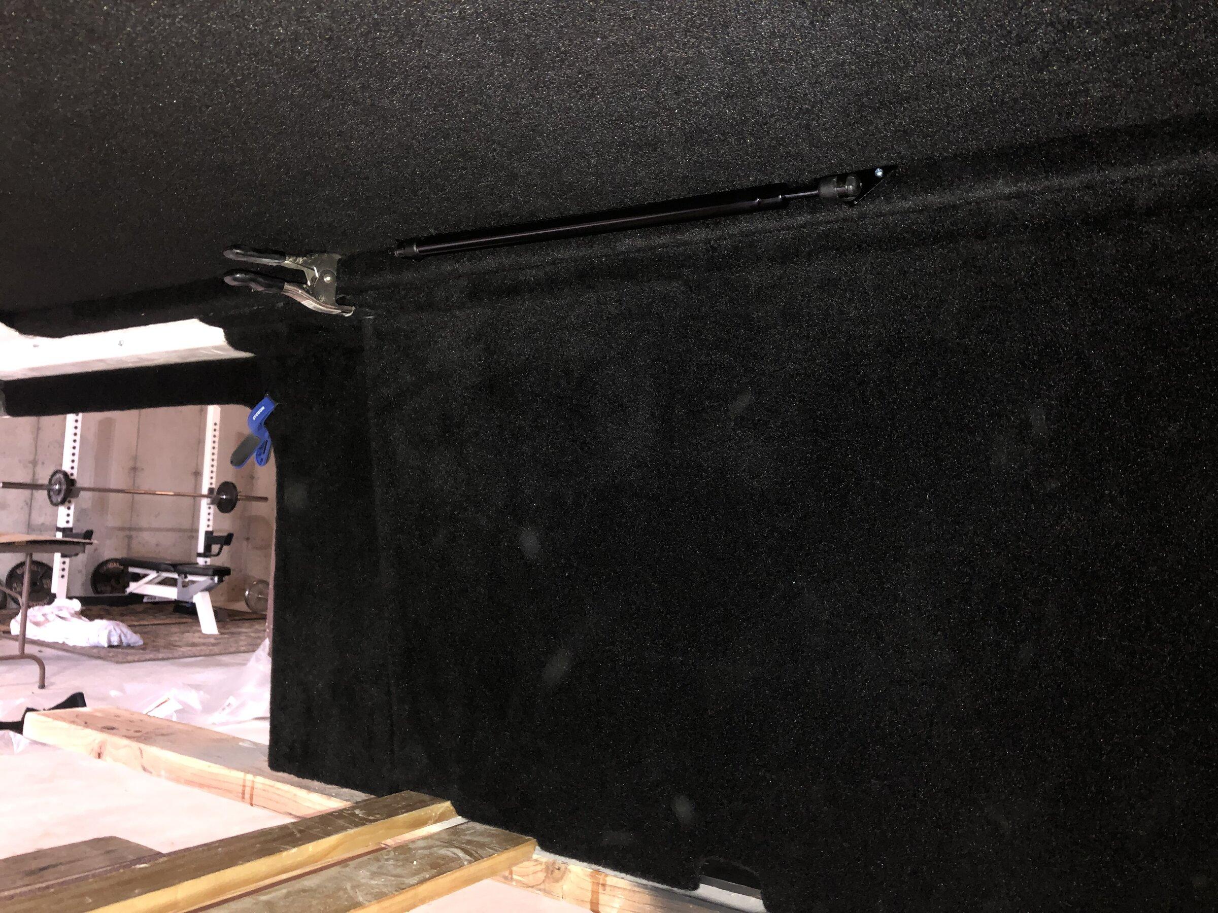

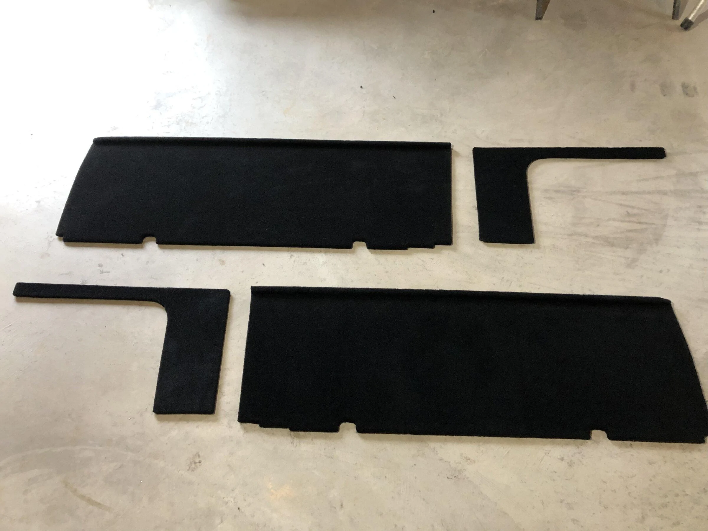

Well, as I think about all the cool expensive gadgets coming up, I still need to finish the shell. I’m wrapping the interior panels with automotive carpet.

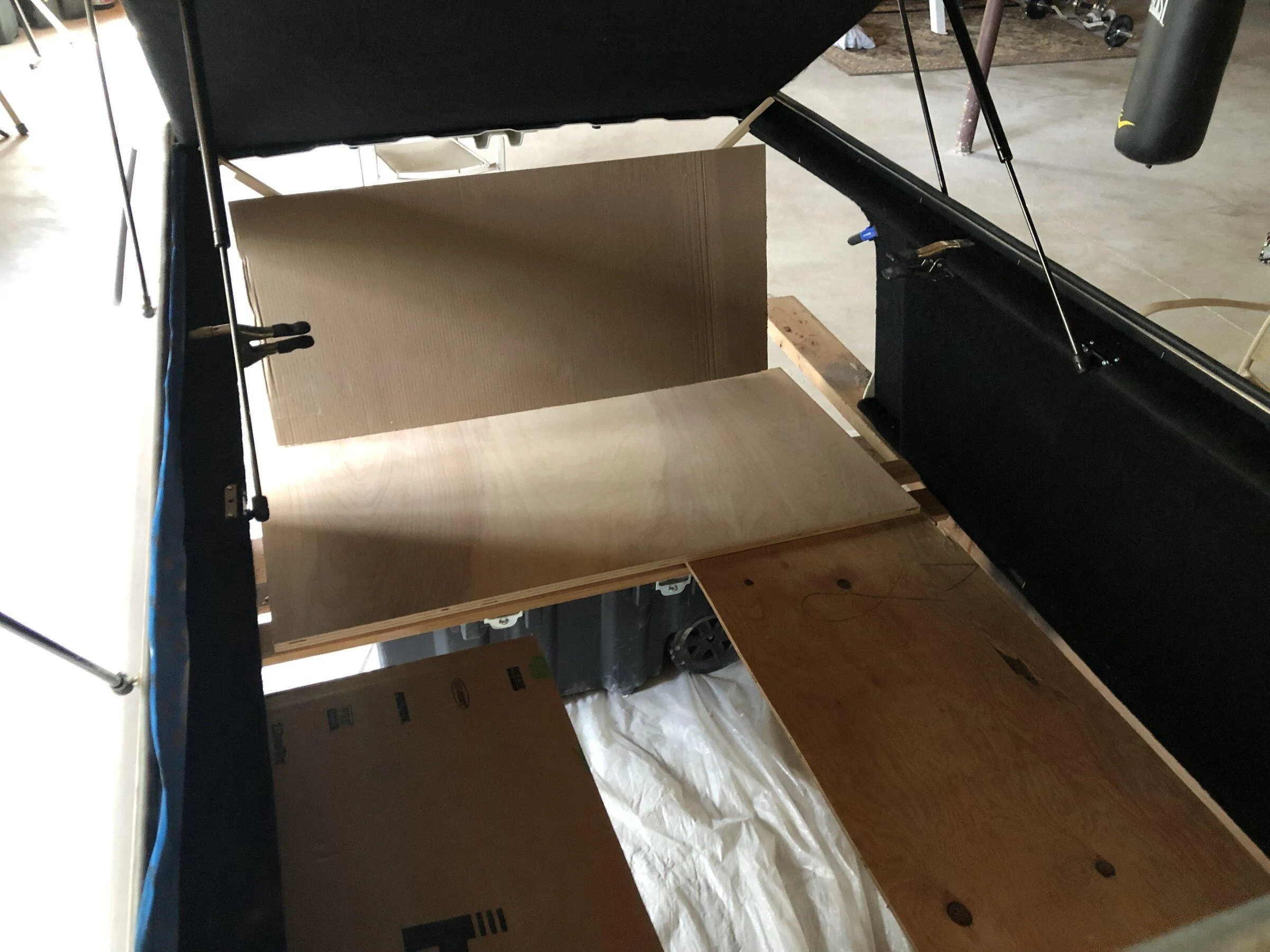

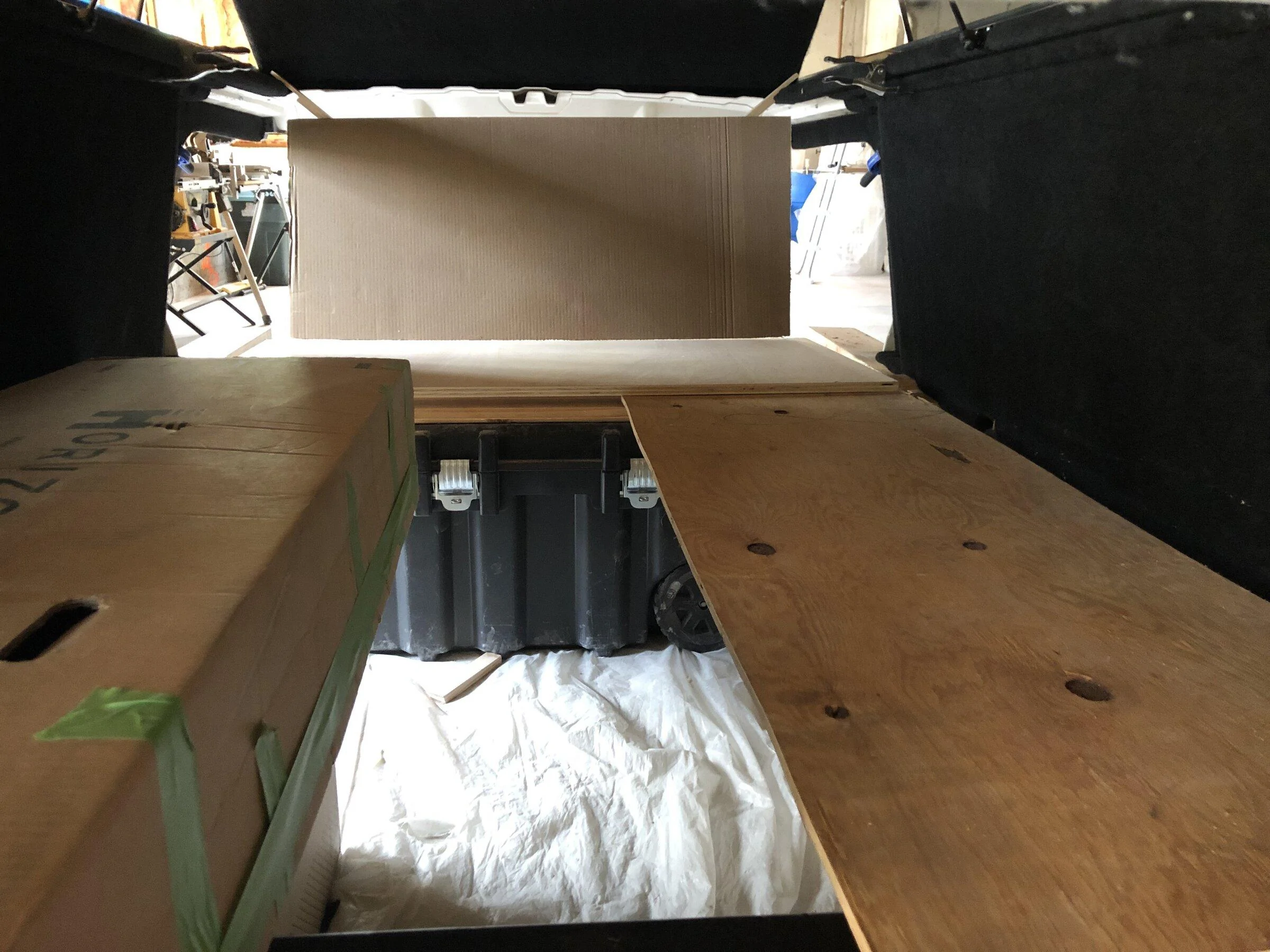

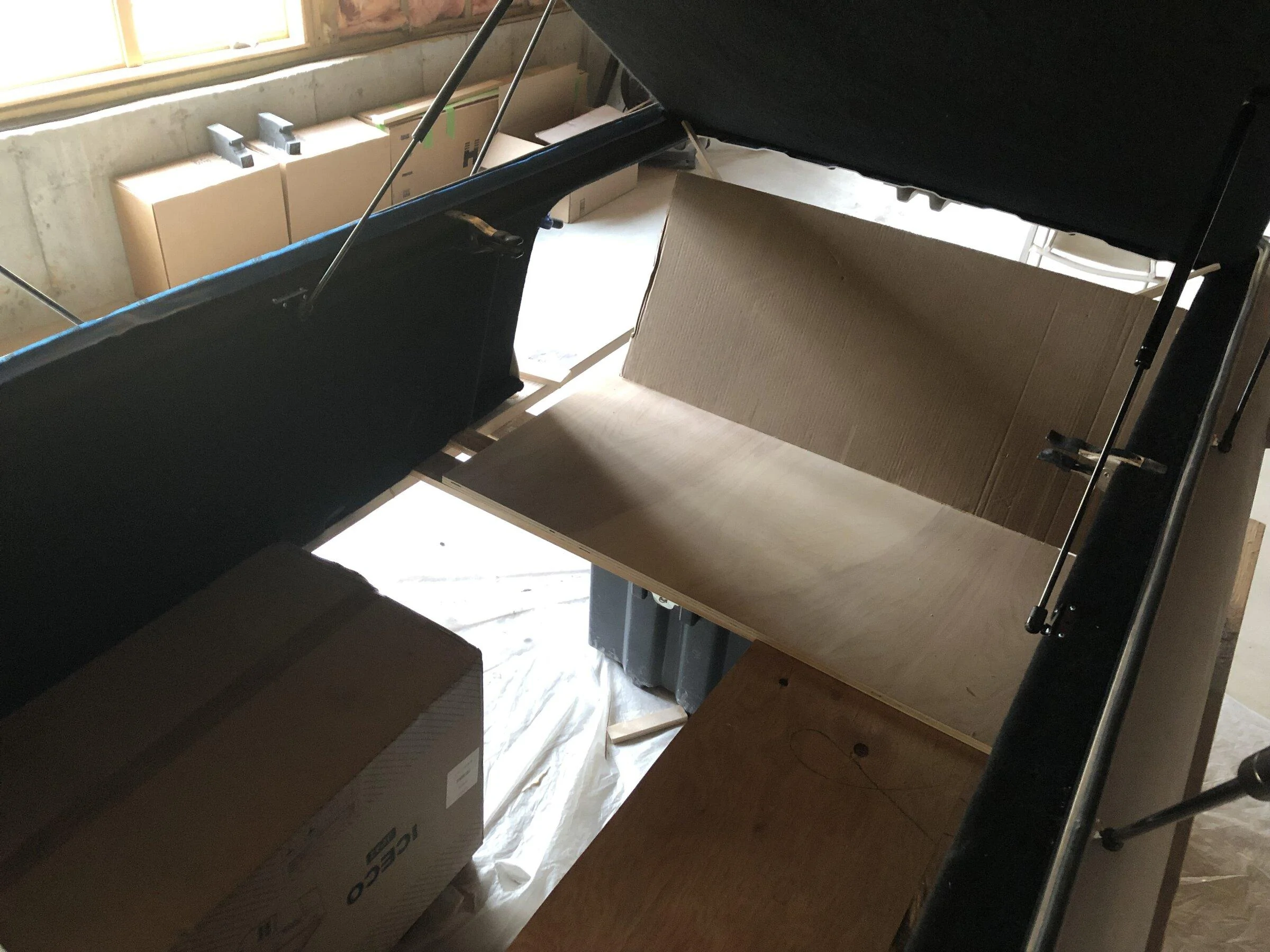

Since I can walk around inside now, I’m mocking up the layout with cardboard and plywood. Can I really fit a fridge, sink, stove, battery, toilet, 10 gallons of water, and storage back there? We’ll see.

Foam board and a spray in foam? Something like “great stuff” for windows and doors might do the trick.
That would be my suggestion, use the foam board to take the majority of the space, and fill in gaps with low expansion spray foam for windows and doors, then use the same carpet to cover the entire area, keeps things tidy

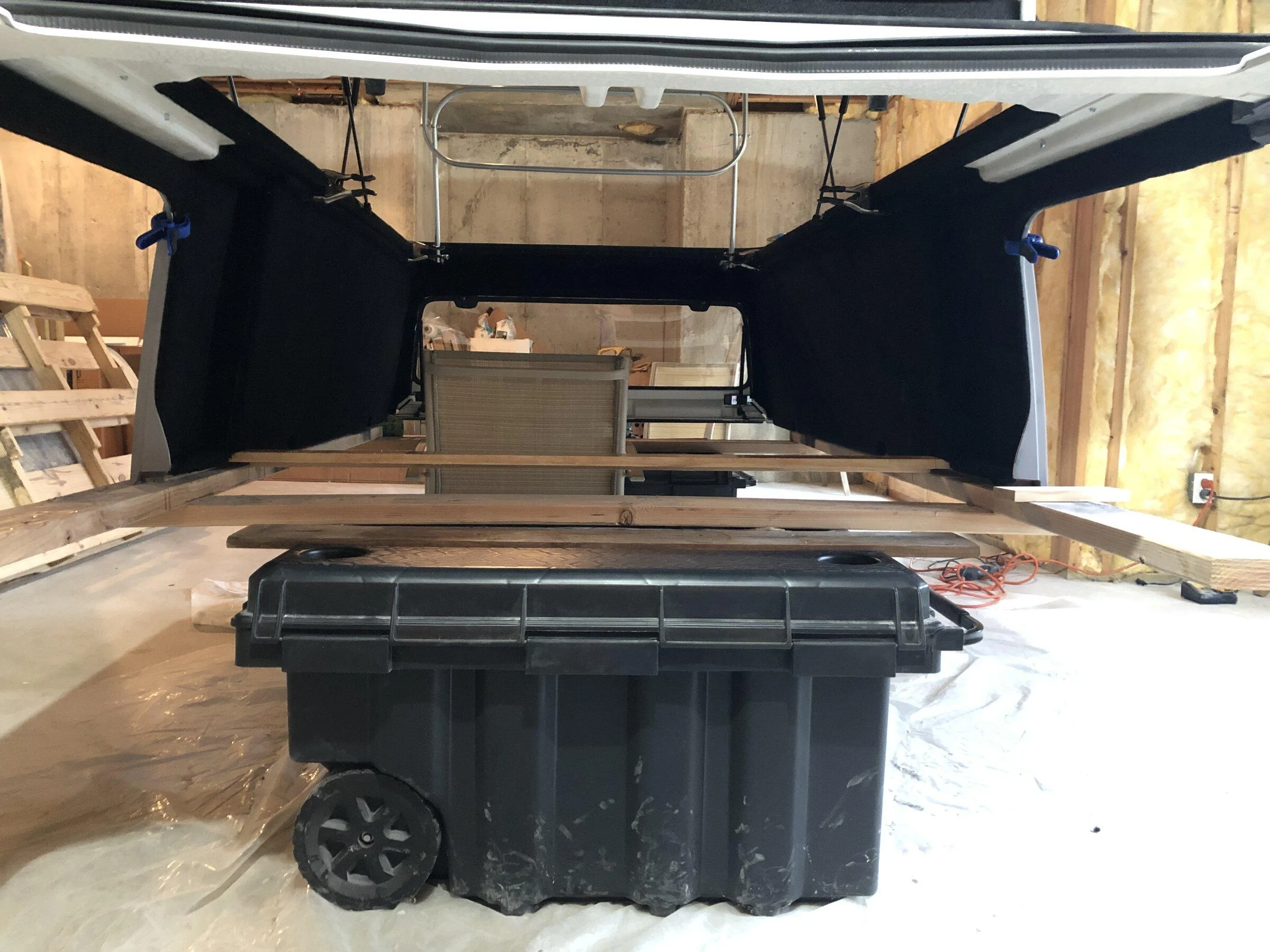

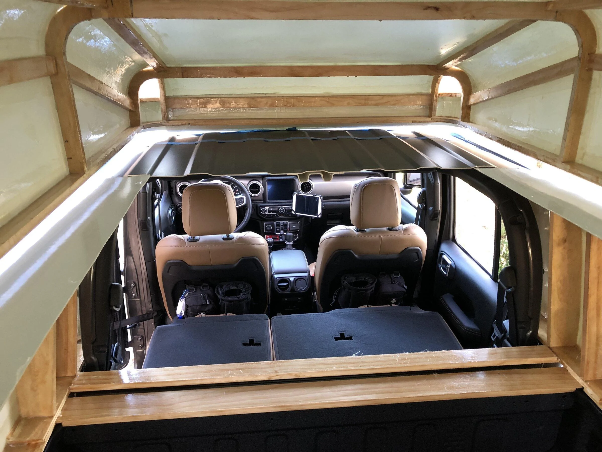

The cushions will lay on top of the pickup bed head wall, so no cutting of the truck. The cab back seats simply fold down, and the cushion platform will fold over the back seats. Rubber seal between the pickup bed headwall and the cab back wall. Here's an old picture from when I was roughing it out. The pass through is a lot bigger now since I trimmed up to the blue tape which you can barely see.
