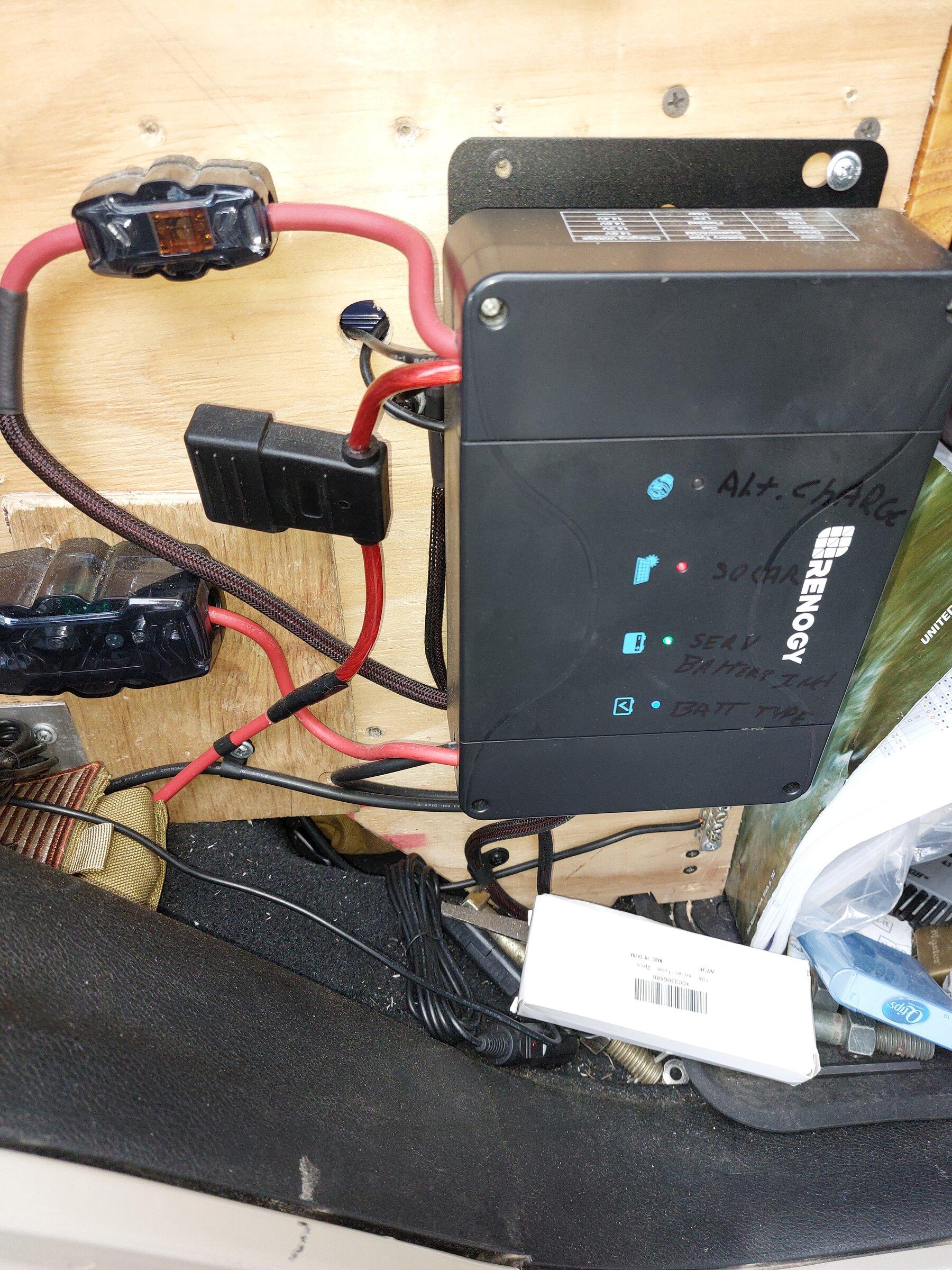

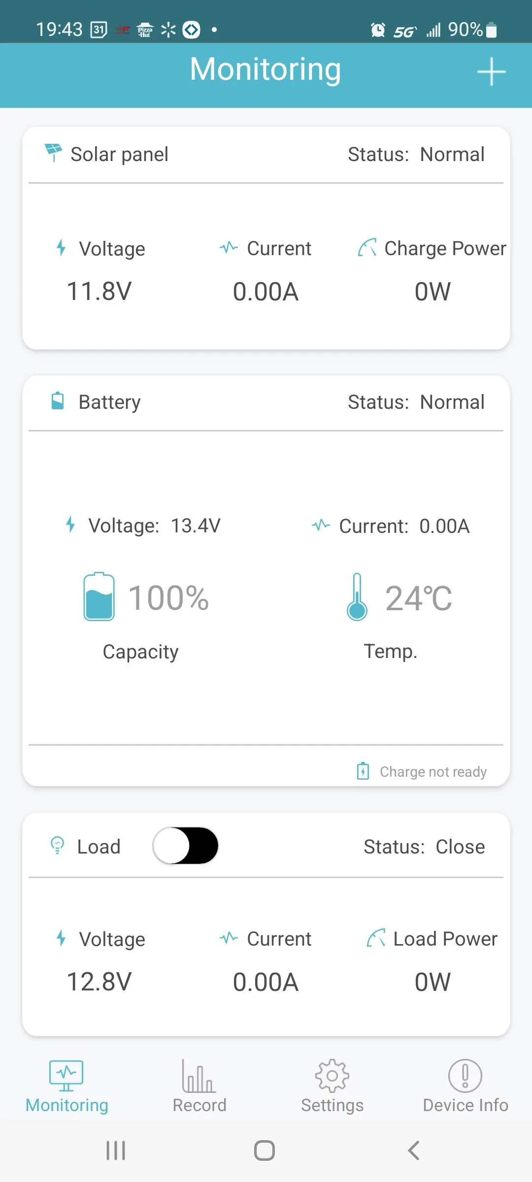

I just went outside to connect with my MPPT Controller to see it's current charge level. For example of what can be expected.
The second battery charge is the starting batteries, note that it is cloudy rainy here at sunset. Mine is running a fridge freezer full time and auxiliary lights in bed, GMRS radio, various other stuff. I'm passing this along so you can assess your power needed, many days the Renogy is just feeding power to the starting batteries not even the "house" battery.
FYI: my JT does have 2 solar systems running too. The Cascade 85w on hood too. I'm a function over looks for my stuff. So that's the crude plywood look recycled from the crate my RLD topper came in. ;) I do need to clean up the wiring some.

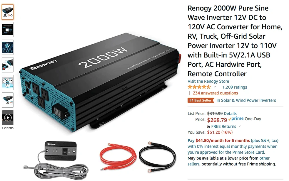

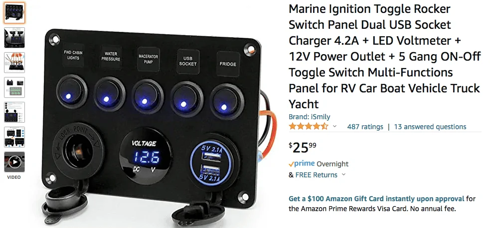

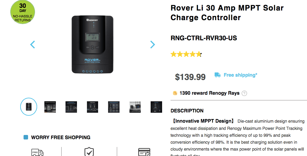

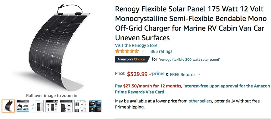

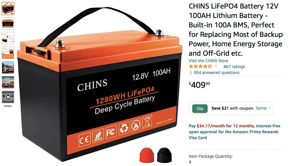

Alright, here's my idea on a solar/power system. It's a lot cheaper ($1,100) than a Jackery, can permanently fit on my small top, and should have plenty of power for a fridge, microwave and blender for those margaritas and nachos on rainy days!

Having a motorhome with solar panels. Go one or two sizes bigger on your wiring from the solar panel to controller to battery. You'll have less lost in transmission.

IMO don't take the risk with these super cheap Chinese batteries. Not to mention they don't put out their rated power.
Get something like a Battleborn.

Mules check out the Cascadia solar panels for hoods, the Toyota Land crusier big square one is 100watts, glues onto your top…..Jack
