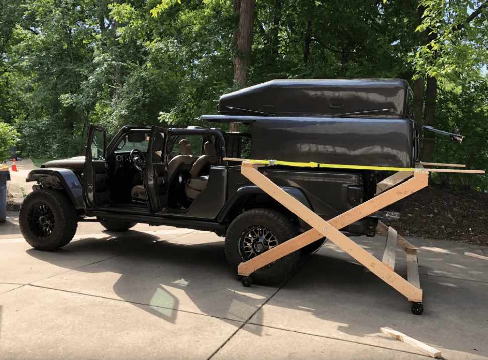

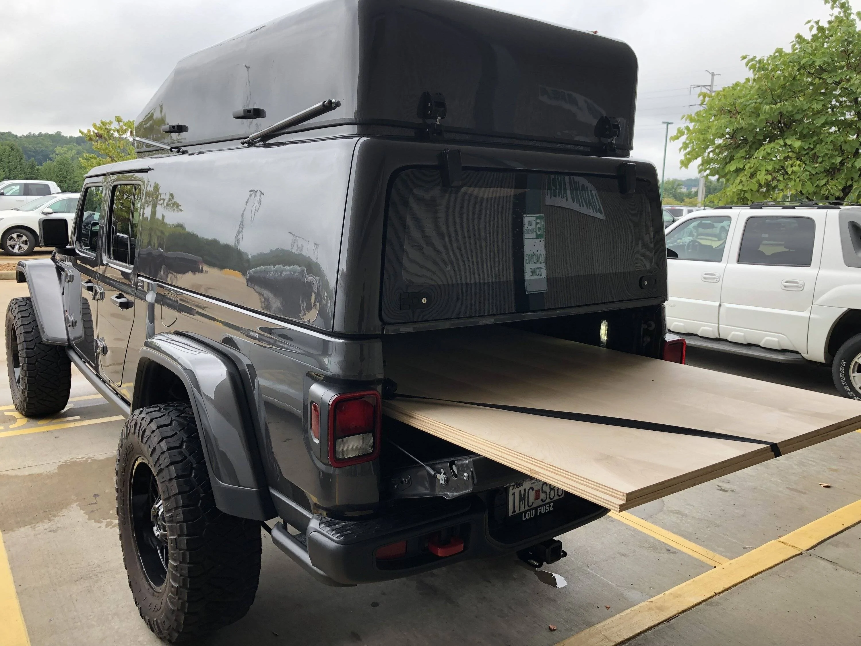

Thanks, if you go back to page 57 & 58 of this forum, there's plenty of pictures and posts of me Mocking up and building the furniture. I kept it strong and light, and I can remove it in about 10 minutes, if I need to haul anything in my truck bed.

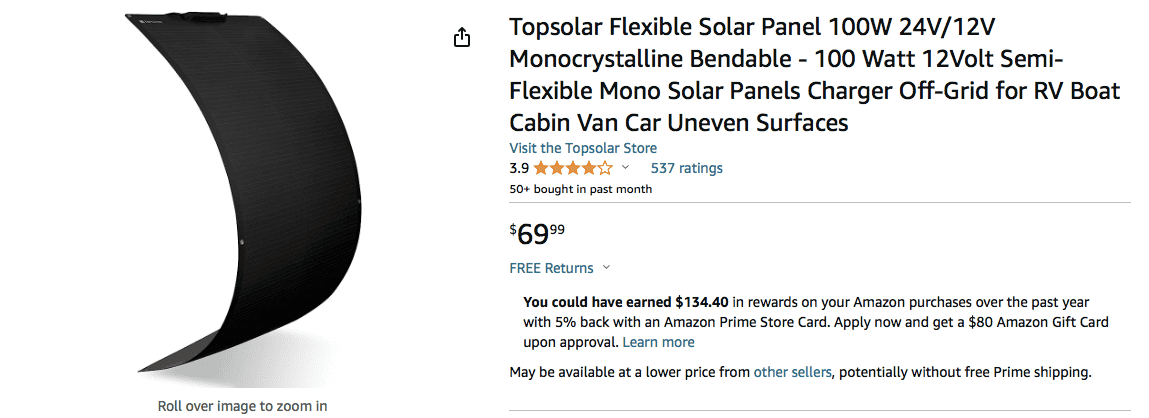

Mike a few years ago I had 2, 100 amp solar panels taped to the roof of my Hallmark expedition camper (from the factory). They lasted about 2 years before they literally cooked themselves due to not getting adequate airflow across the bottom. I subsequently went with solid panels on short L shaped risers and have been happy since.
I have seen some people having success with flexible panels where they use plastic corrugated cardboard like you see being used for yard sale signs to provide channels to allow airflow under the panels similar to this…
https://www.amazon.com/Juvale-8-Pac...437-a85c-3a6ac0280cbf&pd_rd_i=B07K1ZTTLT&th=1
Thanks Eddie! Plastic corrugated backing sounds like the way to go.

The standard coruplast that's widely available is 4mm / 0.157" thick. The channels are so small, I'd think they'd just clog up before long with dust and crud.
If you really want airflow under the panel for max output and longevity, source 12mm or 1/2" coruplast from a local sign shop. That ought to really work as a standoff and allow air exchange. Aside from that, looks like home depot etc can get 8mm and 10mm in polycarb which would be a lot better than 4mm. (Just watch out for having to buy a whole 10-sheet pack)
Also think about airflow: rather than one continuous sheet under the whole panel, you probably want gaps at 1/3 and 2/3 so hot air can find its way out more easily when flat
Personally I ended up with 4mm under mine, and sealed around all the edges preventing airflow, because I was pressed for time to install before a trip. Plus I really had no idea how much usable power I'd get out of my 200W panel. Turns out, I'm getting lots surplus power for my relatively light electrical uses, so improving this install has fallen downward on the priority list. I think I'll reassess after the next rainy season and see how everything is holding up.
Let us know how the 1/4" corrugation works out. I was mainly worried about burning my expensive Granite Crystal Metallic paint job with the solar panels. I would hope the panels would last more than a couple years, but if they don't, at least they are getting pretty cheap.

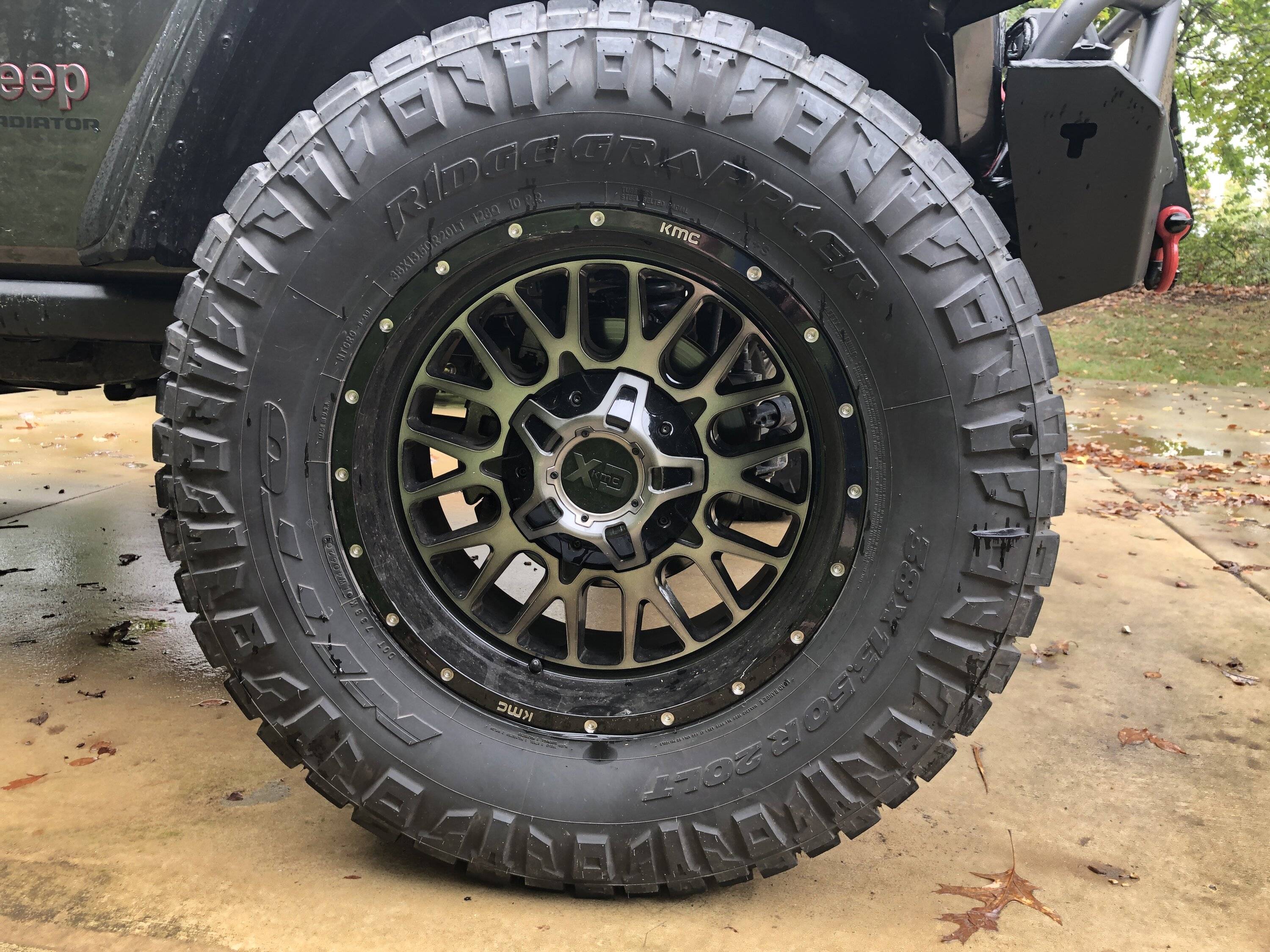

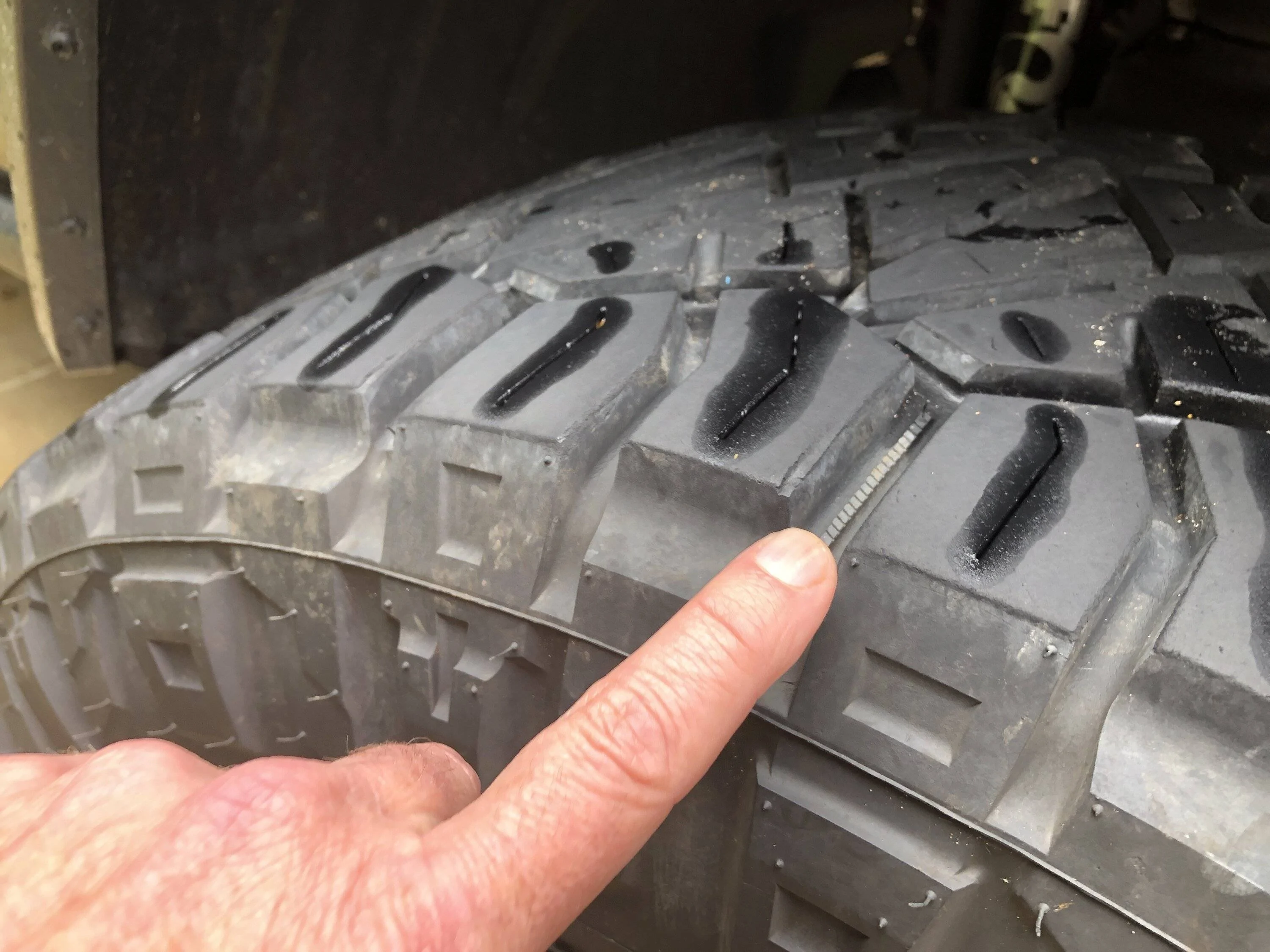

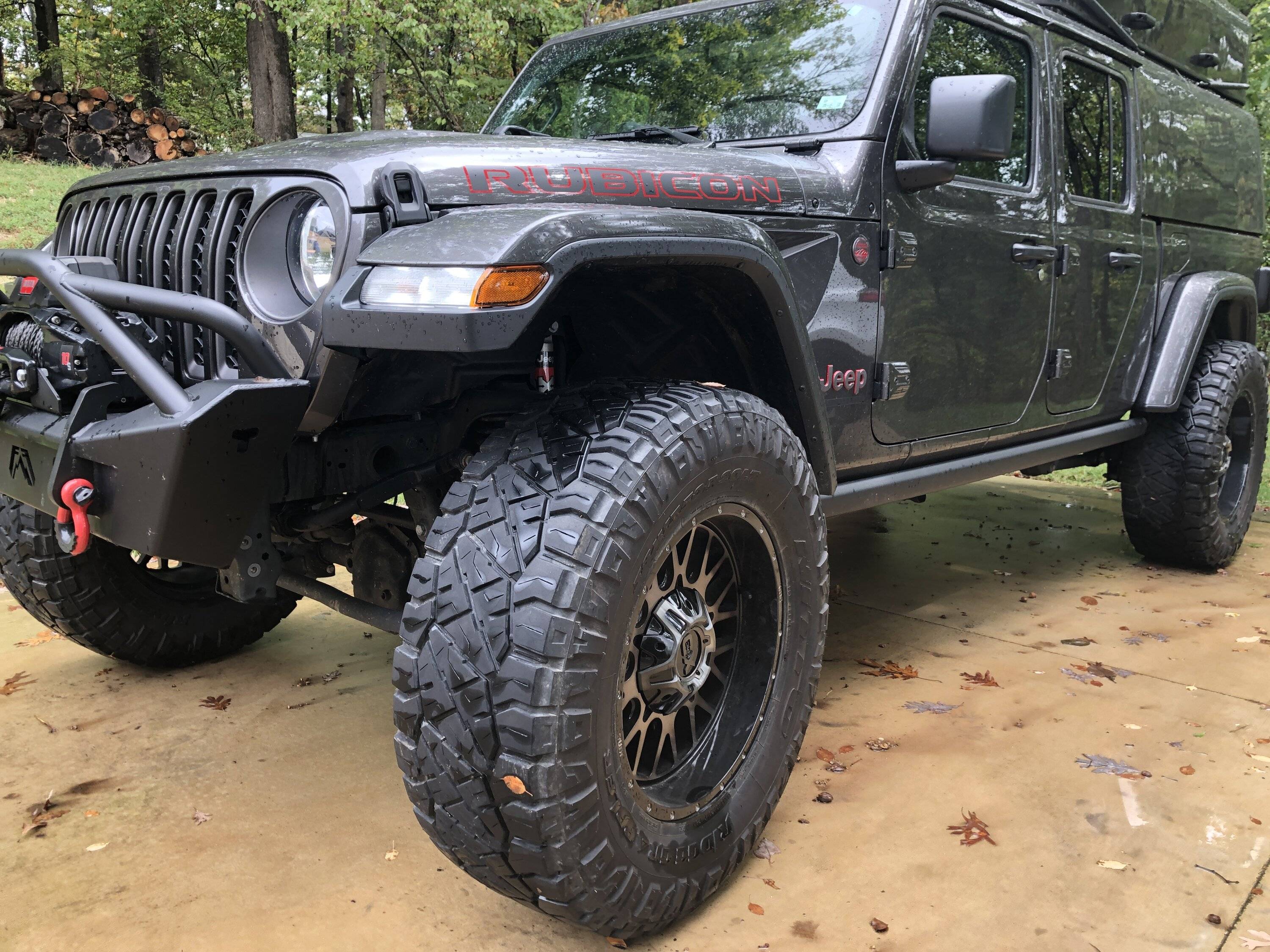

Nitto Ridge Grappler - 25,000 mile review
Alright, I'm been driving 4x4s and sport cars my entire life. I've used Michelin road tires, Goodyear mud tires, Pirelli race tires, and just about everything in between. I used to be a purist and buy the best race and mud tires. Only problem is that both of those use very soft rubber, which tend to wear out quickly. The reality is that today, my vehicles are daily drivers and for fun. If I had a dedicated race car or a dedicated rock crawler, this would be a different conversation.
For those of you like me, 90% daily driver/ 10% fun, I think the Nitto Ridge Grappler is perfect. I mounted these right after picking up my truck at the dealership. It's hard to believe that they have 25,000 miles. I'm guessing there is about 1/8" wear since new. At this point I don't see why these wouldn't last 50,000 to 70,000 miles
These tires are great at 4 wheeling and highway driving with no road noise. I'll be buying these again, next time around.
Only two negatives are that they are expensive and that they pick up rocks like velcro. I usually pick out the gravel from the tread after driving on gravel roads. All in all, these are the best road/4 wheeling tires I've ever had.
One other item of note, is that I run them at 50 PSI, for mileage and to reduce side wear. I used to keep my mud tires aired up around 30psi or lower for 4 wheeling. After wearing them out at 20,000 miles, I switched to hybrid tires and higher pressures. I think it's funny that no one talks about running 4x4s at high air pressures. I'll probably get a lot of negative comments about doing this, but it works for me.

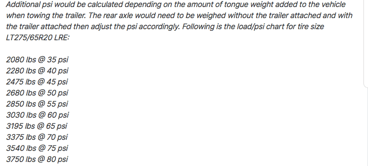

50psi?!
No wonder they are not wearing out. Most of the tire is probably not even making contact with the ground.
Good one!
My E rated tires are rated at 80 psi. The correct way of calculating the recommended air pressure of truck tires is dependent upon the load on the tires. I need to look up the recommended pressure for my truck and tires, but below is what I used on my old Tundra.
I think my Gladiator weight is about 5,500 lbs fully loaded. If I use the chart below, about half of that weight or 2,750 lbs is on the rear axle. So I should be running between 50-55psi. Of course this is for road use, and not for rock crawling. You lower your tire pressure to smooth the ride over bumps and gain more surface area for rock crawling.
I'd love it if someone could double check my numbers.

Thanks! Not near what I'd have expected

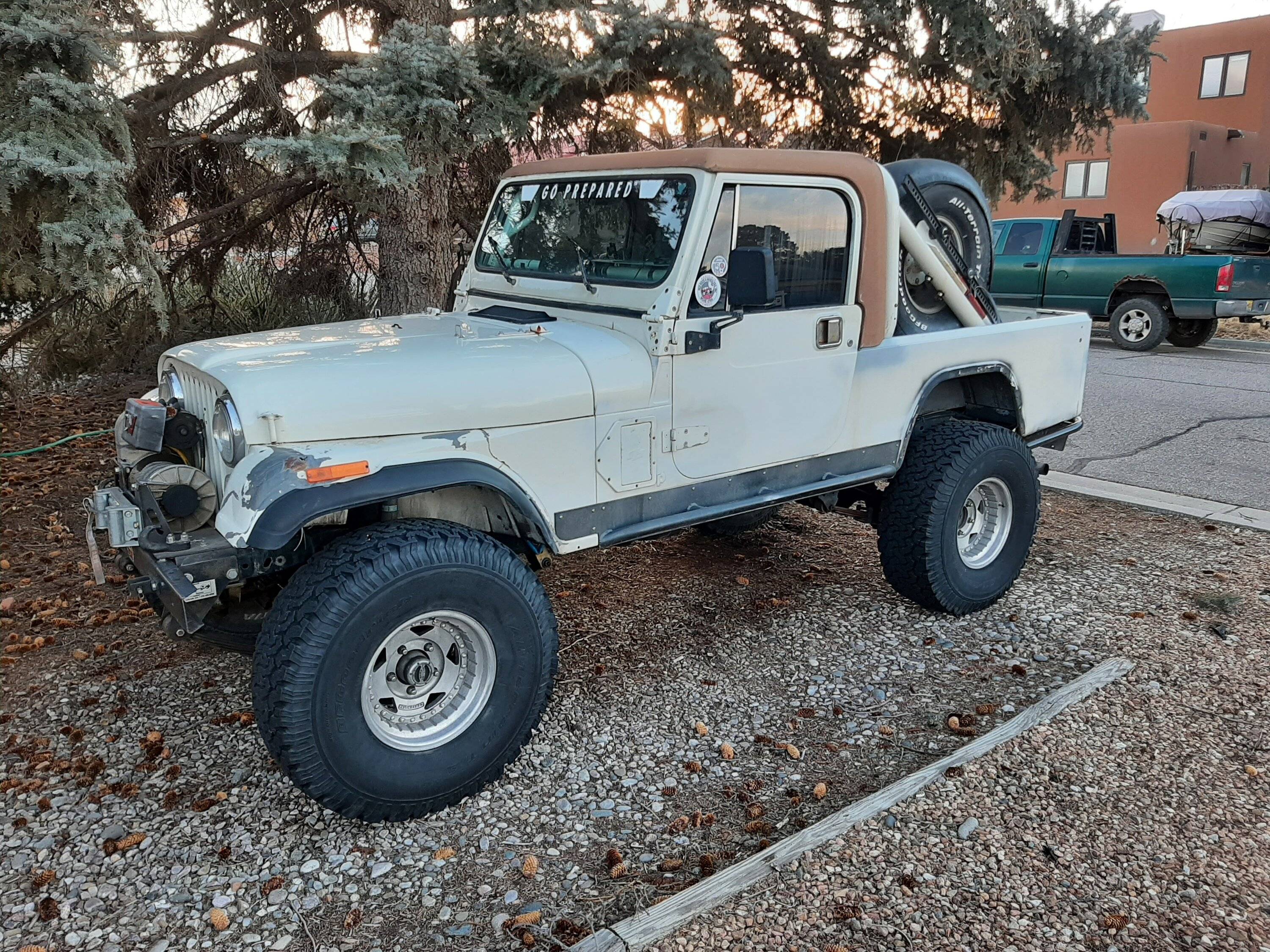

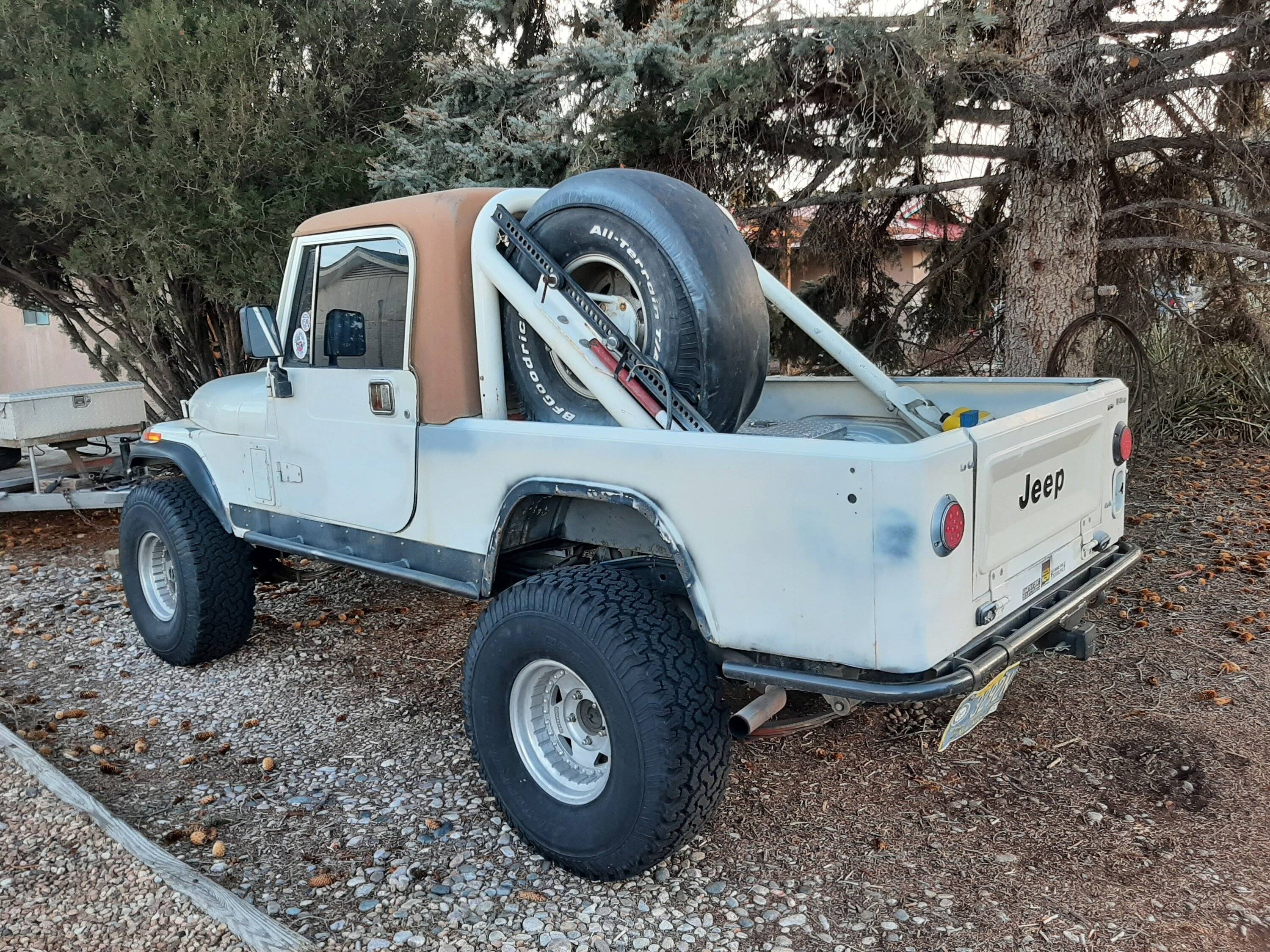

Ask and ye shall receive....
Nice ride. I've always liked Scramblers. I was hoping the Gladiator was going to be a 4 door Scrambler, but they put a full bed on instead.
