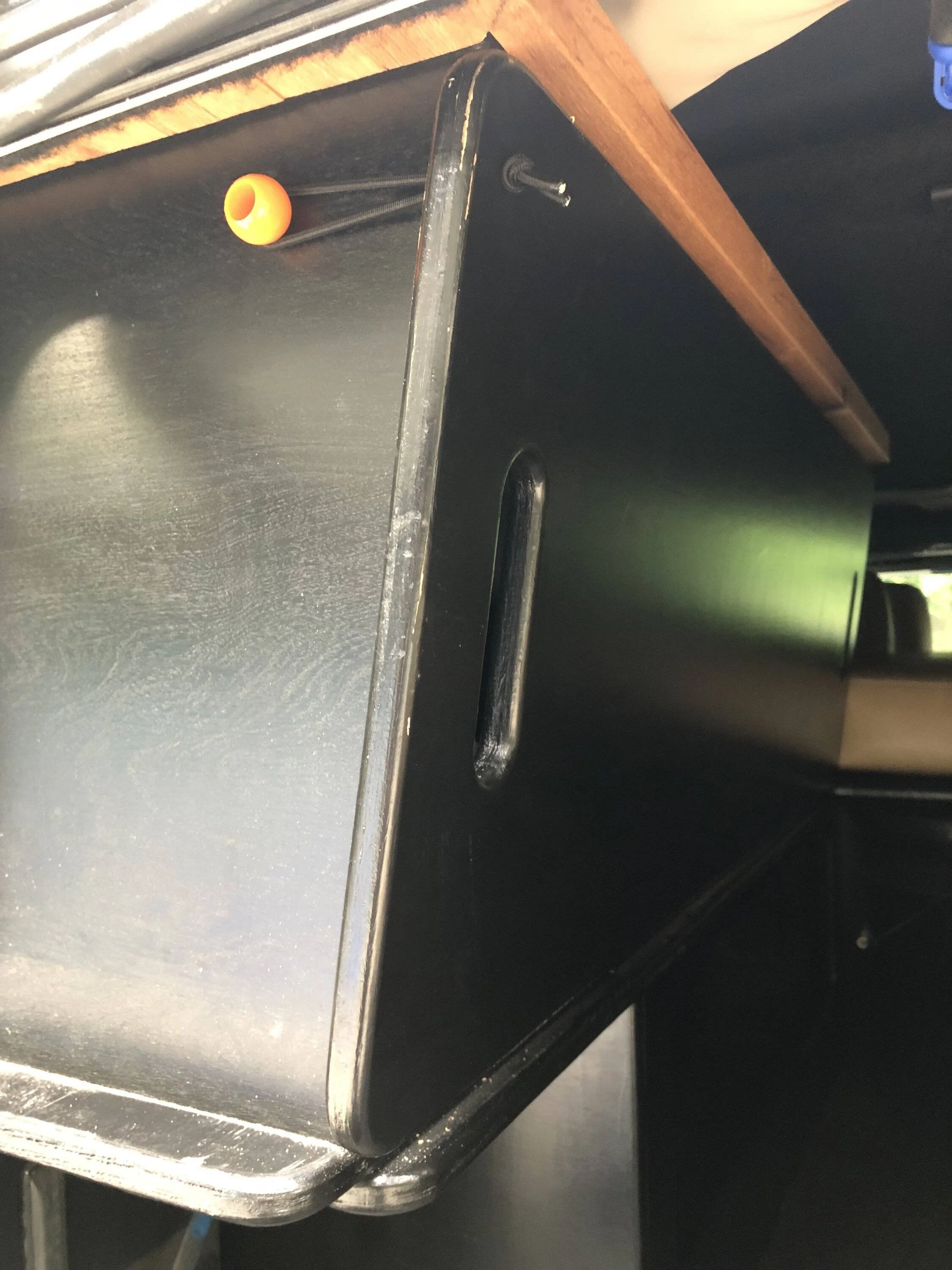

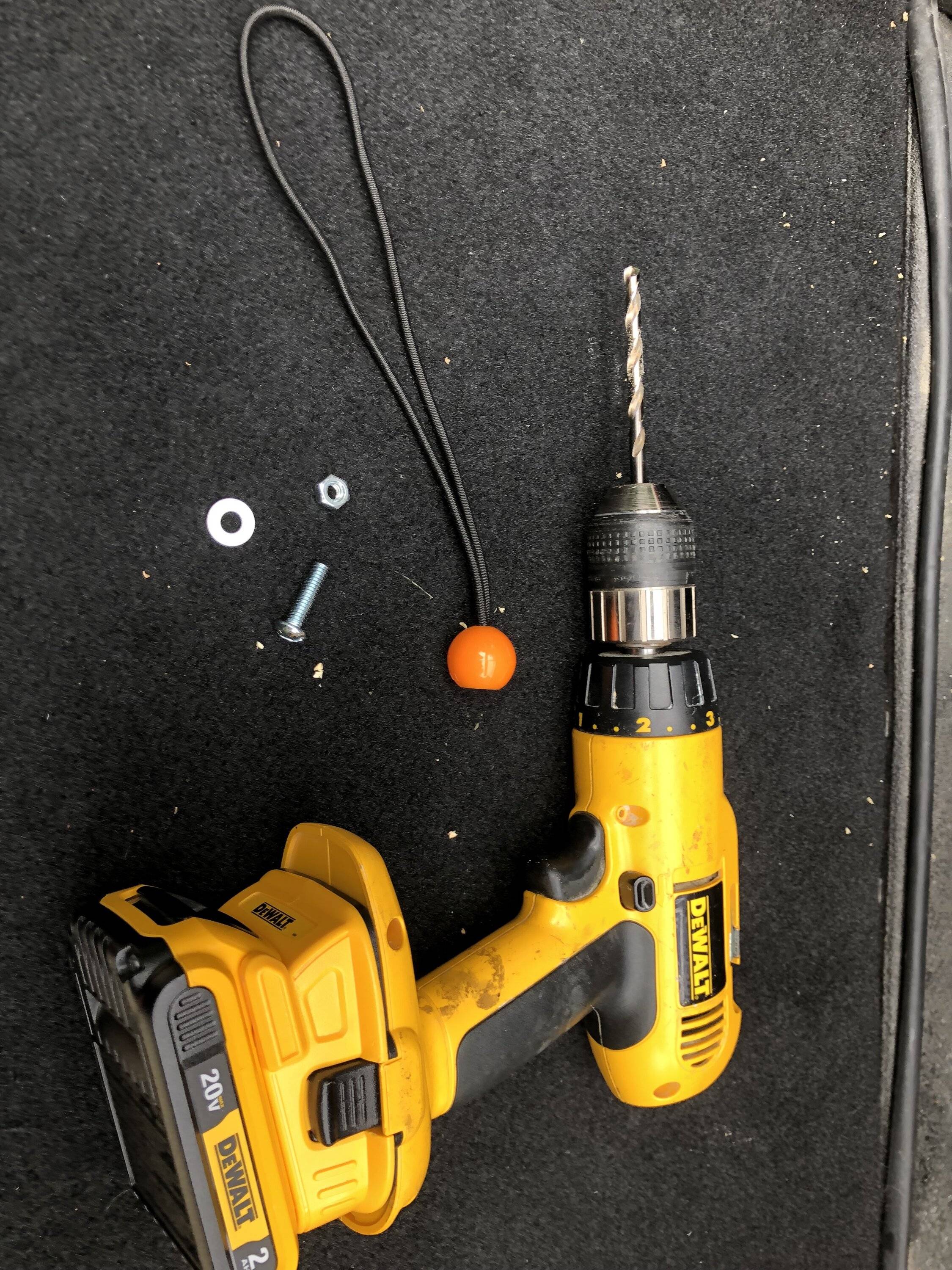

My cabinet door occasionally drops open or rattles while I'm driving. I didn't want any metal to catch my cushions when I lay the door down for a bed and I couldn't find a latch that I liked, so I made my own. I drilled a couple holes, used a "Bungee Ball" and a nut & bolt to make my own Bungee Latch. I bought the box of Bungee Balls at Walmart for $5.

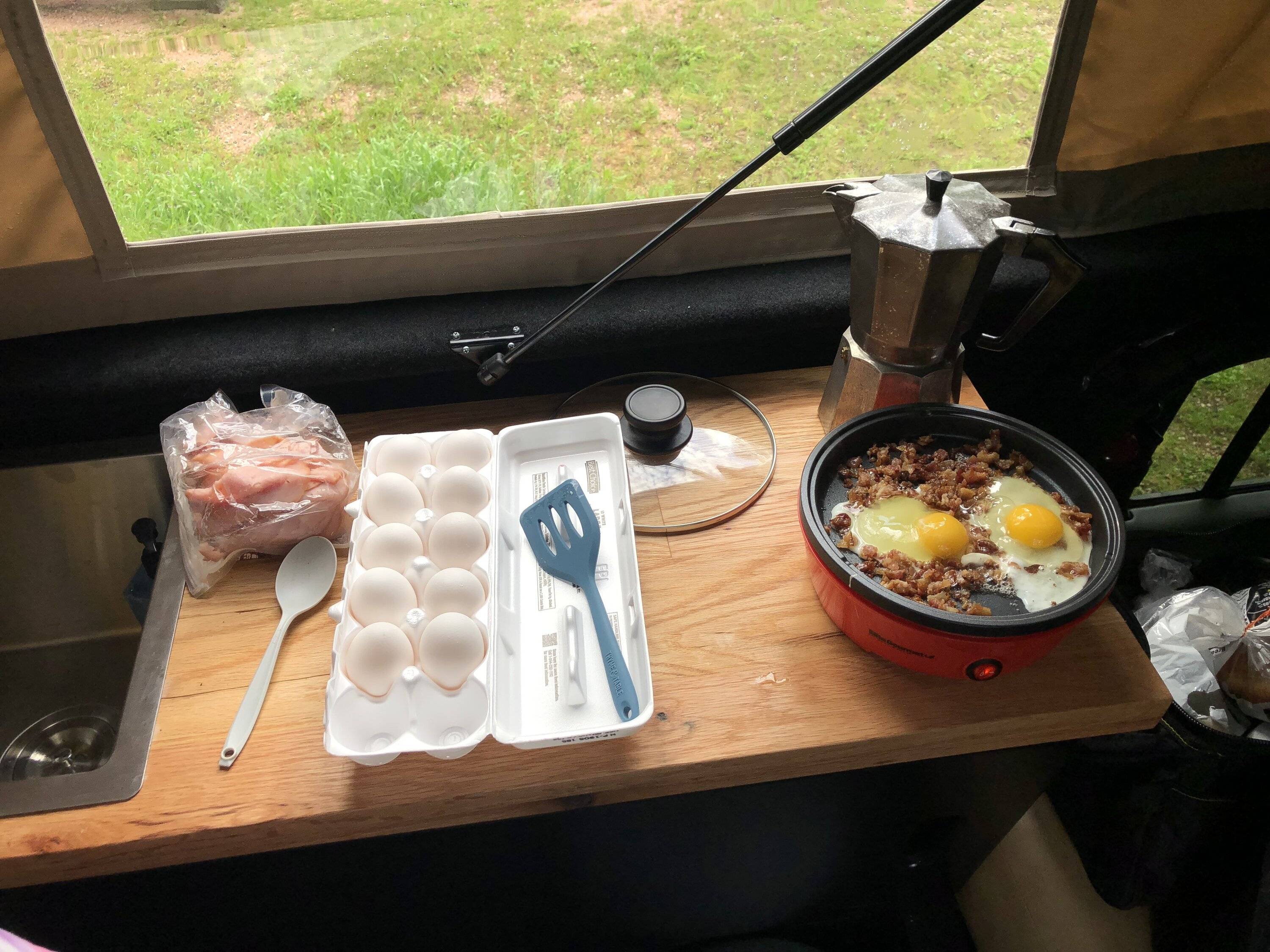

I tried out a new electric pan/griddle for my Yellowstone trip. It's 600 watt/120volt, and worked out perfectly with my small power supply. My little 600 watt hr power supply was enough to keep my fridge running continuously and to make coffee & eggs on the griddle in the morning.
The electric griddle is red in the picture below. It was large enough for my coffee pot, and even had a lid for cooking.

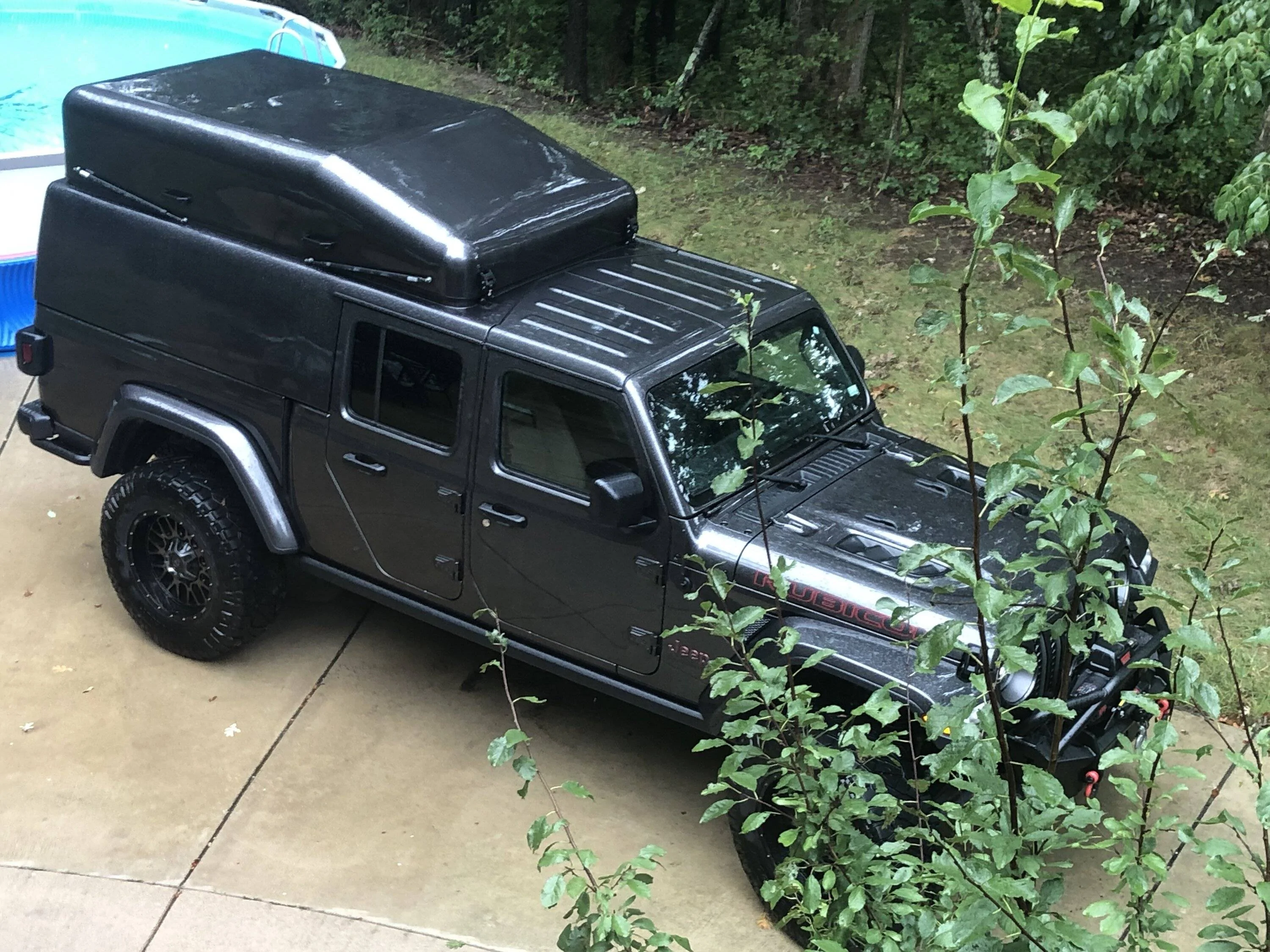

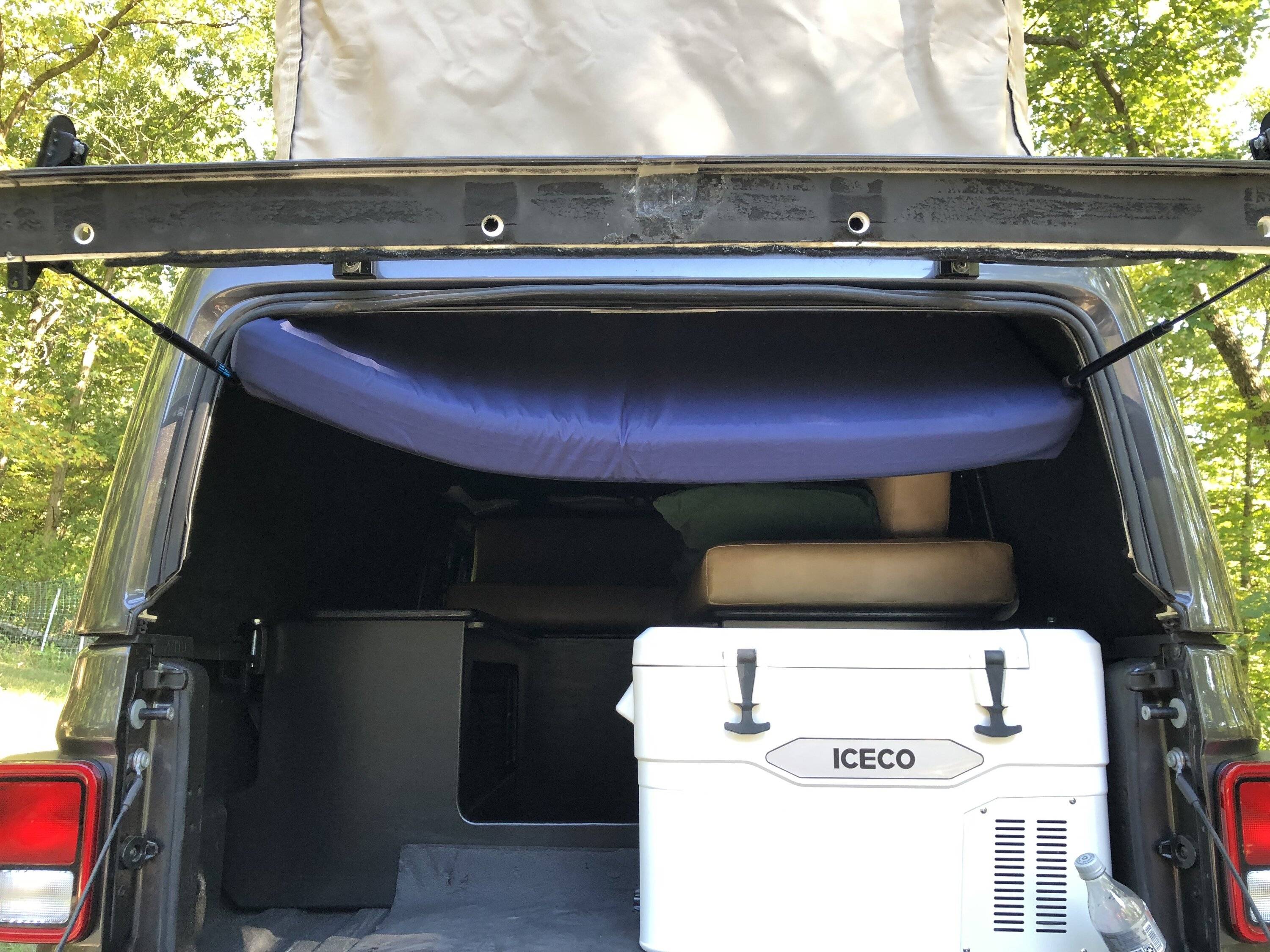

Here's an interesting breakdown on the weight, that I posted earlier.
Final weight of my camper's bottom shell, top shell, tent, and upper bed is 210lbs.
Keep in mind this camper replaces the original hard top and back glass, so the net gain is only about 150 lbs. I believe net gain for the Alucab is 460lb.
Camper 150 lb
Interior Furniture 80 lb
Fridge 50lb
power supply 20 lb
Misc camping stuff 50 lb
Total about 350 lb

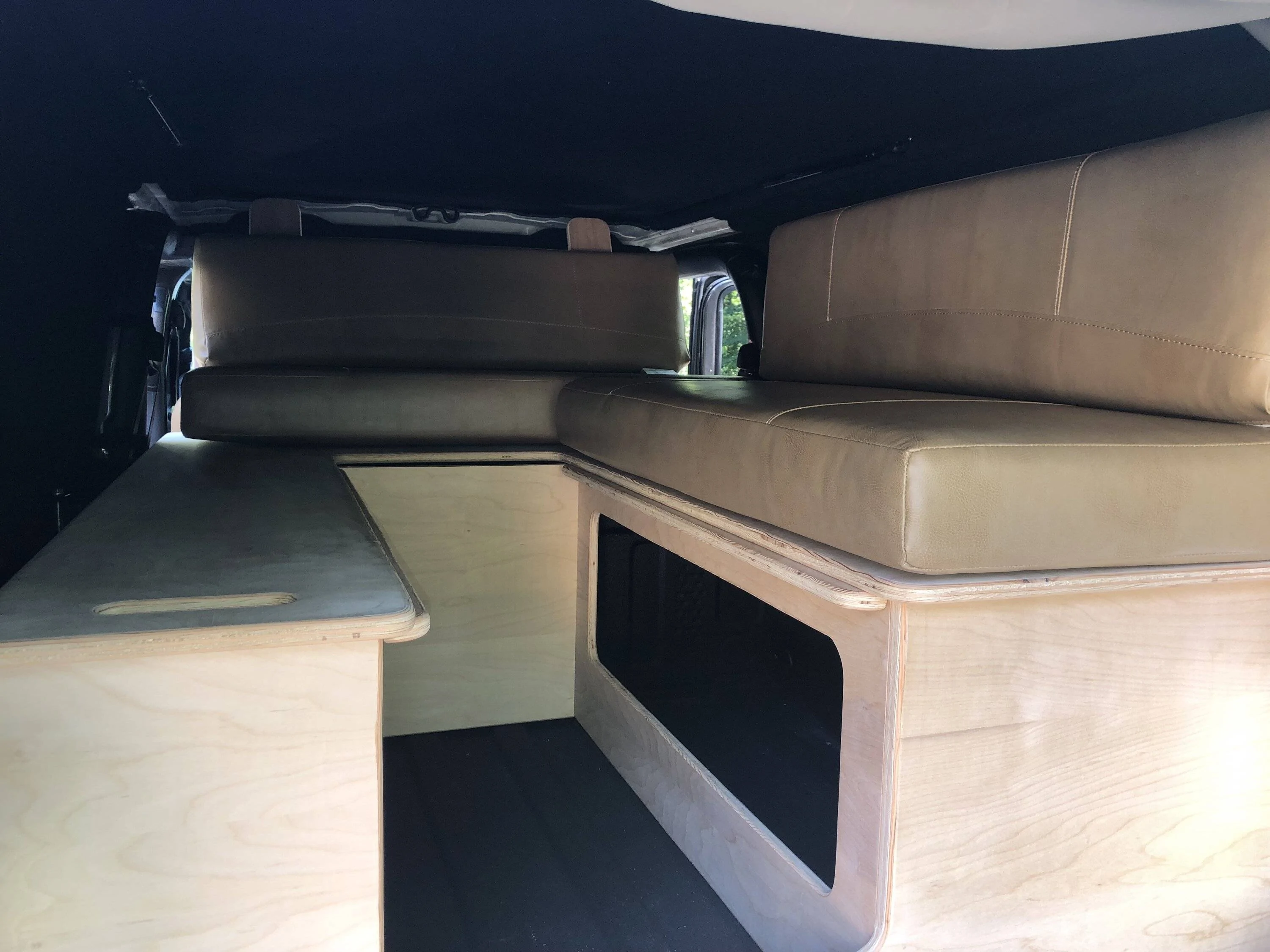

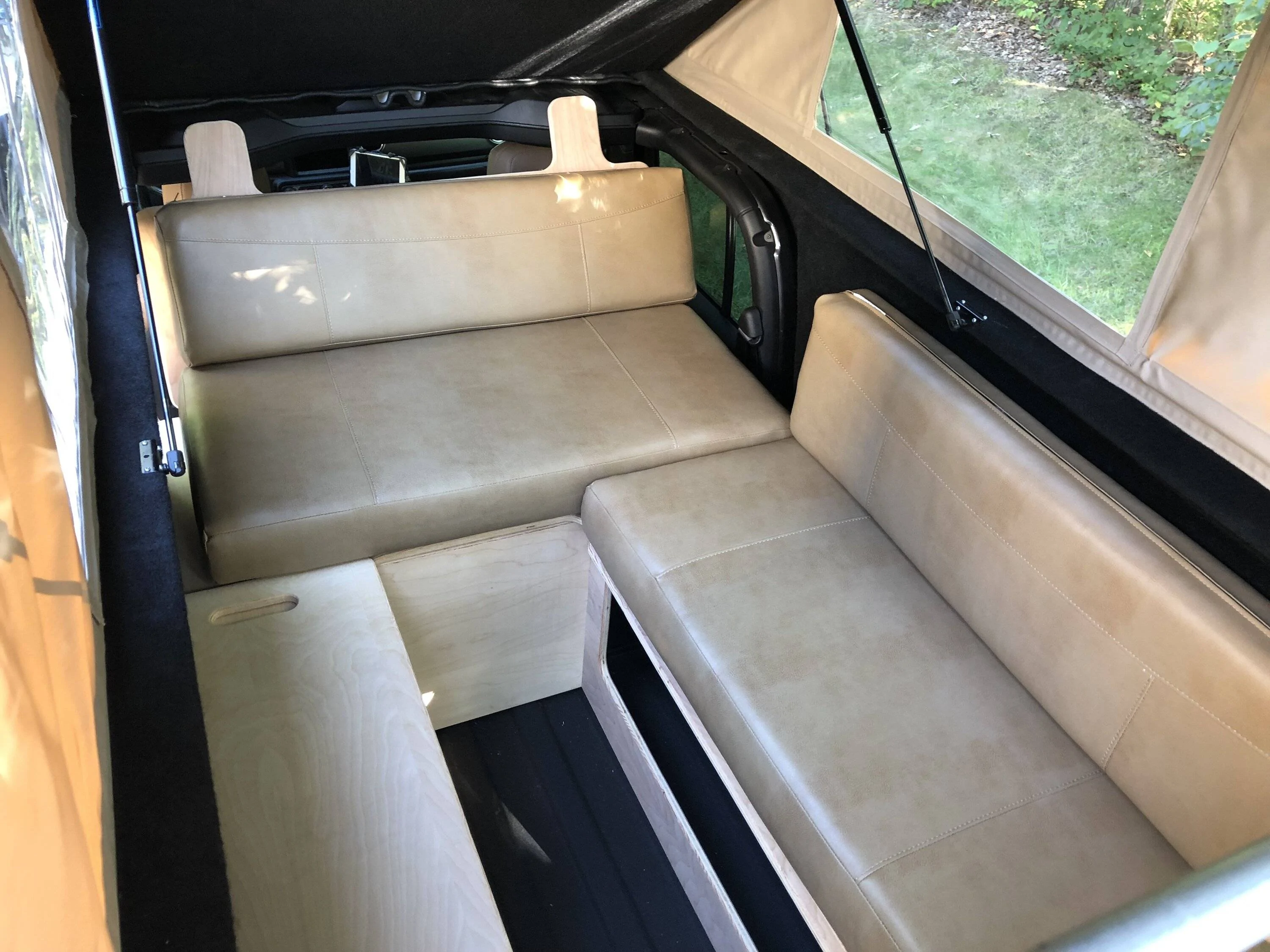

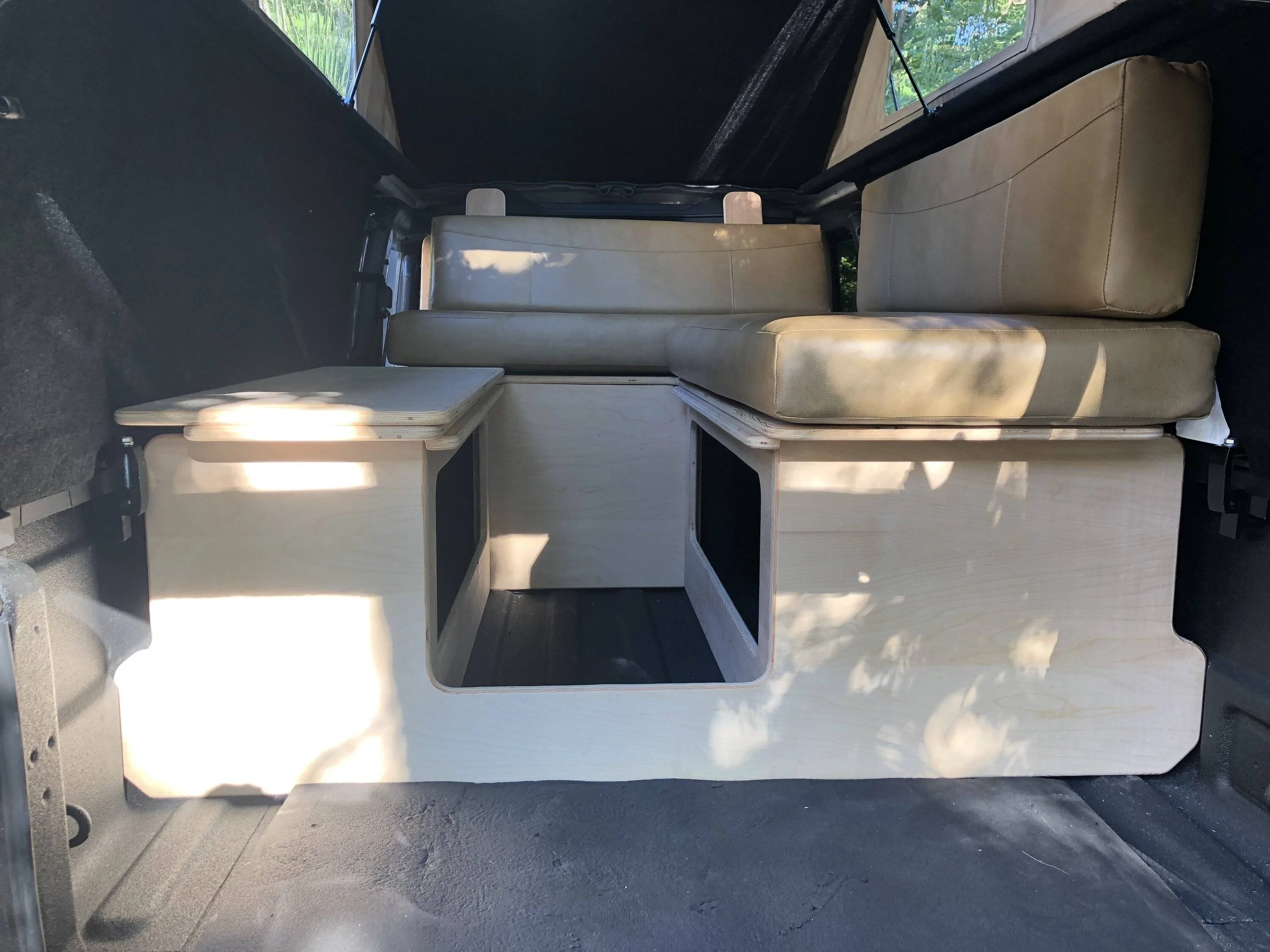

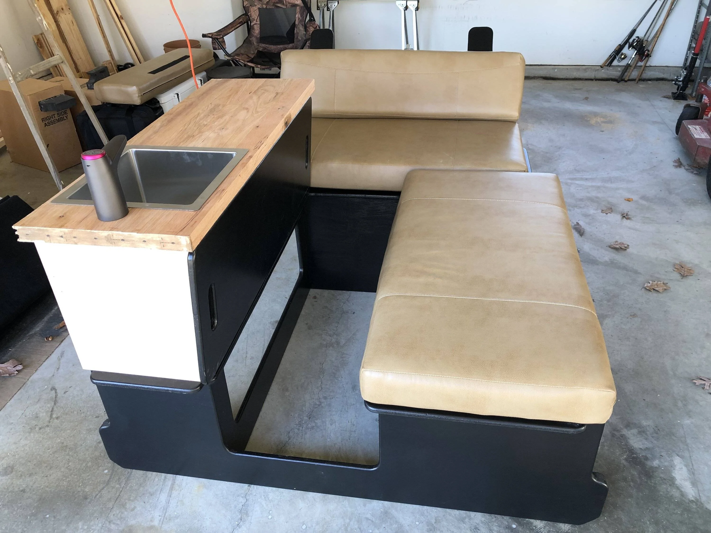

My furniture layout is light and worked out pretty well on my recent camping trip. I'm thinking about some improvements though.
1) Build a permanent location for the fridge
2) Balance out the weight, as I currently have most of it on the driver's side
3) Add pull out drawers to make it easier to get stuff in/out of the camper
I keep going back to Troopy layouts like Drifta's below. I might have another winter project coming up, to build a new interior!

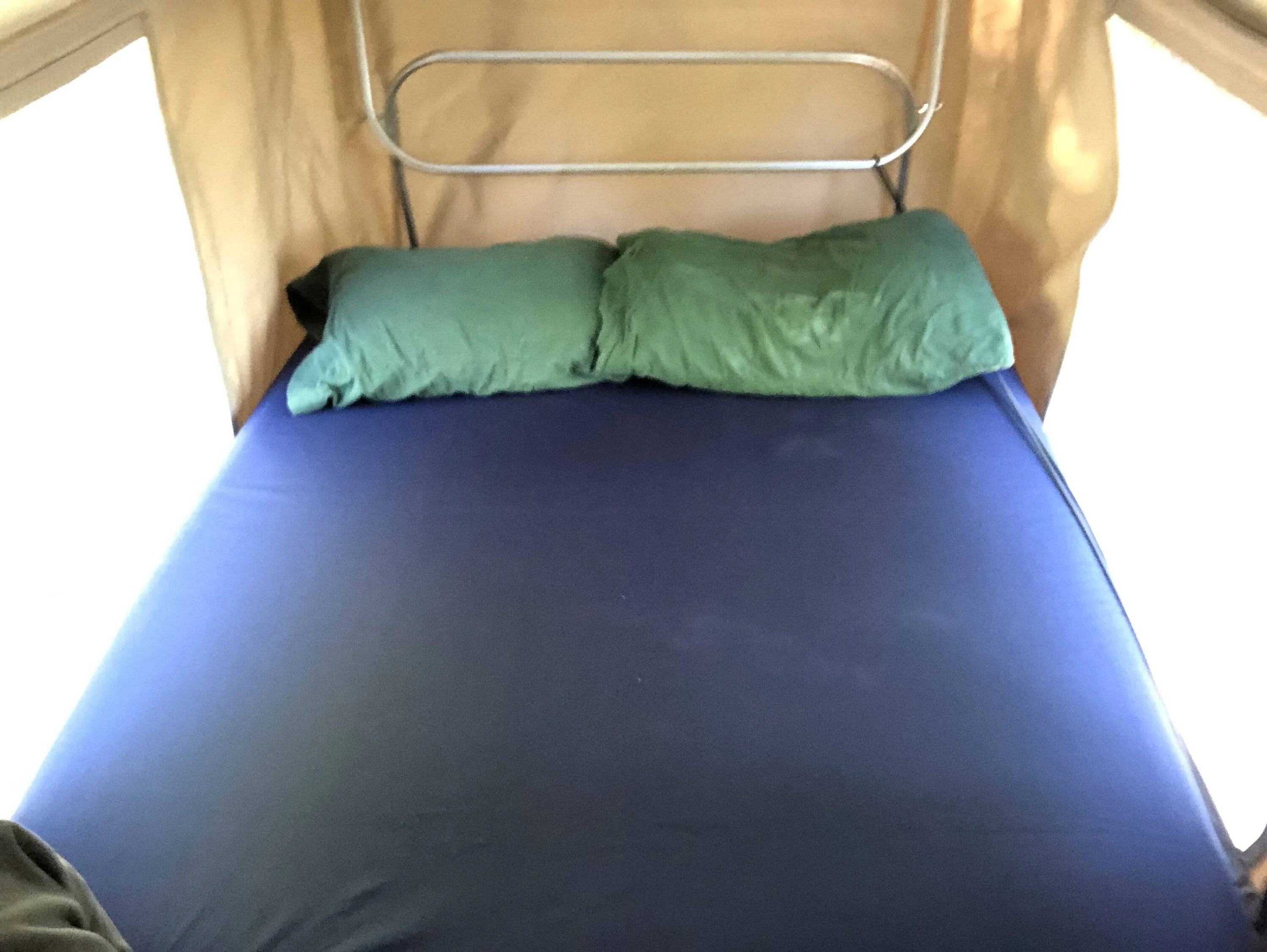

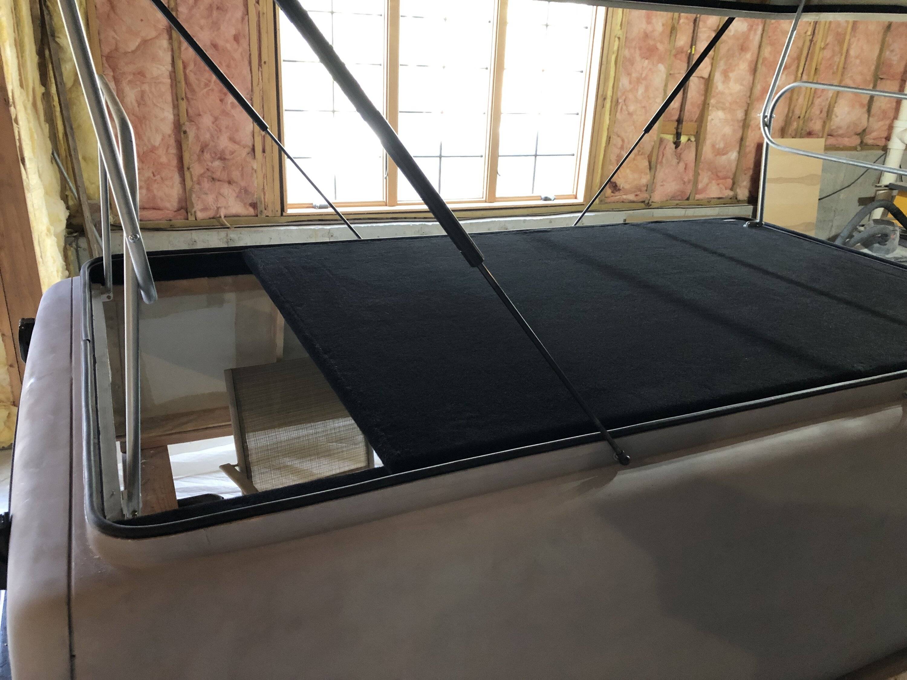

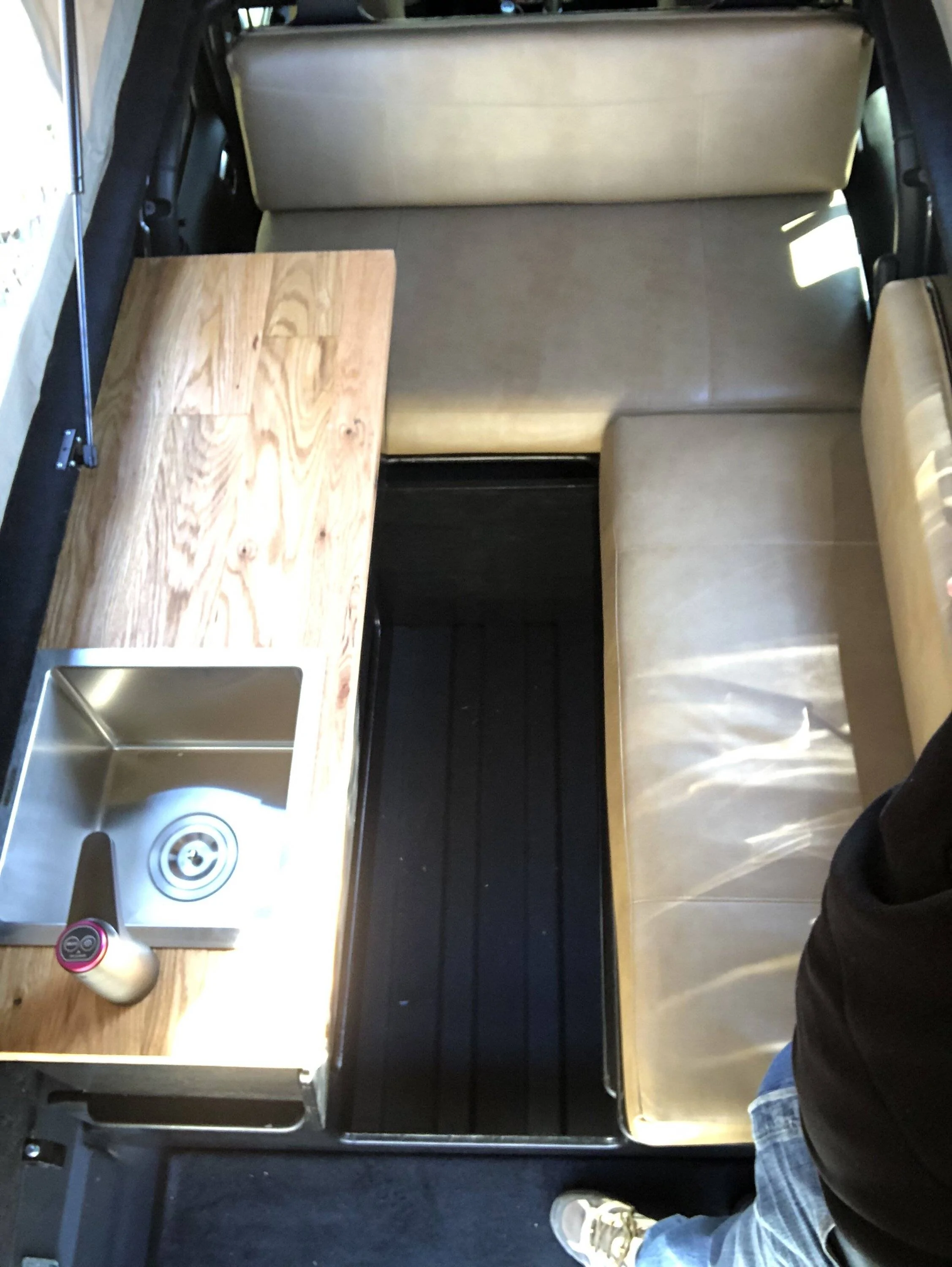

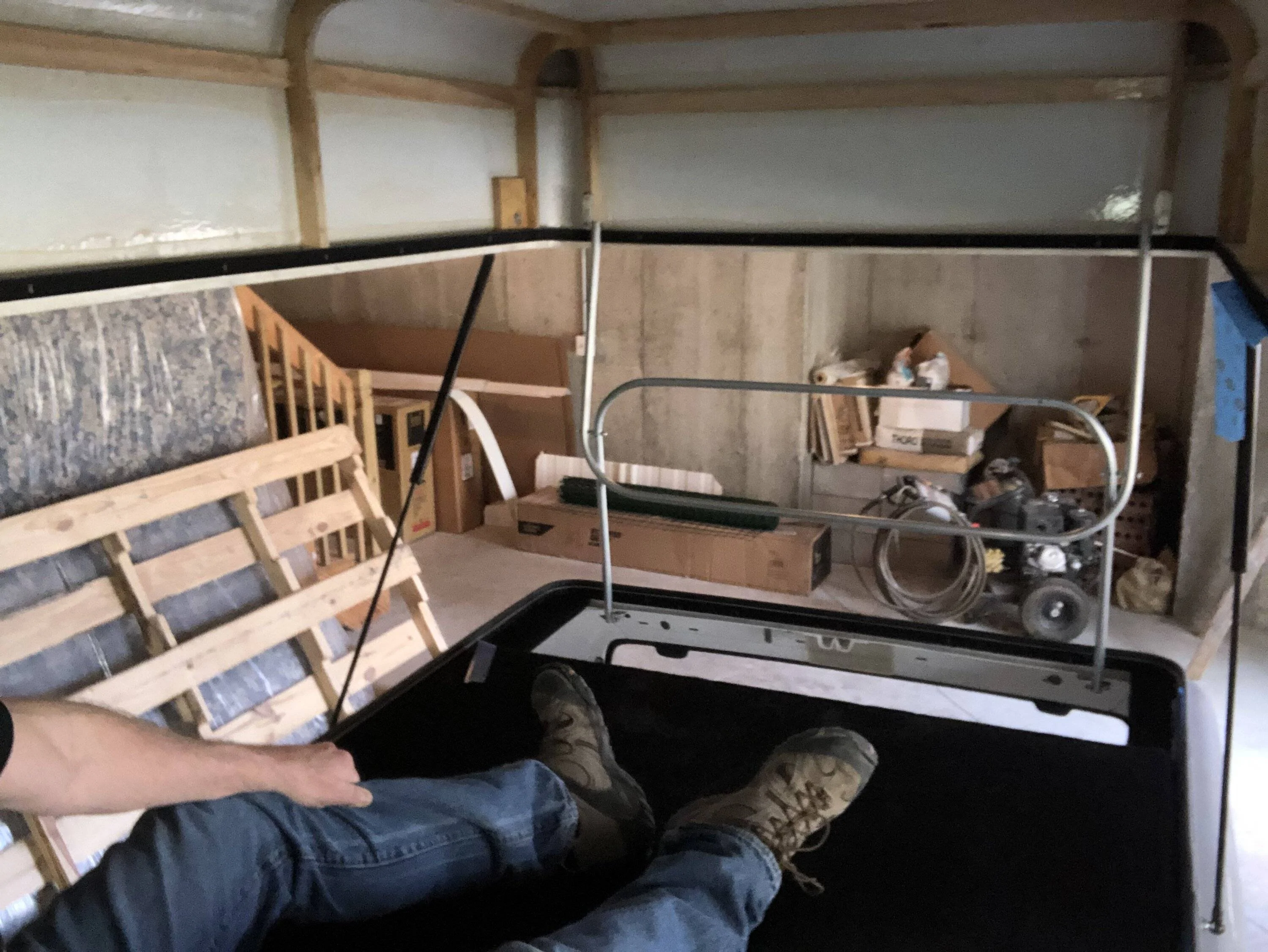

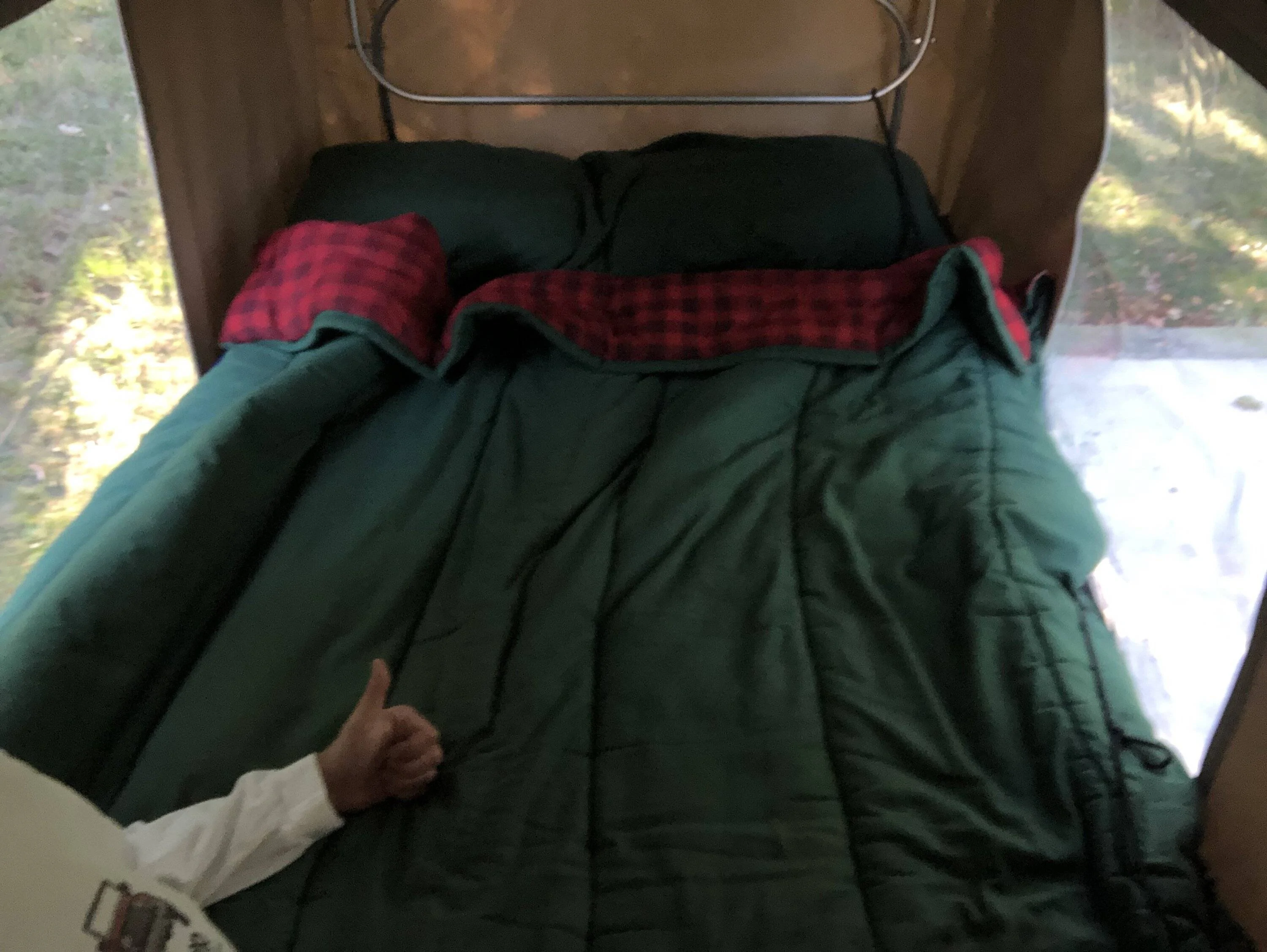

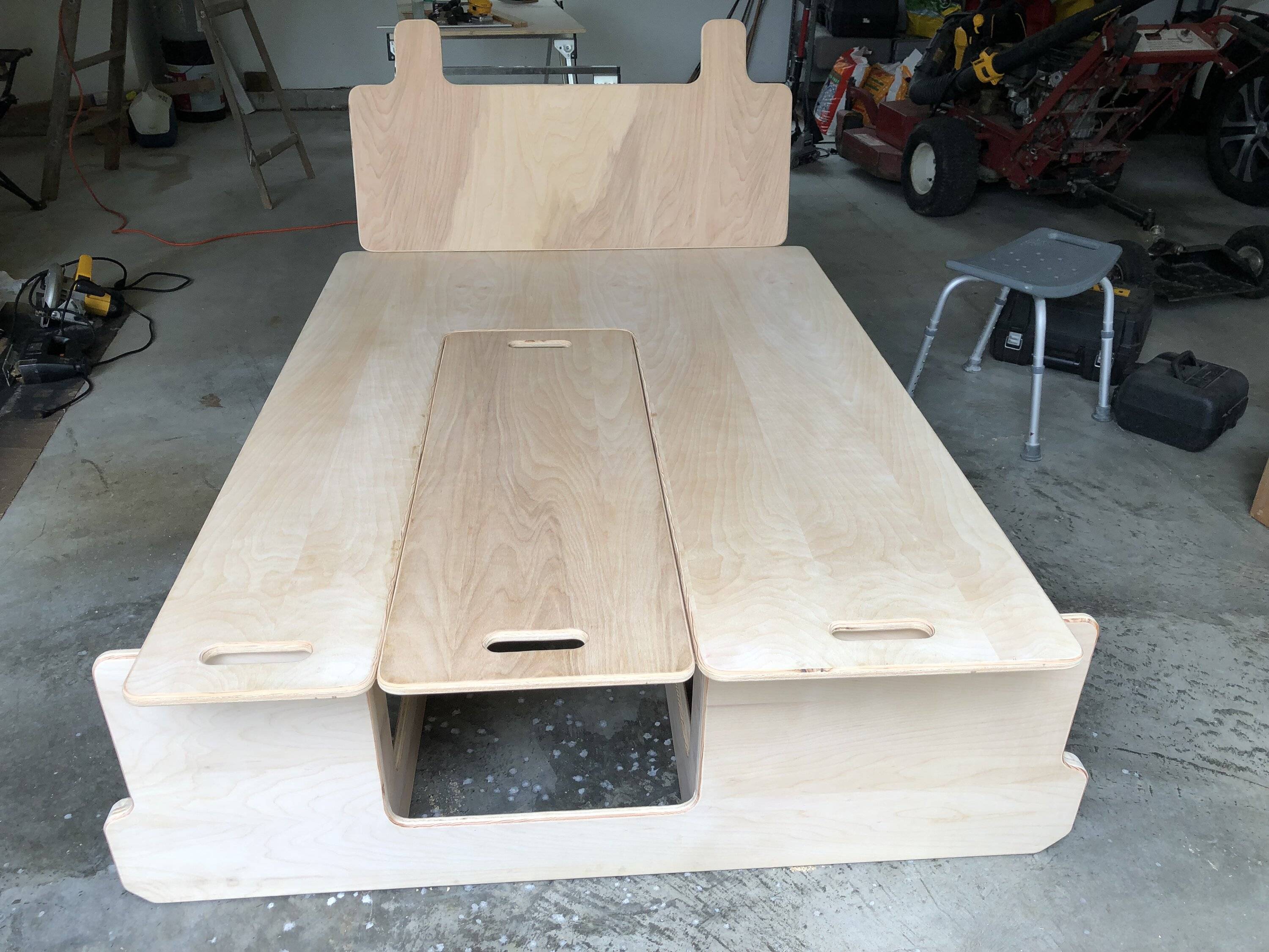

Here are some more pics of the interior. The upper bed platform is 4' wide and 6'6" long. The pass through at the back is about 18" wide.

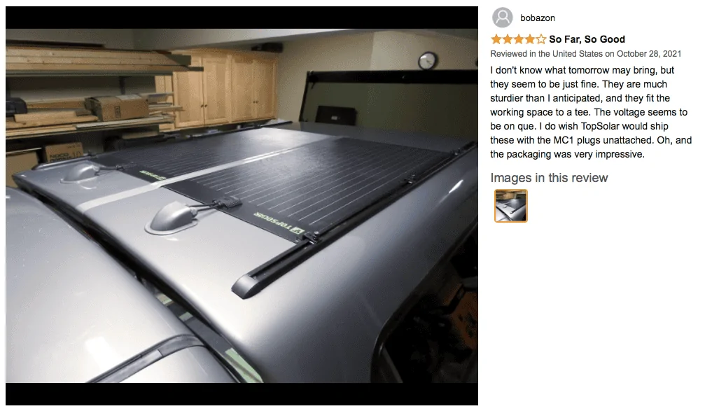

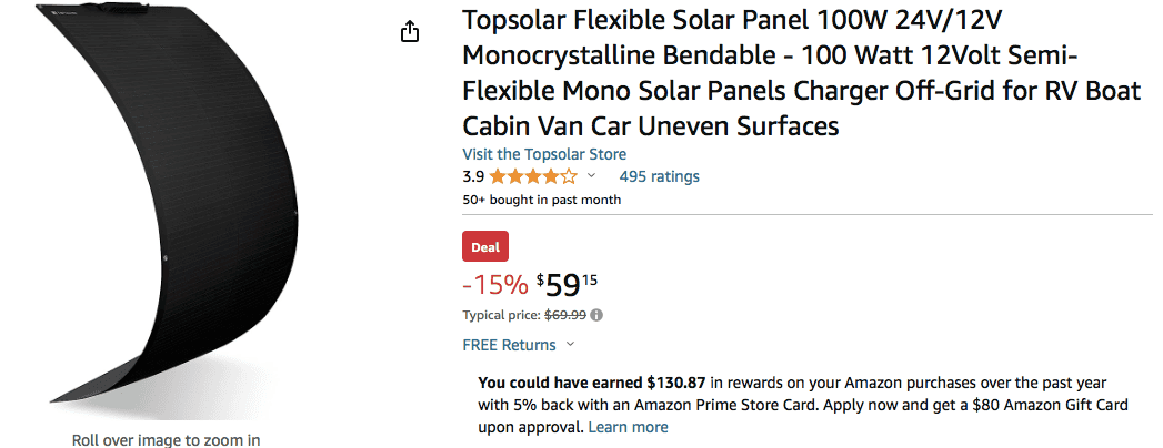

I'm looking at all that roof real estate I have.
Jeep Gladiator Gladiator Expedition Rigs IMG_9225
Has anyone just used 3M double sided tape to tape a flexible solar panel on?
Two Questions:
Will it hold?
Will the black solar panel burn my paint?
Jeep Gladiator Gladiator Expedition Rigs Screen Shot 2023-08-31 at 6.47.44 AM
Jeep Gladiator Gladiator Expedition Rigs Screen Shot 2023-08-31 at 7.13.39 AM
Two Questions:
Will it hold?
Mike a few years ago I had 2, 100 amp solar panels taped to the roof of my Hallmark expedition camper (from the factory). They lasted about 2 years before they literally cooked themselves due to not getting adequate airflow across the bottom. I subsequently went with solid panels on short L shaped risers and have been happy since.
I have seen some people having success with flexible panels where they use plastic corrugated cardboard like you see being used for yard sale signs to provide channels to allow airflow under the panels similar to this…

Apologies if you've already provided but any info on that amazing bed bench and kitchen set up would be much appreciated. Custom? Reminds me of the bam beds but better.

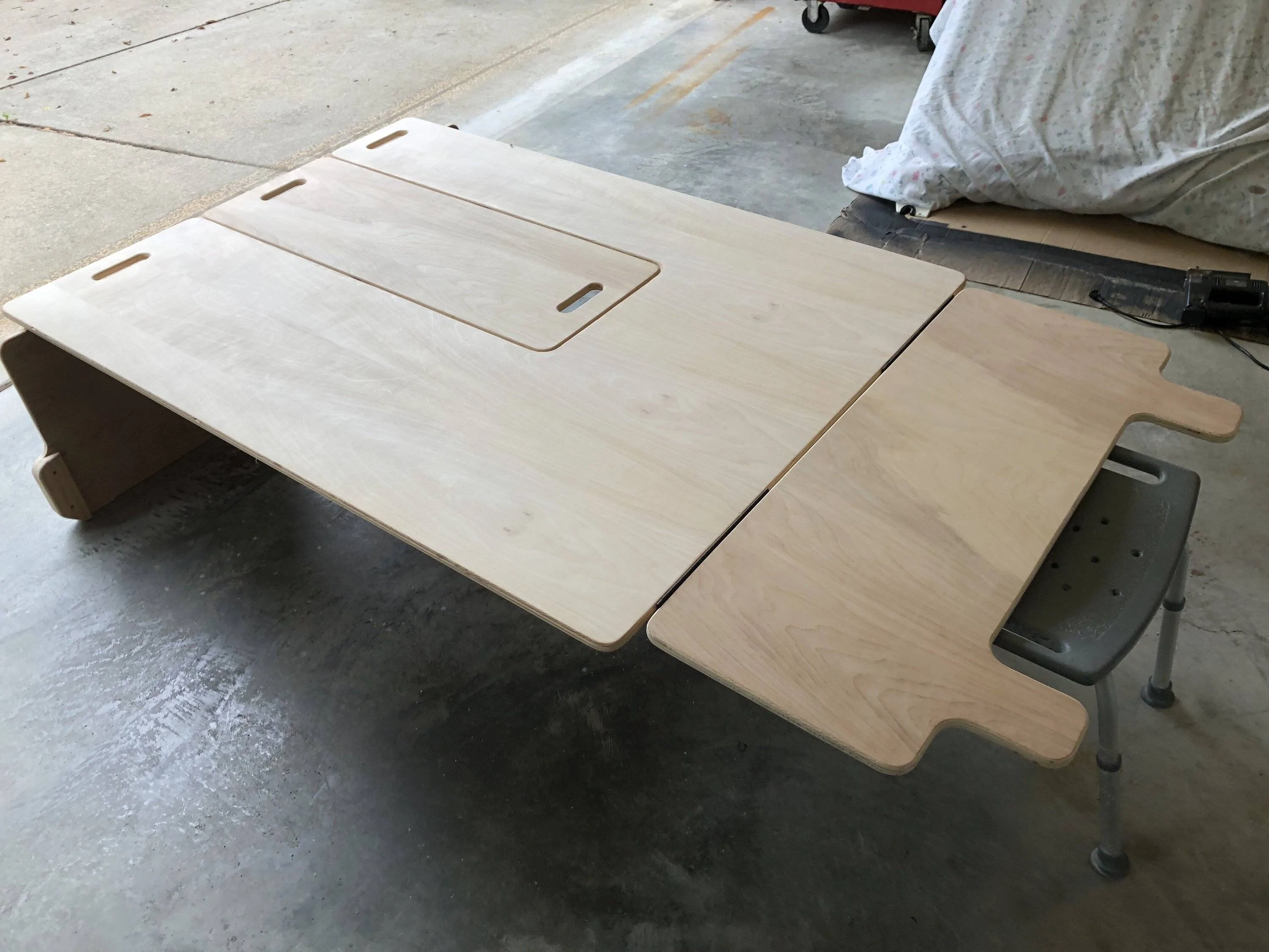

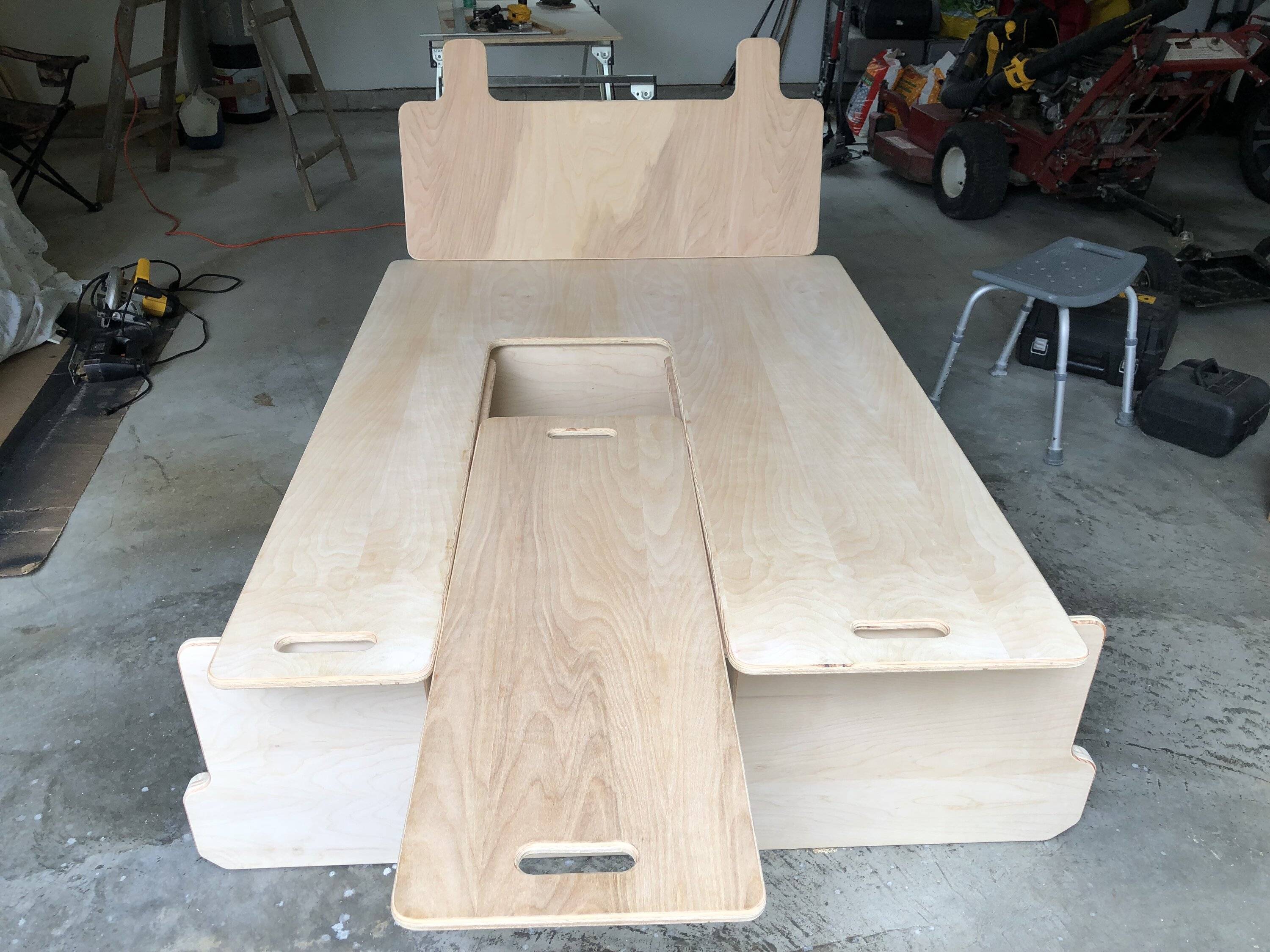

Thanks, if you go back to page 57 & 58 of this forum, there's plenty of pictures and posts of me Mocking up and building the furniture. I kept it strong and light, and I can remove it in about 10 minutes, if I need to haul anything in my truck bed.
