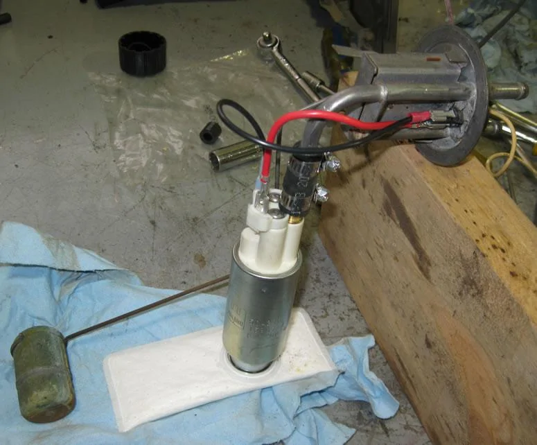

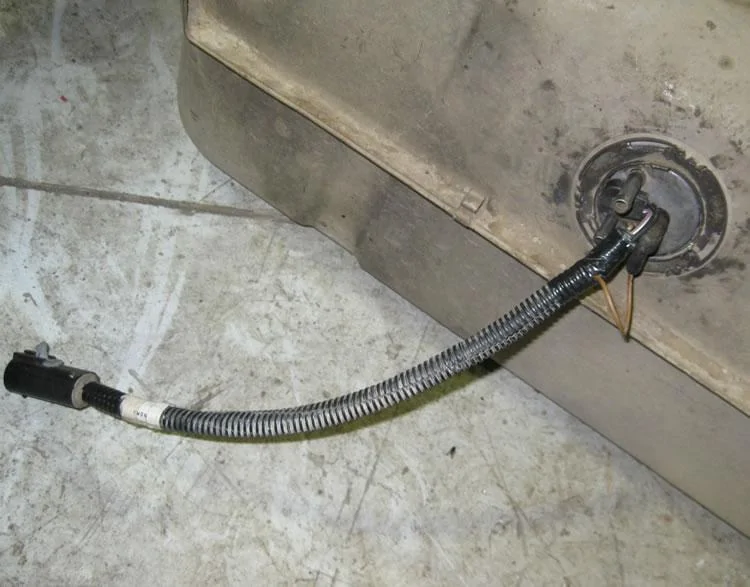

The fuel filter is mounted underneath just ahead of the tank, like the ZJ it came out of, I modified my sending unit to hang a Jeep fuel pump in the tank, and used the Jeep tank harness to connect to my vehicle wiring and ran the pump control wire from the PDC back to the tank harness.

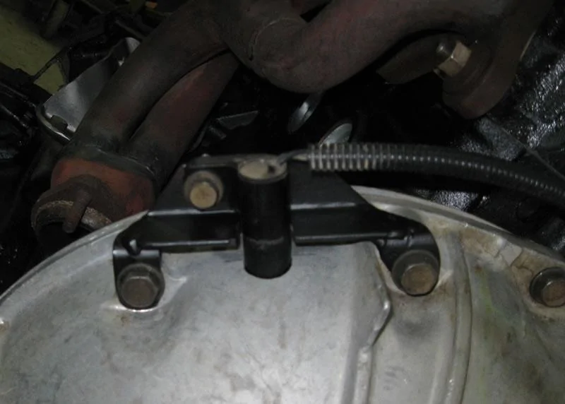

I made a template from the donor Jeep's automatic to locate the flywheel sensor, drilled my T5 bell housing and made a bracket to hold the sensor in the correct place and depth.
