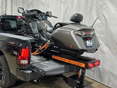

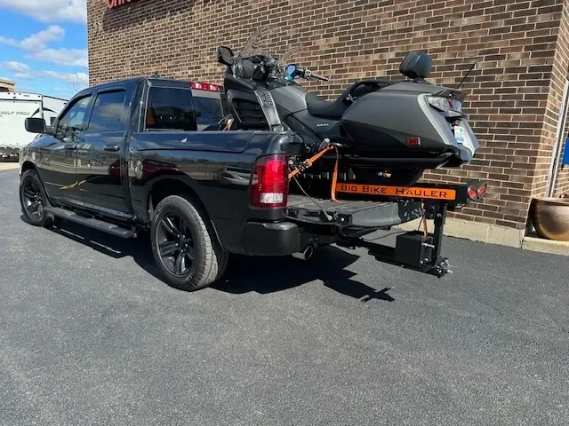

A lot below, short story is worked well. No issues with wind, went over mountain passes in several states. It’s about making sure the tow capacity of the RV is heavy enough for weight of gladiator/bike, having the proper specā€˜d tow bar for wieght of jeep/bike, and keeping as much weight as possible off the back of the truck bed.
it squatted the back shocks more than I wanted, but never rubbed. Took it slow over bumps and gas station driveways. Expect much better with 33ā€ or 35ā€ tires.

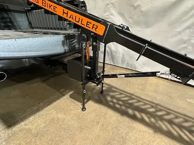

Initially wanted a bike lift on back of RV but 5 of 6 local weld shops do not install anymore for liability reasons saying hard bump, etc lift may break off RV, too much potential of catastrophic results for vehicle behind you. Likely voids chassis warranty on RV. My insurance is outstanding with Chubb and they couldn’t guarantee coverage from a lift failure. Too bad, I really wanted a lift. The last weld shop does the lift but at least for me it wasn’t worth the stress.
Many months of research ended with Loadall brand ramp system. They have a model specific to the gladiator’s 44ā€ width between wheel wells. https://loadall.com/products/jeep-gladiator-1
pros:
1/3 the price of hydraulic lift (I’m including $3.5K-$4K install quote)
1,300 lb capacity. My bike is 925 lbs
No weight on tailgate
Bike weight is distributed evenly on ramp platform, touch points on the loadall to truck bed is very front of truck bed, over the top of the axels, and near the back of the truck bed.
Drive bike up a wide 44ā€ ramp
Good ramp traction even when wet
When bike is out of truck, the ramp slides forward so you can close the tailgate.

Heavier at 240 lbs
I’m 5’ 8ā€ and at apex of ramp, my feet don’t touch the ground. On my flat driveway and with 37ā€ tires and 2 1/2ā€ stock Mojave X lift… ramp is steep. Scared the crap out of me and my wife first time. 2nd-10th time easy to find a slight slope or hill somewhere that made it very easy and not scary. Probably ok if over 6’ tall person.
Drilling 4 holes for bolts in the truck bed
Took about 4 hours to assemble and install, putting nuts on bolts while laying on the ground was tight but doable.
Don’t want ramp in bed when not doing a bike trip, so have to disassemble everything (30 minutes). Reassemble is also only 30 minutes.
My tonneau cover was an inch too fat, had to remove for the trip but only 2 bolts, 10 minute job.

Your gladdy looks a little grumpy with the bike on the back, squatting in the back
