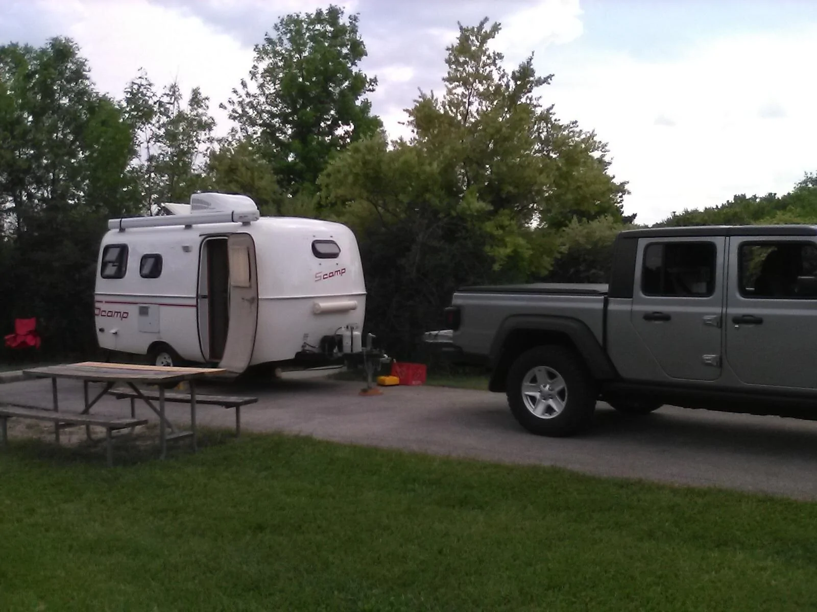

I pull a Scamp and have sumo springs, only I put the sumo's on the JT not the trailer.:idea:
Jeep Gladiator RV Towing 1621627028835_IMG_20210521_155630

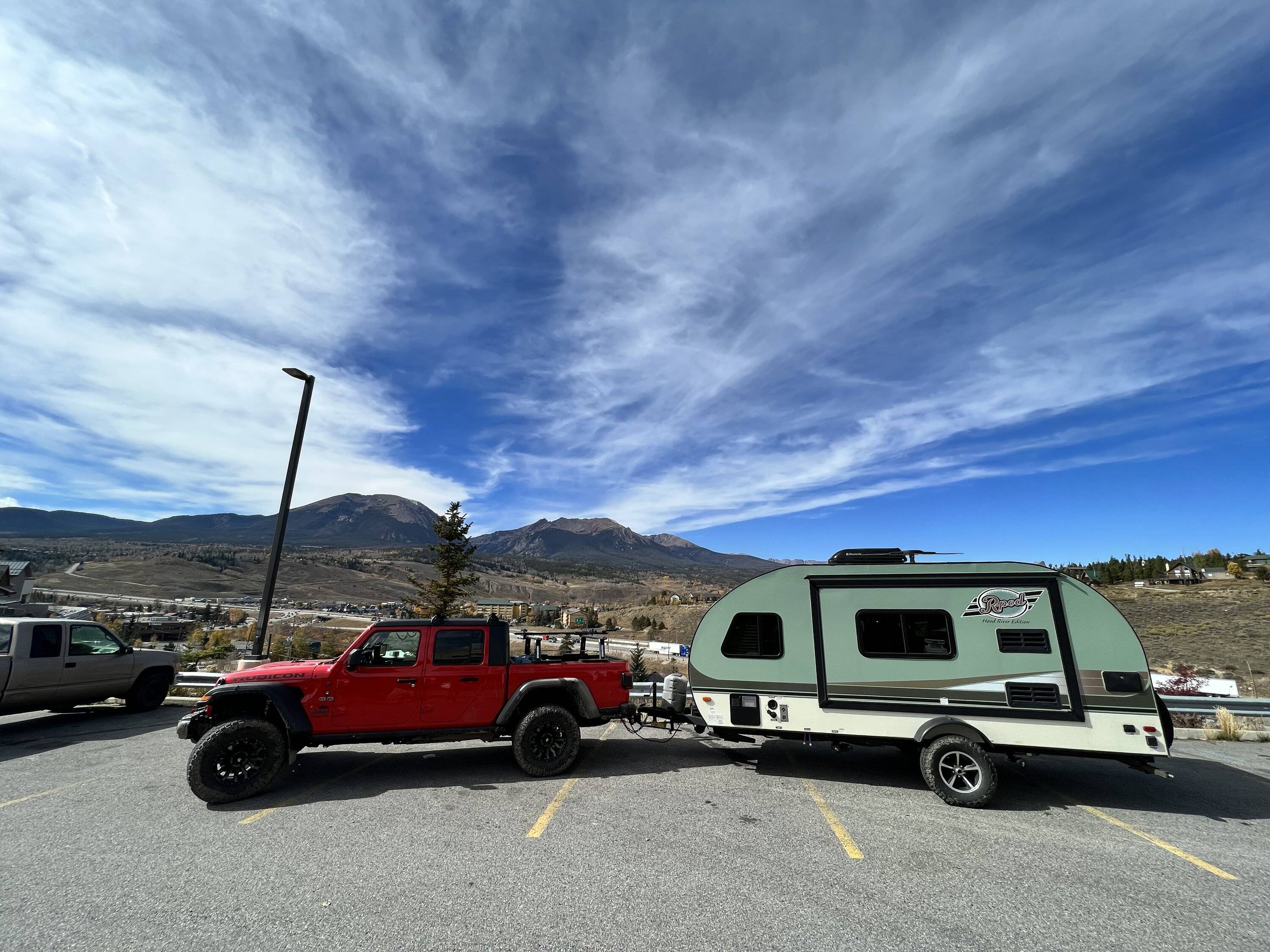

If it’s you and your wife and want a super nice camper, get an RPOD.
I have the 189 it’s dry weight is 2950

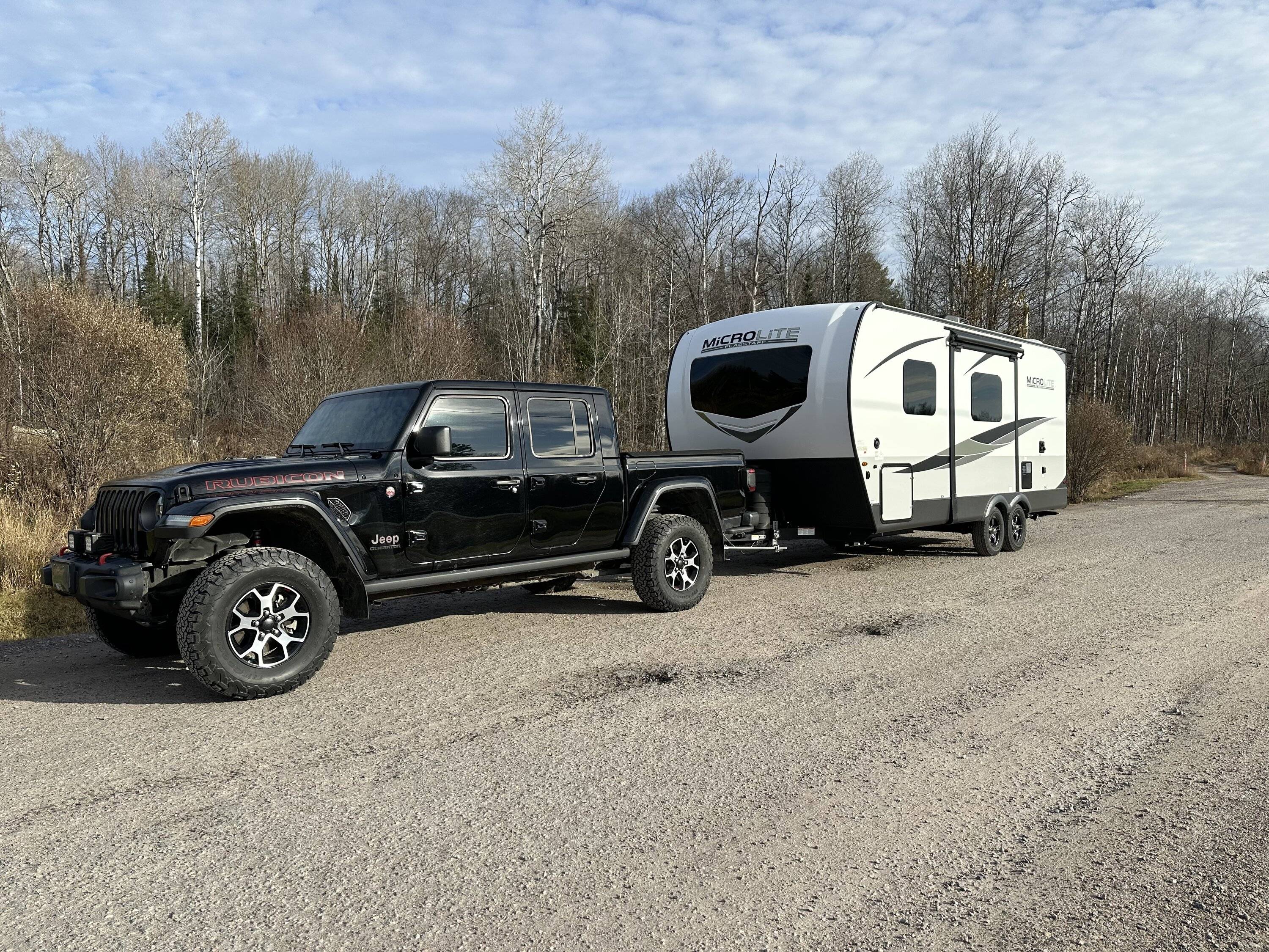

6006spd
Dave
Sep 14, 2021
91
85
Walford ont Canada
2021 gladiator
Self employed
21 Rubi eco diesel 23 flagstaff 22 ft , husky centreline Wdh, red arc trailer brake set up, fire stone 1000 bags In The back, tows perfect, for me no issues we travel light, only 5 gal water in tank for on the road for potty stops everything else empty, trailer 5100 lbs about 5500 on the road as most have said really windy day stay another day at the camp ground other than that, roll on
Jeep Gladiator RV Towing IMG_2123
