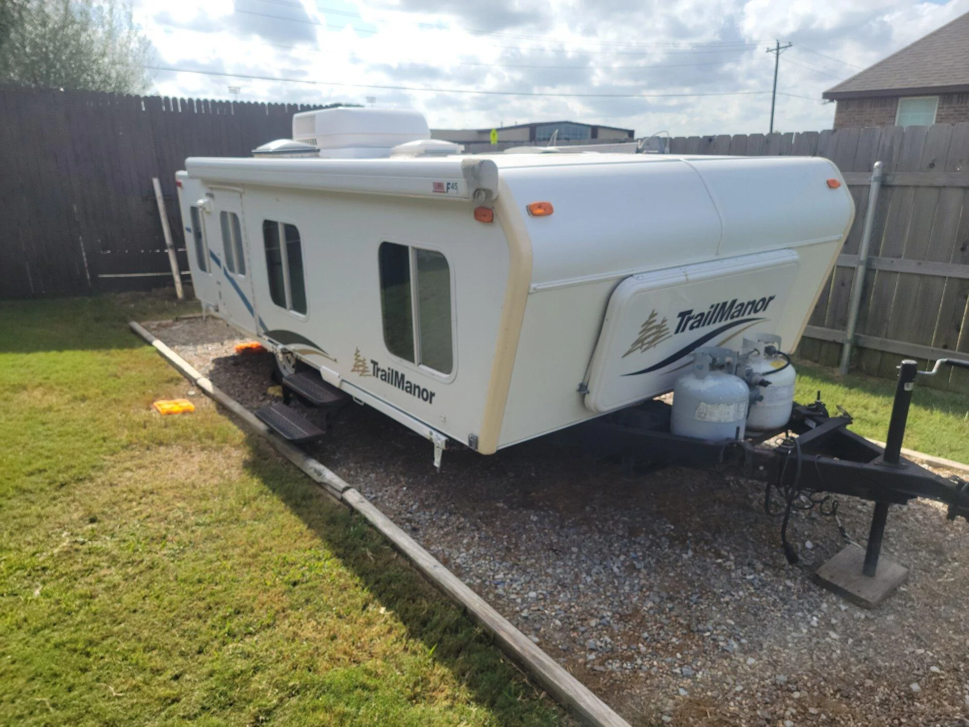

Hi there,

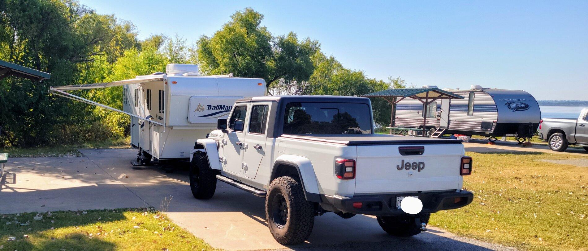

I just ran across this thread and may be a little late but we have been towing a Trailmanor hard sided pop up. These things are amazing, 3800lb, no sway and everything you need. Just thought this may be helpful.

I am a big fan of Trailmanor. I am going to buy an Airstream, but TM are awesome little trailers.

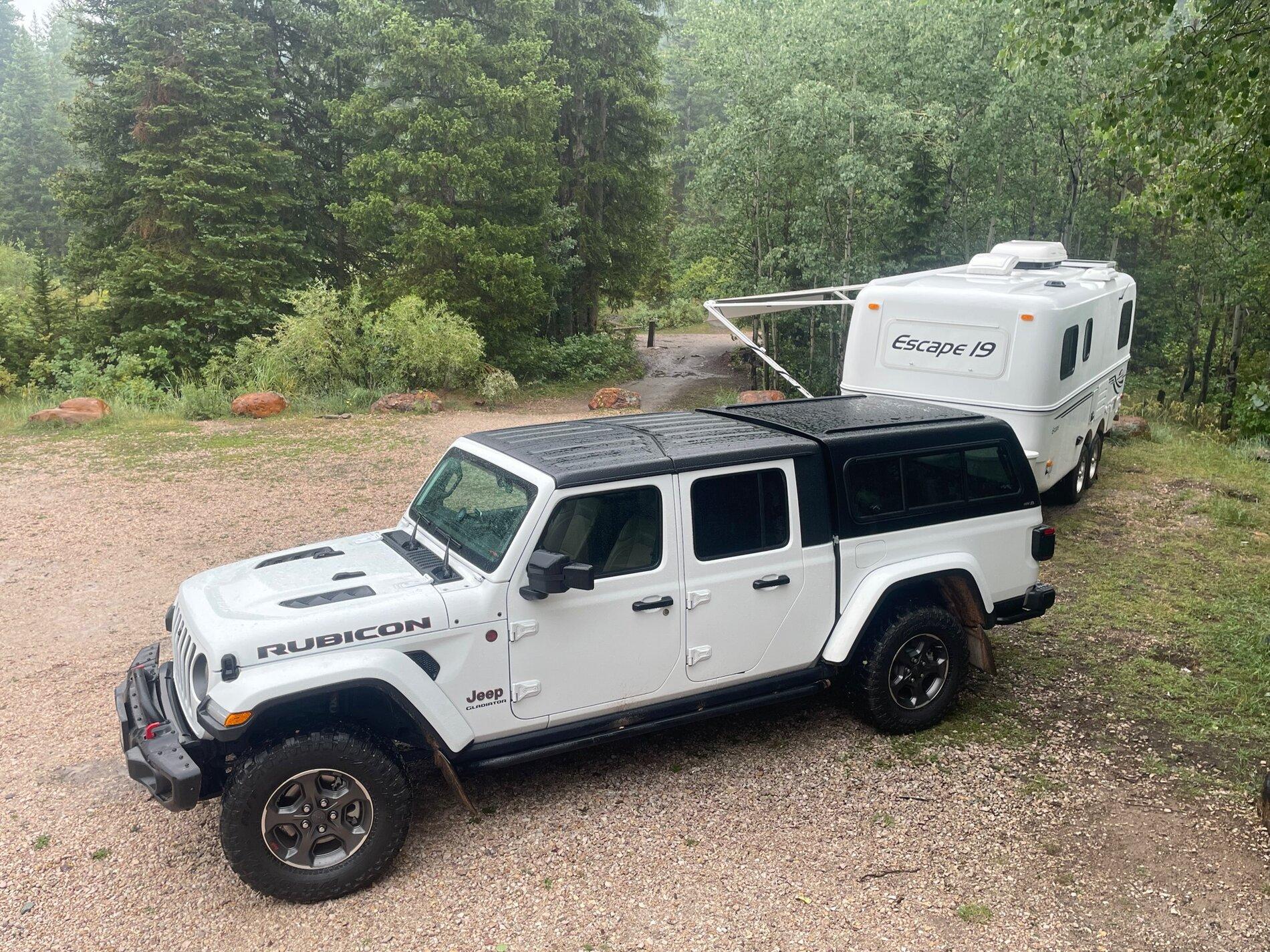

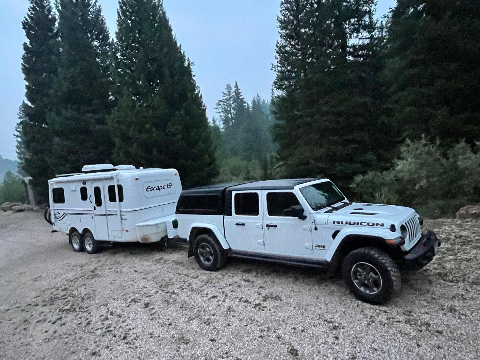

I'll add my experience towing... We wanted to stay within 50-60% of the JT's towing capacity. We have an Escape Industries E19 fiberglass trailer which weighs 3,802 lbs with fresh water and propane tanks filled. I installed Red Arc brake controller and love it. The weight distribution/sway control hitch is critical in my experience. We use a Fastway e2 hitch and I've been very happy how the JT handles the TT while towing. Our mpg has ranged from low of 12.2mpg to high 14.3mpg while pulling serious grades in Idaho. On a recent 865 mile trip with approx 600 miles being freeway speeds ~65-70 mph we avg'd 13.6 mpg. Two axles make a tremendous improvement in tow experience.
Jeep Gladiator RV Towing IMG_1719
Jeep Gladiator RV Towing IMG_1190
Jeep Gladiator RV Towing IMG_1715
The trailer makes a great base camp.

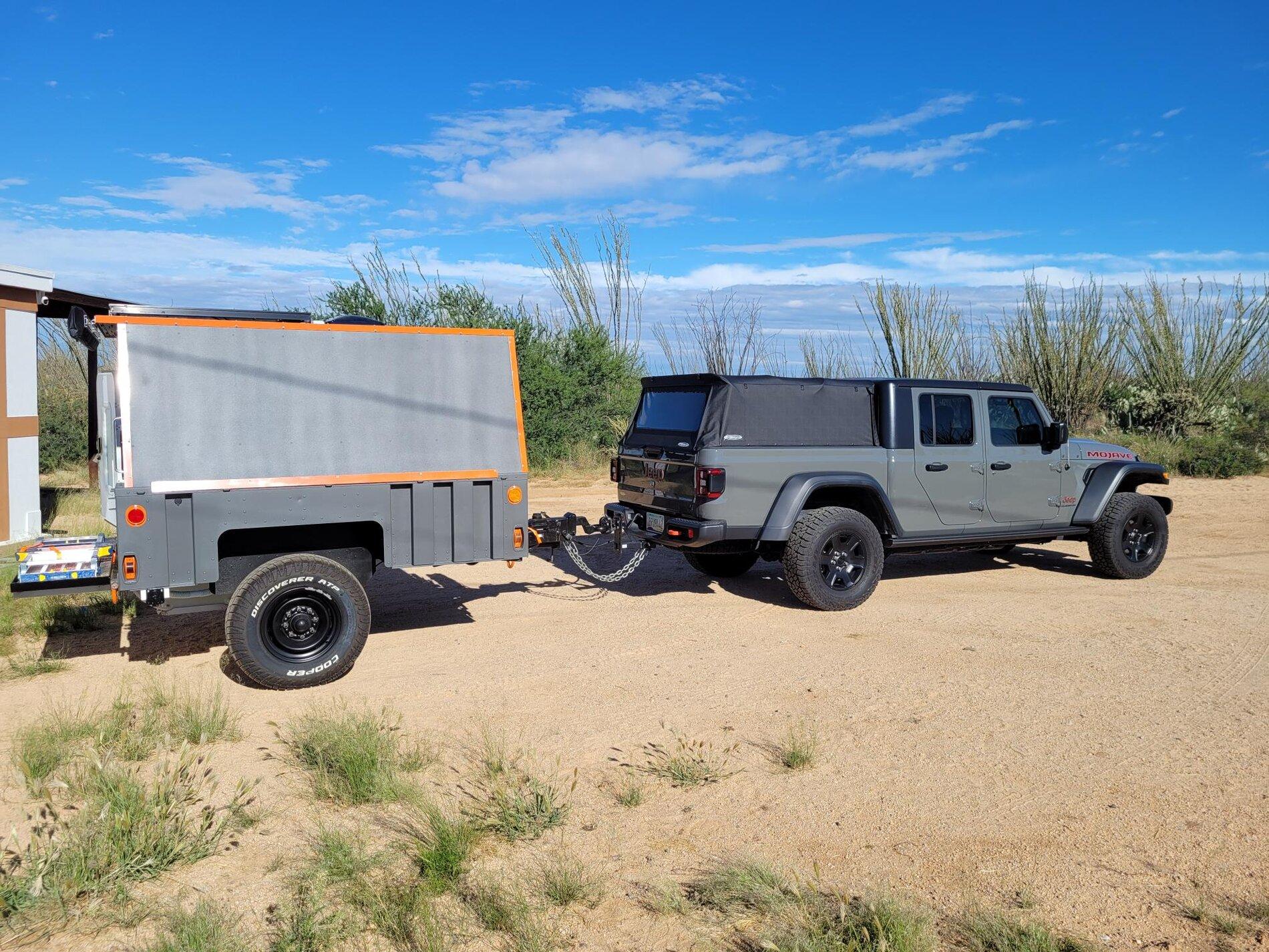

Just made the trip to Overland West in Flagstaff. I'm guestimating i weigh in at 2500-2800 pounds or so. Towed fine but feels heavy. I could hold 75 in 6th gear on the flats. 5% grade is 4th screeming and maybe 55-60 @ 8mpg. Got about 12 MPG overall. All temps were normal. The softopper made a huge difference with airflow. For those of you who are asking about towing 6000 pounds, I think that's 3000 pounds too much. To keep from squatting, I had to run airbags. Maybe its a Mojave thing with the softer springs, But I think its well sorted out now...good luck!!
Jeep Gladiator RV Towing 20210923_154059
If you're having an issue with squatting it's because you (normally) should be running a weight distribution hitch with a trailer that heavy. The axle on your trailer is also very far back, putting a higher percentage of it's weight onto your Jeep. It looks like a military trailer with that lunette ring hitch so I expect it was probably pulled by something like a deuce and a half which wouldn't have even noticed it back there.
I assume you're running that hitch and no weight distribution because you use that trailer for off-road travel, so the squat is just a consequence you have to accept in that case. If anyone is pulling a 6k pound trailer without weight distribution and sway control they've made some very poor decisions.

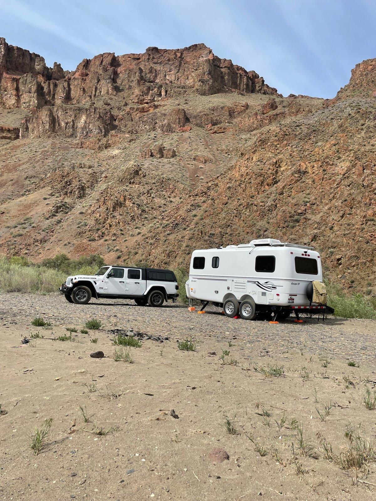

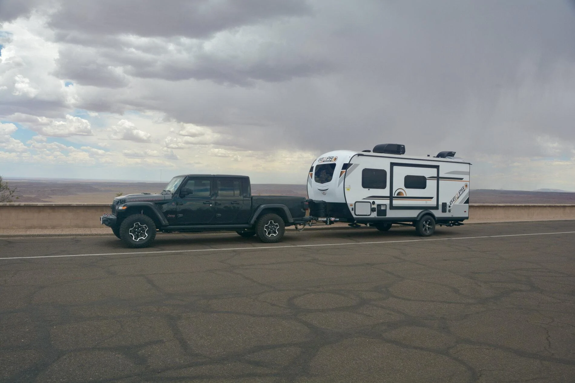

I love my GeoPro 19FBS. It’s small enough to easily tow with my JTR but big enough to be comfortable when I stop for the night.

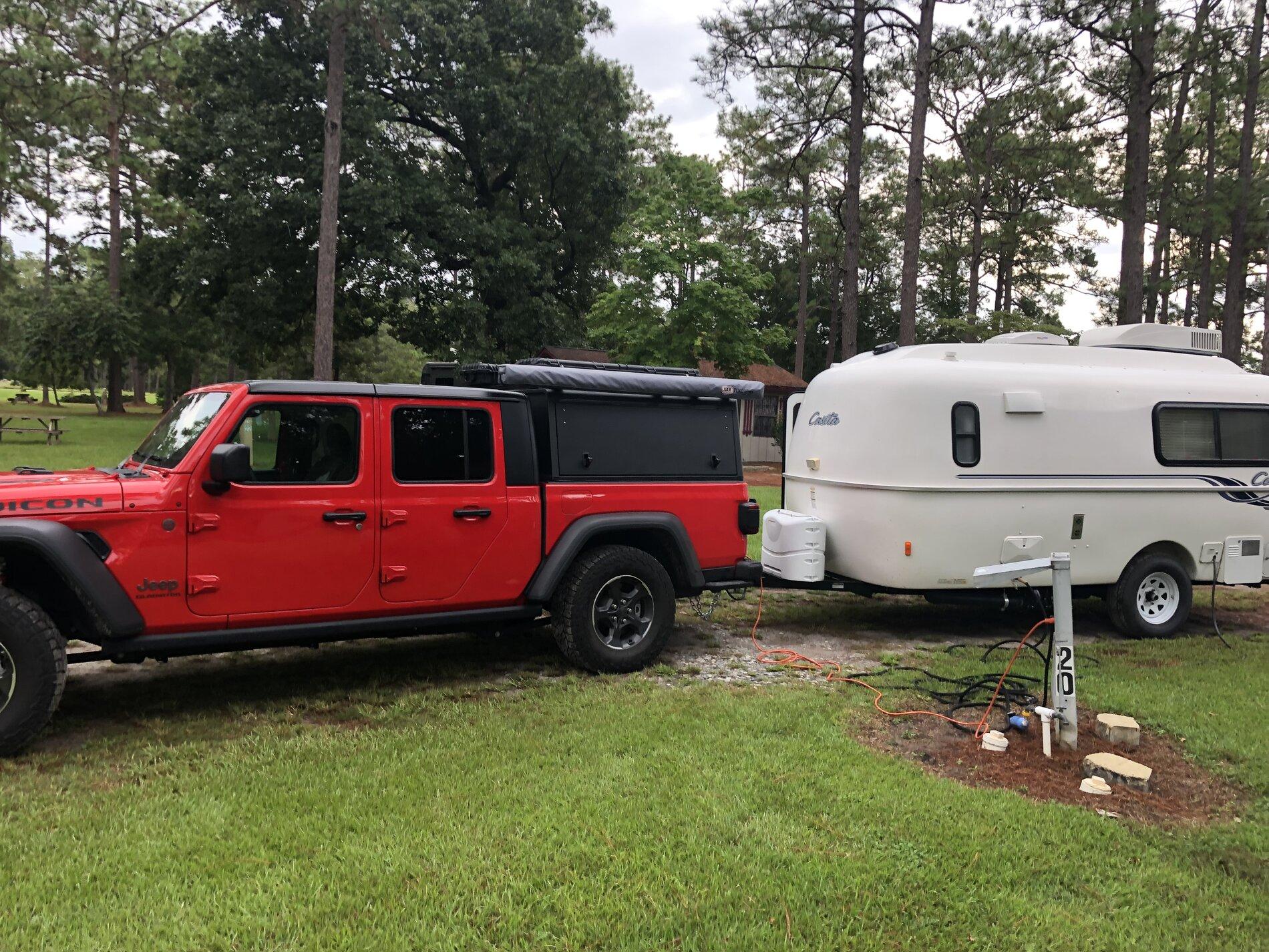

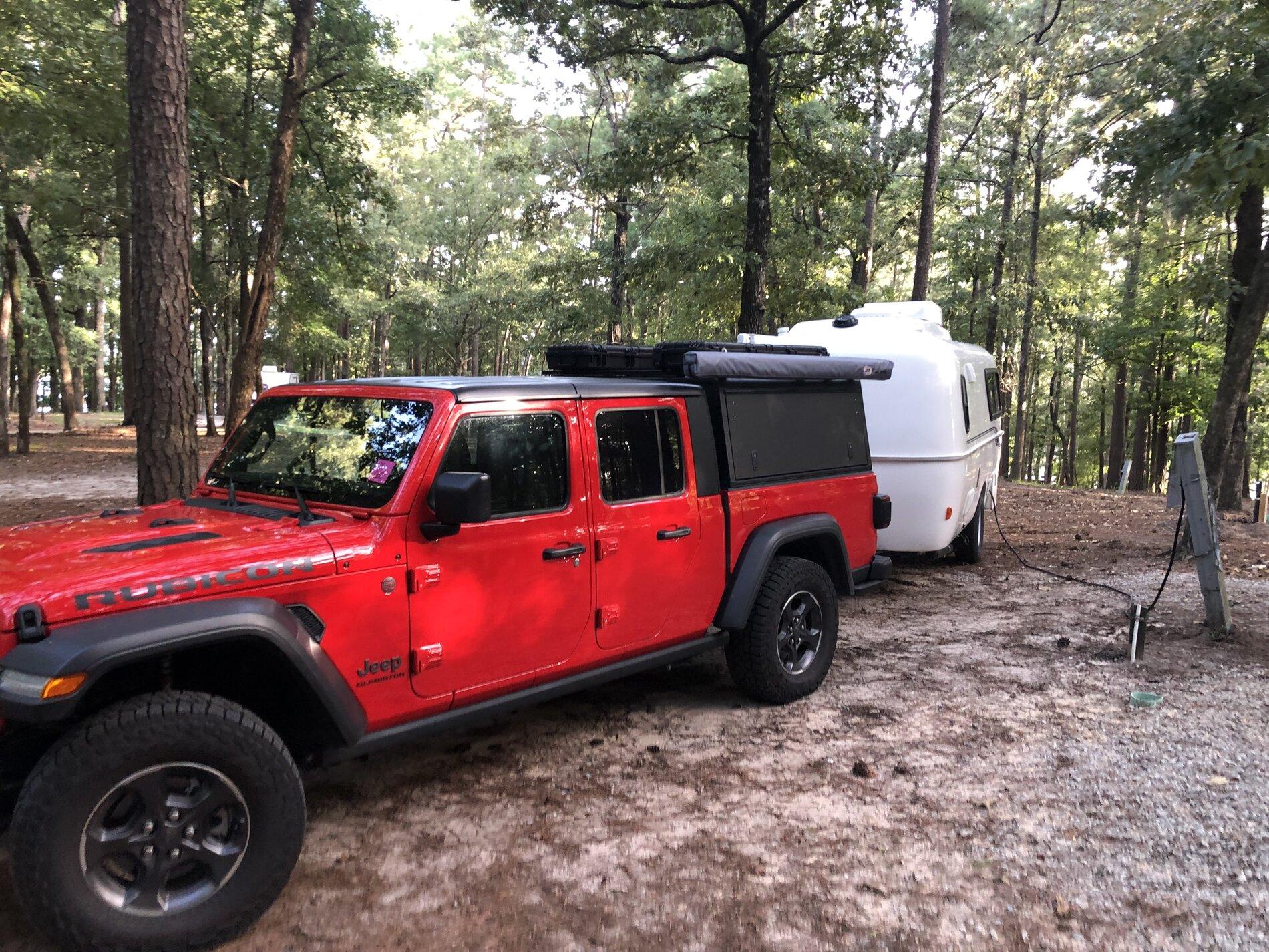

Here is my 2021 Rubicon gas engine with 2017 Casita Independence....
SOMEWHERE IN TEXAS
Jeep Gladiator RV Towing 65179554969__BD29C734-9323-4970-824B-7C690BCFF254
IN A DRY COUNTY, SOMEWHERE IN MISSISSIPPI
I don't remember the name of the county but the sign upon entering the county said "Possession and consumption of alcohol in XYZ county is illegal and is strictly enforced". I toasted them with a couple of bourbons. :rock:
Jeep Gladiator RV Towing 65171107097__19B4F4BB-07A2-44A7-83F8-763664148C58
The trailer weighs about 2480 pounds empty and the most it has weighed loaded is about 3200 pounds, I only pull it with water if I am going boondocking.

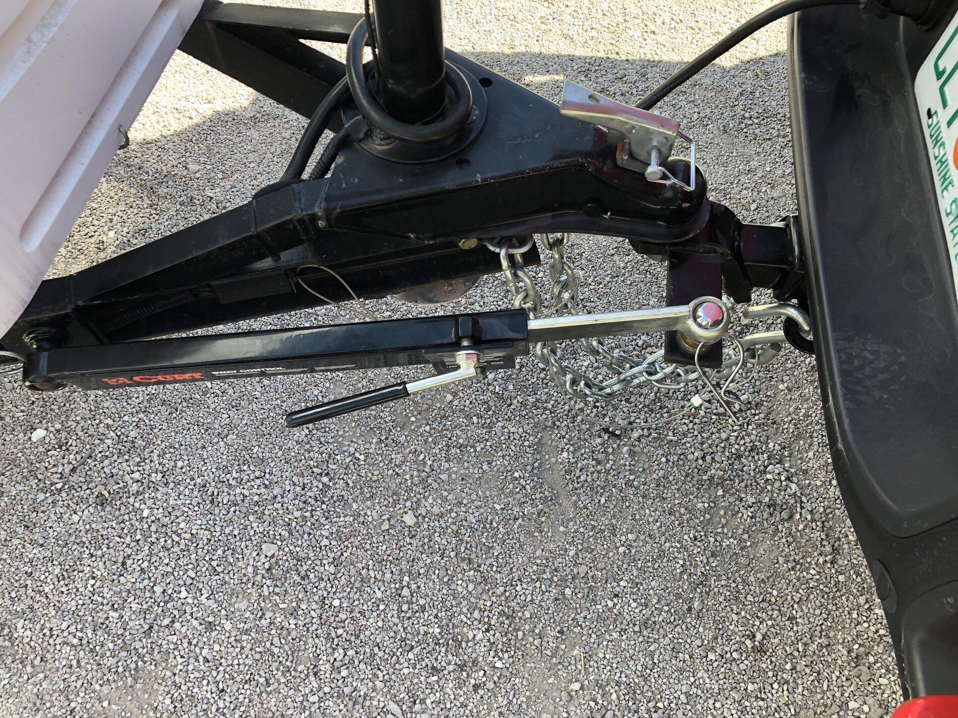

I do not use a weight distribution hitch, but most assuredly I use an anti-sway bar (Curt). Harbor Freight has a decent $30 knock off.
CURT ANTI-SWAY BAR
Jeep Gladiator RV Towing 65160021181__4392CB58-AF40-4EBE-8CFF-0BE90667960A
Tongue weight is about 330 pounds and I plan to install air bags to reduce sag...
Here are my trailer specs.
Casita 17' DELUXE MODEL SPECIFICATIONS
Overall length 17'
Overall height 8'-11"
Interior Height 6'-1 1⁄2"
Overall width 6'-8"
Approx. dry weight 2480 lbs.
Approx. hitch weight dry 365 lbs.
Tire size 15"
Axle capacity 3500 lbs.
No issues pulling it, but it is slow going in the mountains.
That model is on my list of potentials. Can you give any feedback on it?
Ferg
Michael
Aug 26, 2019
216
544
Longview, TX, USA
2021 Gladiator Rubicon
Retired College Instructor
I really like it. The 190W solar panel is now standard, as are the "off-road pkg." (translation: it's lifted a bit) and the 12v compressor fridge. The trailer itself is an easy tow and is comfortable. I've enjoyed it very much.
Awesome, thanks!

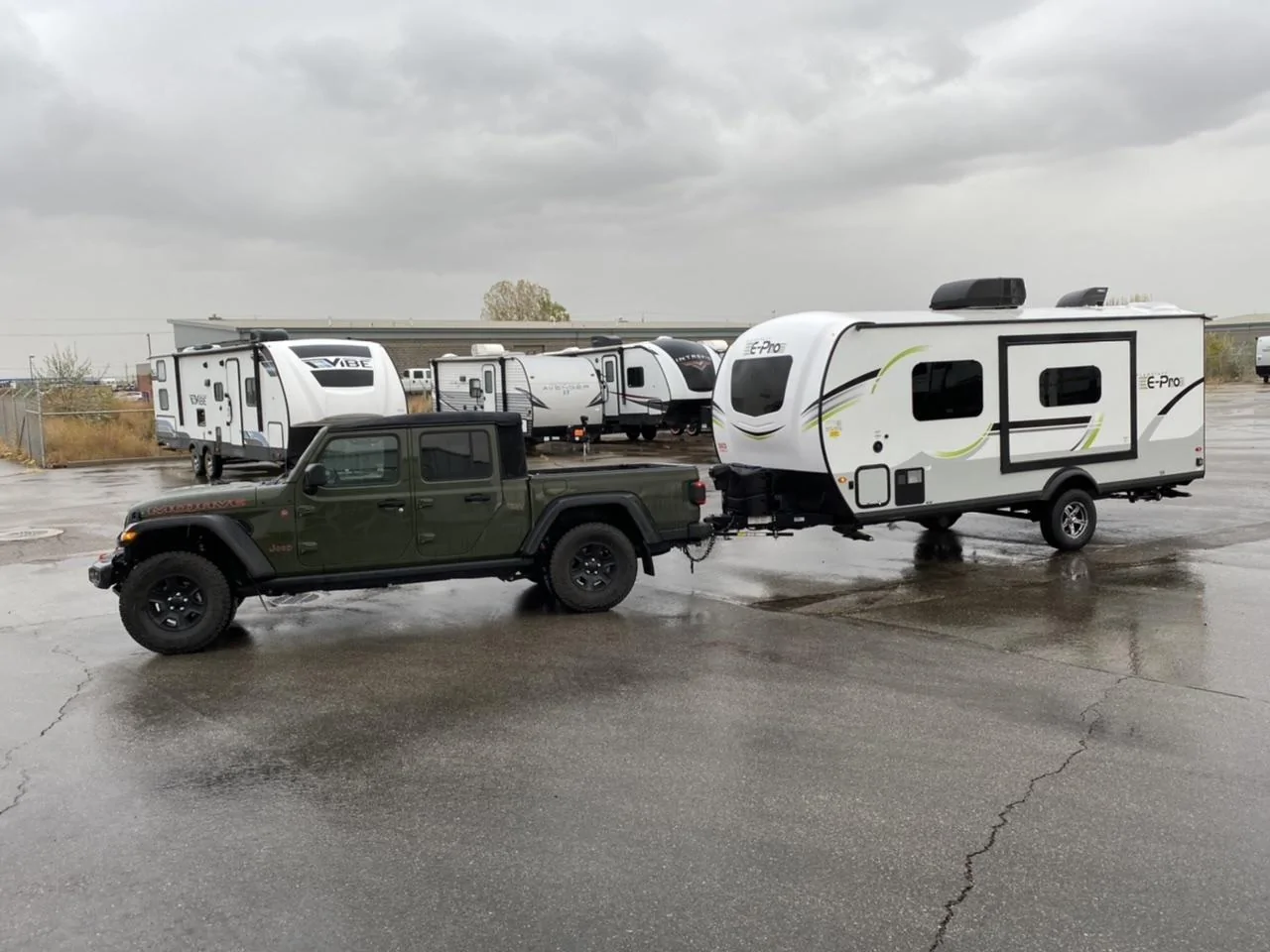

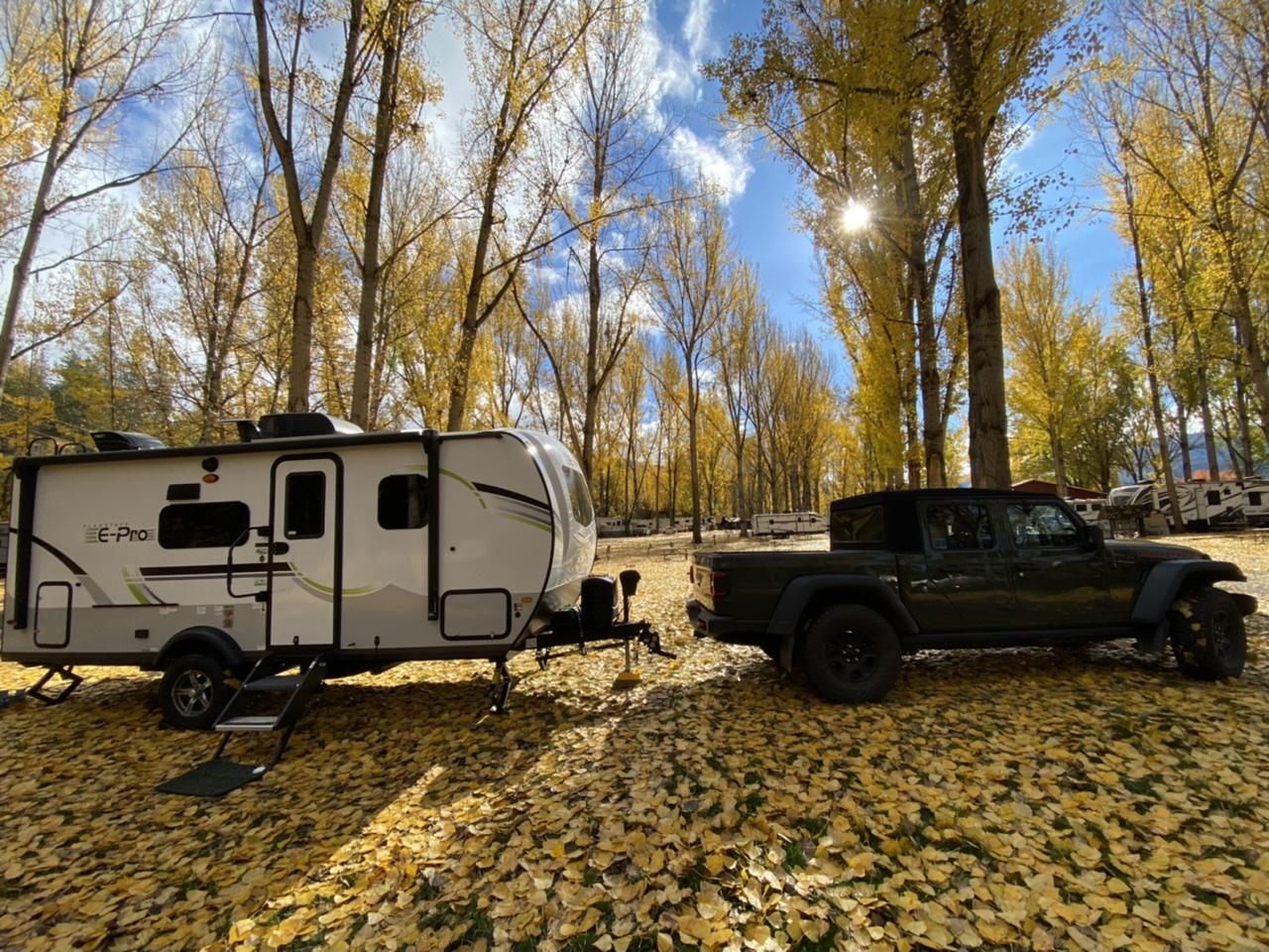

Thank for your input, it was super helpful in making our decision. We picked up an E-Pro 20FBS last week and spent two nights in it in Kamiah, ID. Pretty similar to your 19FBS but a foot longer and some items shifted a bit. Super easy tow and great trailer!
Jeep Gladiator RV Towing 6205BD01-B5F1-4B9A-A58B-C7B397833B6F
Jeep Gladiator RV Towing D75BBDF9-4ECC-48A8-826D-E9AC62472016
Of course, we finished the trip and discovered the hitch head was loose on the shank. Turns out the dealership that installed my Equalizer hitch for me didn’t actually torque anything at all. Bolts that should have been 320ft-lbs were at 50ish. Thankfully no incidents and no damage, and it was easy to fix after I made a run to a local farm supply store for tools.

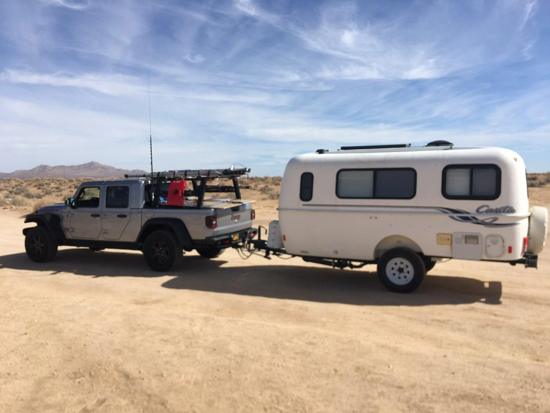

Here is another recommendation for Casita fiberglass trailers. This 2014 16ft is about 2,200lbs empty and I suspect about 3,200 fully loaded and it has a kitchen with fridge and microwave plus bathroom with shower. Sits six and sleeps three.
It hauls like a dream and I use an Anderson No Sway hitch. I put air bags in my rear shocks and run about 25lbs in those then use the adjustments on the hitch to do the final leveling on the truck. There are several other brands of fiberglass trailers that are similar to the Casita that have all the benefits of the leak proof fiberglass shell and light weight.
I put a 3" lift on this trailer and it handles mild off roading just fine.
Jeep Gladiator RV Towing 1636394267839
