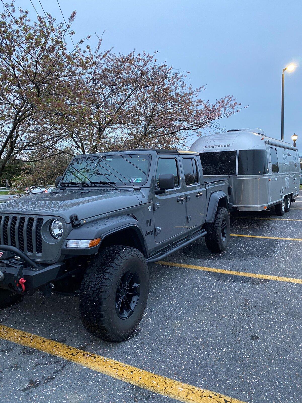

I have the Sport S Max Tow with the 2" Mopar lift, 35" tires and side steps. This deducts from my overall payload - but well worth it. We pull a 23' Airstream Flying Cloud - tongue weight is around 680 lbs and trailer is around 6200 loaded for camping. Pulled it 2300 miles from eastern PA to Destin, FL. It pulled great. Weighed it on the CAT scale on the way down - we were over on payload by 180 lbs (6430 vs 6250) but under weight on both axles. Moved some items from the bed to the trailer. Oil temp, transmission temp, etc all well in range - - even on a constant incline we hit. It is a great combination.
