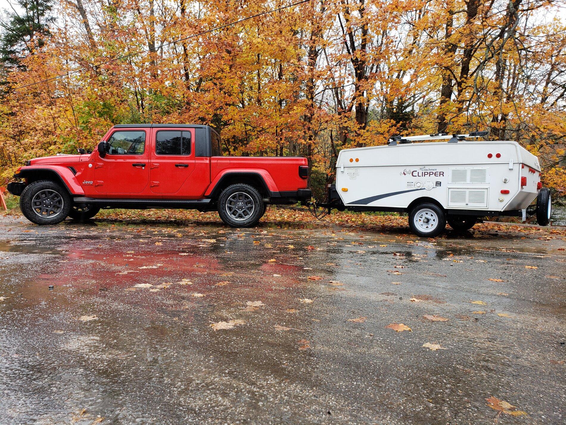

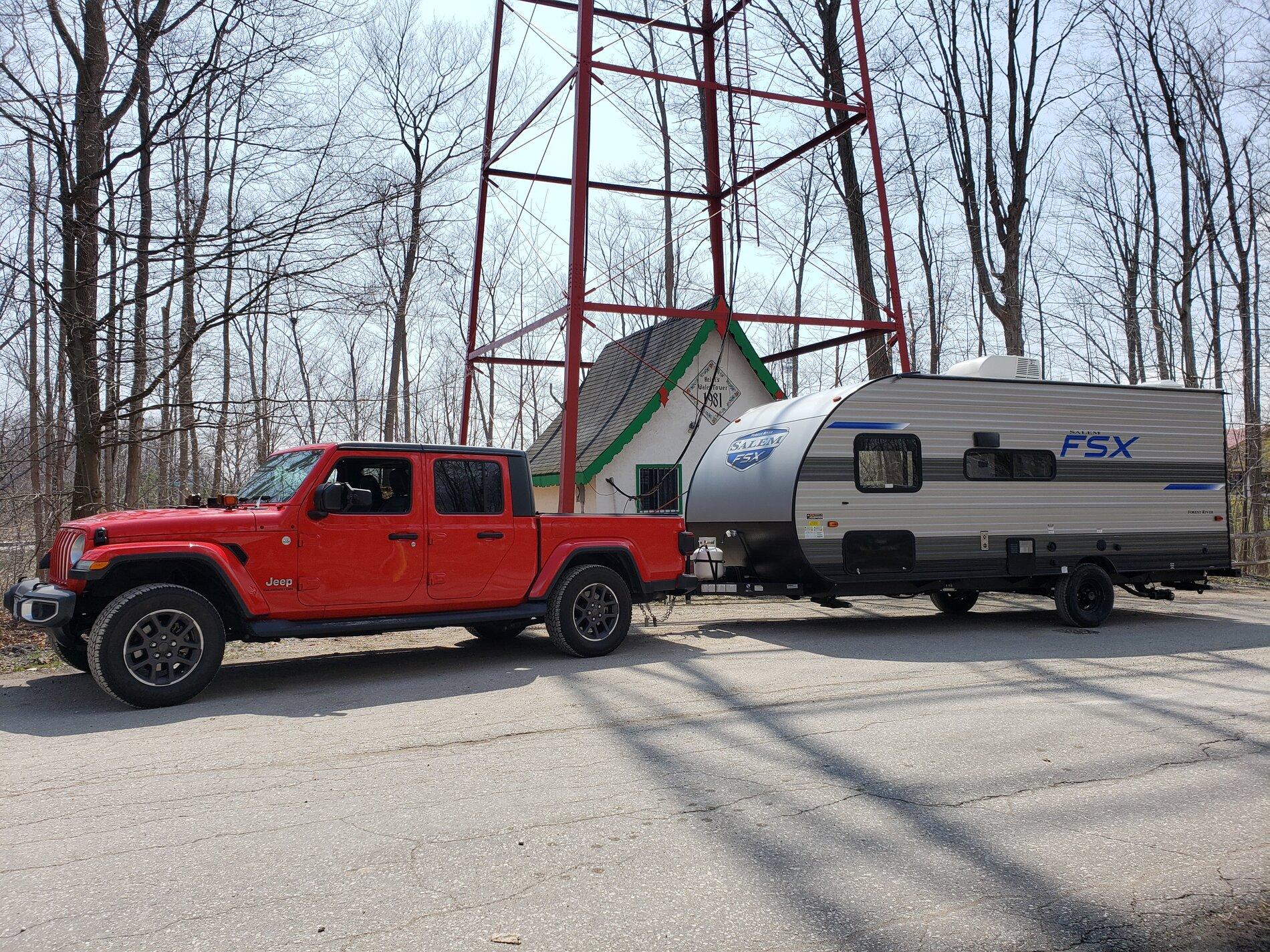

We just picked up our upgraded trailer a few weeks ago. Having the Overland was definitely limiting when shopping for a new RV. As many have said, with a midsize pickup it'll likely run out of payload before hitting the towing capacity. Heavy trailer tongue weight and weight distribution / sway control hitches are gonna be a challenge. How I wish we waited for a Max Tow to become available. Oh well, it is what it is.
We opted for the Andersen No-Sway WDH to save some payload. But at the end of the day, the 10-15% tongue weight for whatever trailer you're planning to get is unavoidable. Leave more wiggle room and your trailering trips will be more leisure and enjoyable.
I told my friends that if the plan is mostly doing short, flat drives (a few hrs one way) to a site and stay there for the trip, it's "ok" to go closer to cargo/tow limit. But if the intention is for prolonged roadtrips across hilly terrain, it's necessary to leave more room.
One thing I read from RV forums is "buy your second trailer first". Definitely has a lot of wisdom to it, and made me think twice about what we should get for our setup.
Sharing some pics before and after our upgrade:
Jeep Gladiator RV Towing 20201004_141046
Jeep Gladiator RV Towing 20210414_130052

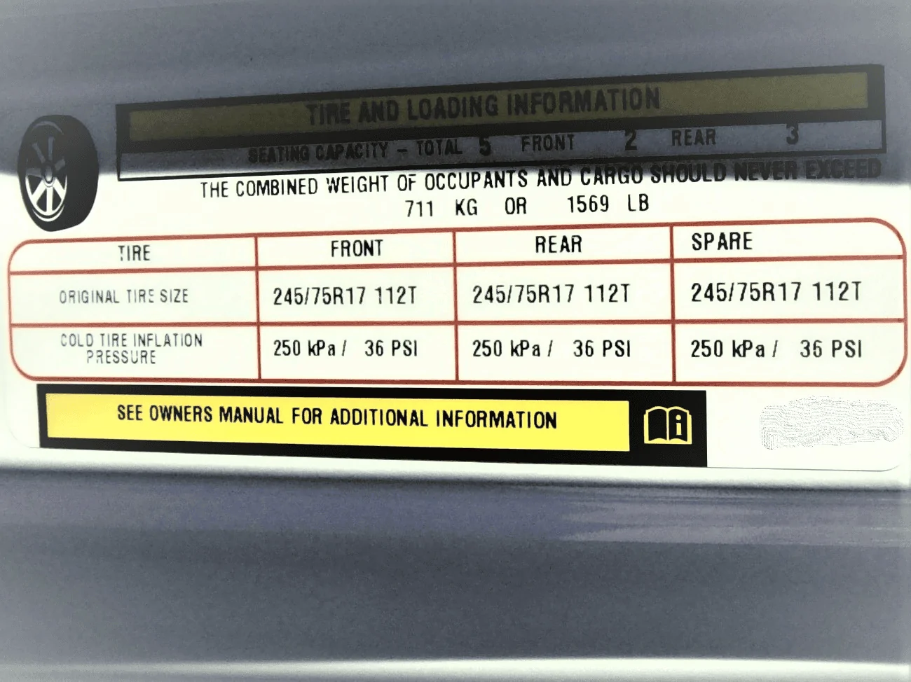

I also have a JTR automatic and towed multiple times last year after buying it. As mentioned several times, there’s four main numbers to look at for trailer calculations.
tow capacity (JTR=7000lbs, which pretty much takes into account your gross combined weight rating number minus your vehicle weight) hitch capacity (700lbs) cargo capacity (1245 on mine/see pic below) and trailer frontal area. (Sq ft / JT is listed at 60 sq ft I believe)
what I’m towing right now is a cargo camper conversion that’s 7x16 and 7’ tall so the frontal area is 7x7 although it is a v-nose.
as mentioned above, tongue weight and passengers and anything else you put in the truck counts toward that payload so in my case I add about 400 for me and the wife, 100 for the dogs, 50-60 for the weight distribution hitch and 600 tongue weight and end up at 1150 or so. Not much room for luggage or anything else. But.... we put all the gear and luggage in the trailer. My cargo camper w/two 3500 lb axels scaled 4200 on the axles and 600 on the tongue disconnected from the truck so when we load up to go, we load the totes of dry food, gear and luggage over the trailers axles to keep the tongue around 600 and had no problem at all.
what you’ll have to watch when buying any premade camper like the Grand Design you mentioned is they always put a huge cargo area in the nose and a lot of people load that full without thinking about how much tongue weight that adds (which counts towards your payload numbers.)
I’ve towed a single axle without WD and towed this tandem axle trailer ONCE without WD. Above 55 the slightest breeze or buffeting from other vehicles makes for a nervous drive from the trailer sway. A good WD hitch with sway control makes a ton of difference no matter what your towing! It spreads the tongue weight across the front and rear axles of the truck so you not squatting in the rear and puts some of that weight to the trailer axles as well AS LONG AS ITS SET UP RIGHT!! I have an E2 roundbar WDH and had to play with the adjustments a few times to get it set right. Once I had it set up right and the trailer brake load and sensitivity dialed in, we traveled from Missouri to Yellowstone and back at the 70mph speed limit, and the trailer never swayed, wiggled or got of line at all (even when a semi pulled out from the entrance ramp to the middle lane right in front of me causing me to have to lock the trailer brakes) Just Make sure to read the directions that come with it and set it right. I’ve seen too many people pulling campers that are not level, with trucks that are nose up swaying down the road at 65 mph and thats scary to see knowing they are a hairs breath away from losing it and possibly killing themselves or someone else.
We have been looking at premade campers ourselves but there’s more to consider than which one has the nicest floor plan or amenities. Take your time and crunch all the numbers before you commit to make sure you’ll be able enjoy taking that camper on all the trips you want to take.:like:

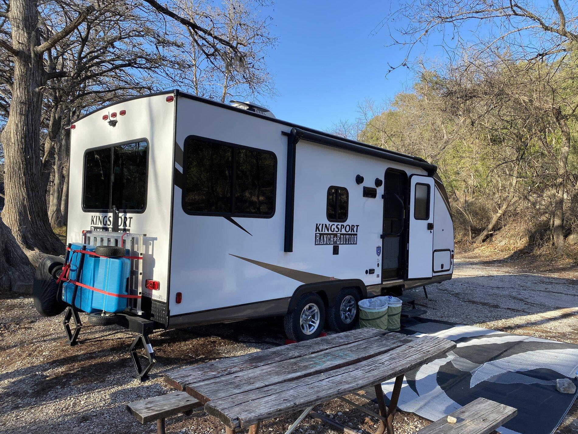

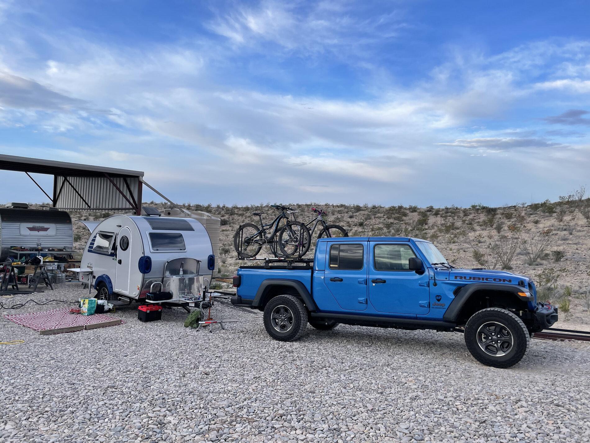

Just got back from a trip out to Big Bend, first tow with My JTR and new trailer Tab 320CS Tongue weight 250, weight 2500 dry. The truck towed as well as can be expected for a midsize truck at speeds between 65-68mph. Real world gas mileage is the only thing I would wish different. We got and average of 10 mpg, combined some headwinds and elevation changes in both directions. All that gave us a range of 200+/- miles. I can't imagine towing anything bigger or heavier. The truck can certainly handle it but how often do you want to stop?

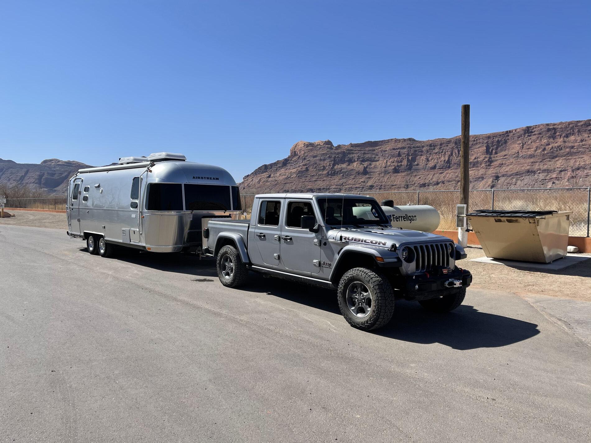

Last year I purchased a new 2020 Gladiator Rubicon 3.6L v6, 4.10 axle ratio, with tow package. I bought the Gladiator not only for off roading in southern UT but to also to tow our 25' Airstream trailer which weighs about 6,000 lbs dry. I recently had the dealer install the Mopar electronic brake controller on the Gladiator. The Gladiator payload is 1,171 lbs and after subtracting the weight the Warn winch, of a couple adults and the Airstream hitch weight (with full LP propane tanks and two batteries) and factoring in the BlueOx weight distribution hitch, I am pretty close to the payload limit. The Gladiator towed the Airstream from northern UT to Moab just fine for the recent Easter Jeep Safari.

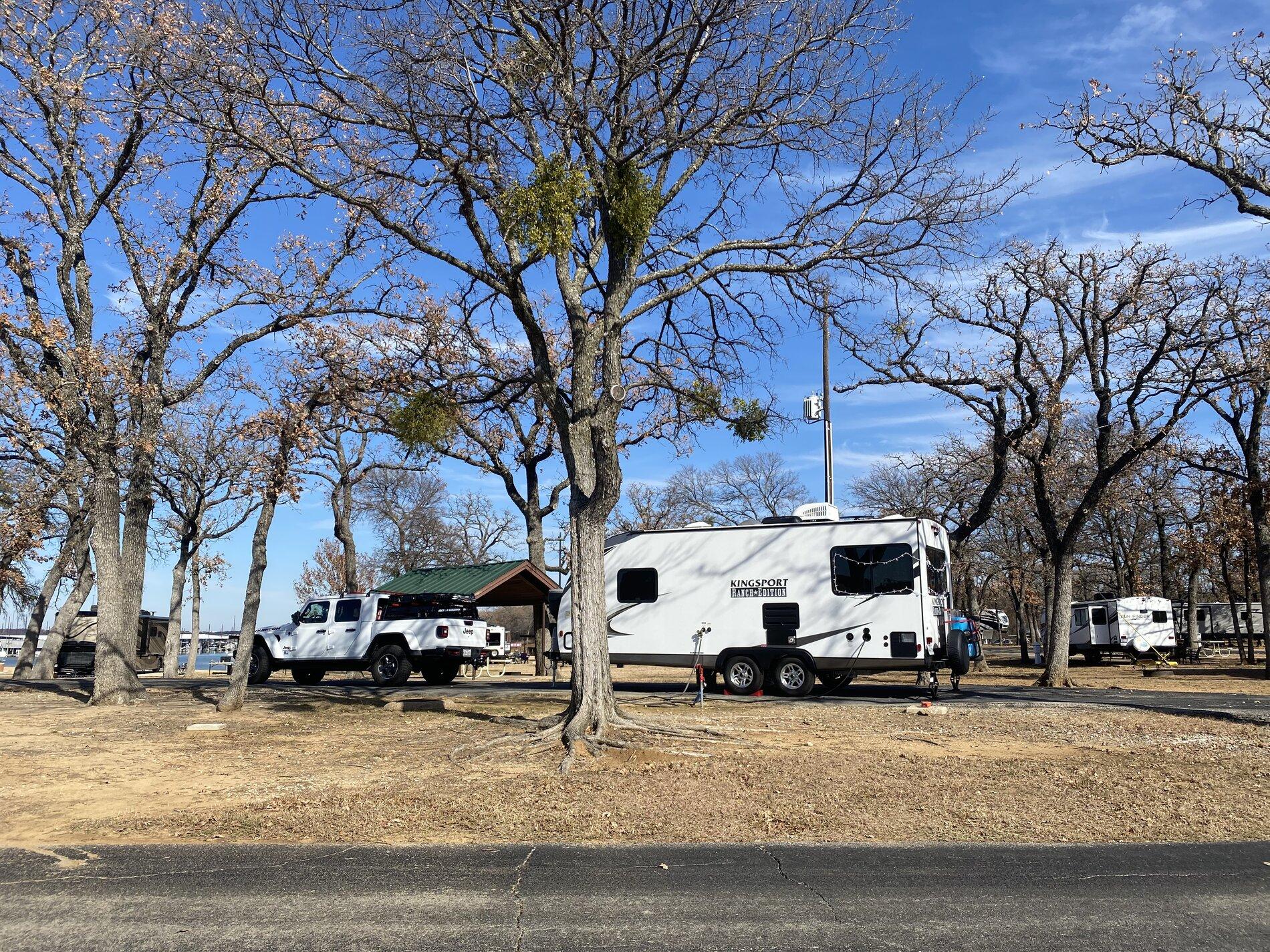

I live in Texas, so lots of highway miles before I get to my preferred camping spots in AR, NM, CO.
Max tow on 35s pulls my 3800# (5000# when actually traveling) great till 55mph. After that the engine struggles alot. Wind makes a huge difference if coming from the front..
If I was to do it again I would buy something with less wind drag as an RV. The finish on the outside and the shape make a big difference.

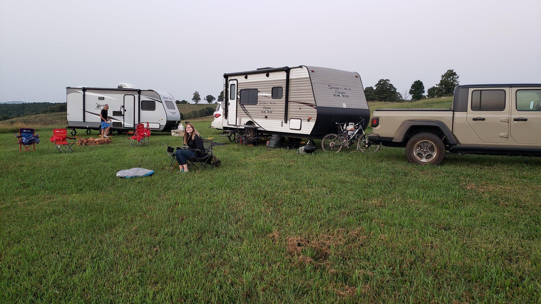

I towed for the first time this week. My trailer is 1900 lbs with 300 lbs of camping junk in the bed and that was too much. Truck sagged bad. For me it isnt weight but wind resistance... and making sure you dont skip a gas station. Those of you towing 6k, your nuts...

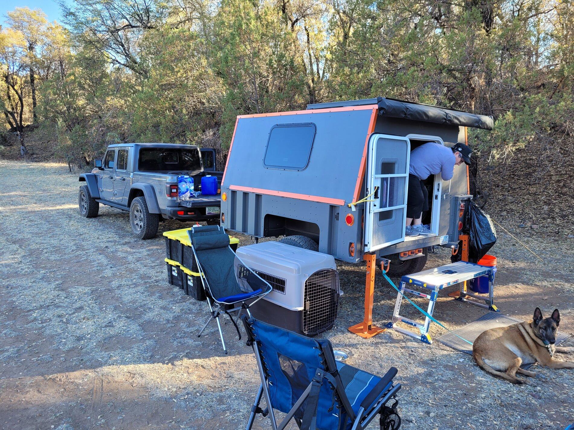

We love our Gulfstream travel trailer. It is constructed of aluminum substructure with sandwich panel side walls, roof, and floors with fiberglass and Azdel face sheets. It works quite well with our Rubicon. This trailer is a 25’7” tandem axle trailer with a dry weight of 3750lbs! The trailer cargo capacity is an unbelievable 3650lbs. Not that we could ever load it with that much. It is a 22UDL model. It is worth checking out. Great couples trailer. Will sleep 4 adults though.
