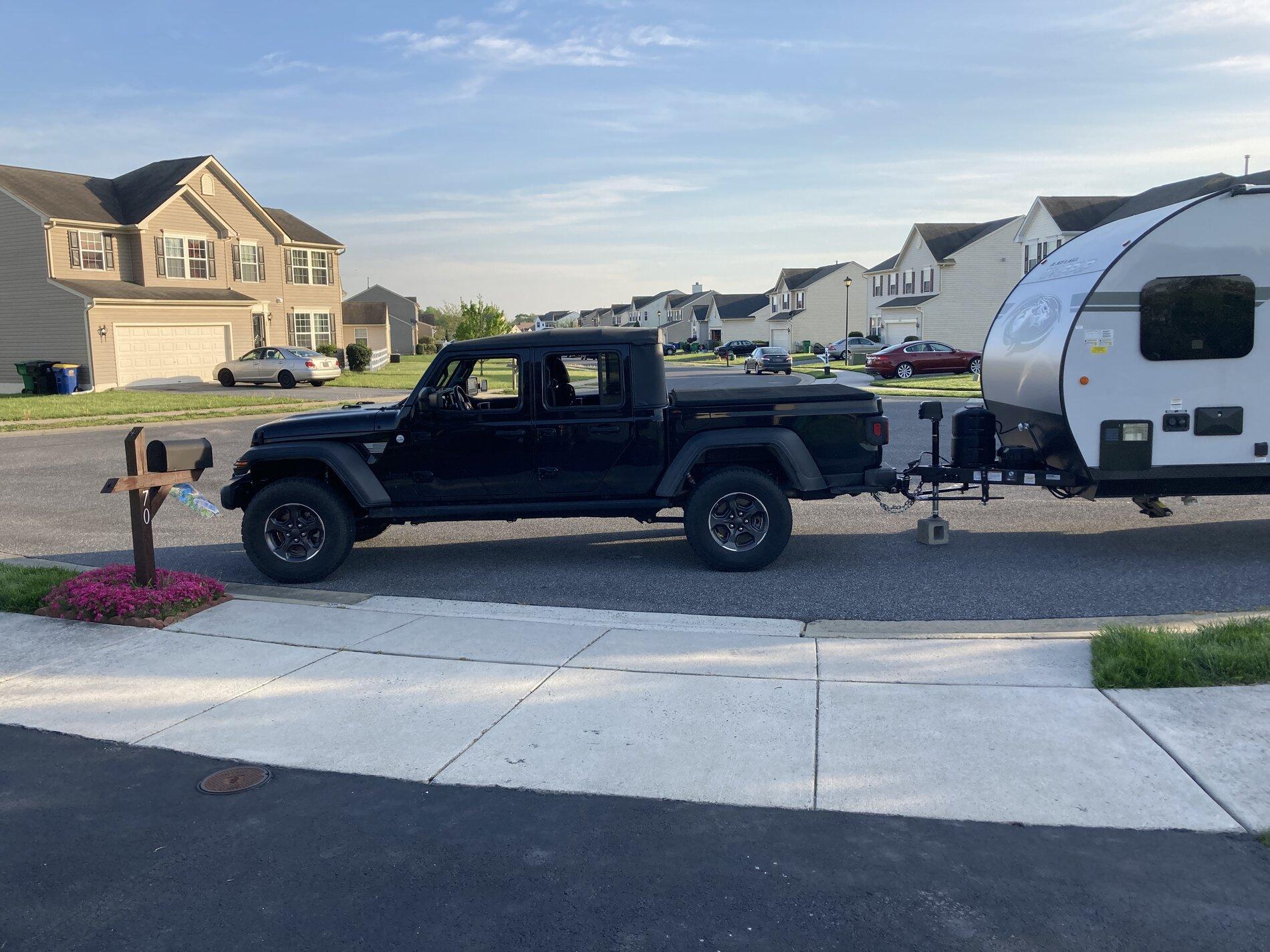

Here’s what I have. Pulls great with the jtmt, so it would pull great with a rubi. Well under weight ratings and payload. Like others have said it bounces a bit with the single axle but nothing to worry about.
in a addition to a wdh id suggest sumo spring rear bump stops and air bags. The combination of the two makes the ride feel like there’s nothing behind the JT. It’s unbelievable the difference the two additions made.

sits perfectly and rides like a dream with the stuff I linked above.

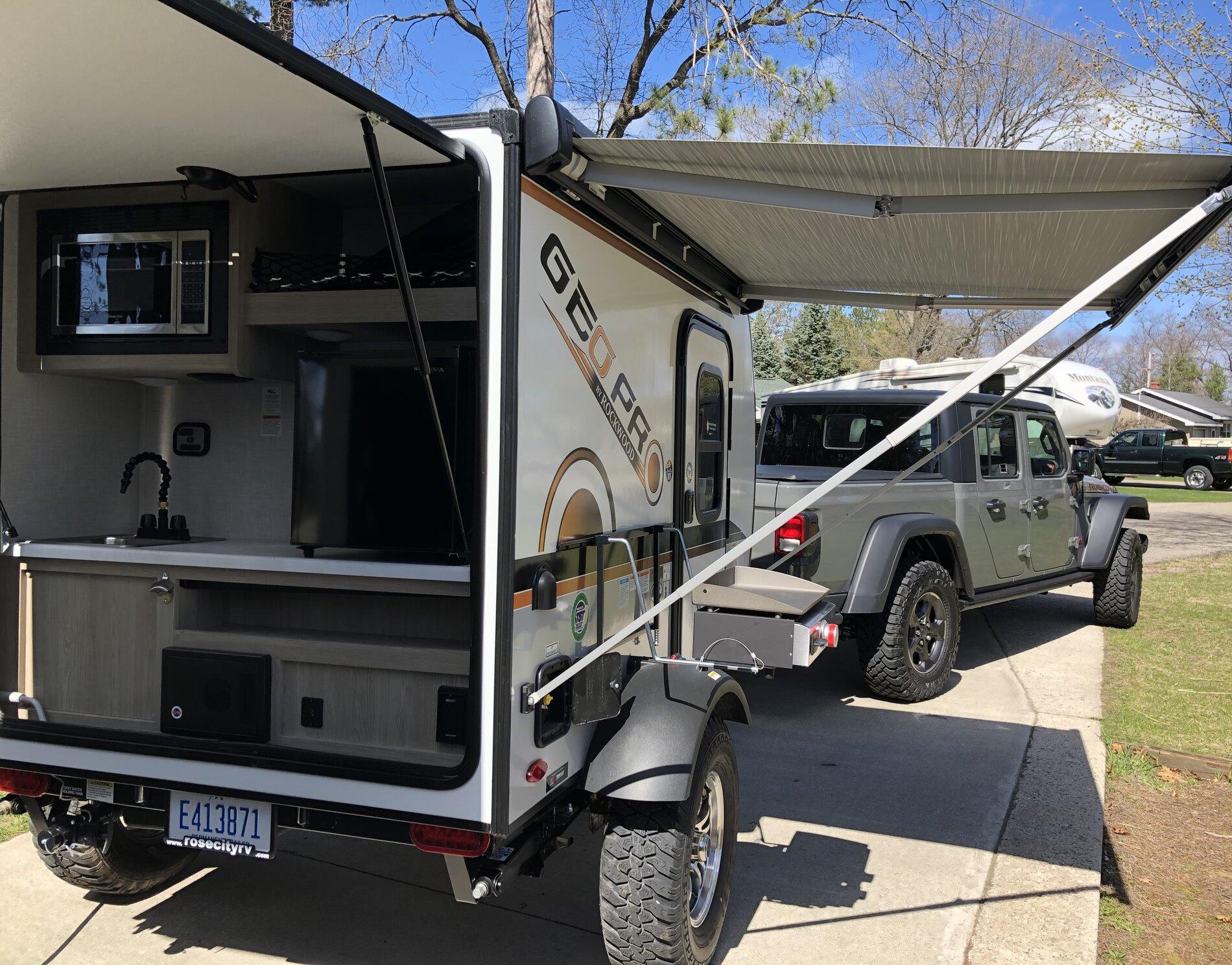

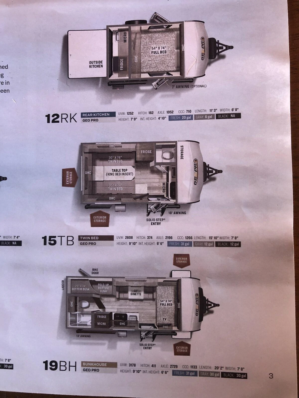

Here is my set up. My Geo Pro 12RK,
1300# but no potty. I carry a Luggable Loo. They do make a lightweight with a bathroom called a 15TB.

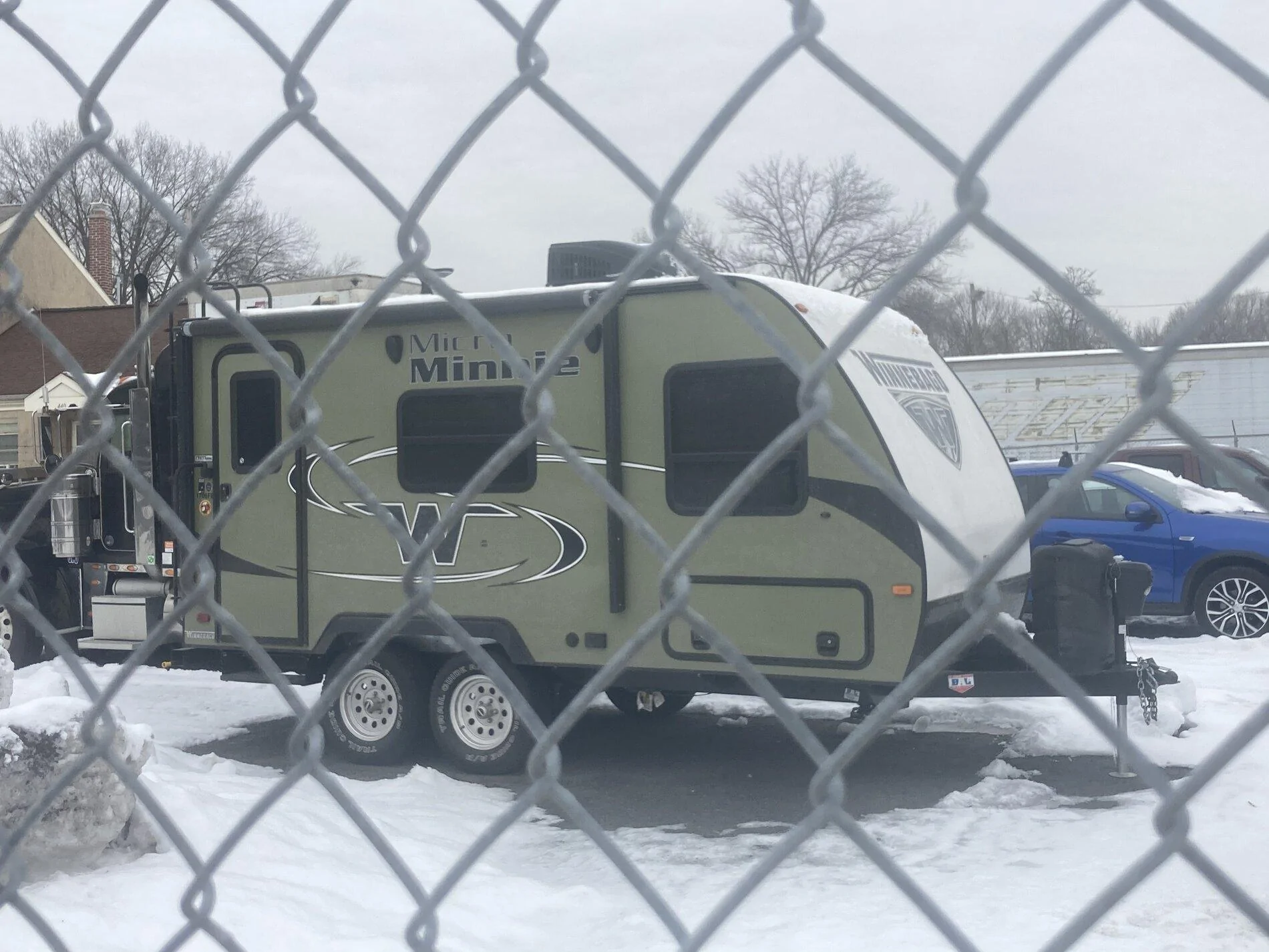

The Micro minnies from Winnebago are really nice this is a 1706FB, seven foot wide, dry bath, large two door refrigerator, no slides dry weight under 2800lbs., hitch weight 330lbs. I have towed boats and campers for years current camper is s 19’ Prowler tandem 3400 pounds dry weight and we want to downsize to a minnie, no matter what you get check out Thorn Engineering( member here) for tow mirror adaptors and get a set of Rampage mirrors.
Nancey really think what you want, I won’t tow anything over 4500 dry weight with my Mojave. We go to kayak fishing tournaments and have had four campers over the years, we sleep in our camper ,cook and sometimes eat in it, do you really need a big wide camper that will stress your husband and truck or get something like the picture and have an enjoyable experiance with minimal issues, and same end result.
That is not my camper but was a repo at a place I drive by was sold before I even called but it is the model we are thinging about......Jack

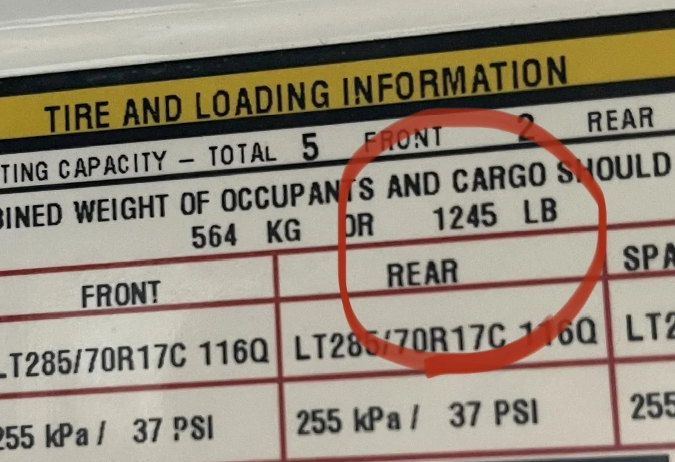

I also have a JTR automatic and towed multiple times last year after buying it. As mentioned several times, there’s four main numbers to look at for trailer calculations.
tow capacity (JTR=7000lbs, which pretty much takes into account your gross combined weight rating number minus your vehicle weight) hitch capacity (700lbs) cargo capacity (1245 on mine/see pic below) and trailer frontal area. (Sq ft / JT is listed at 60 sq ft I believe)

as mentioned above, tongue weight and passengers and anything else you put in the truck counts toward that payload so in my case I add about 400 for me and the wife, 100 for the dogs, 50-60 for the weight distribution hitch and 600 tongue weight and end up at 1150 or so. Not much room for luggage or anything else. But.... we put all the gear and luggage in the trailer. My cargo camper w/two 3500 lb axels scaled 4200 on the axles and 600 on the tongue disconnected from the truck so when we load up to go, we load the totes of dry food, gear and luggage over the trailers axles to keep the tongue around 600 and had no problem at all.
