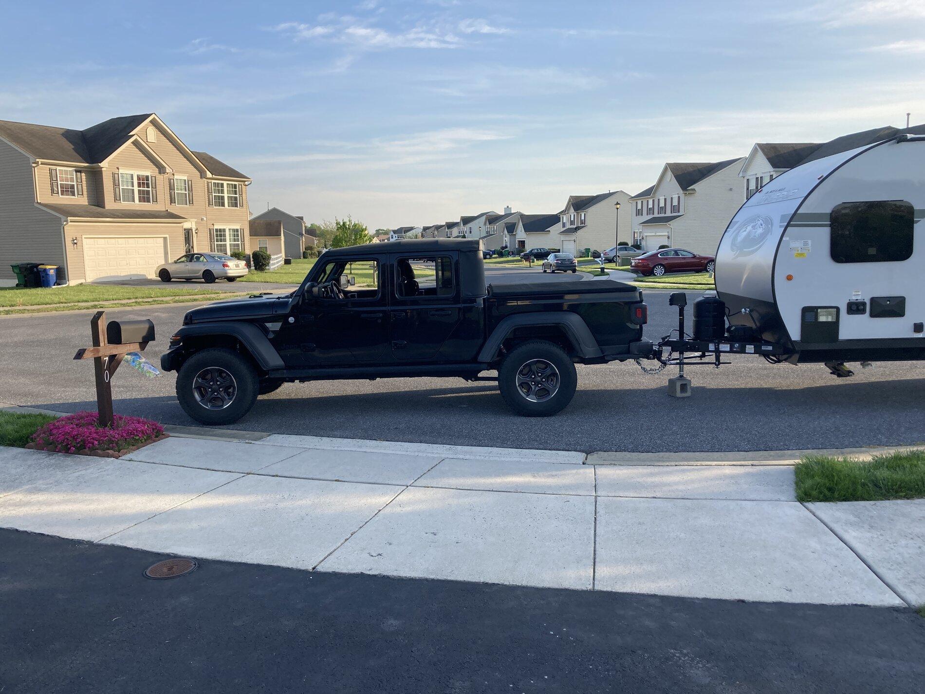

Here is my set up. My Geo Pro 12RK,
1300# but no potty. I carry a Luggable Loo. They do make a lightweight with a bathroom called a 15TB.
This thing is awesome. I just saw the G12SRK version. That might be the way I go.

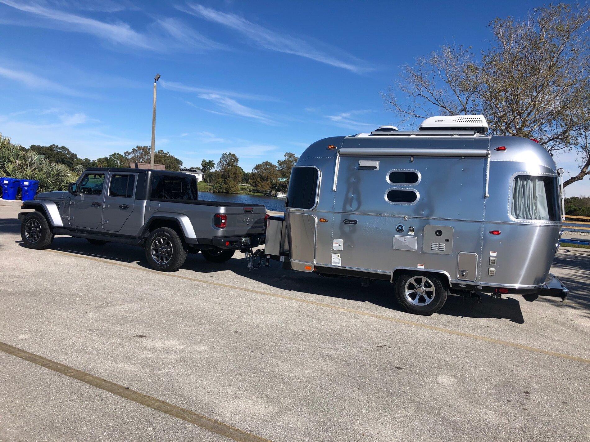

Here is a work out for a 16' Airstream and a Gladiator Overland. This is the only way to find if you are legal not only on MFG ratings, but also staying within the LEGAL limits for your tow unit. One item i find is usually missed is the actual weight of the Load Equalizing unit you pick. That can easily be 100+ lbs with the hitch weight and the load bars. Take care, Bob

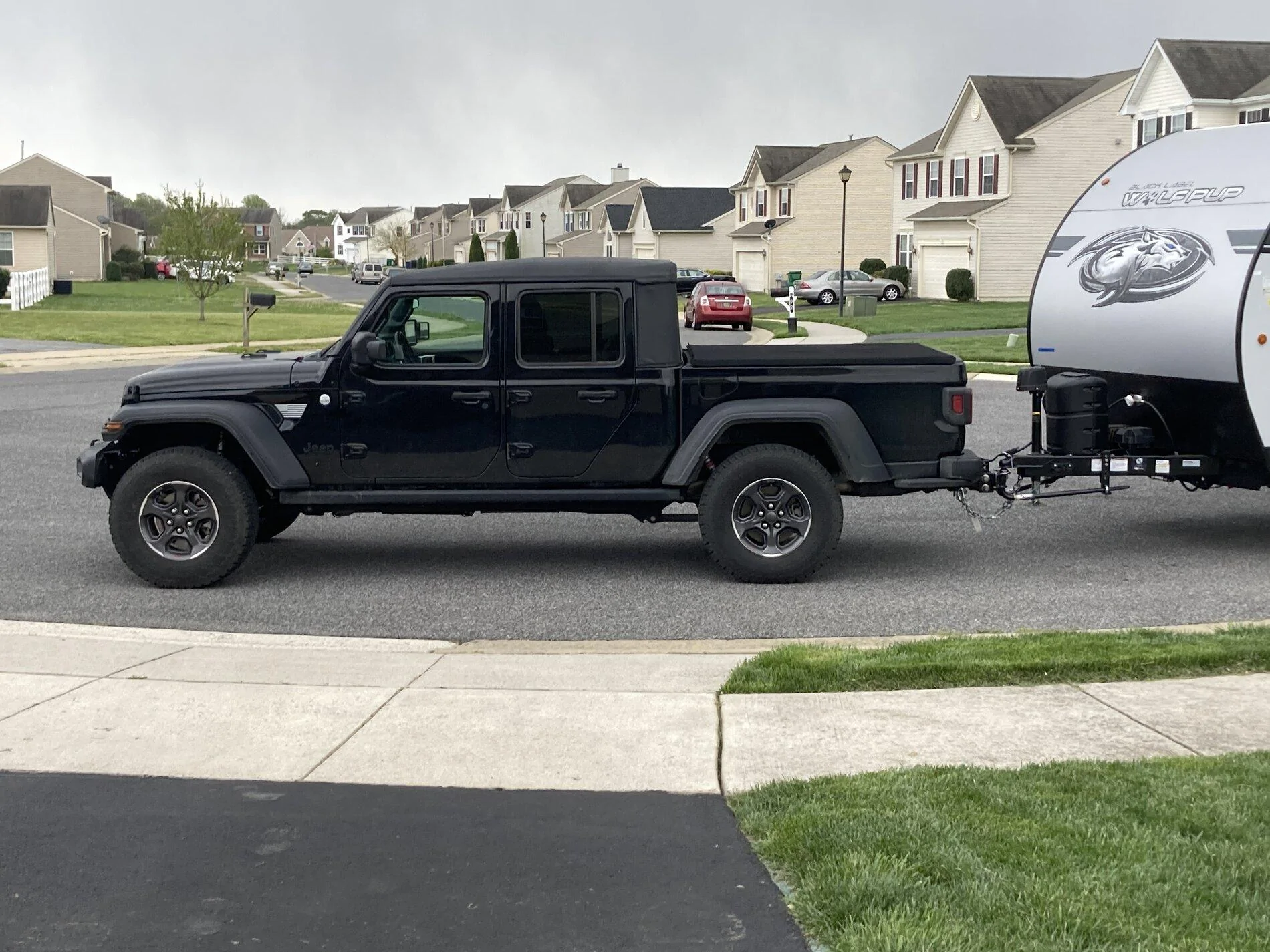

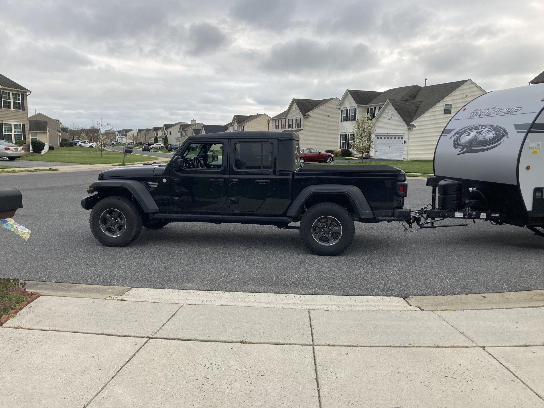

I have access to lots of new take-off springs and shocks from various Gladiators, as well as my own. The one in my profile pic is a Max Tow, however I wanted to do some science and compare the Rubi springs to the Max Tow ones, both visually, and on the road with the trailer. In my experience, and this is my own rig, my driving preference, all based on a totally subjective interpretation. That said......!
Rubicon front springs, Max Tow rears, Max Tow factory shocks, rear air bags @ 22 psi, Reese Straight Line hitch with 1200 lb bars set to 4 links hanging free. With our payload setup, tires, the trailer type, etc., it works.
What brand of air bags do you run?
