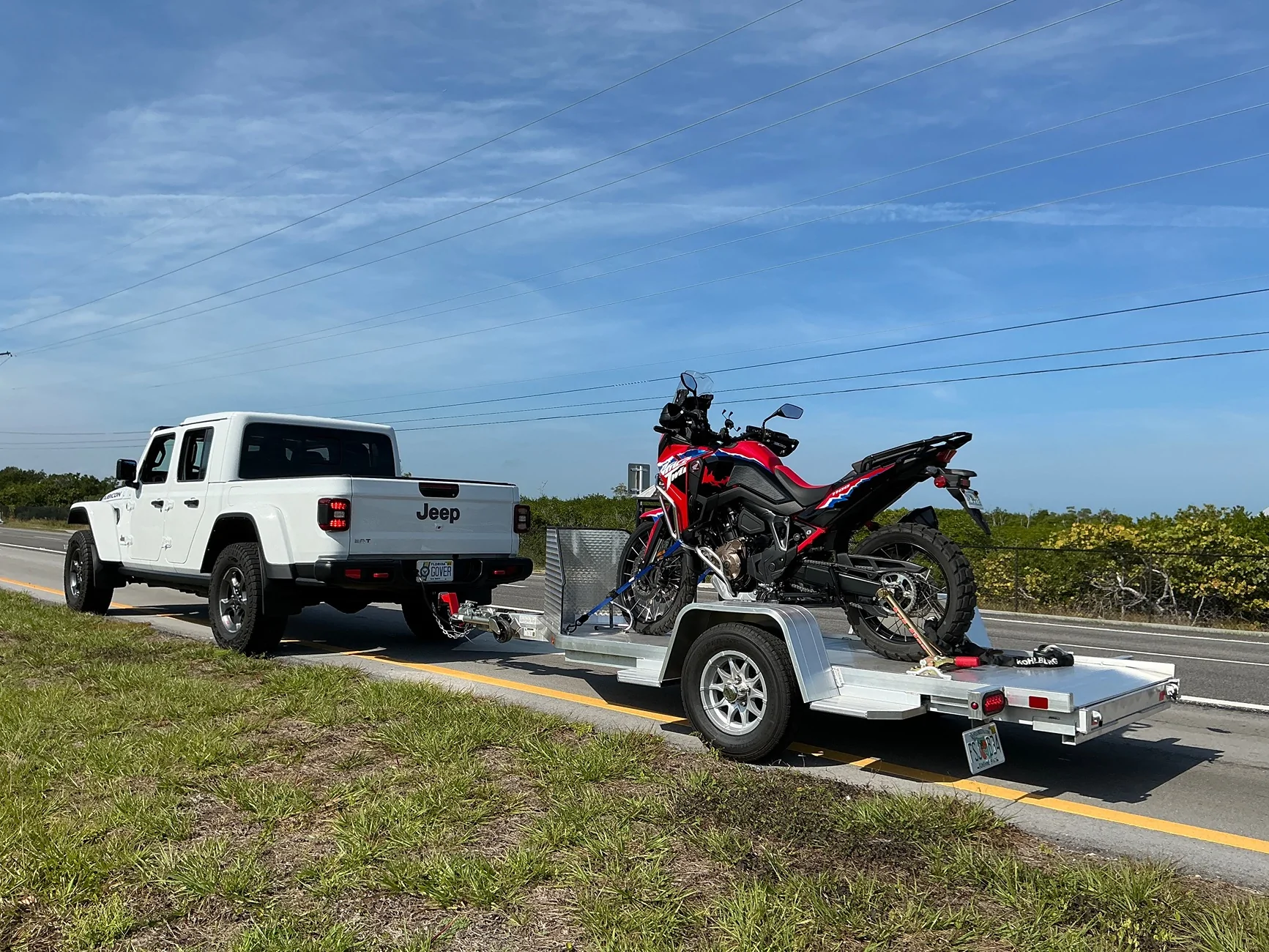

From years of experience with a hitch mounted carrier, I can honestly say my new motorcycle trailer is much easier and safer to use by myself. A word to those
Jeep Gladiator Long Distance with Motorcycle Hitch Carrier? IMG_0787
using the carrier - take your time, lay everything out in advance and get a helping hand if you can. Good luck.

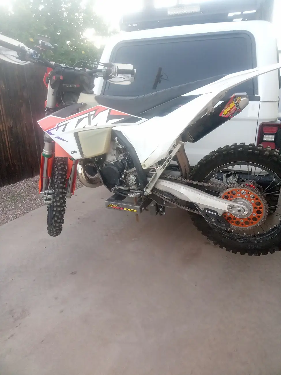

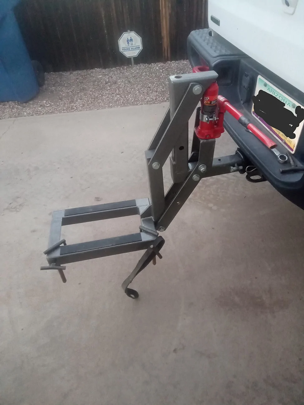

I'll throw this out there, I have been using a motojack rack (https://motojackrack.com/shop/) for my dirt bikes and it's been great, keeps the bike well fixed to the truck. No twisting like the ramp stuff.

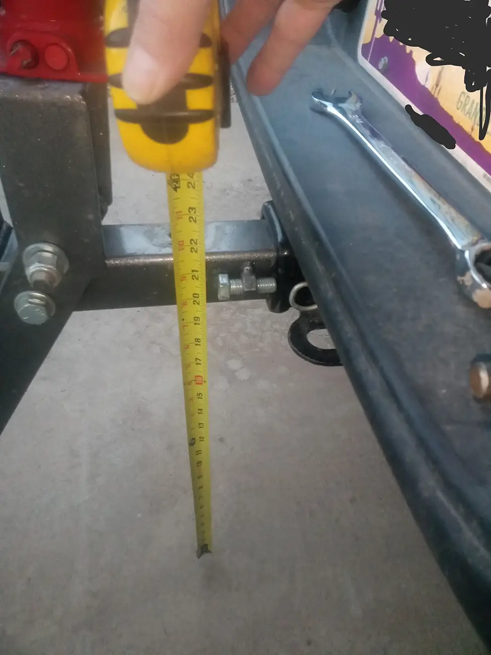

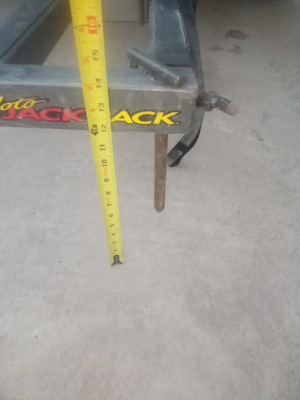

I have been looking at the MotoJack Rack and it's tempting me. I have a DR650 that I'd be carrying longer distances (I'll just ride my BMW R1200GSA if I'm going on a trip).
Did you order the extra 2" drop version? I have a lift on my Gladiator and I think that the extra drop should get the platform low enough to get under my bike's frame.
I did, but the drop throws off the geometry of the jack and with the lift fully dropped the geometry kind of locks itself together and has trouble lifting a 300cc 2stroke, if I keep the lift not fully dropped with about a 2" gap between the vertical bars then it lifts the bike no problem.
If you are thinking 650 then get the normal lift so it's less of a issue and get use to lifting the bike up a bit.

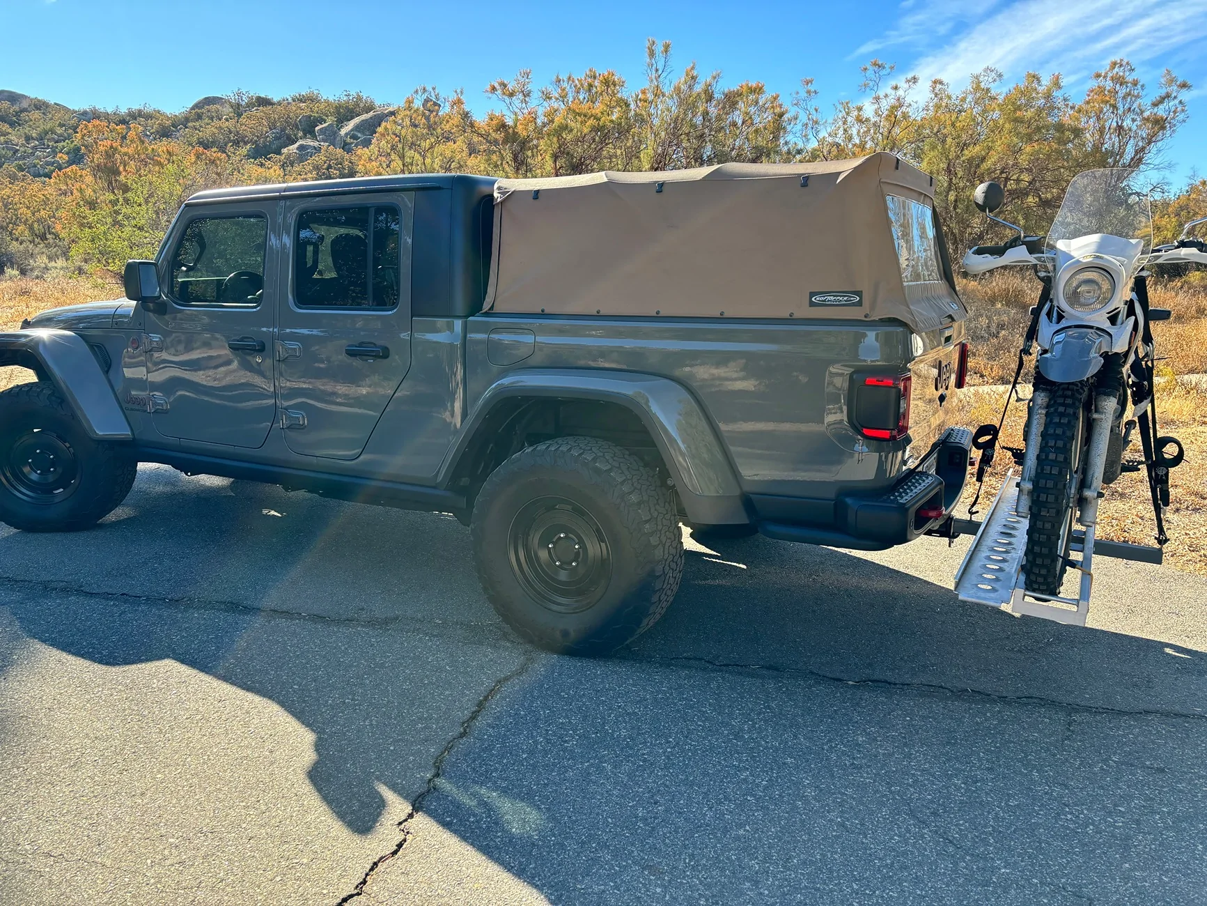

A couple thousand but not tens of thousands with this set up. Yamaha XT 250 with a black widow hitch rack. I used a hitch clamp to take some of the slop out. Bed full of camping gear.
Frankly, it was not ideal. Too much rack movement and rear bounce. I recently installed a set of airlift 1000. Haven’t tried it with the rack/moto yet. I expect the improvement to be marginal.
Like others, I think a small trailer would be better,
