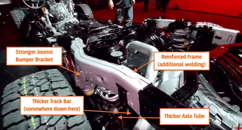

Autoweek claims that the Mojave axles are heavier-duty than Rubicon. I think they are wrong, but they actually cite tube thicknesses... Where are they getting their info from?! Perhaps they are comparing to the Sport / Overland axles, not realizing the Max Tow / Rubicon axles are already beefed up and identical to the Mojave?
Can anyone confirm that Autoweek is mistaken?
https://www.autoweek.com/drives/a32...r-mojave-on-the-desert-trails-that-shaped-it/
Under the metal, Mojave has stronger axles with cast-iron steering knuckles up front and thicker tubes in the rear. In fact, the rear axle tubes went from a 6.25mm wall thickness on the Rubicon to 10.5mm on the Mojave to resist fatigue.

Four wheeler also states that the Mojave has thicker tube walls at 10MM, BUT...also states that both models now share the third generation axles with 10MM tube walls, but the front difference is the Mojave has the cast iron ends versus aluminum on Rubicon, and they go on further to say they both have the same third generation rear axle. I had posted in a Mojave thread about the thicker tube walls, and when questioned by a member pointed to a video of an engineer doing ramp articulation tests between Rubicon and Mojave. Guy was pretty good, he stated Rubicons was 8MM versus Mojave 10MM, Mojave had better artuculation then the Rubicon by a little bit if Ruby sway bar was connected due to Mojave front suspension being an inch higher, but Mojave was blown away when the Ruby disconnect the sway bar. He also said teh Ruby was going to benefit with the thicker walls in future 2021?? I'll look for the video. Why not put the cast iron knuckles on the Ruby also it will be the one to run much larger rock crawling tires then the Mojave? Wouldn't cast iron be same or less then aluminum?
Benny can you tell us if the 2021 Rubicaon and Mojave have the same axle part
number ? Perhaps compare the 2020 part numbers also? Thank you!

Thanks. I agree that it’s confusing and crazy that we don’t have confirmation yet! You’d think that Jeep would highlight the thicker axle tubes on their press materials if it were truly the case as seems like a pretty big deal. Hoping Benny can add some clarity. The fronts will be different for sure as the Rubi has lockers. Rears should be the same.
Regarding the knuckles, I think it has more to do with high-speed impacts. Cast iron is more resilient and can absorb the impacts while aluminum would be more likely to crack. The aluminum is likely plenty strong for slow rock crawling, big tires or not. Just my guess.
Here is what I come up with
Front Axle Housing Part #
2020 Mojave 68526133AA
2020 Rubicon 68477136AA
2021 Mojave 68526133AA
2021 Rubicon 68477136AA
