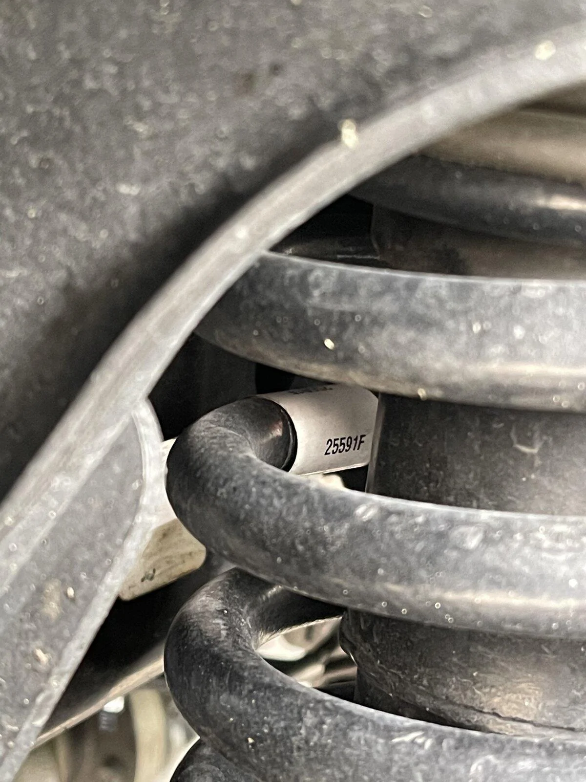

Both. Here is the front driver.
Interesting! My 2021 Gladiator diesel Rubicon sets 3/4” lower on front passenger side, was told by dealer it’s because fuel tank is on passenger side, I drove till almost empty only came up 1/8” of an! I believe its definitely a spring issue
Hmmm....Fuel tank is on driver's side? LOL!

2021 gasser and diesel springs are different.
Diesel sport/overland have both 6377AA front springs. Rubi F/R is the same, but F/L is 6378AA. However, both rear springs are different between them.
