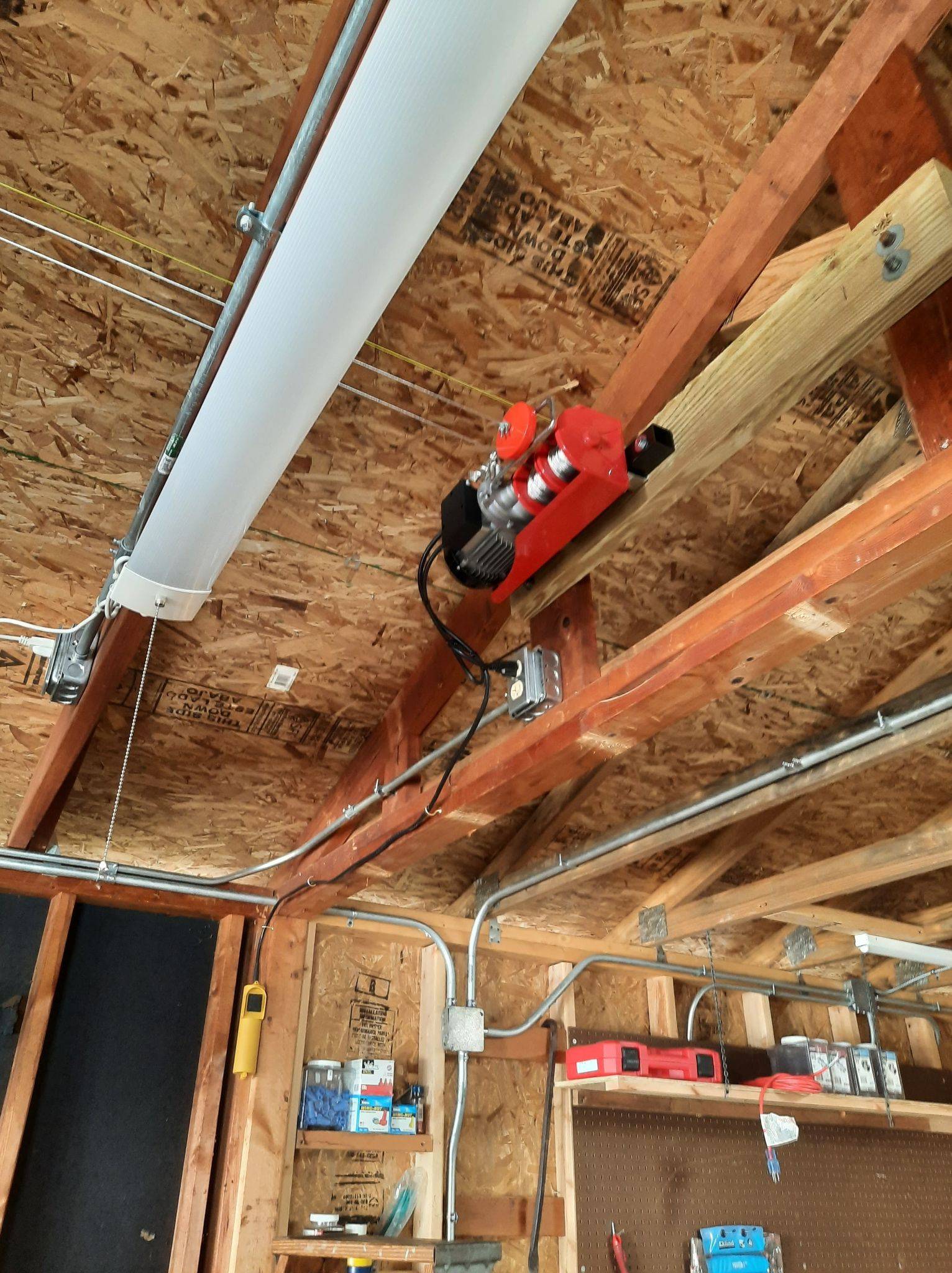

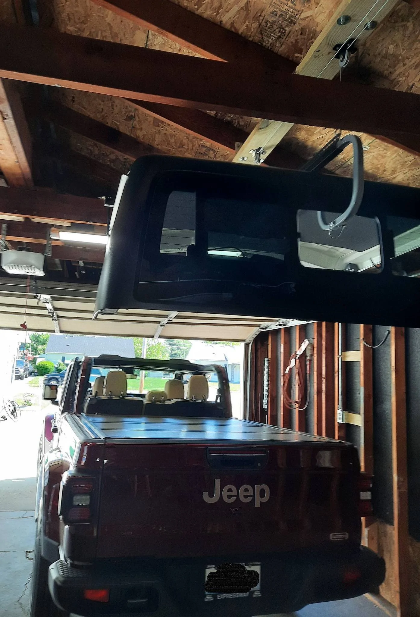

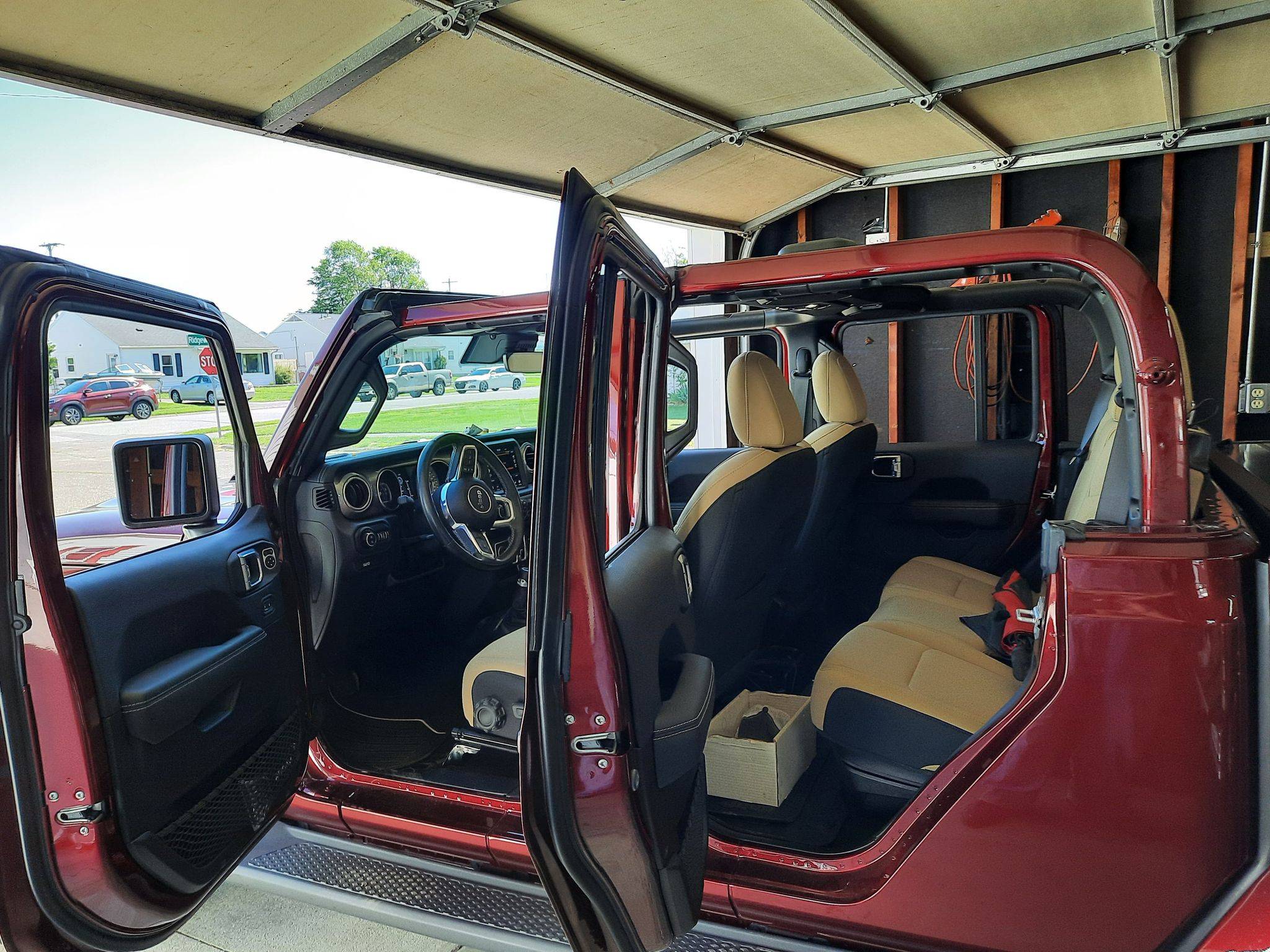

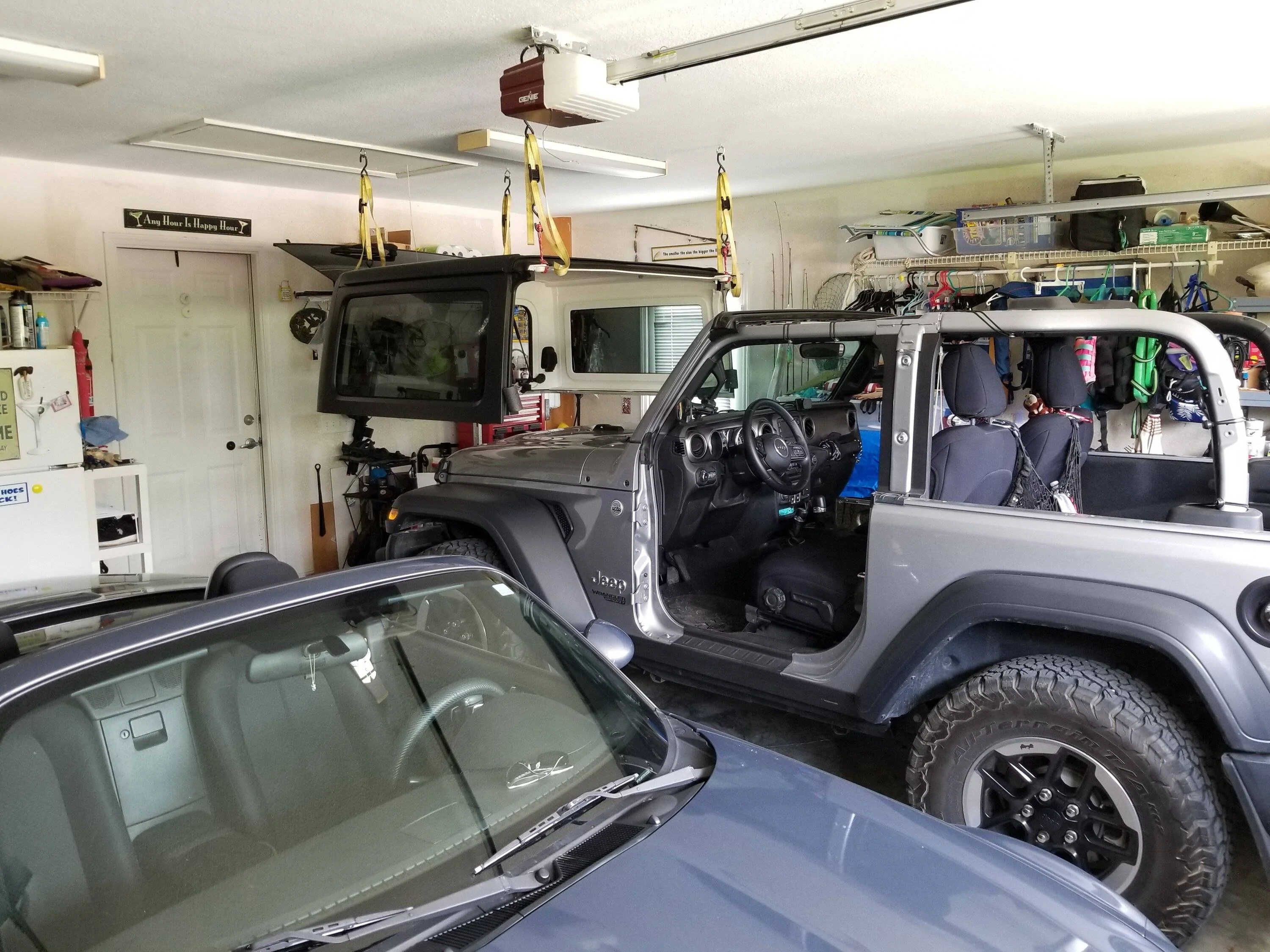

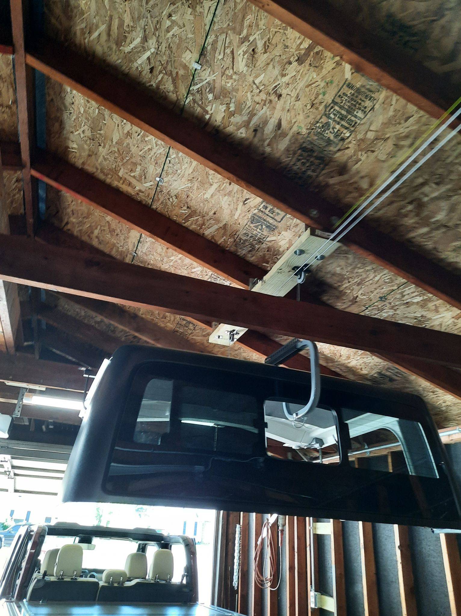

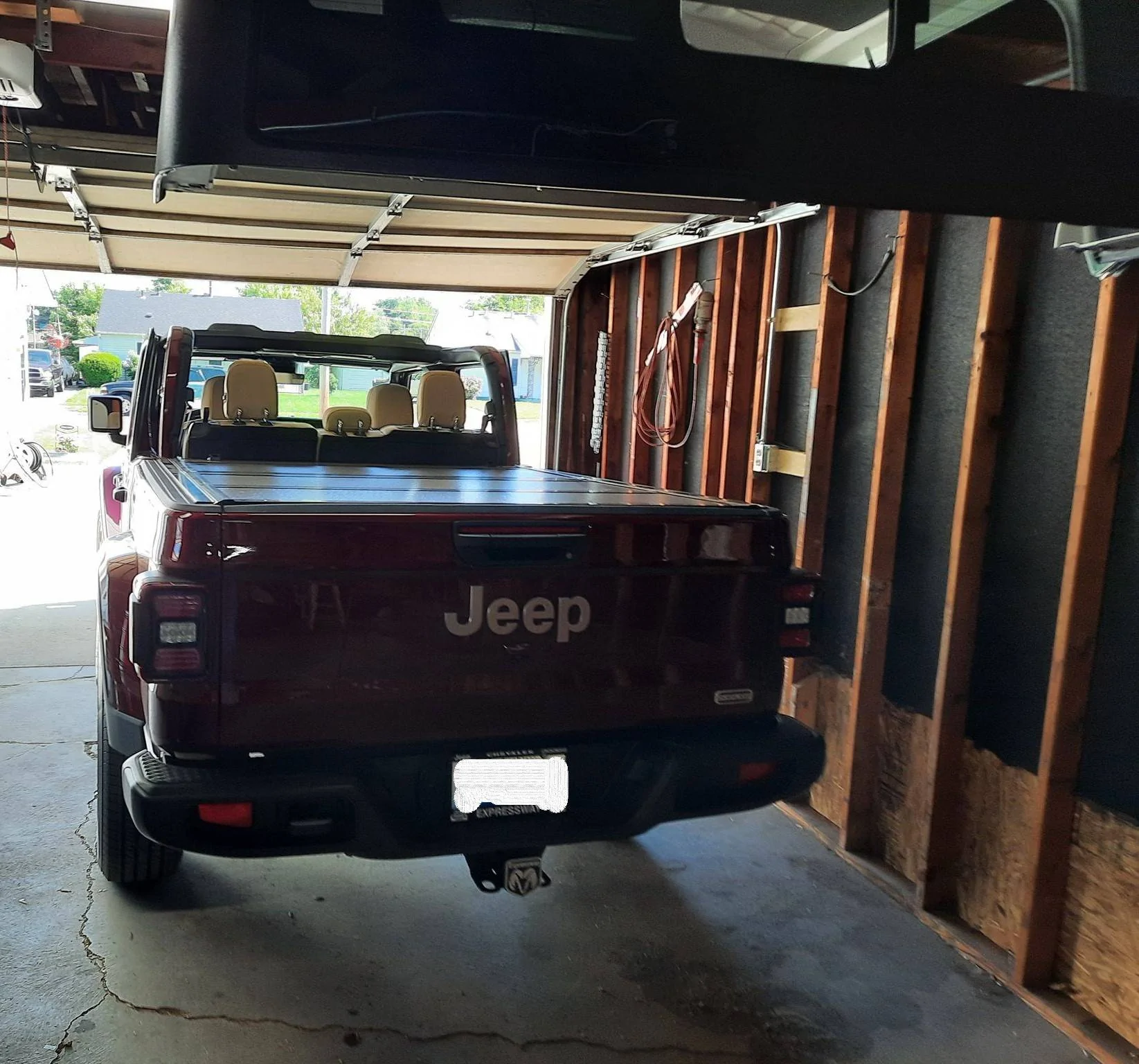

I should have included pictures. Here you go.
I do my JL 2 door the exact same way, even with the rope loops at the front.
A lift would be nice, but this was cheap and works well with my low garage height and other stuff in the way.
Jeep Gladiator Gladiator top removal - best way to remove myself? 20200329_112313

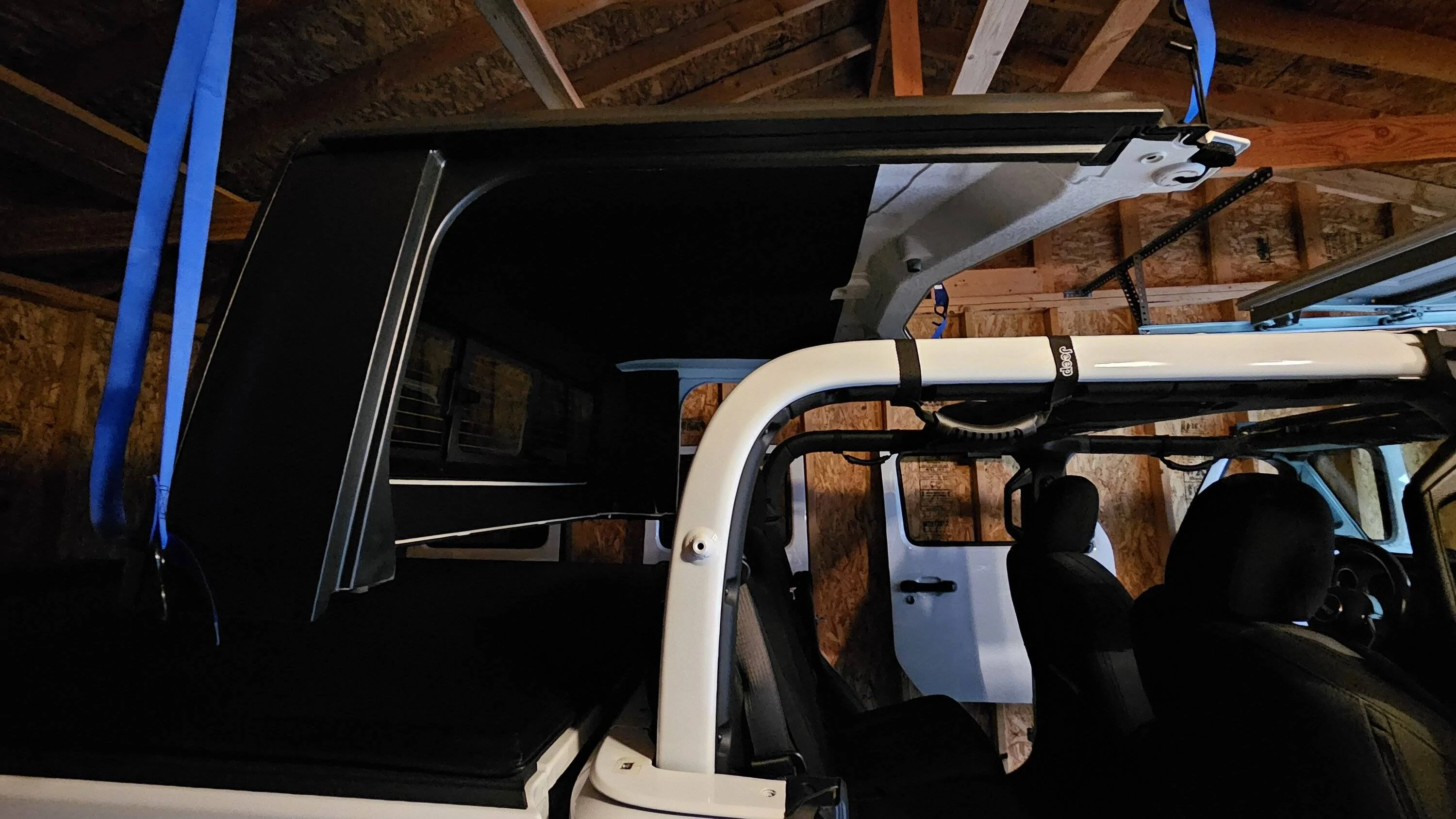

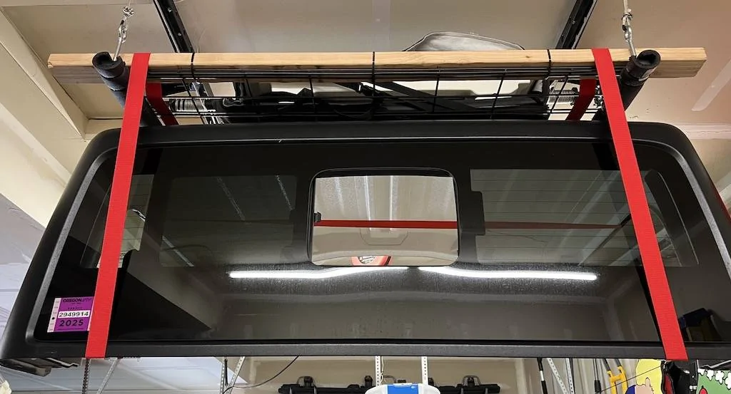

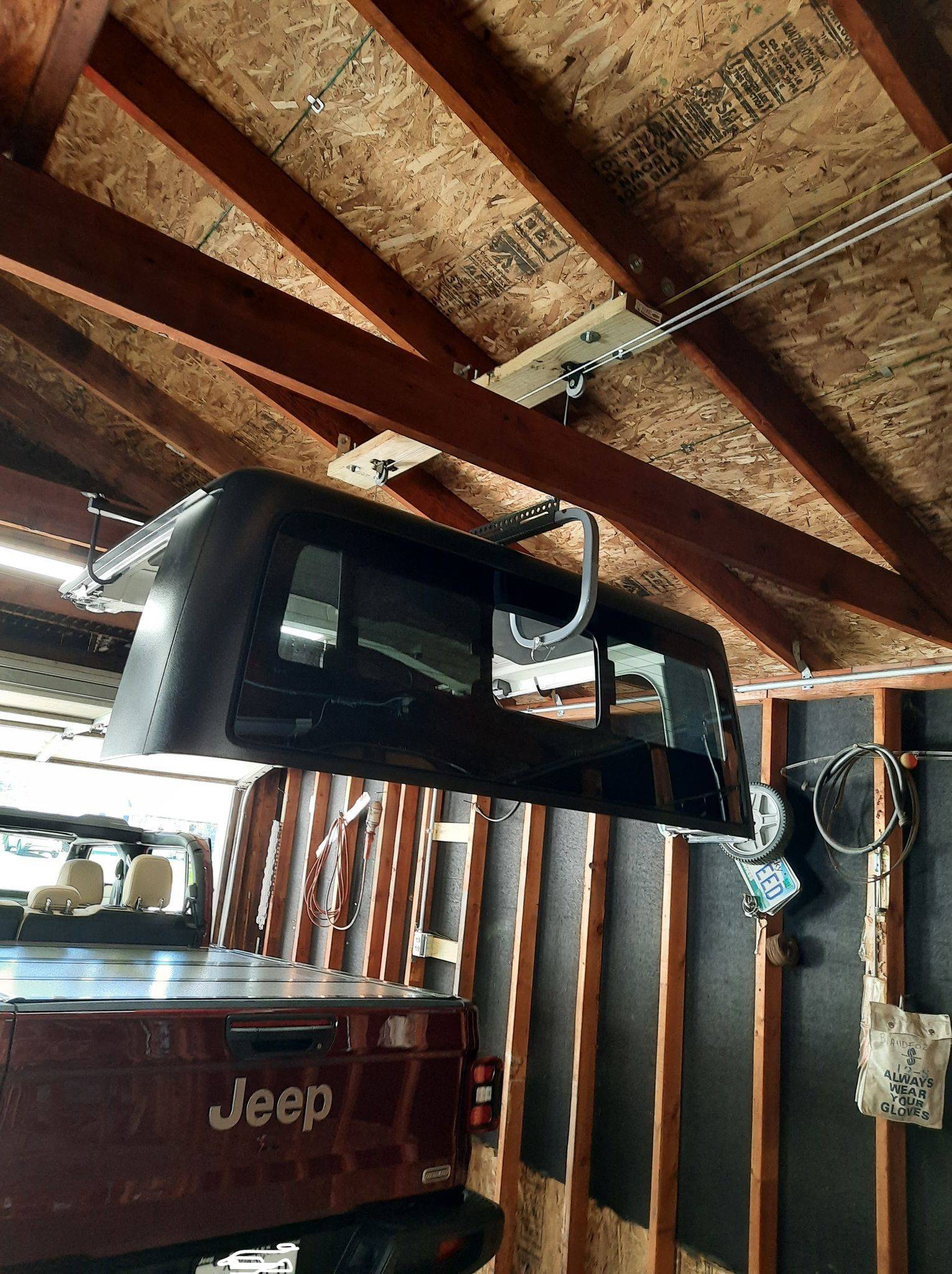

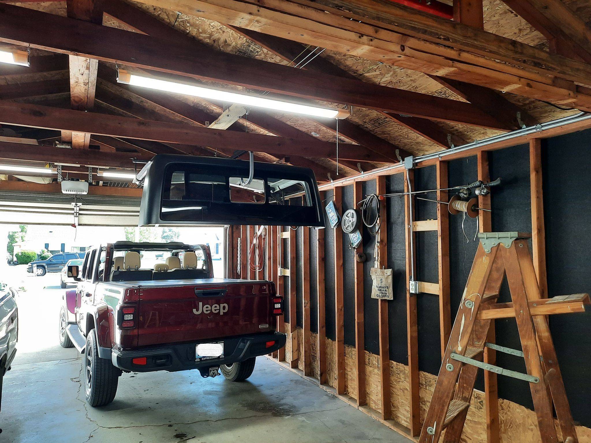

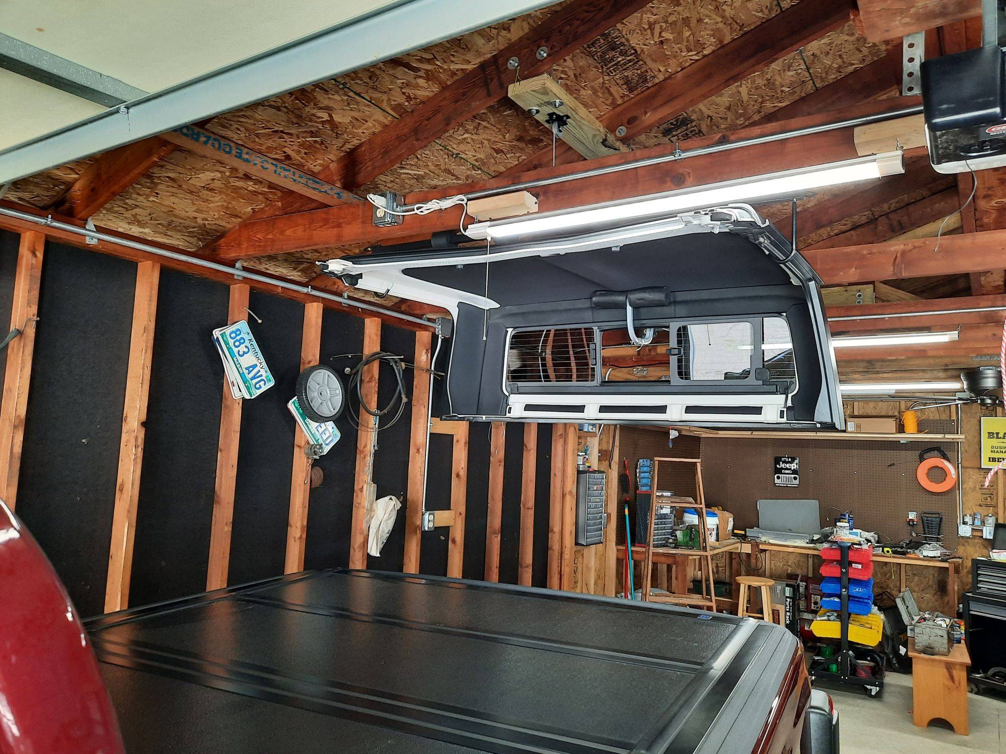

I made this to work for my situation, low ceilings and limited floor space.
Nice work! Those hangers are beefy enough to lift the whole truck! Lol ?
I’d like to borrow your hook design ??
Yea I need some more details on how you made the hooks. I have the same issue, super low ceiling height. I have a large carabiner basically that I've wrapped in pool foam and electrical tape. It's the only part of my lift system I really hate.

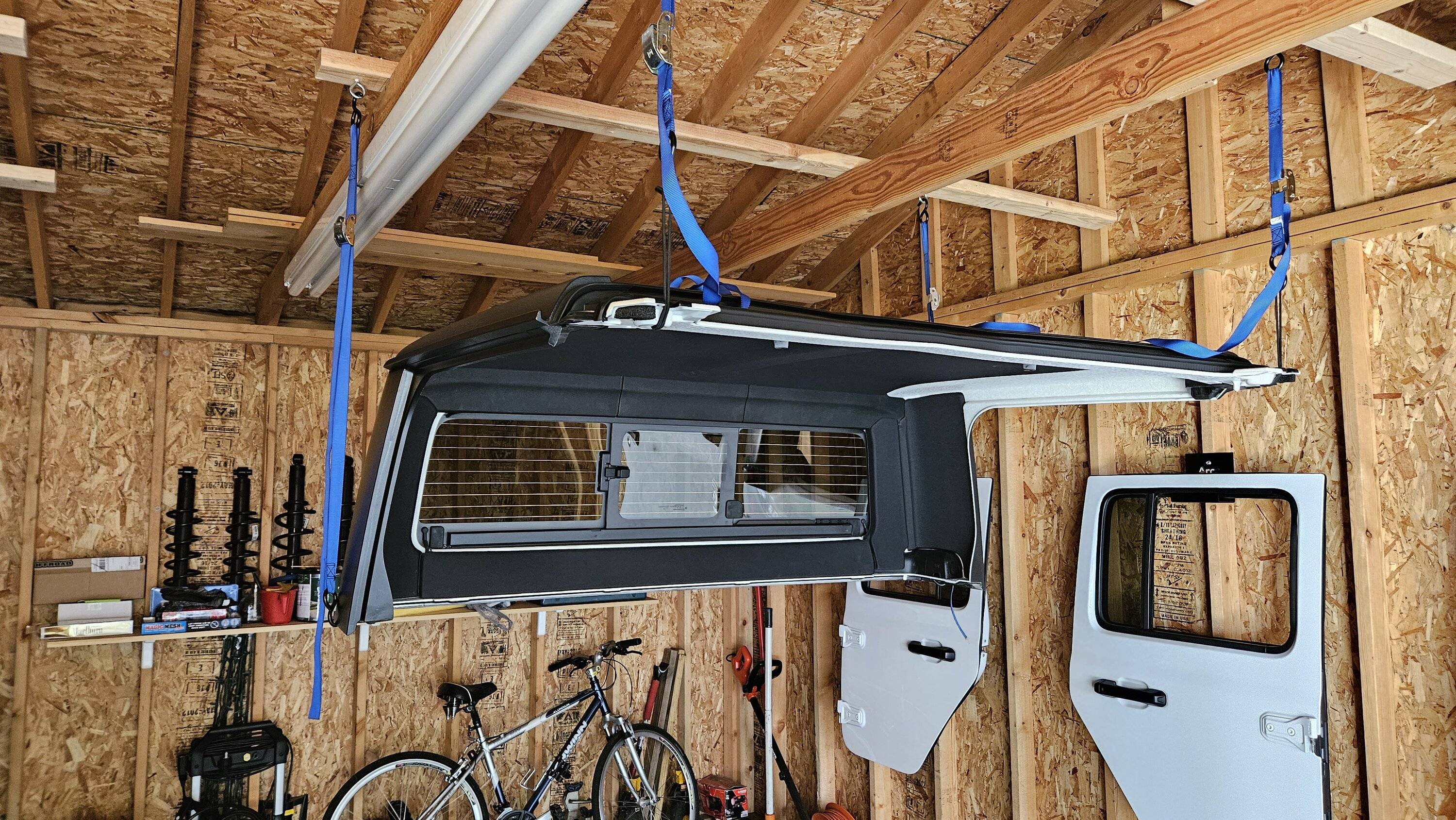

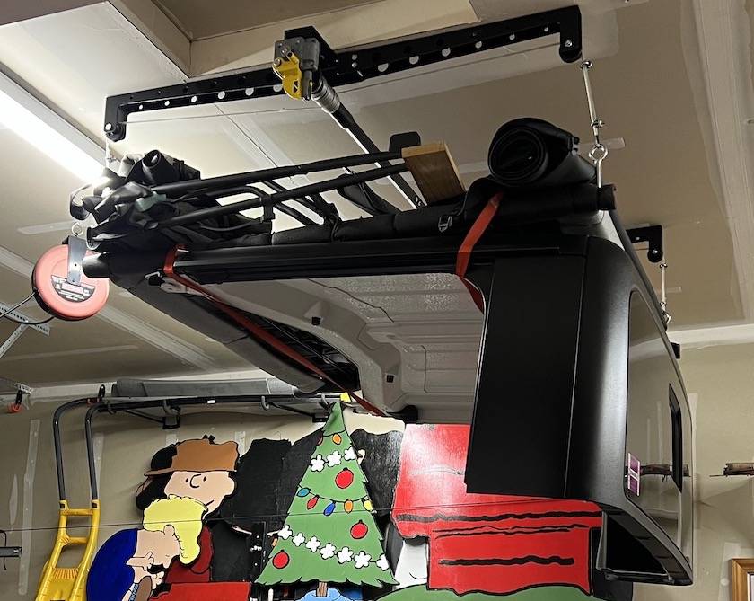

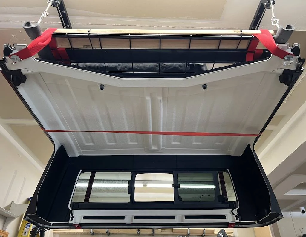

This was about 250 bucks plus the 2x6s and took me about 4 hours to install. Makes it very easy and I just keep it lofted to the ceiling for storage.
Are the straps going through the back window?
It's hard to tell based on the photos.
