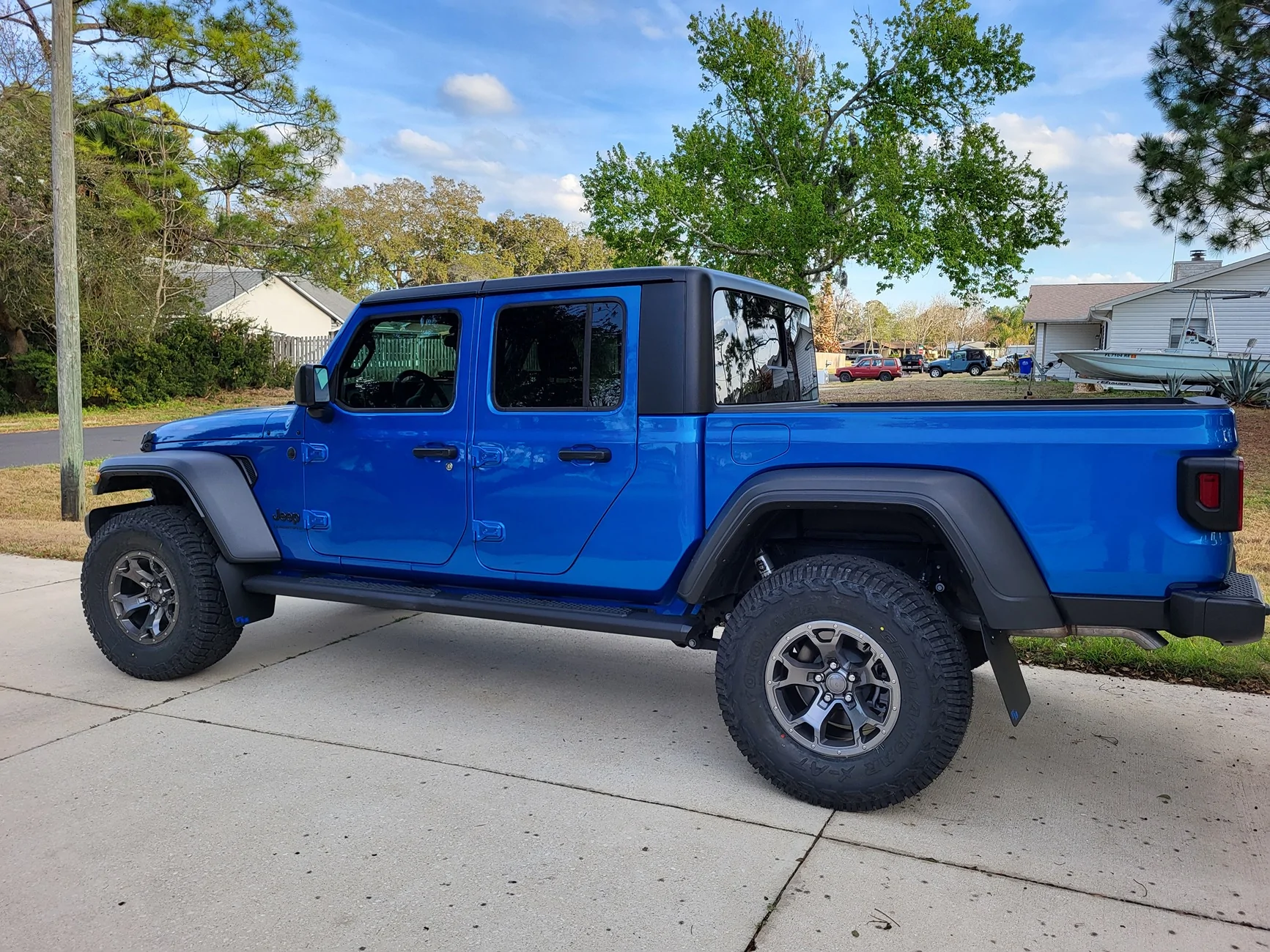

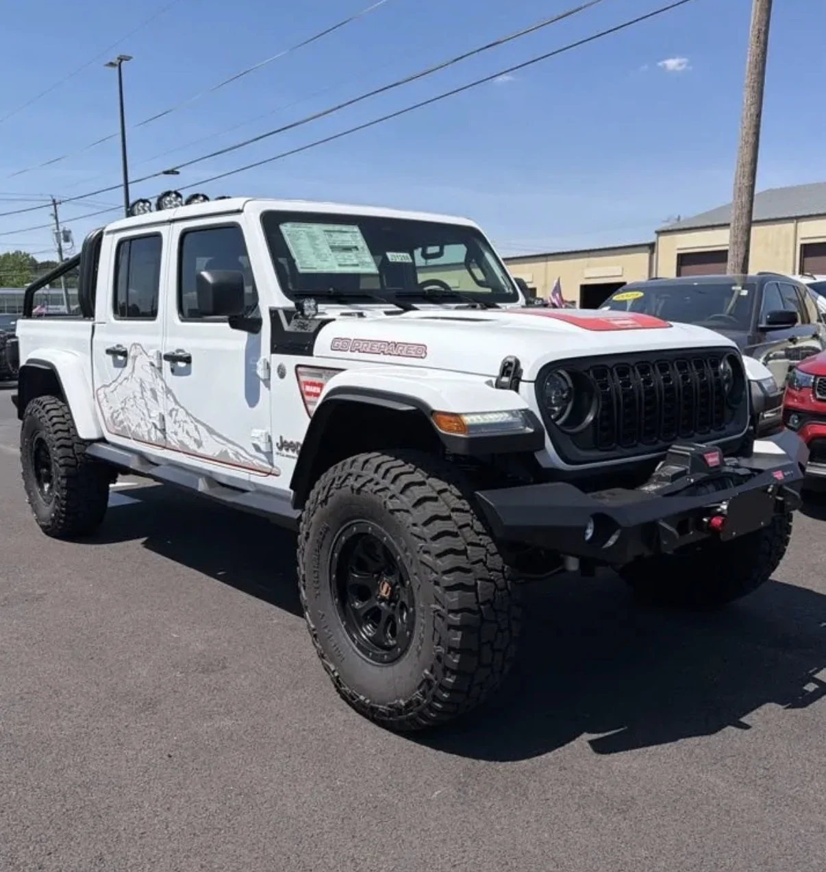

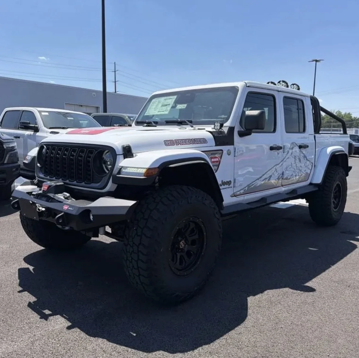

Just finished intalling a Mopar lift and added 1 inch teraflex spacers in the front. It's on 315s for now until I can affort 37s and a gear change.

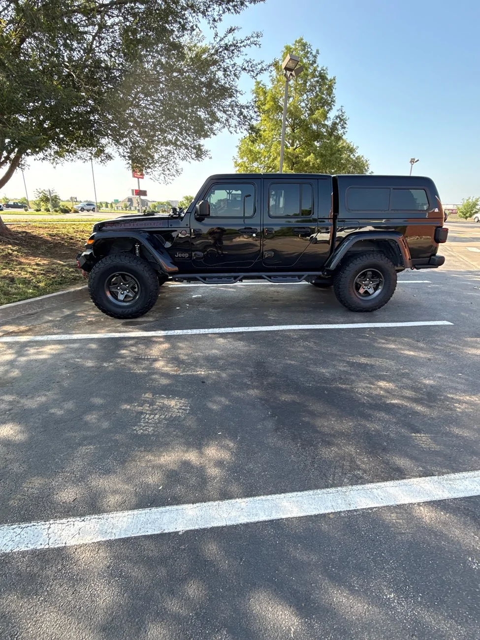

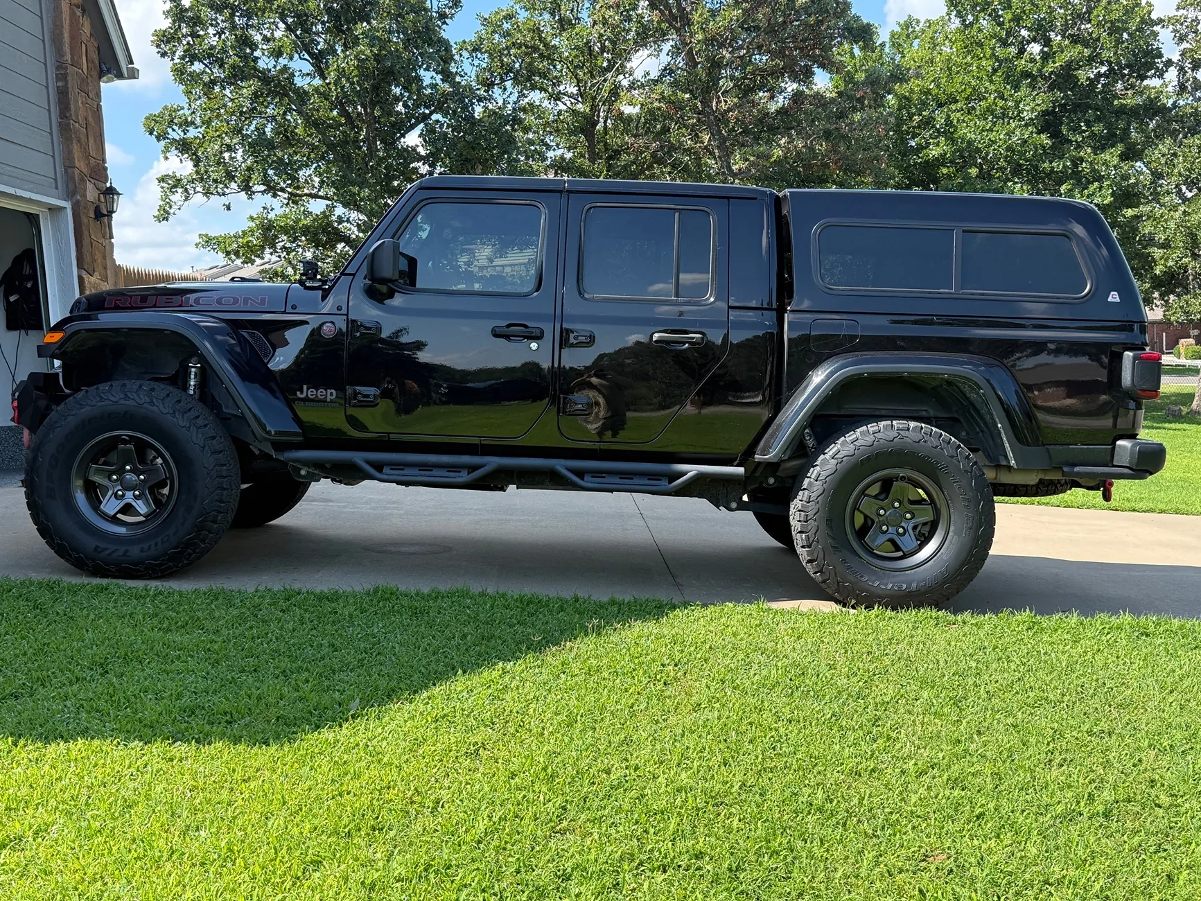

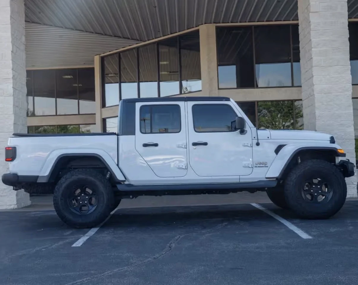

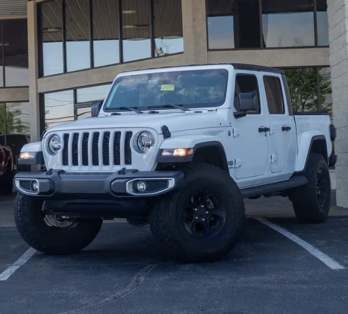

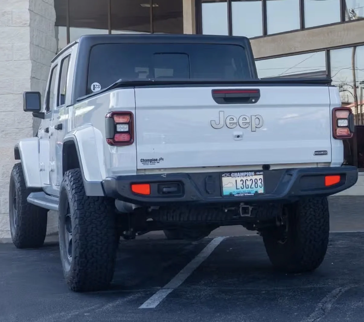

Had the lift installed 2 weeks ago, then realized it made my 35s look small so off to discount tire for some 37s went with ko2 a due to there smaller size but still big enough for me . .i Left a 1/2 Terra flex spacer up front to counter the bumper and winch weight and left 3/4 daystar rear spacer in back to counter the century top and roughly 200 pounds of gear I keep in the back set it up pretty much level 3 inches all the way around
Jeep Gladiator Gladiators on Mopar 2" Lift Kit IMG_9600
Jeep Gladiator Gladiators on Mopar 2" Lift Kit IMG_9602

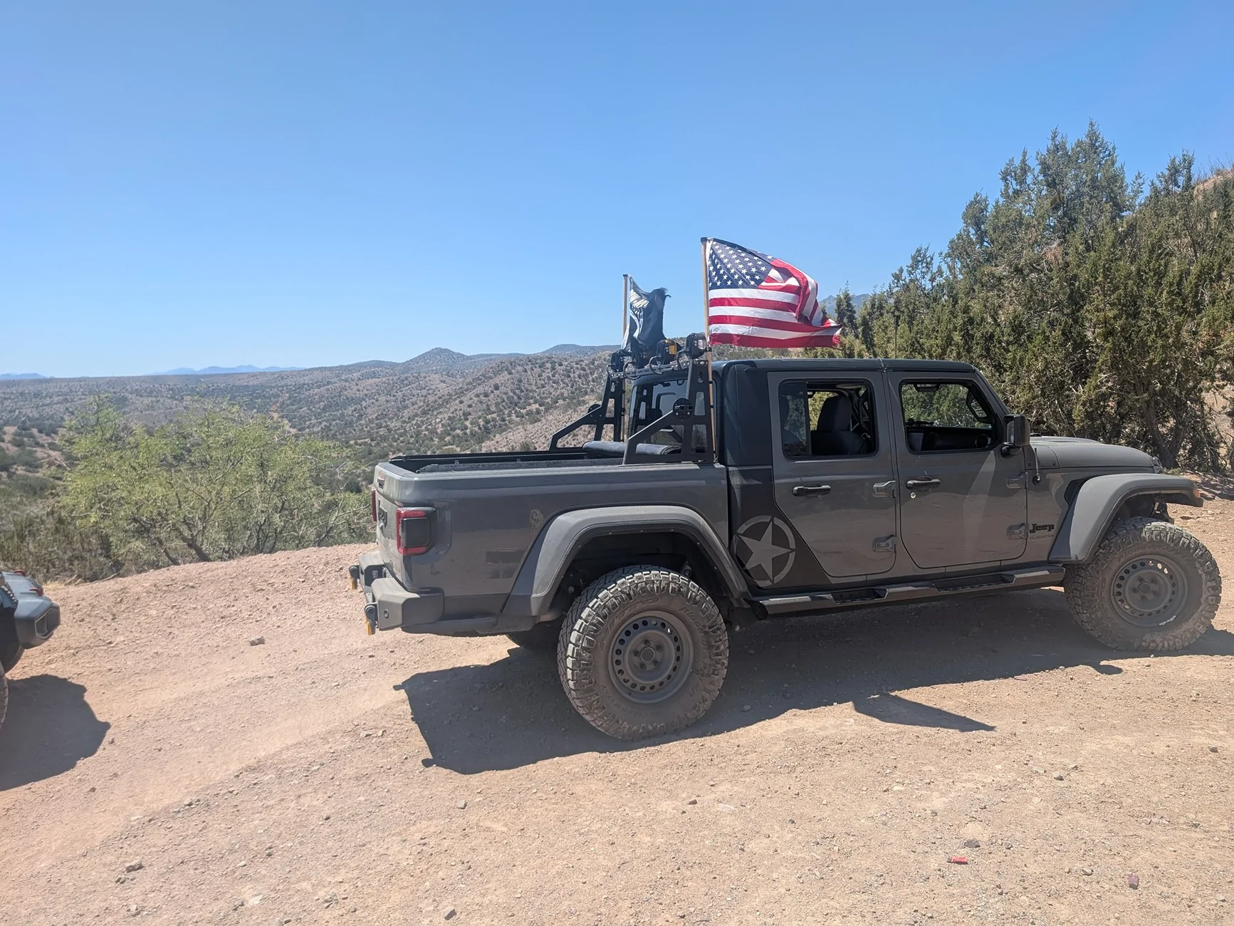

35x11.5r17 ridge grapplers, oem steelies, 3/4 đây star front spacer
