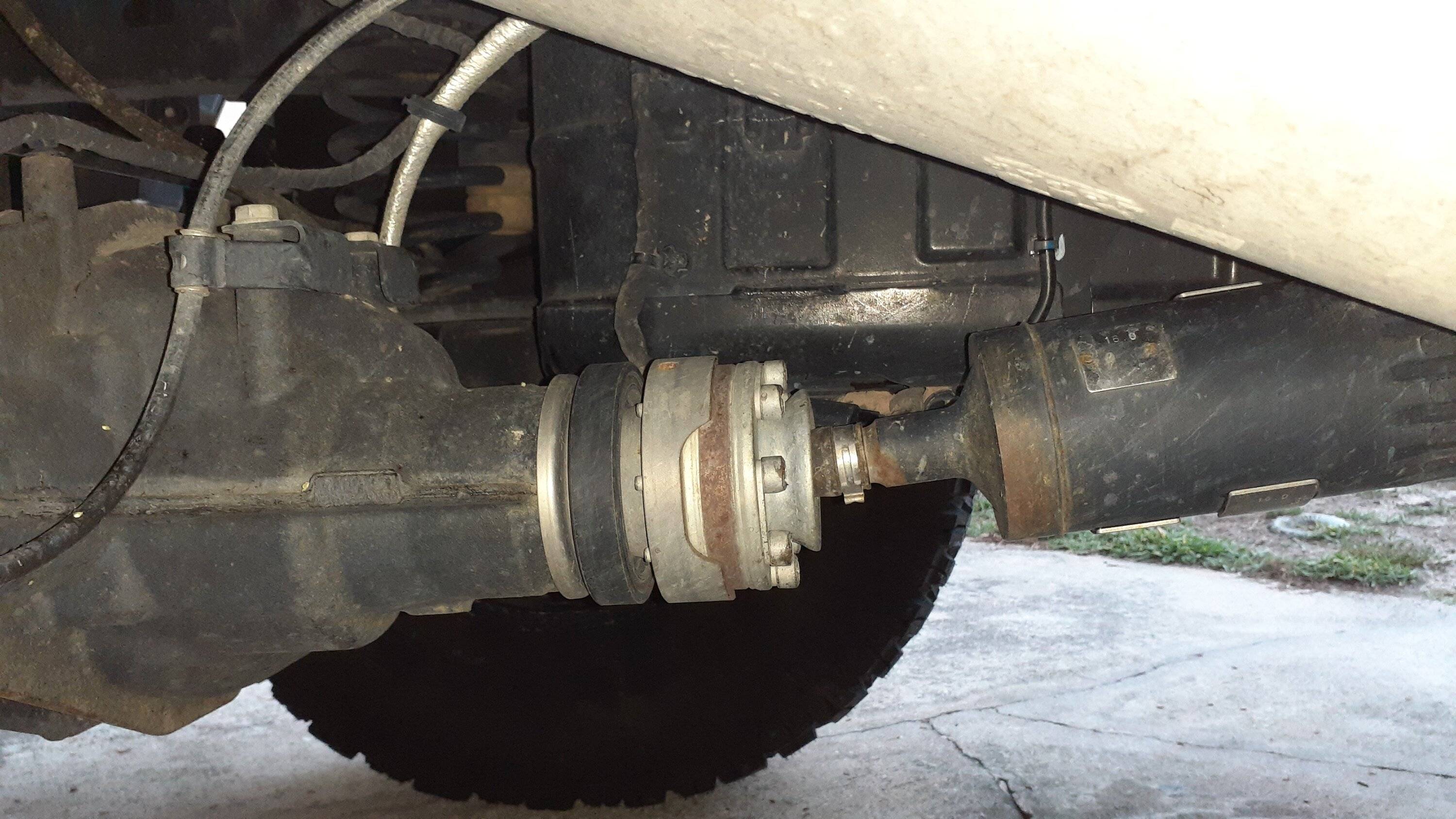

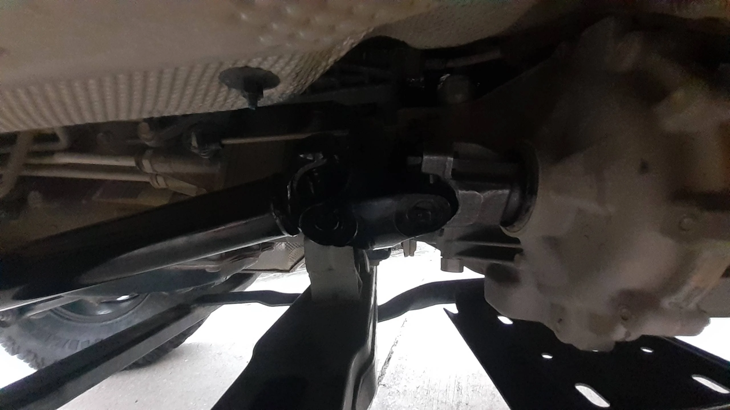

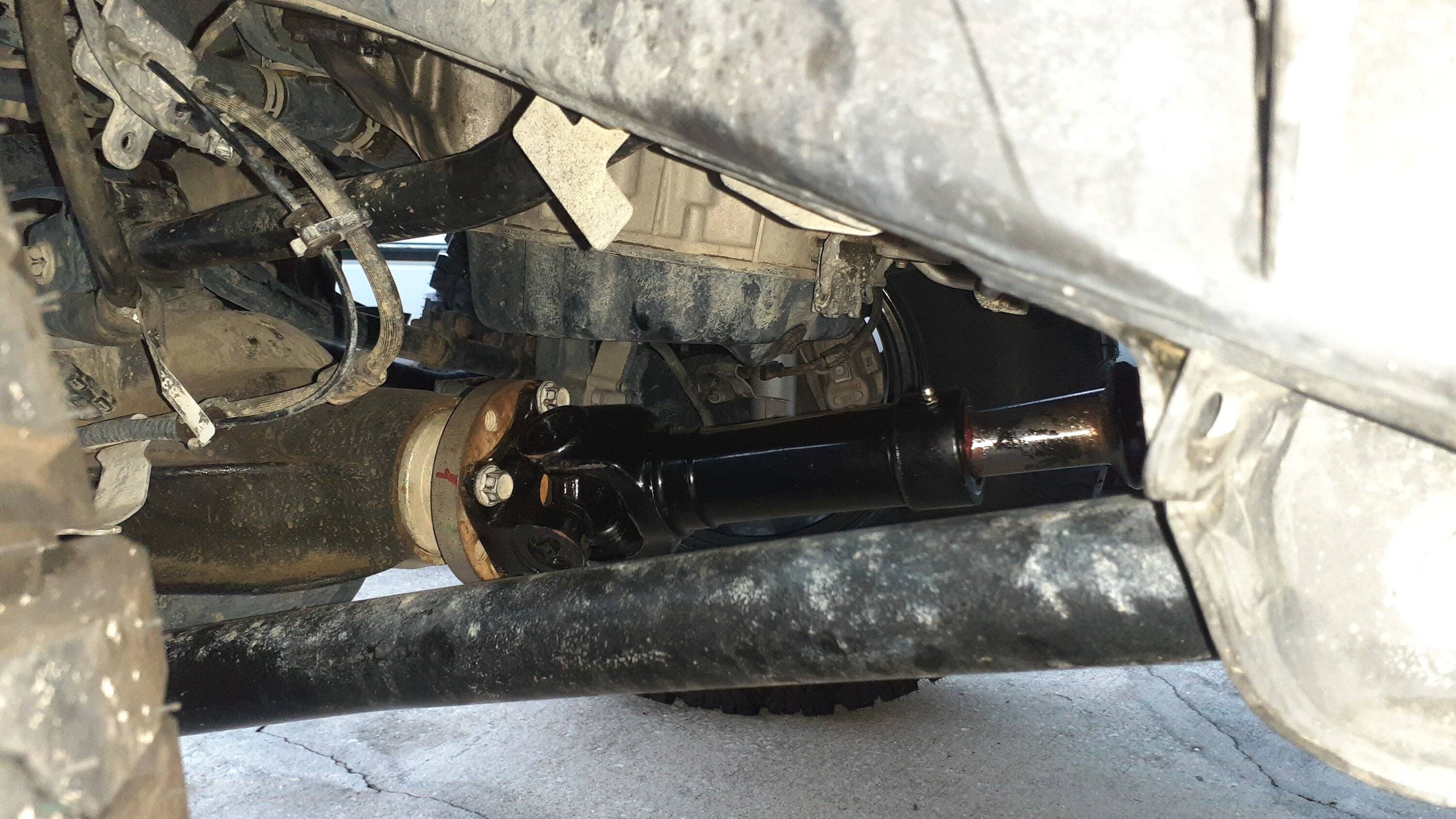

For starters your pinion angle is probably awful with a 5.5” lift. Upgrade to a 1350 drive shaft drive shafts or carry spare u joints
I think the pinion angles are okay.
I haven't lived the rear yet but will adjust accordingly.
Went from 3.5"to 4.5" springs plus 1" spacers while I decide on which full length coil springs to get.

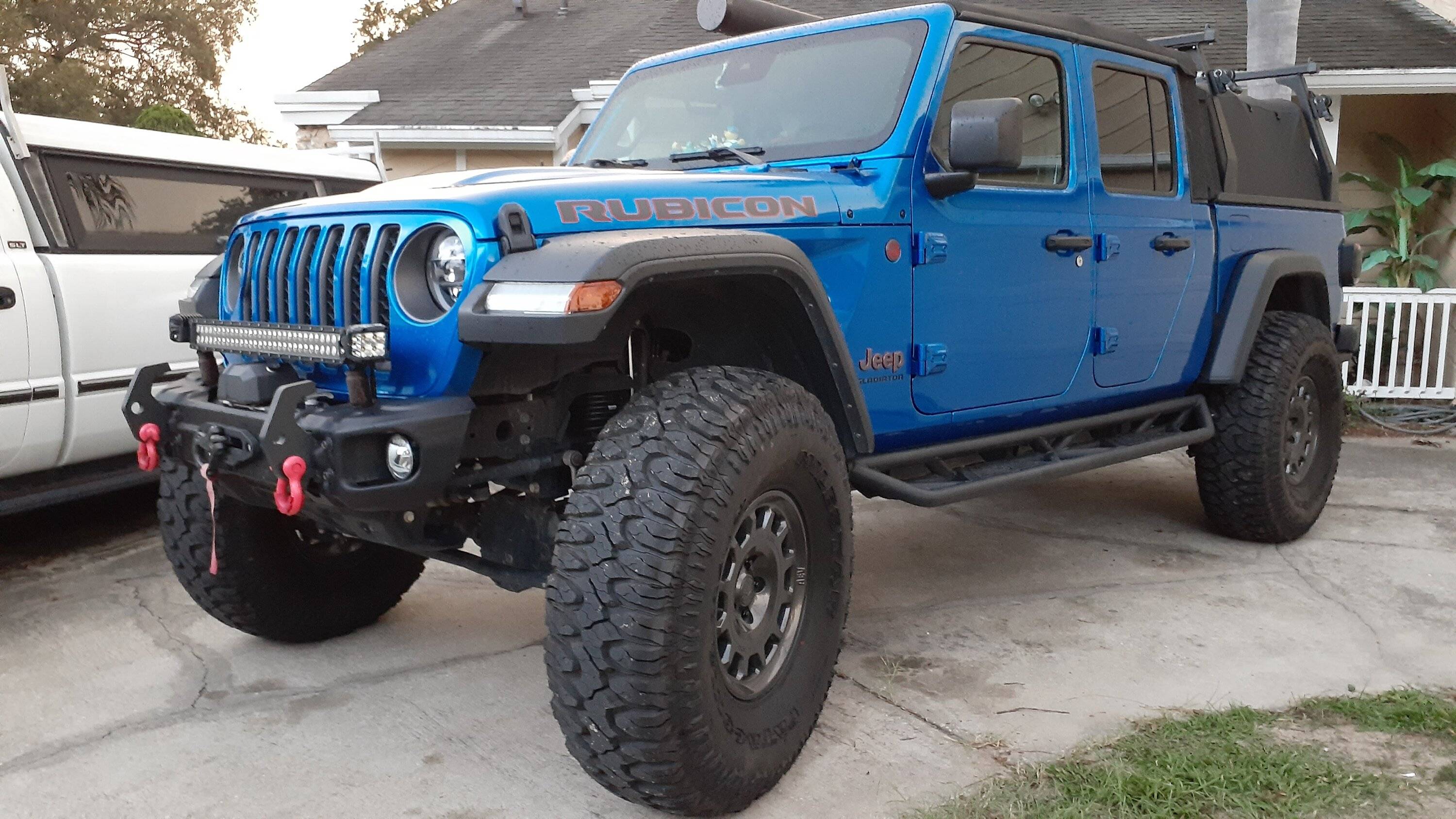

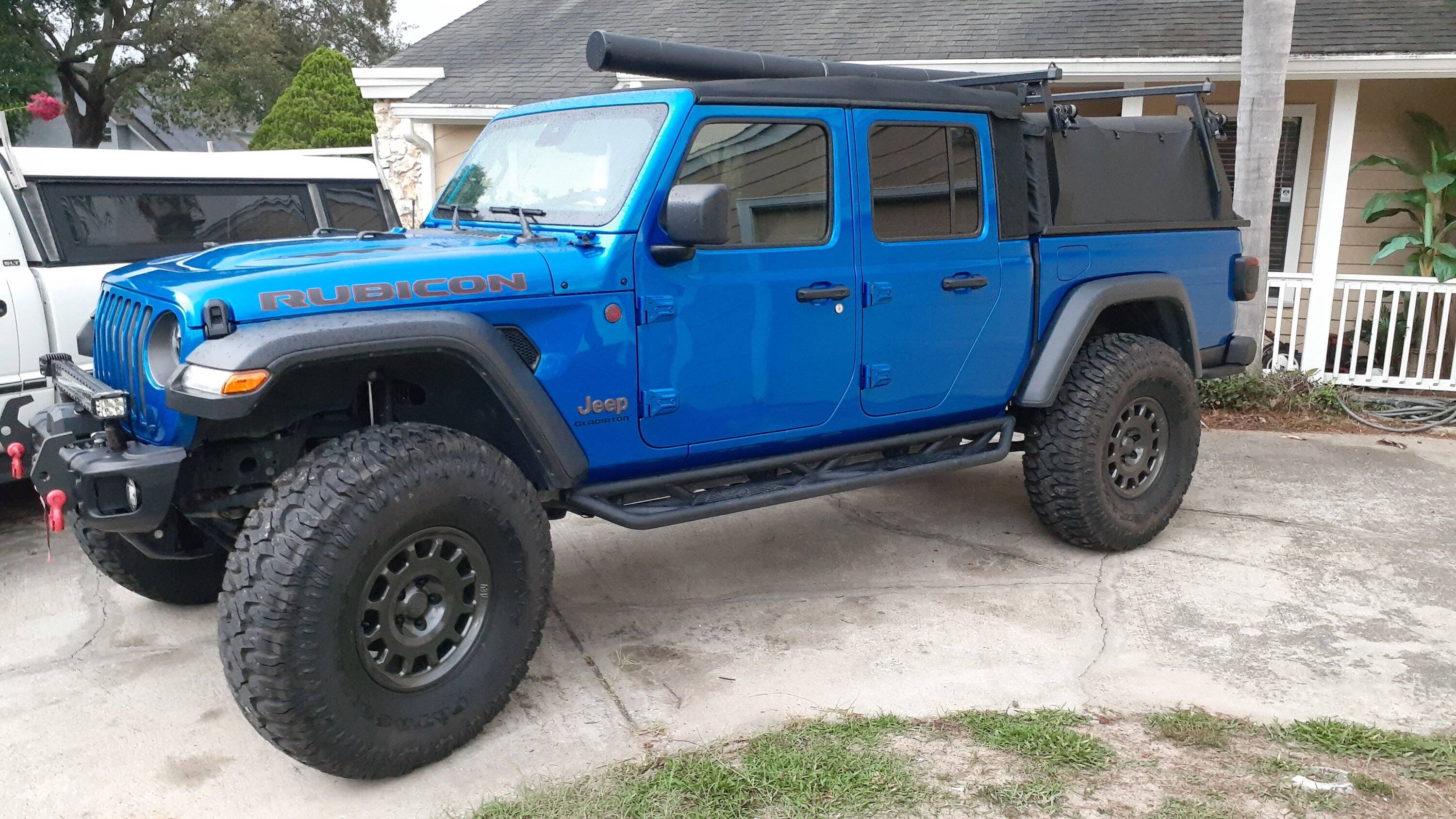

I came here for the pictures of 5.5" lift with 40's and am disappointed...
Here ya go!
Jeep Gladiator Going 40s... New concerns... 20230718_195535
Jeep Gladiator Going 40s... New concerns... 20230718_195601
Jeep Gladiator Going 40s... New concerns... 20230718_195617
Jeep Gladiator Going 40s... New concerns... 20230718_195303
Jeep Gladiator Going 40s... New concerns... 20230718_201040
Pics with a new paintjob!
Jeep Gladiator Going 40s... New concerns... 20230806_130752
Jeep Gladiator Going 40s... New concerns... 20230808_113446
Jeep Gladiator Going 40s... New concerns... 20230827_172121
