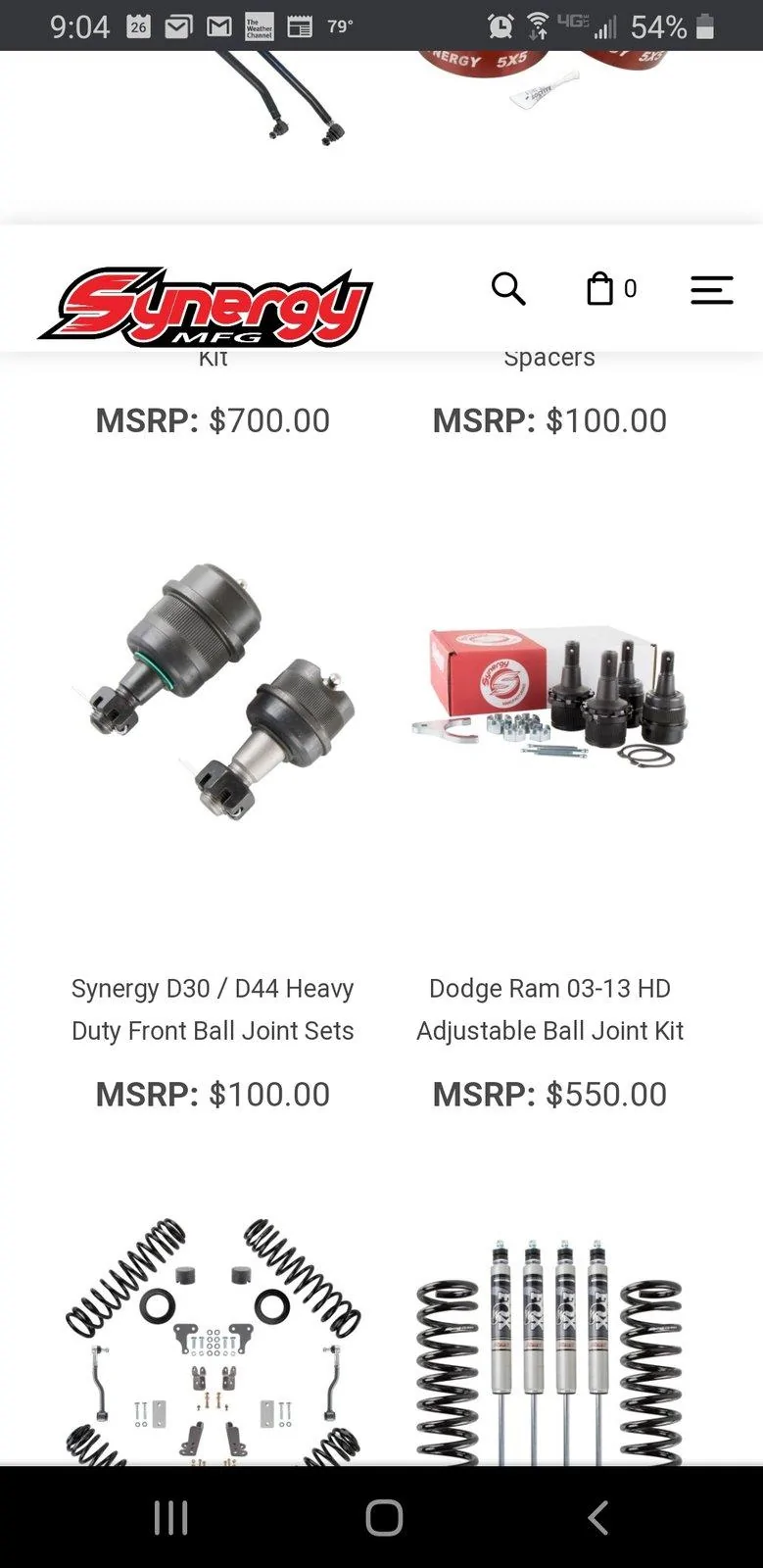

Did a quick search for knuckles and couldn't find anything...I'm sure your local offroad shop could point you in the right direction. These Synergy ball joints have a pretty good reputation and are what I used on my JK. They are noticeably beefier than stock. They aren't real expensive but it is a good half day job to replace them yourself if you haven't ever done it before.
