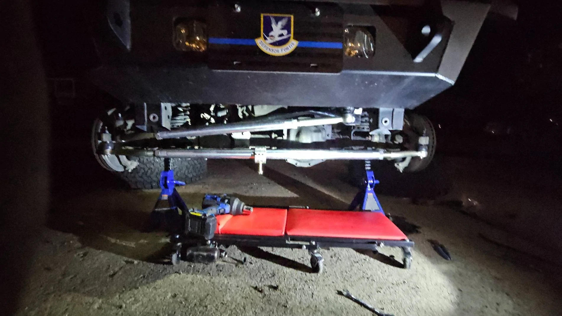

Got my new steering done. I decided to go with the Rusty's Offroad HD steering kit and trackbar with the brace too. I still need to do the sector shaft brace. I'm pretty pleaseed with it. I got lucky and they were doing a special where they included the alignment kit with the steering purchase. Holy cow, it is so much easier to do it with those.
Jeep Gladiator Going to 37s eventually, What steering upgrades are mandatory? 20250404_213923
