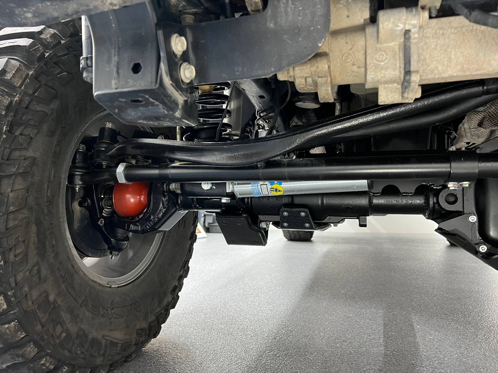

Here’s a photo of my previous JTRD’s front end. 3.5” Clayton, 37s, trussed, with the Rock Jock high steer kit. Drove much better than stock.
What axle shafts are those? Or is it just some kind of boot over your U-joint?
