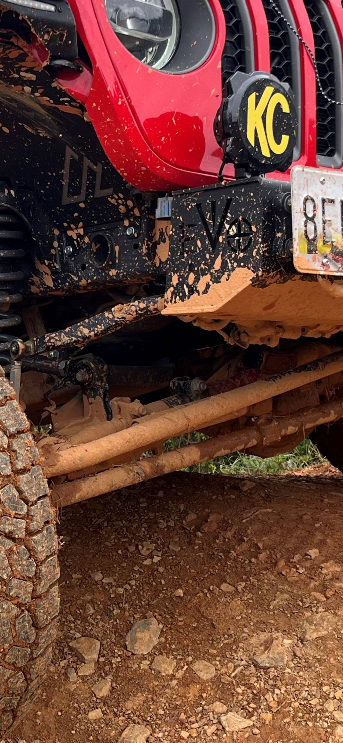

I have 37's on my Rubicon and the best thing I have done so far was to upgrade my steering. I went with Synergy draglink and tie rod. I already had a Yeti Track Bar but I may take it off and swap that to Synergy as well. I know this will bring some strong opinions on here....but I am not crazy about the yeti...has non rotating OEM bushings on the ends and way too thick for no real reason. The Yeti barely clears my diff cover at full flex. That and the damn cuff has to be positioned perfectly to not contact a flipped stabilizer. You can kind of see that in my picture. The bottom bolt came in contact a few times when I was wheeling. Yeti does "look cool" though.
Also snagged a free falcon top rod mounted adjustable stabilizer for a JK for free. They fit on the JTs and JLs if you get the right cuff size for the tie rod. Still need to re-gear though, then its on to a front drive shaft.
