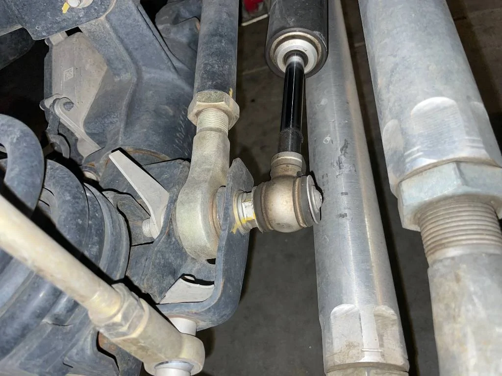

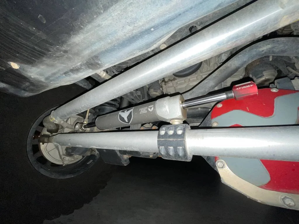

Looking at STEER SMARTS - front and rear track bar
yeti xd tie rod assembly
yeti xd drag link with xd atcuater
REGEAR -down the road
You are on the right track --- Drag Link, Tie Rod, Steering Stabilizer - Move the Stabilizer on top of the Tie Rod. Front end will feel great.
