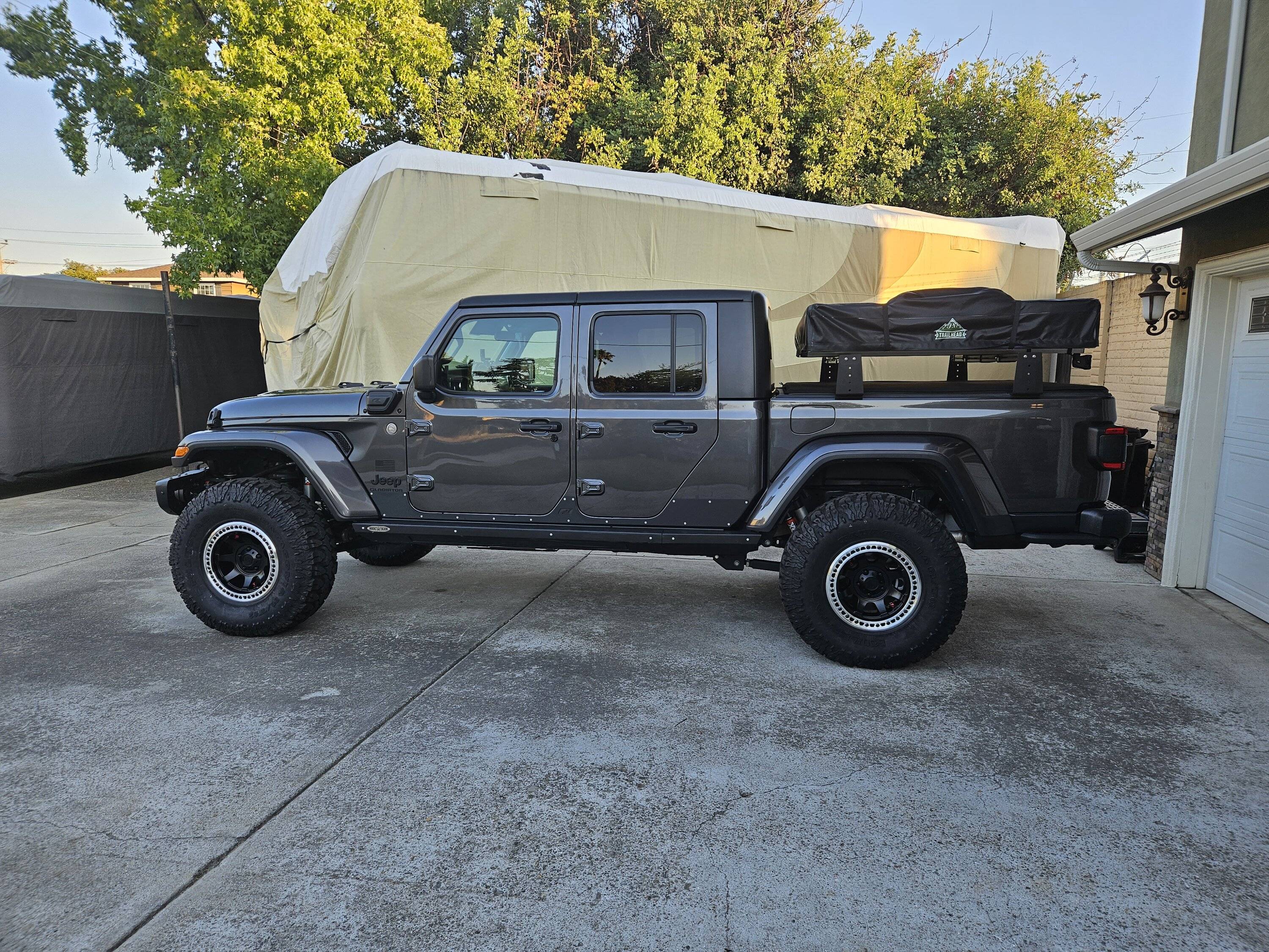

I just moved from 35's to 37 Patagonia's, for safety I did Ried Knuckles, Ball Joint Deletes, RCV's in front Chromoly axles in rear. I had regeared already for 35's to 4:56 which was perfect and still seems really good but If staying with the V6 I would do 4:88. I plan to go 392 in another week so the 4:56 will work. I am also doing psc steering in the rocks the stock steering isn't enough imo.
I have a Clayton 3.5 lift with 4.5 Backspace wheels with no rubbing. Mine is a Sport Fredom edition. I wanted 38's but want to keep the spare in the stock location and the 37 barley fits, I think a 38 is a no go. I decided not to truss for now if the axle breaks I will upgrade to 60's. I also have Rockslide engineering steps wich is a must for the wife ok and me too.
Jeep Gladiator GOING TO 37S WHAT SHOULD I BEEF UP 20230914_183706

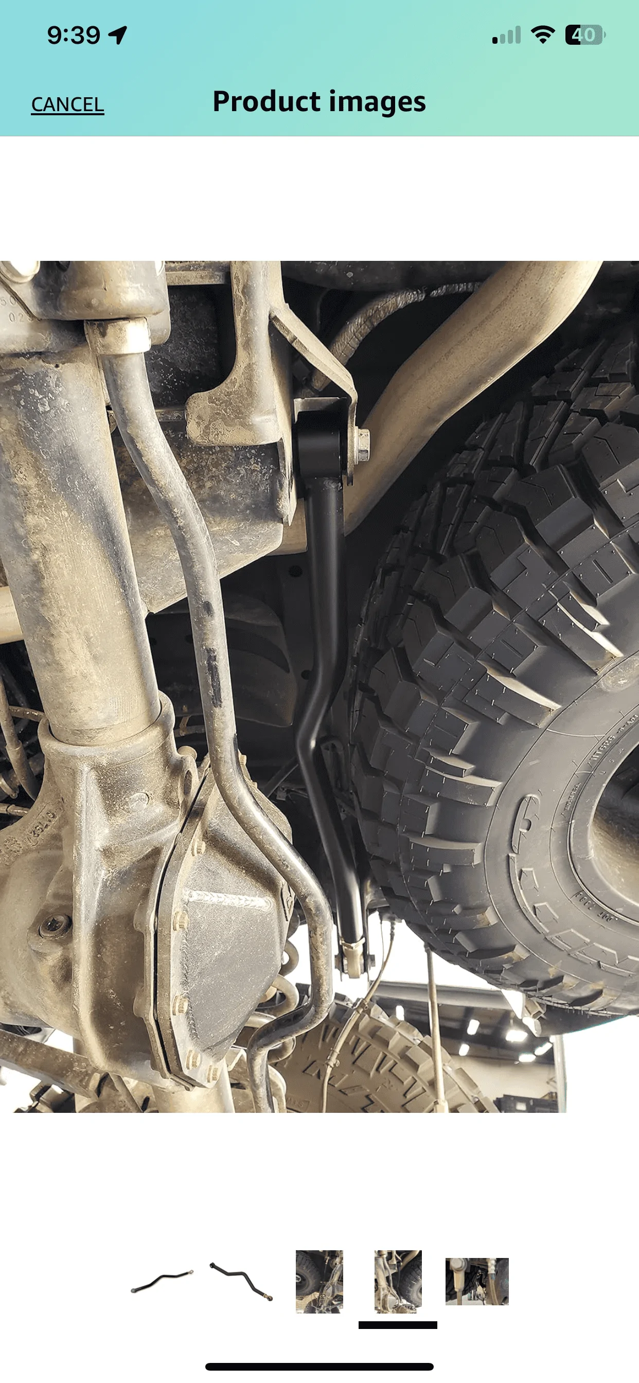

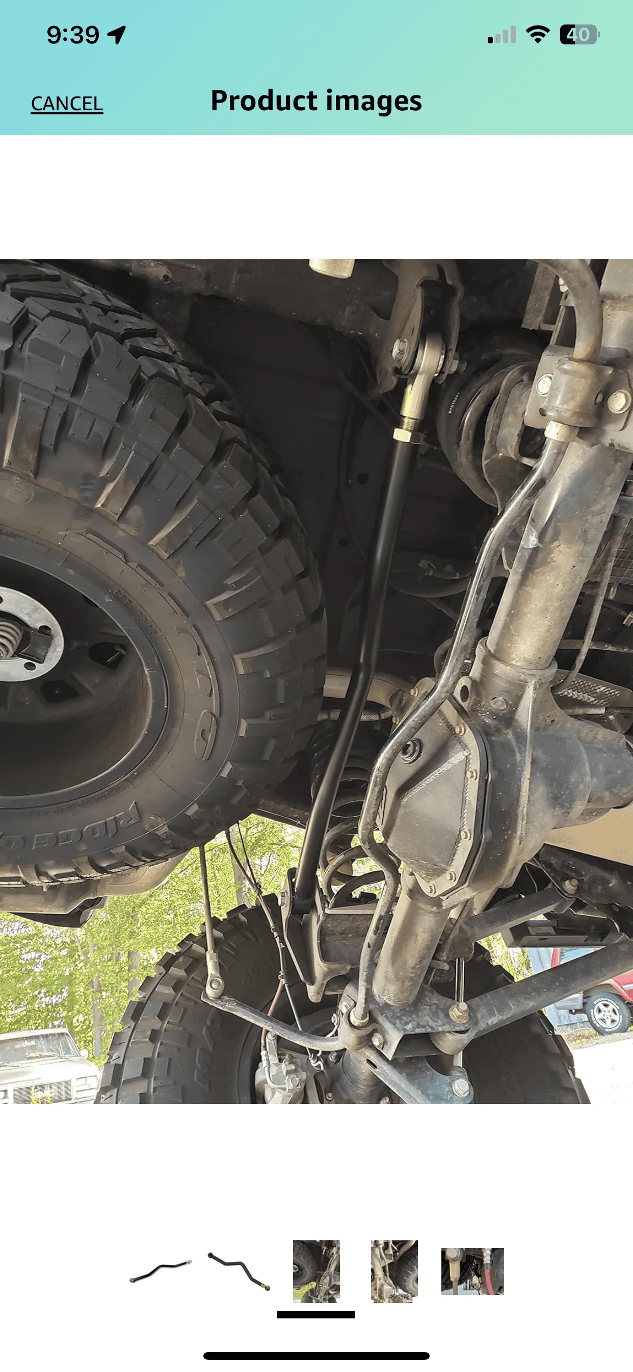

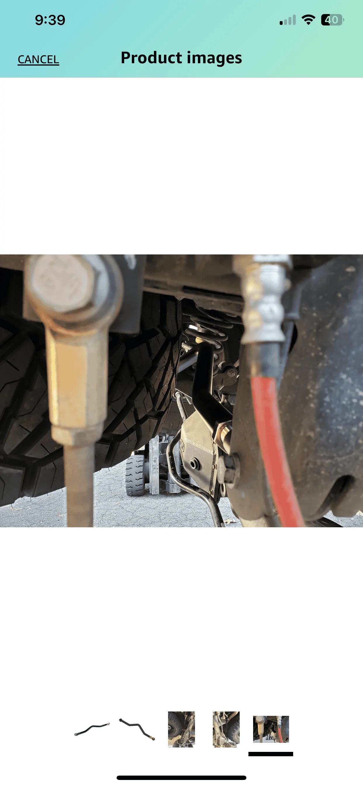

Use the Clayton rear track bar. It provides more clearance and allows for no contact with the spare of a 37” tire.

BUZZHEAD
BUZZHEAD
BOB
Apr 12, 2021
856
1,224
LAKE STATION INDIANA
2024 JEEP RUBICAN GLADIATOR ,2016 HD SLIMS
WEED PULLER
spare is mounted in the bed
