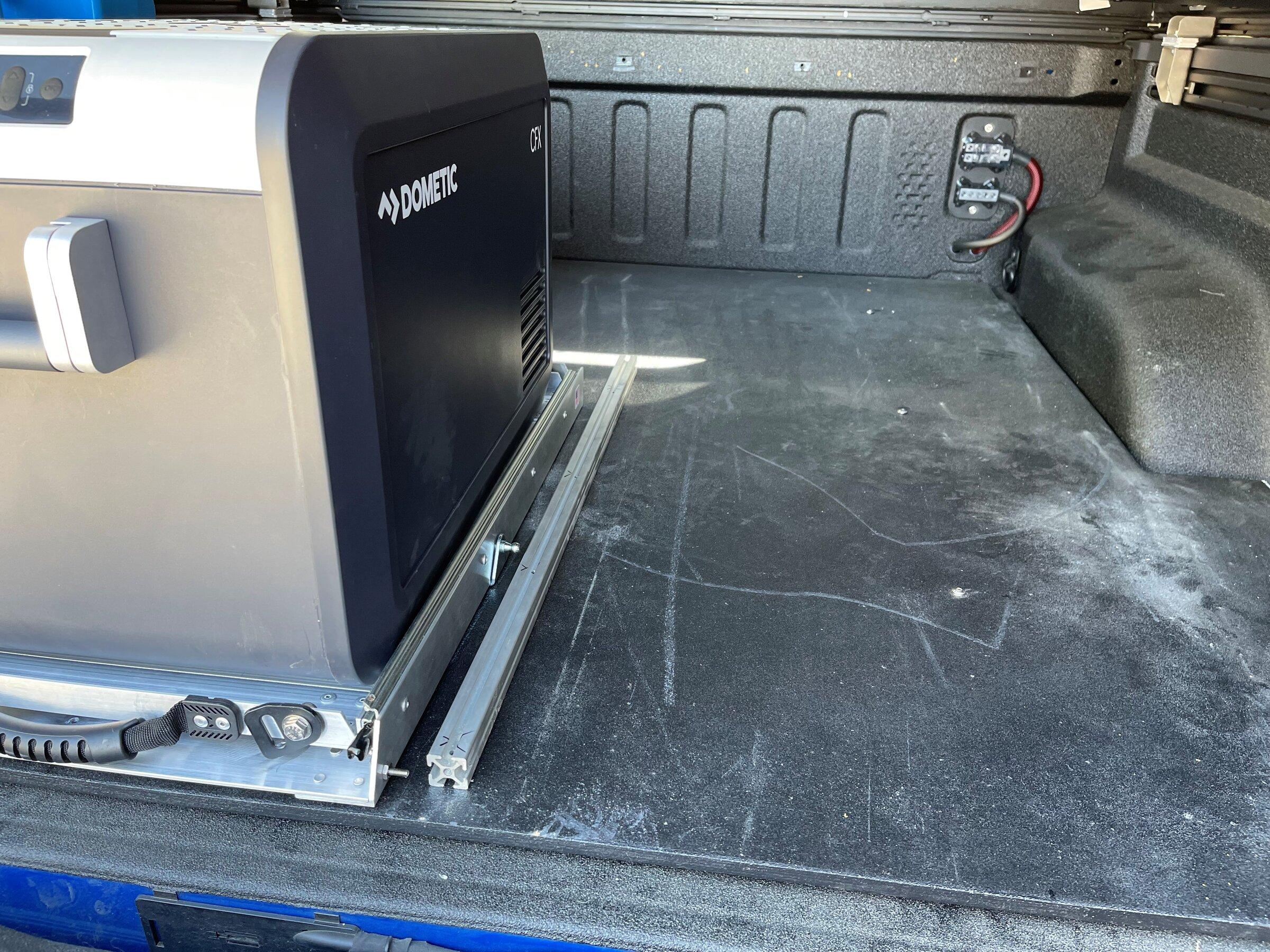

I am looking for something like the Goose Gear Bed Plate but would prefer not to spend that kind of money on a bed plate :).
Does anyone know of another brand?
Or if you built one yourself how did you fix it to the bed bolts nylock nuts and washers, rivnuts in the bed?
Thanks.

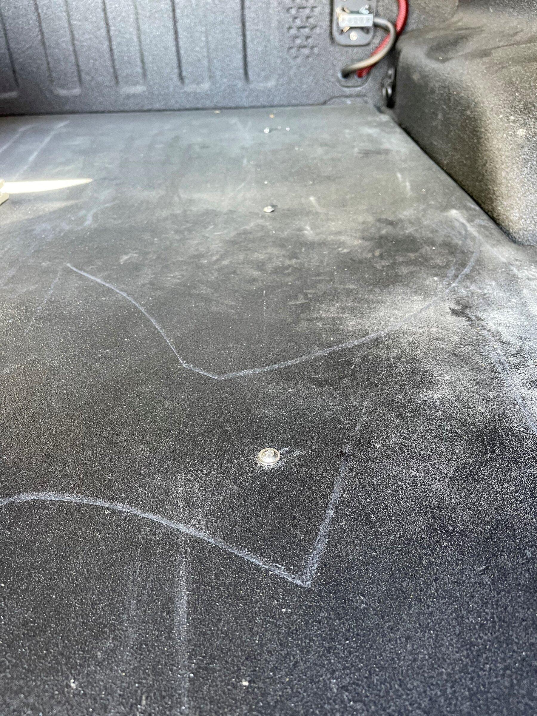

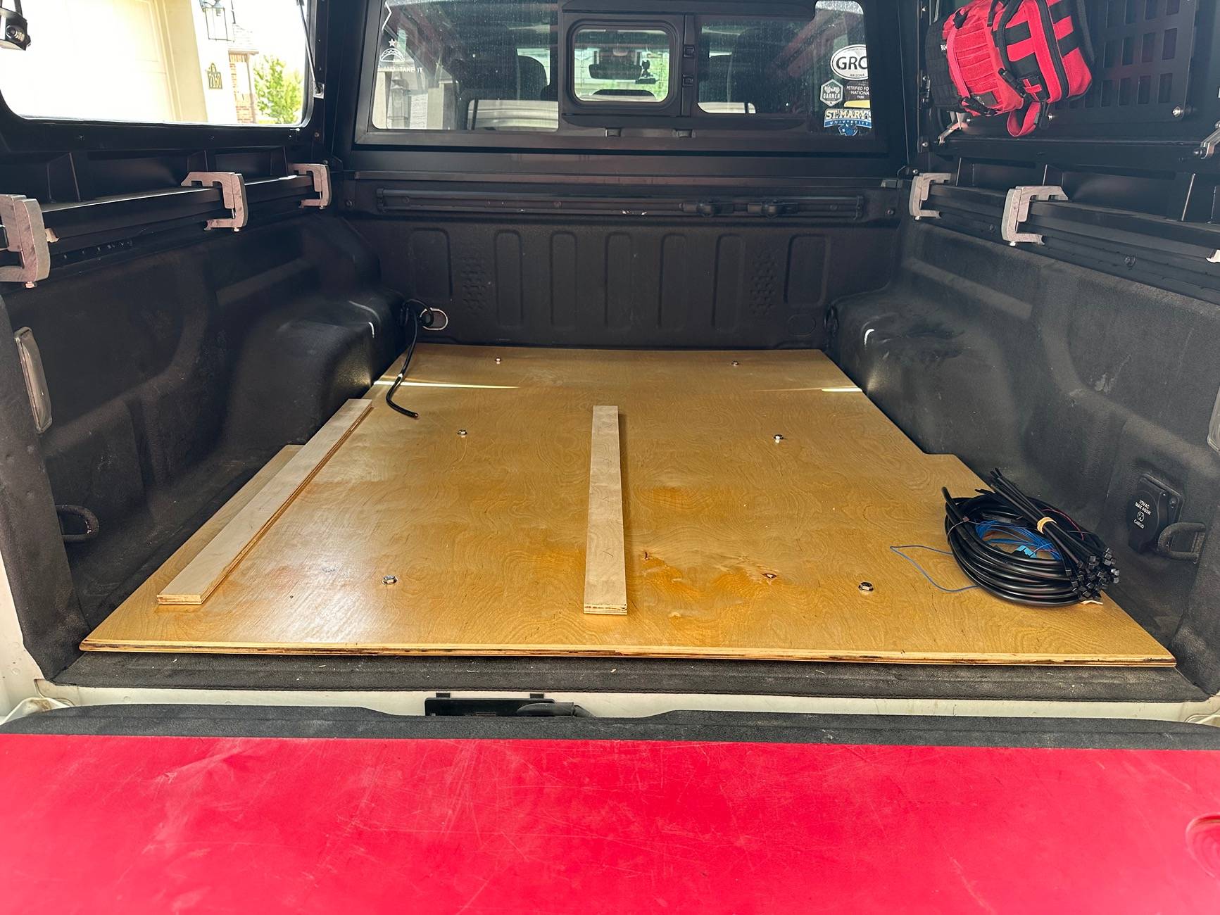

I love Goose Gear’s products but I do agree that the bed plate is a bit pricey. When building out my overlanding set up, I installed nutserts into the bed and then bolted down 3/4” plywood (sanded, primed, bedliner-ed). Might not be as pretty but certainly was as functional. I did cut reliefs in the plywood for the bolt heads so that they would not snag everything and make for an uneven surface.
Here’s a shot of one side of the bed during the build out:
Jeep Gladiator Goose Gear Bed Plate or similar 43_KitchenPlatform
If I were to do it over/again, I think the only thing I’d do different is I would use 1/2” plywood for the weight reduction. I was worried that it would not properly support the weight placed on it, but I now think it would be fine.

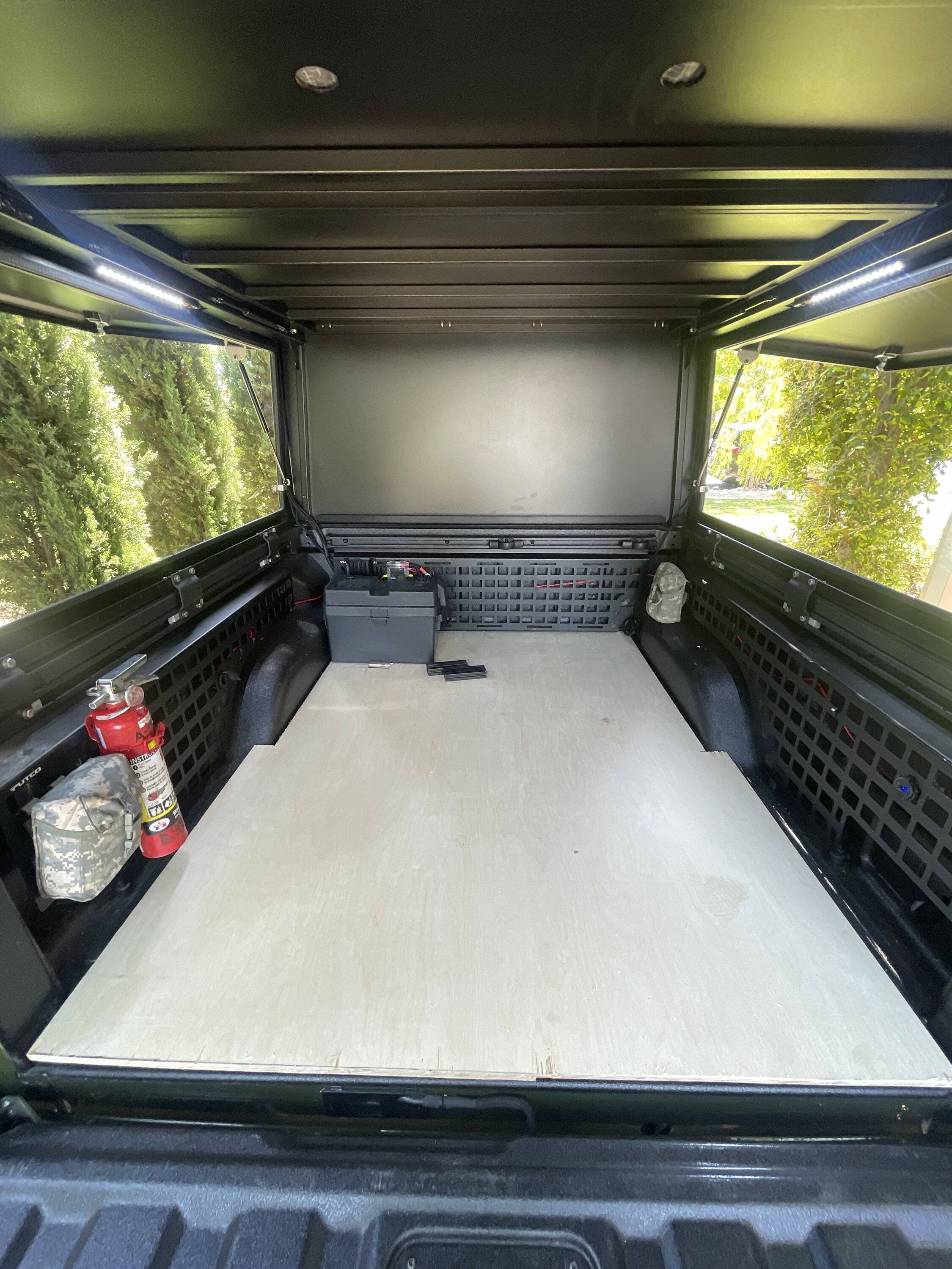

I ended up making one for about $150 plus a couple of hours of time.
$70 for the 5'x5'x1/2" Baltic birch and $80 for enough roll on Raptor liner to do 2 coats on each side.
Does no look as polished as the Goose Gear one but it works and once I put a fridge slide and some other things on there most of it will not be visible anyway.

Thanks. Called all over and none of my local timber merchants have 5’x5’ but with the Molle panels 4x8 will be okay.
$156 a sheet for Baltic birch right now.
still a work in progress but here’s where I’m at right now
