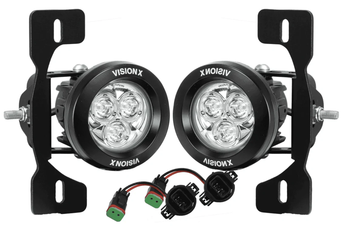

That will work, but so will any chinzy little pair of diodes for a buck.
I agree but I like the higher capacity, cleaner installation and build quality so I only have to do it once.

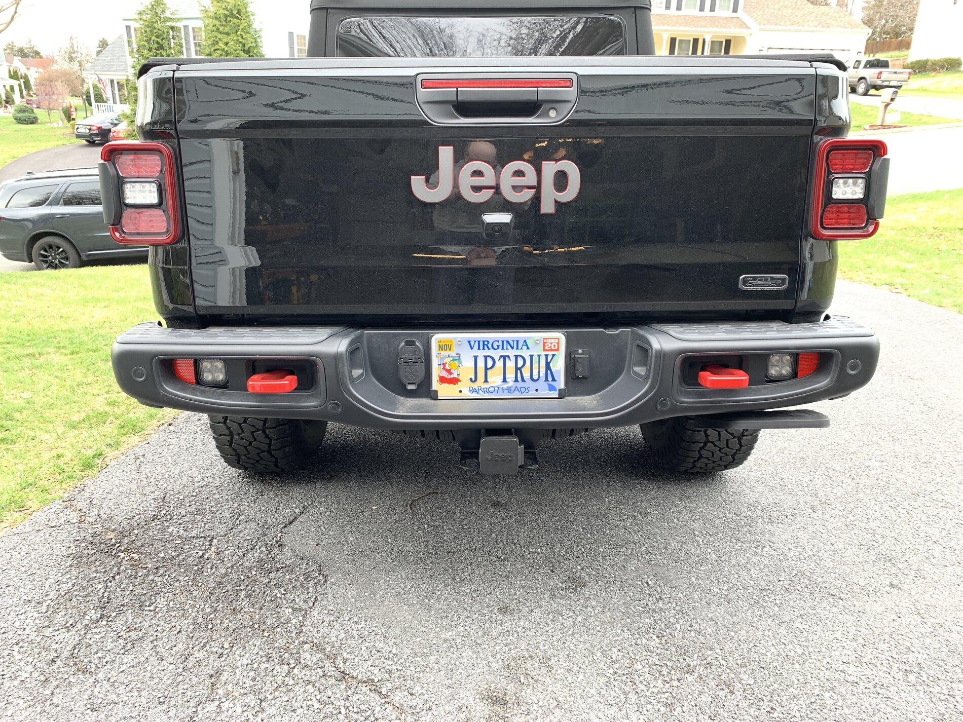

I have mine wired directly to each respective reverse light input on the taillights. Works great and adds quite a bit of light for reverse backup driving. They only draw 1 amp per light so it will be fine on the reverse light circuit.
