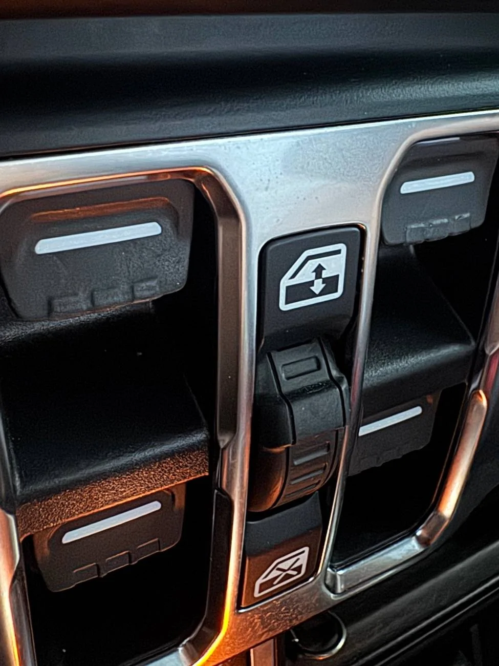

Has anyone else experienced this situation?

Yep. ‘20 Sport S pkg. the rubber started softening and deteriorating about 2 years in. I’ve just ordered button replacements from Amazon. These are not stick on covers but actual button replacements with no rubber coating. Search MOTOKU Switch Button For JEEP on Amazon. I have high hopes based on the reviews.

Same deal on mine, 2020 and they started peeling just after warranty period. The last bit of rubber on the switch isnt supported so over time it will wear off. It's inevitable.

57000 miles on my 2021 and nope. Don’t press with the tip of your finger where your nail hits it.

I use a thumb.
It's more of a problem for my wife - she has no thumbs, and usually has long nails (and can't bend the fingers on her right hand, so she hits the switches in her JL with her nail)
I've noticed that some of the damage on the switches I've seen has been the oils in the fingers impacting the rubber, softening it and messing up the integrity of the rubber itself. Sweaty oily hands make the issue worse..

This is a common issue across a lot of automotive interiors. The oils left behind from common skincare products, as well as natural oils on our skin break down the material thats used on a lot of switches/handles/steering wheels, buttons etc. You see it more often with vehicles driven by women because they typically use more lotions and makeups that leave oil behind. Once it starts to break down theres really no saving it, you can only prolong the deterioration. It's one reason why it's important to clean everything often with a good automotive interior cleaner and use a protectant.

I'm worse on interiors than my wife -since she retired, she's cut waaay back on that stuff. Me - I have naturally oily skin, I have to wash my hair daily, and I'm hard on cotton fabrics. Of course, I do some shop work, need to run in to town, hop in my JT and go -
I hope people see your post on this - as it is truly a thing.
Steering wheels, arm rests and so on - I'm hard on them. This example is only 27,000 miles -
