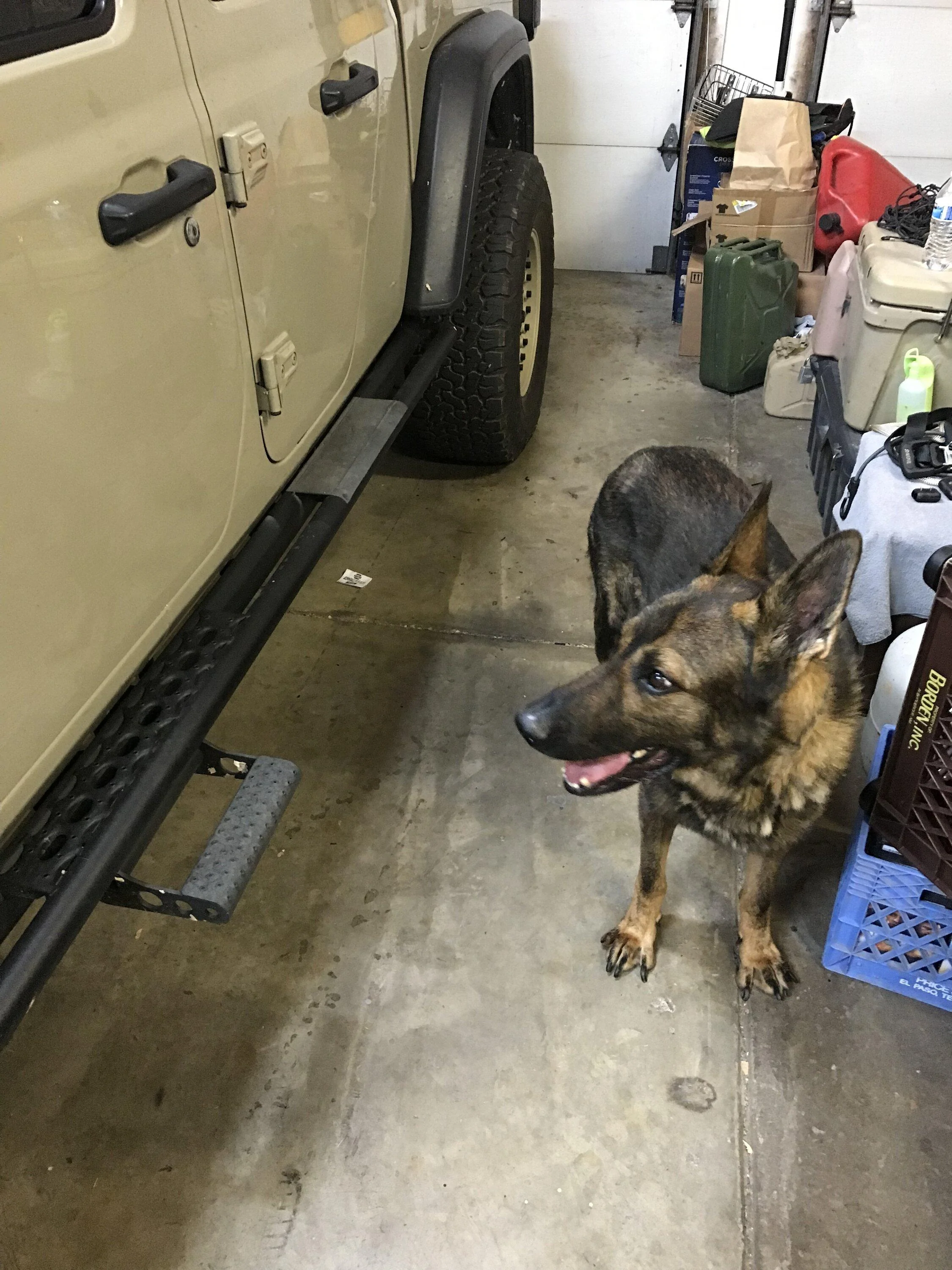

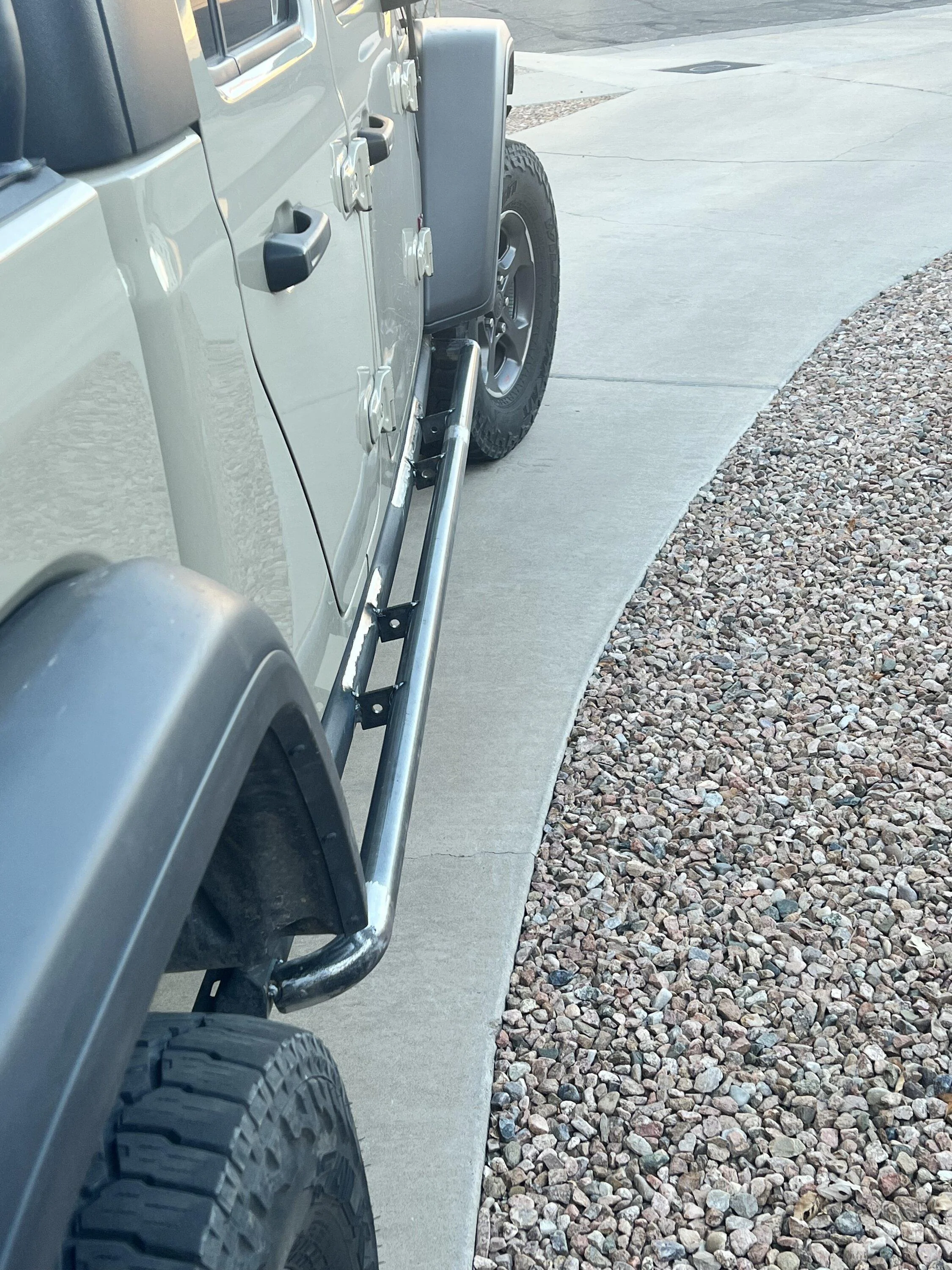

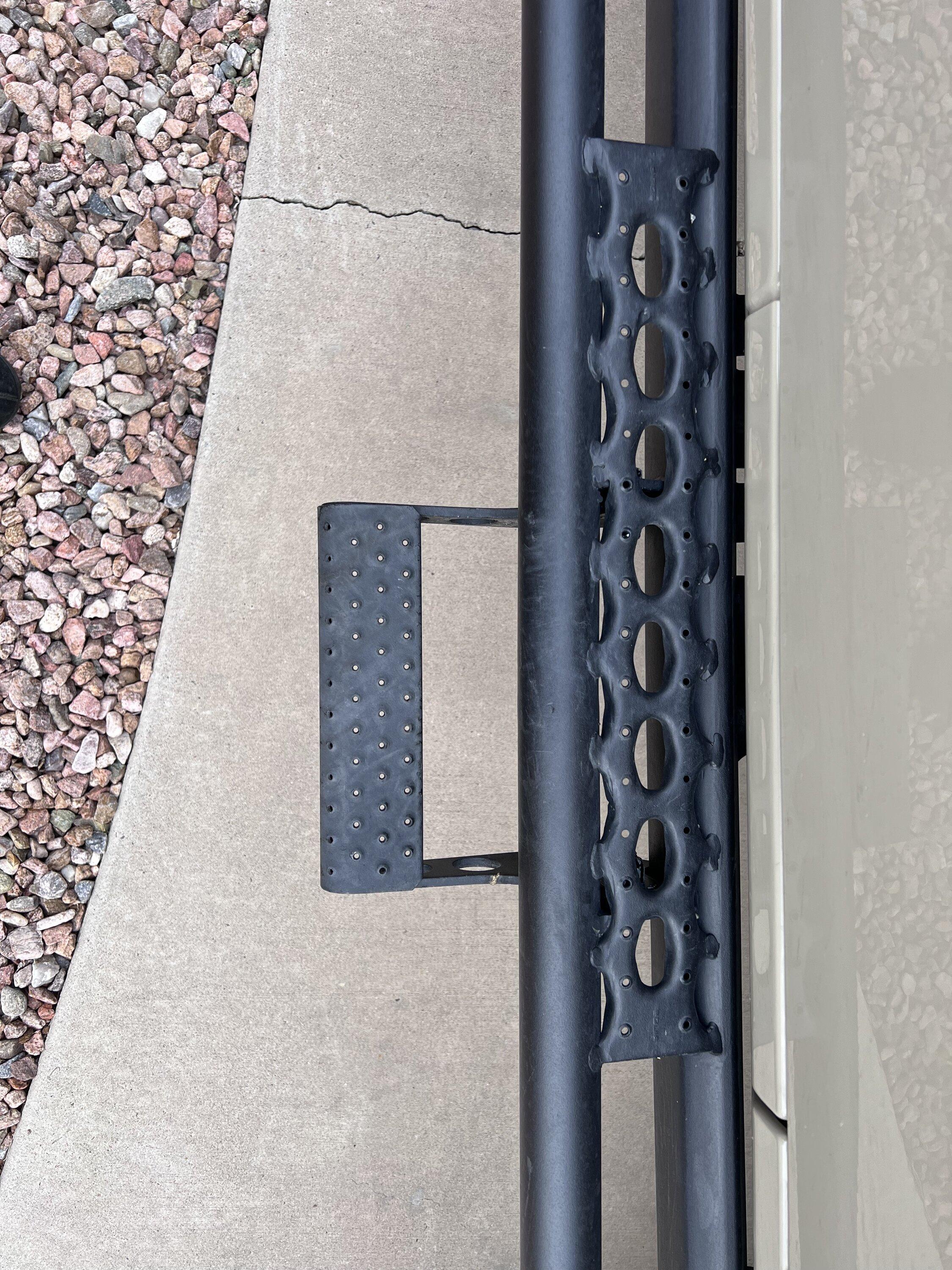

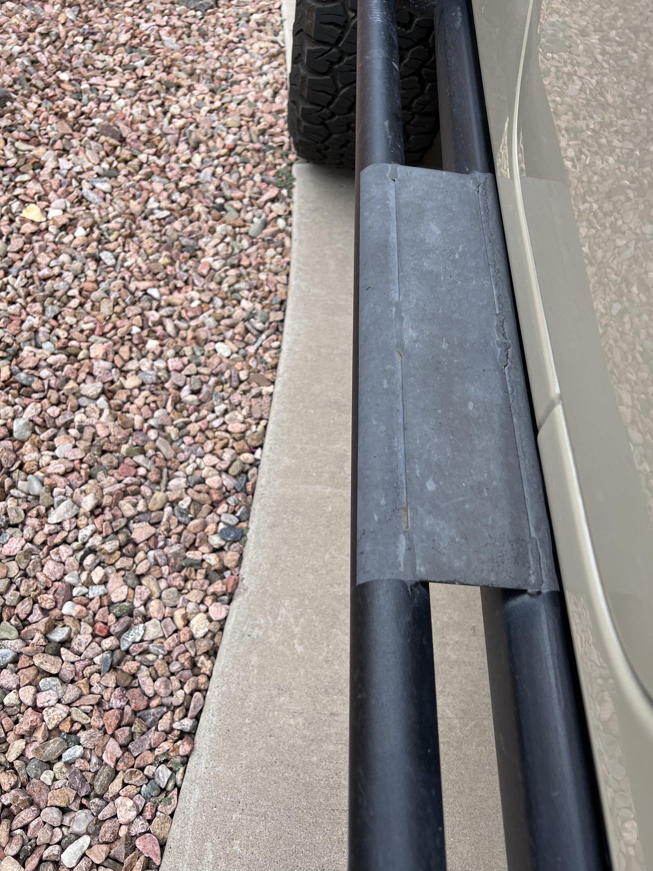

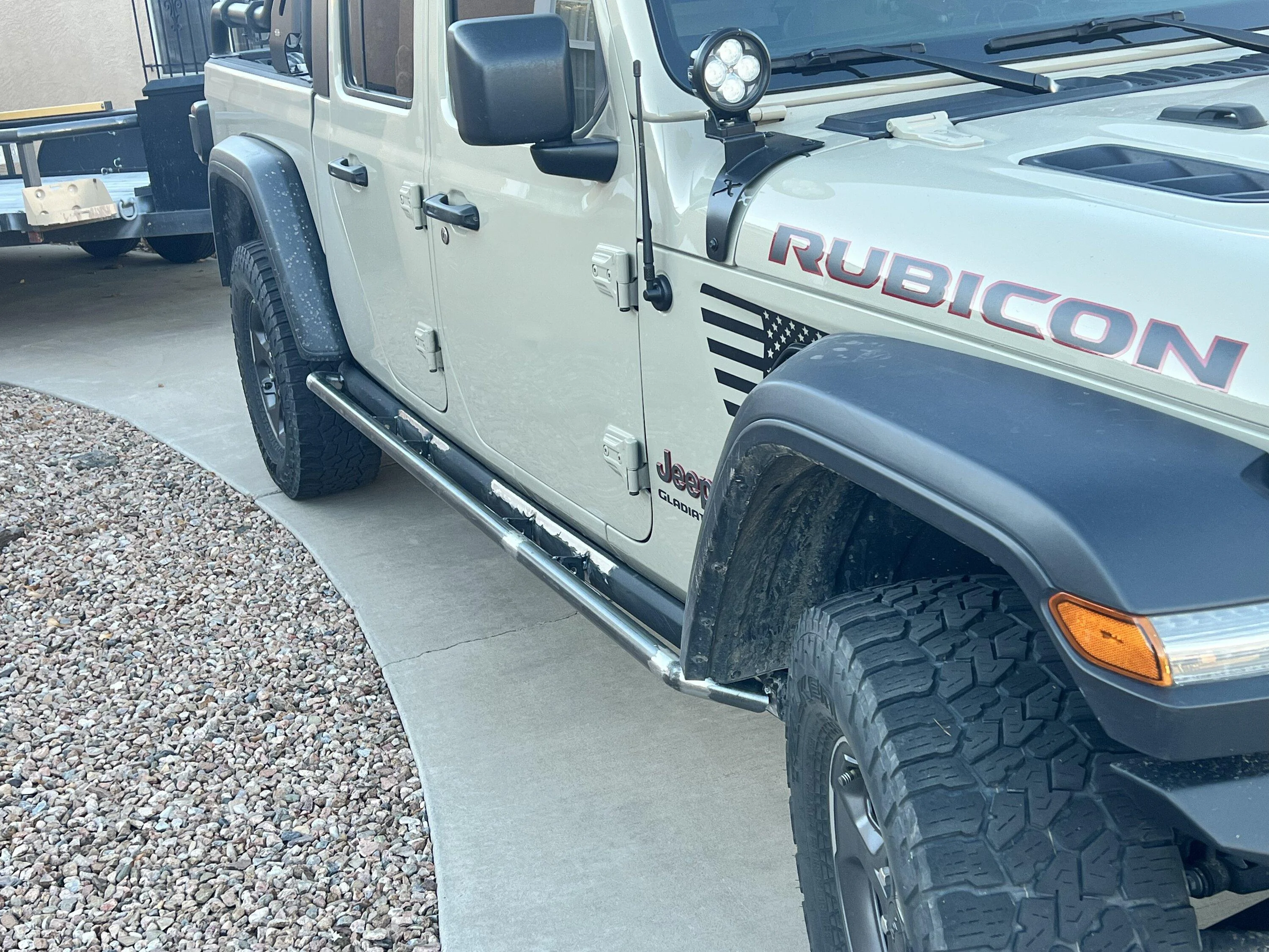

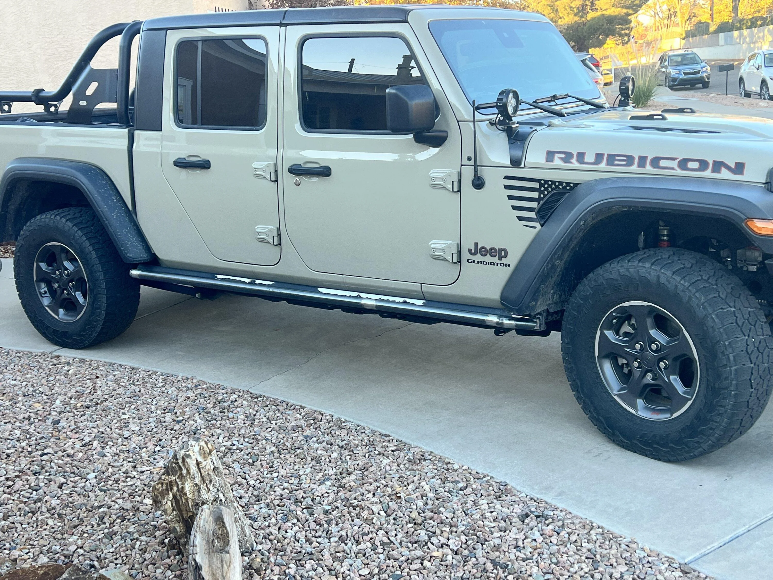

I did a similar thing but used schedule 40 pipe. I bought 45 and 90 degree joints and welded them on instead of bending. I added perforated steps for the front and solid for the back for my dog. I welded braces to attach an NFab step for when I lifted the truck. I can move the step from front to rear, or remove it for wheeling.
Did you do this yourself or have it done? I need to pay someone, this is great!

I did it. I used to have a welding business so it was pretty easy. I did pay to have it powder coated.
Any chance you posted a write-up? I understand the basics of what you used, but would love a diagram/details spec of everything. I don’t have any experience working with metal, but if o has a plan, I believe I would get it done with someone. What material/product did you use for the steps?
Can you take some pictures of the weld locations along the rock rails themselves?
Also, would a “metal working” place be who I would look up to do this? Do they typically powder coat, or do you have to find an automotive painter for that?

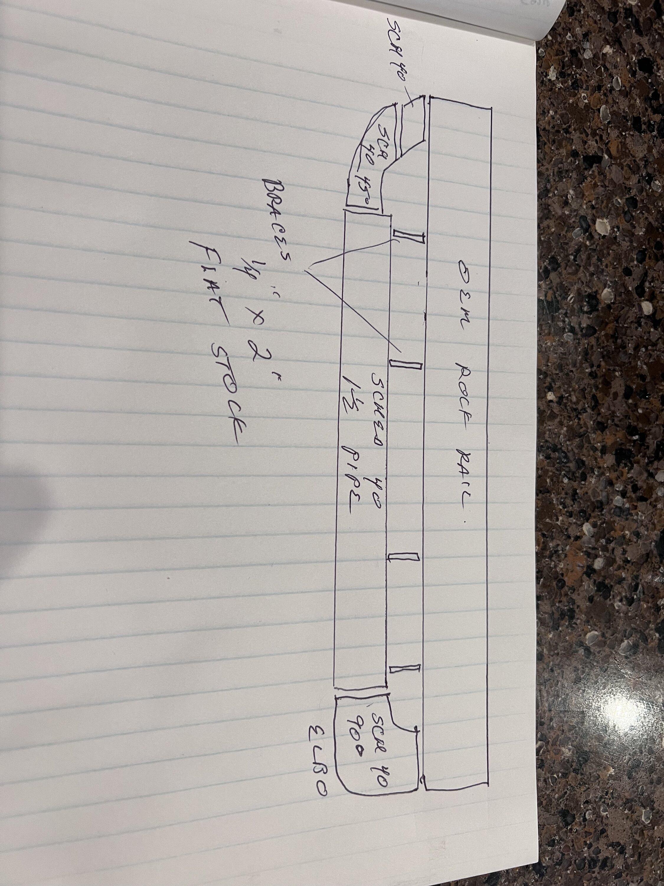

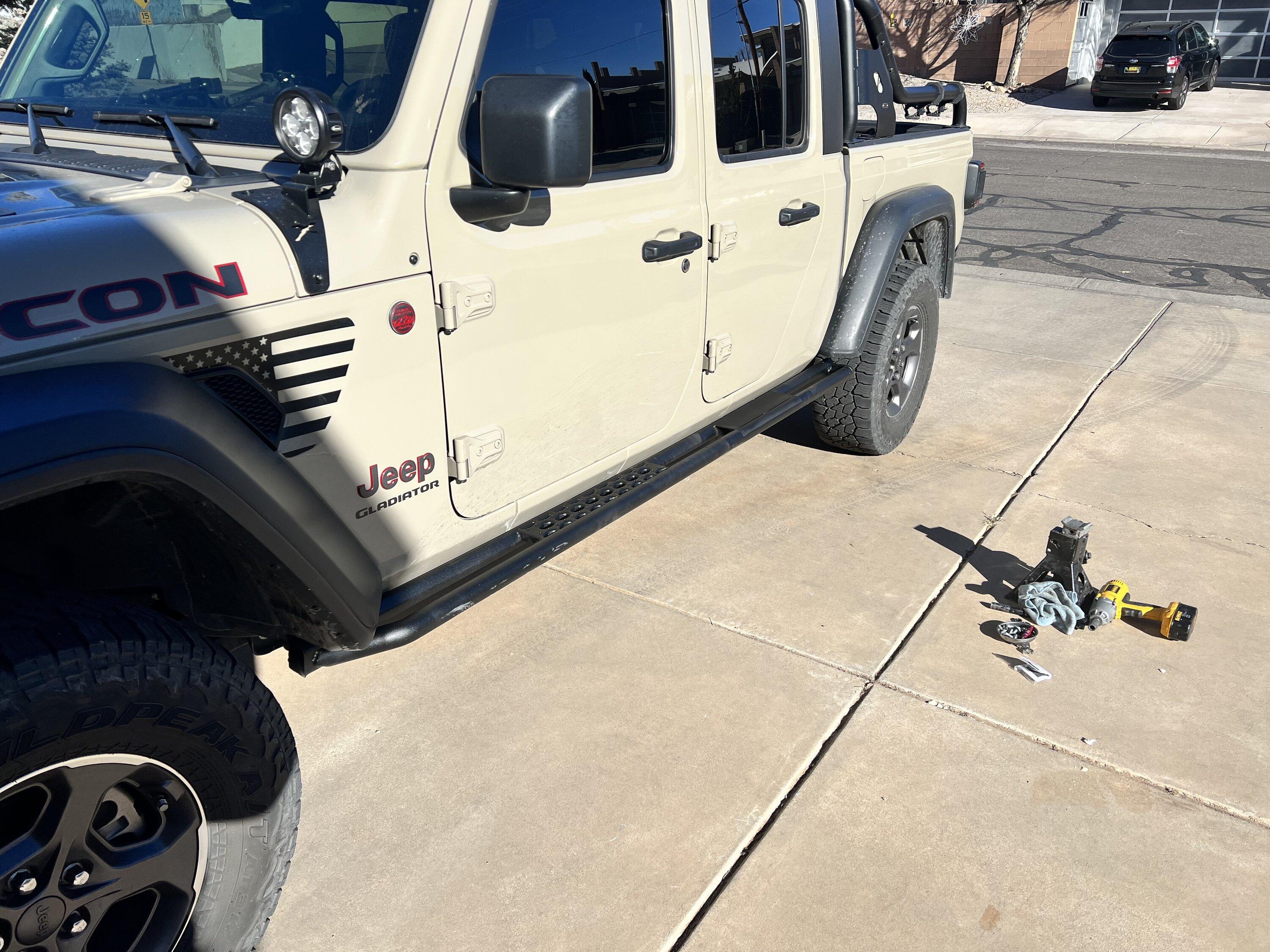

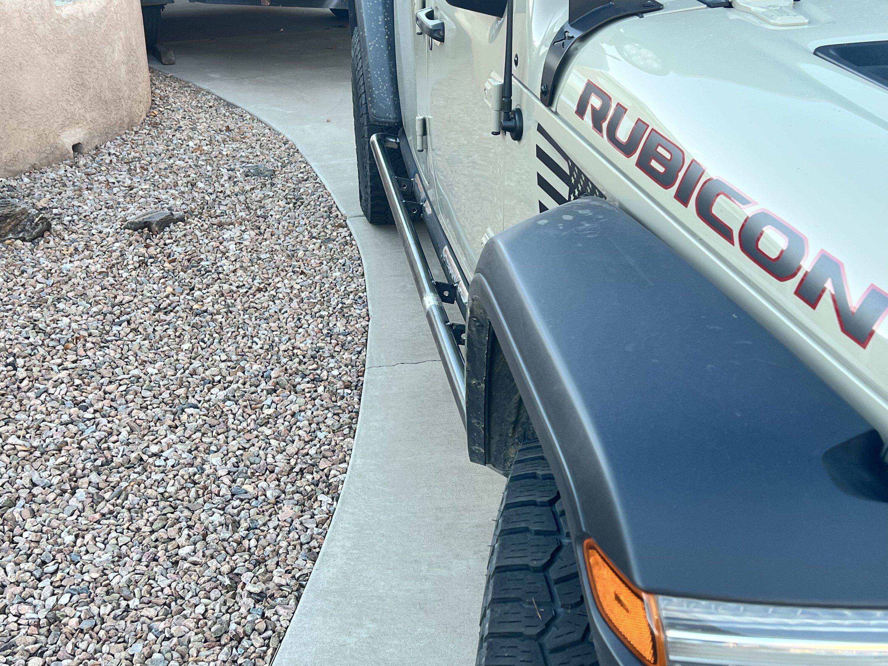

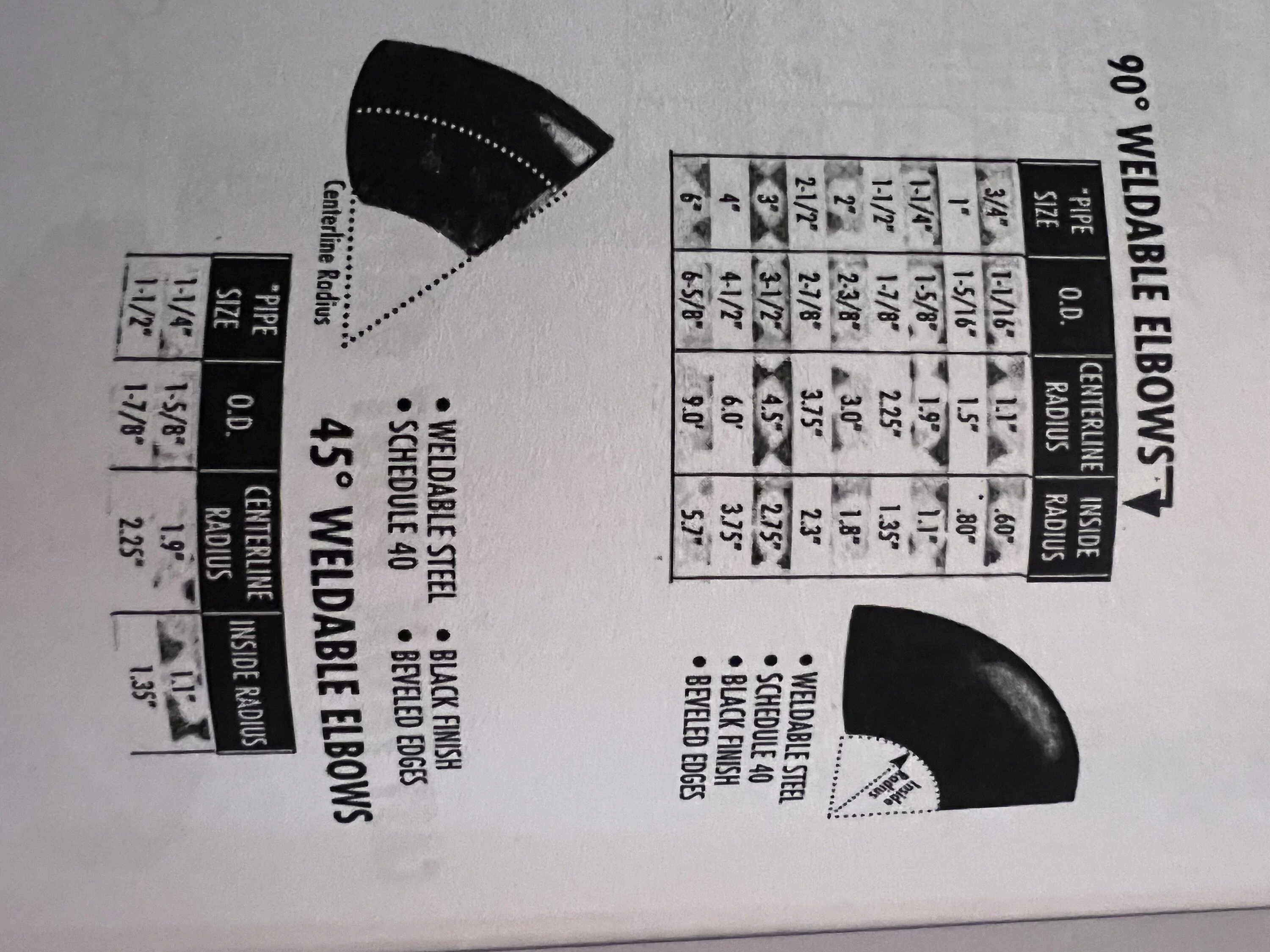

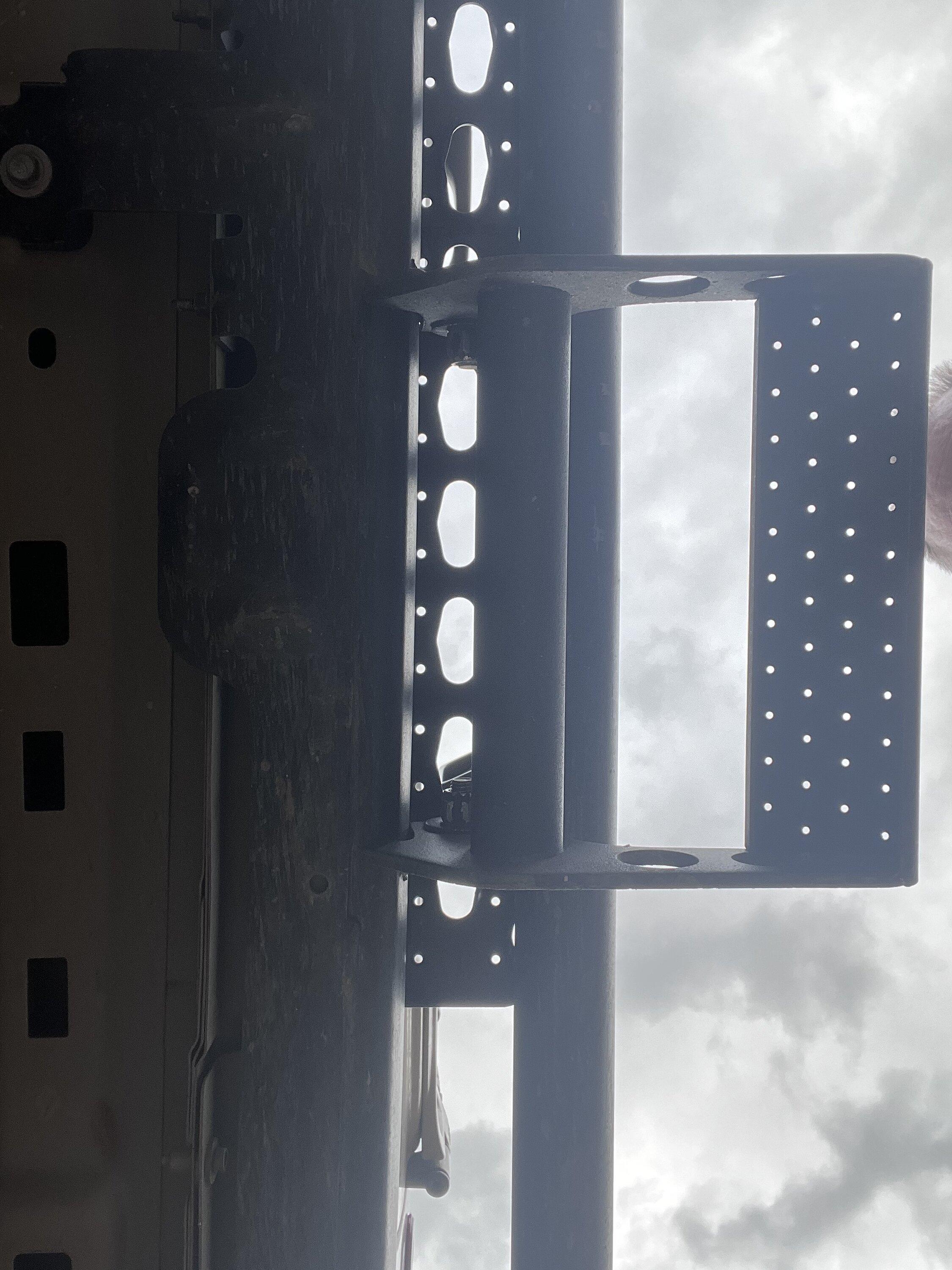

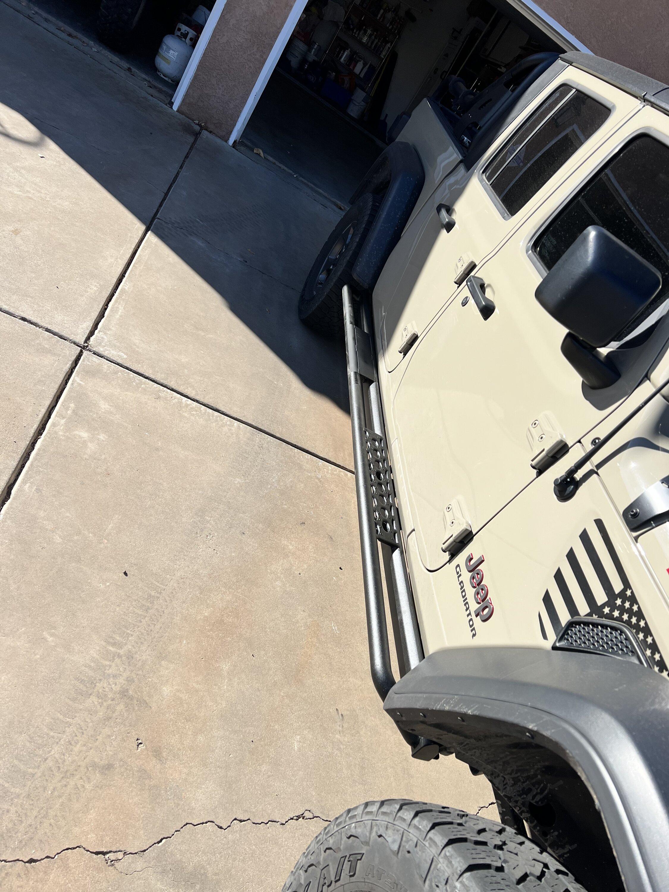

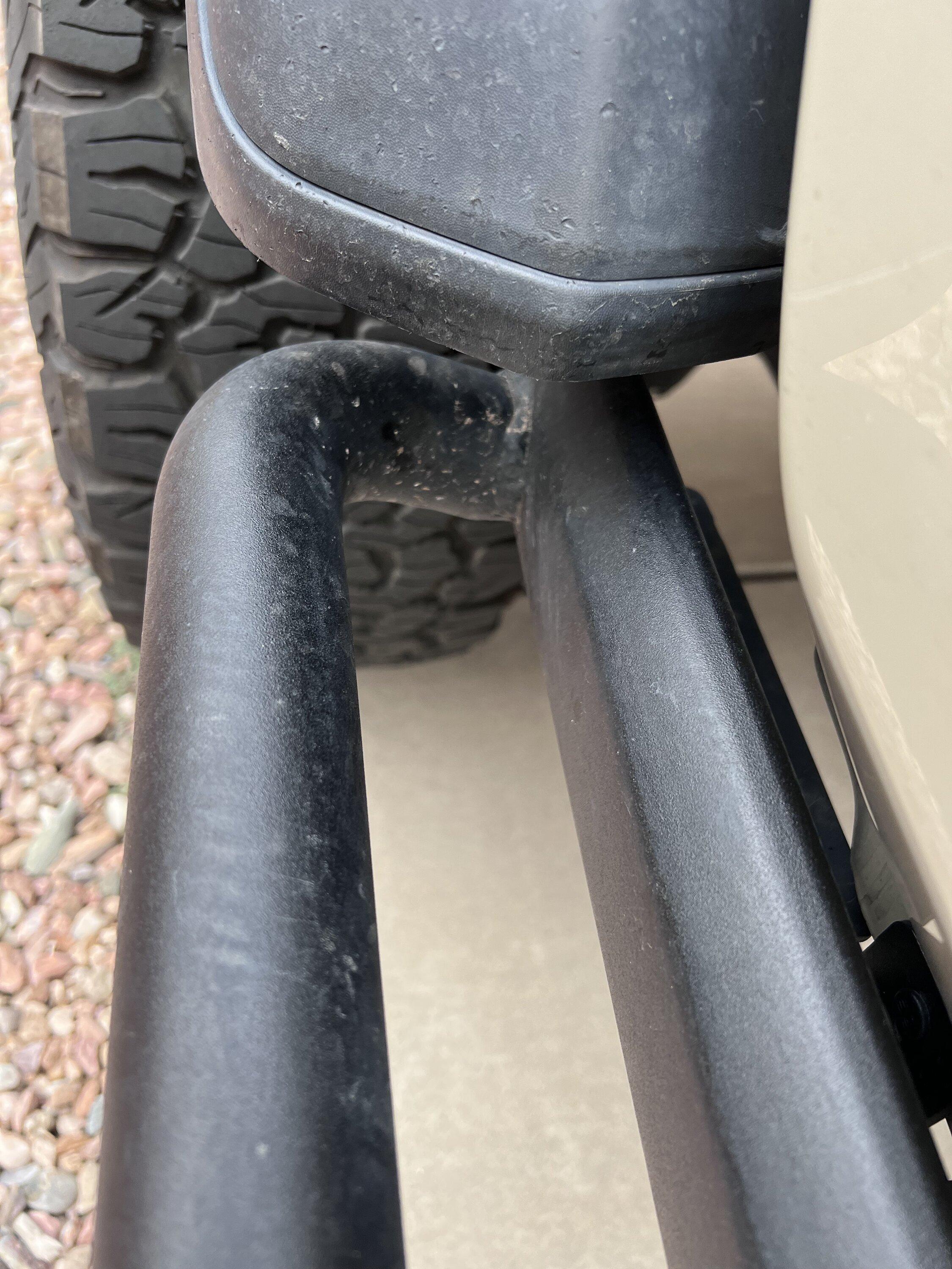

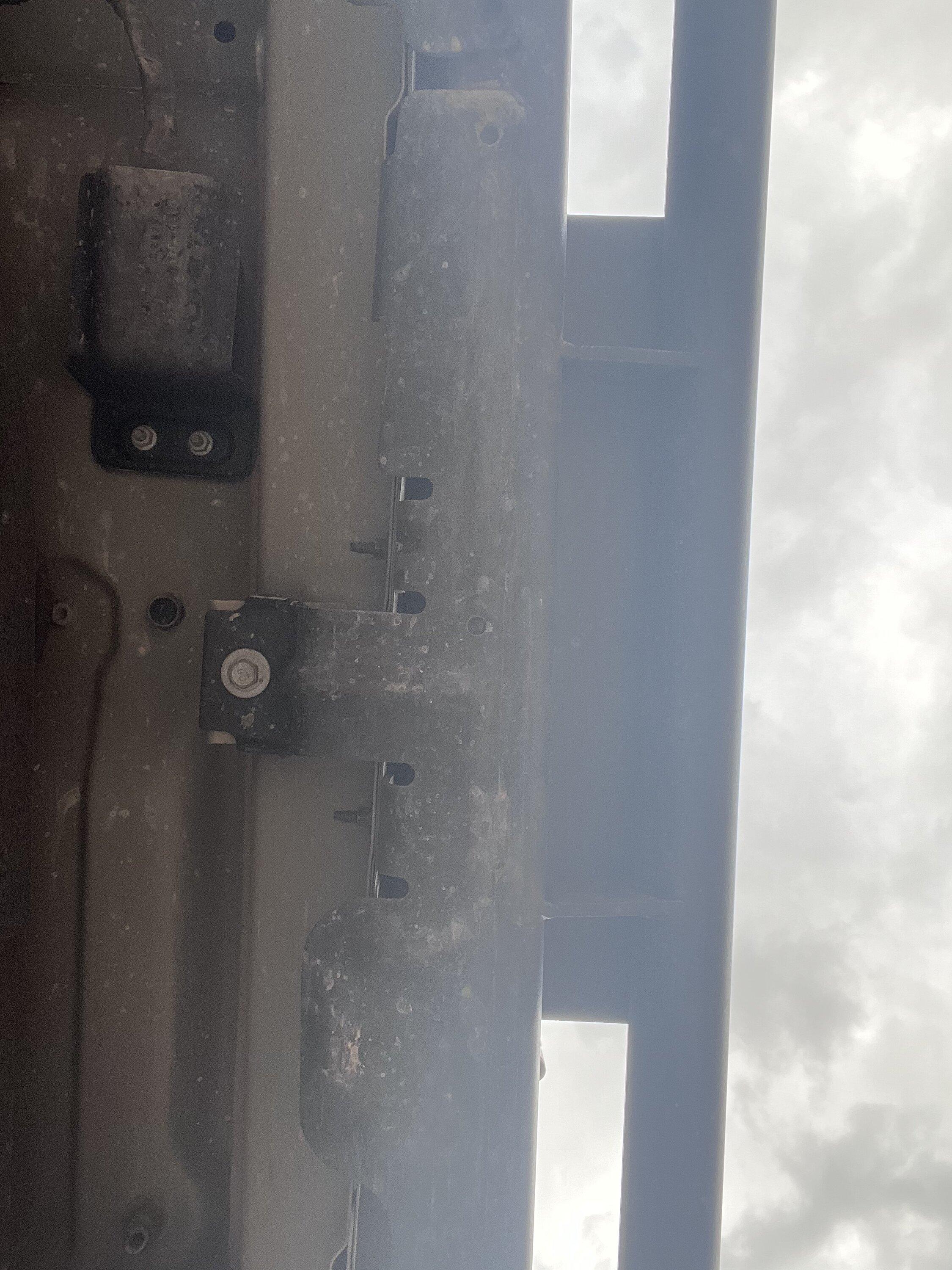

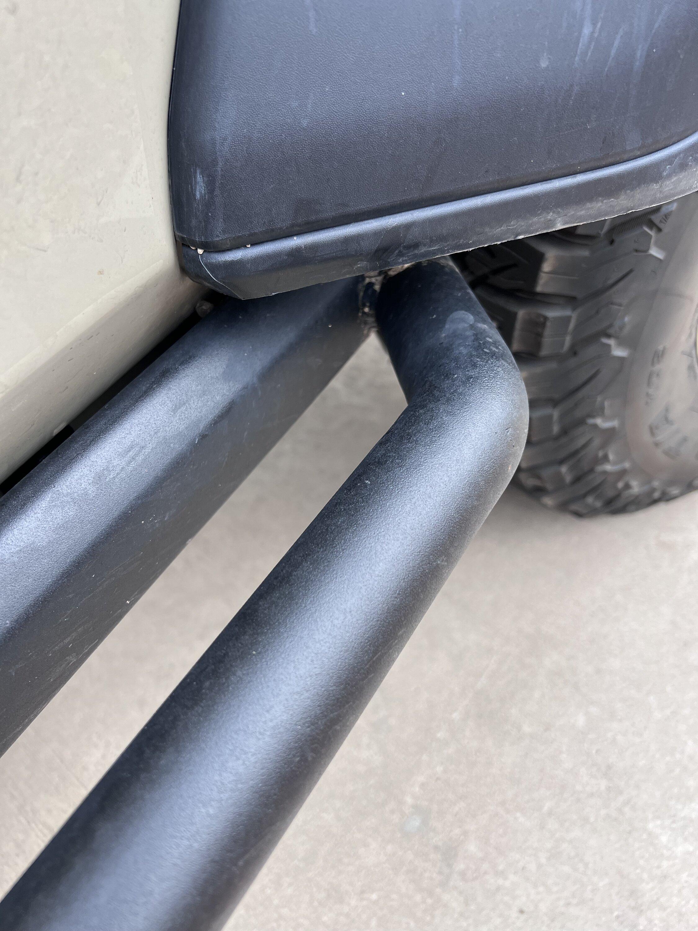

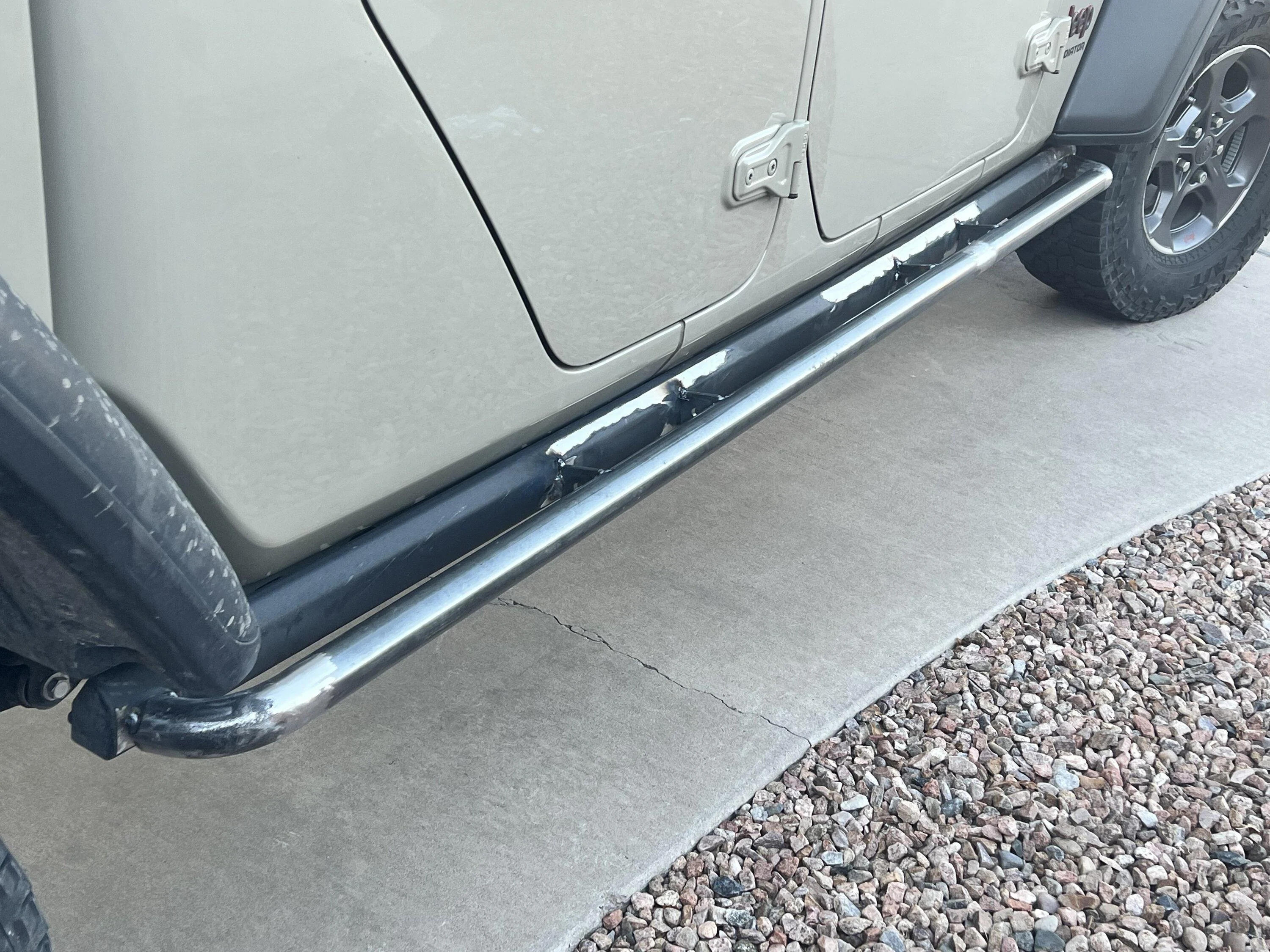

So I didn’t do a write but I do have a few pics and a blueprint. I bought some schedule 40 pipe 1 1/2 inch which measures 1 3/4 outside diameter and two 45 and two 90 degree elbows for the pipe. I welded the pipe together to the length I wanted with the 45 in the front and 90 to the rear. The ends were cut at an angle to fit flush against the rail. The paint was sanded off the rail where the welds would be. I removed the rail and welded the pipe to it. I reinstalled the rail and tacked in the braces. The braces are 1/4 x 2” flat stock. You have to grind a curve in one end to fit up around the pipe. I had the steps from an NFab rail I had on my other Jeep, so I decided where I wanted the step for the front and rear doors and placed the braces there. I removed the rail, completed the welds and ground smooth. The steps just bolt into the braces. I then welded the perforated step in the front and solid in the back for the dog. I had it powder coated at a local shop. Do a search in your area for a welding shop and give them this info. It’s pretty easy, any shop should be able to do it. If they don’t powder coat, they pry know someone who does. If not do a search for powder coating. Please don’t hate my “blueprints”’ I’m not a Draftsman. If you need any more info feel free to contact me. Good luck.
