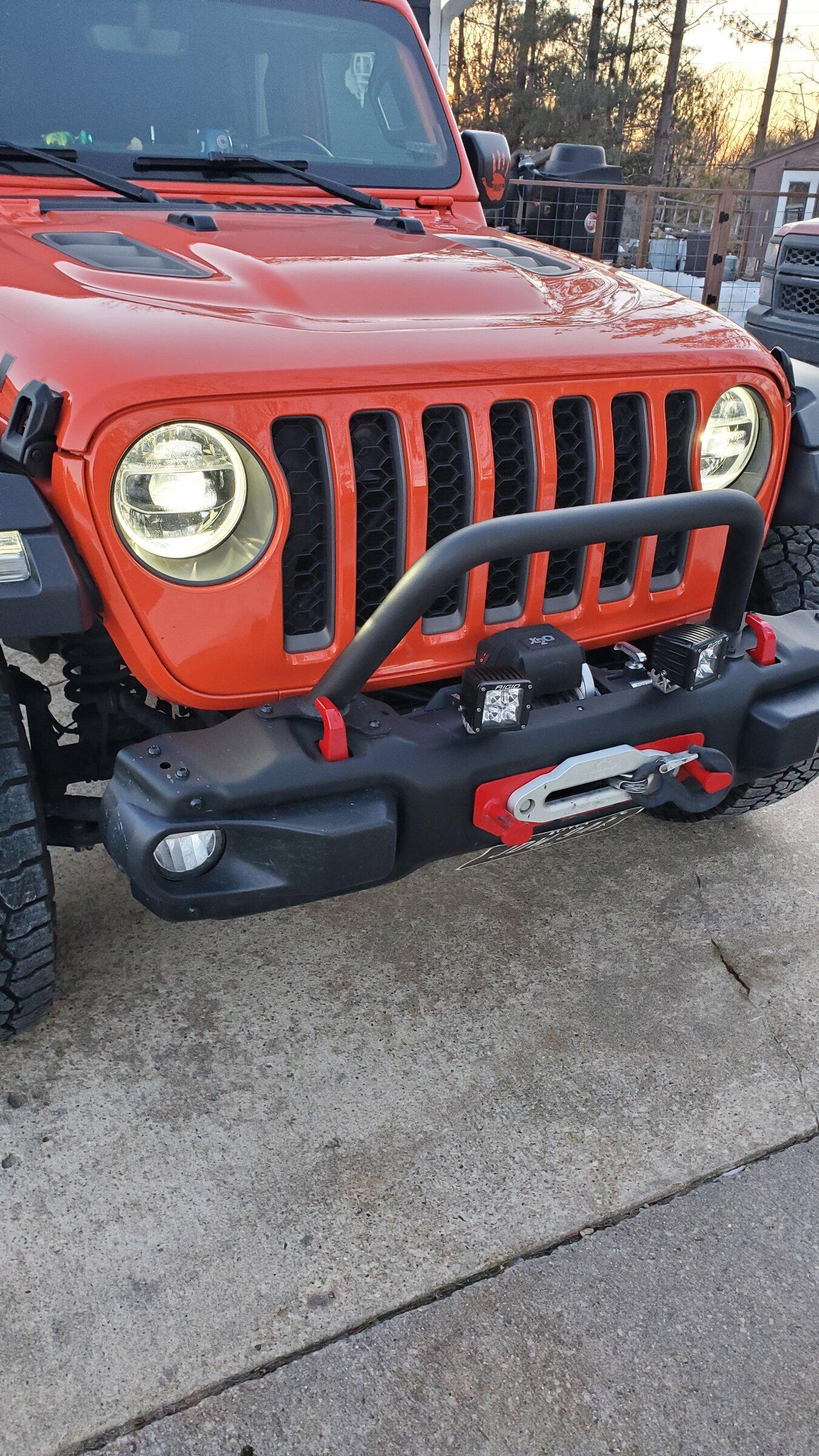

Hi all,
Took my 20 JTR into the dealer a few months ago for warranty work. I got it home and reinstalled my Tazer.

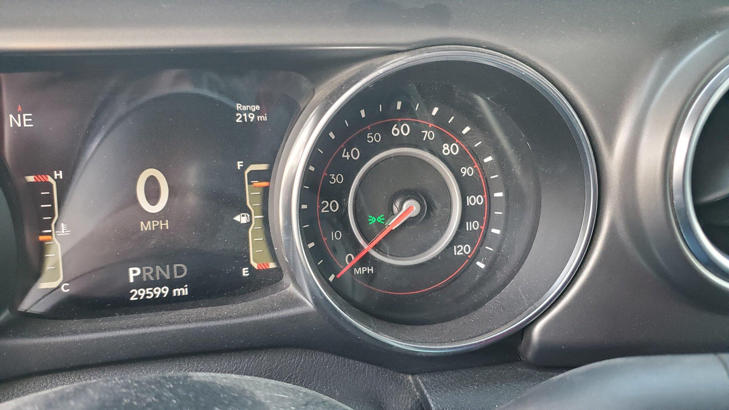

Ever since then I feel like my headlights never shut off day or night. During the day I have to flip the internal switch to on to see the radio and at night I have to flip it to auto to get it to dim down.
Is this a Tazer issue or something else? I've gone through the Tazer and Radio settings multiple times and can not seem to find the correct settings to make the "auto" settings to work properly. Also the headlight light on the dash never shuts off.
Unfortunately Tazer does not have live support so that leaves me with endless emails to get assistance from them.
Before you ask NO I have not unmarried my Tazer to see if it goes away. I would rather not go through that hassle yet.
Thanks I. Advance!!

Oh, and it's worth noting that this light you show here is not the headlight indicator. That's the parking lamps indicator.
Well according to this Jeep published owners manual it IS the headlight indicator light.
Anyway, agreed removing the Tazer would eliminate that question. I was hoping someone could tell me if there was a setting in the Tazer that keeps the lights in a always on state.
