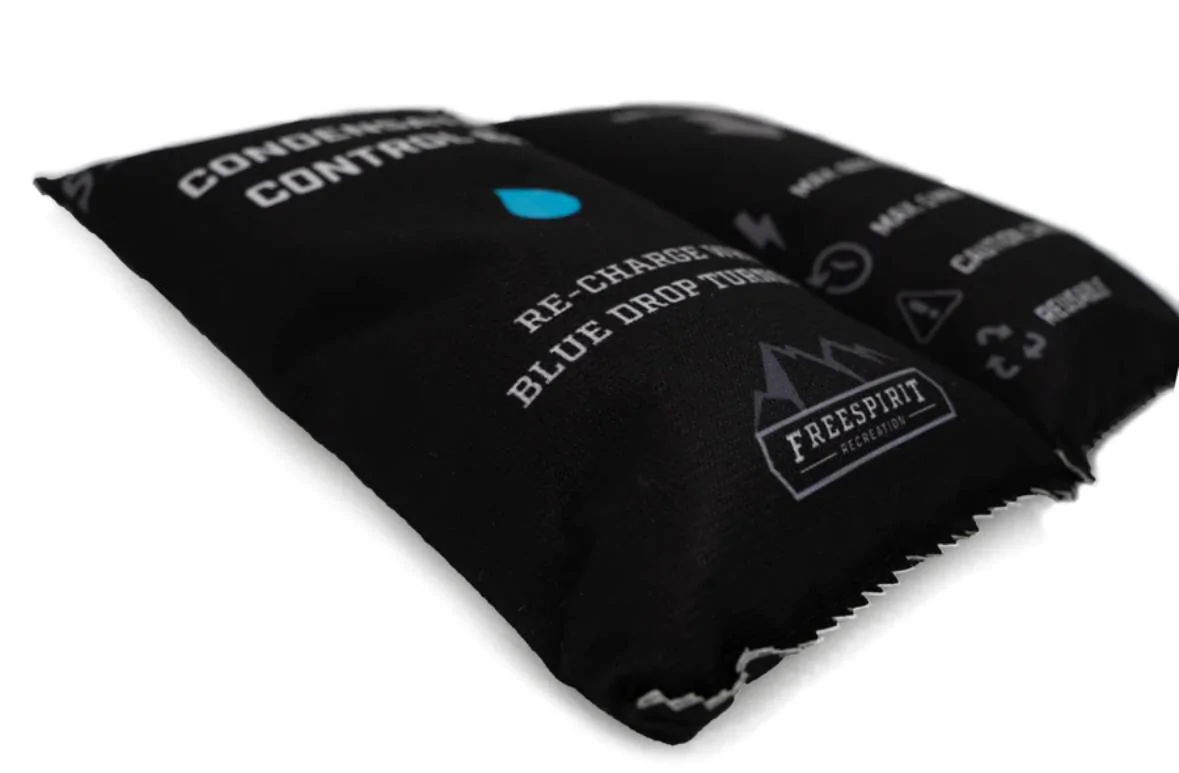

Check your inbox.
Just search AMZN for: Rechargeable Desiccant Pack
You'll find lots of options.

Buy about 30 of ‘em and use it as your mattress ?
LOL. yea my thought exactly. But that is a great idea for storage. Since I can't realistically take my tent off in the winter, I threw 3 or 4 bags of silica up there hoping it will absorb any moisture over the winter instead of getting into the canvas or mattress. Hopefully it works. Kinda nervous about that.

Yeah but would those really absorb enough water vapor as fast as it is created?
I'd assume it's a long-term absorption, not an overnight thing. But it would be a cheap test to do.
The 100g bags work up to 200gal of space, so for my Tepui Basin, I'd need 5 bags - about 895gal is my tent volume. Of course, that's assuming an airtight seal, which we know tents aren't.
I would be curious to see how well they work. Just doesnt seem like a viable option for camping to me. But for winter storage I think its a great option. I use these in my documents safe And just swapped out new ones a few months ago. Good thing too because the paper was starting to absorb basement moisture. I checked again a week after putting the new bags in and all the paper documents were nice and dry.
