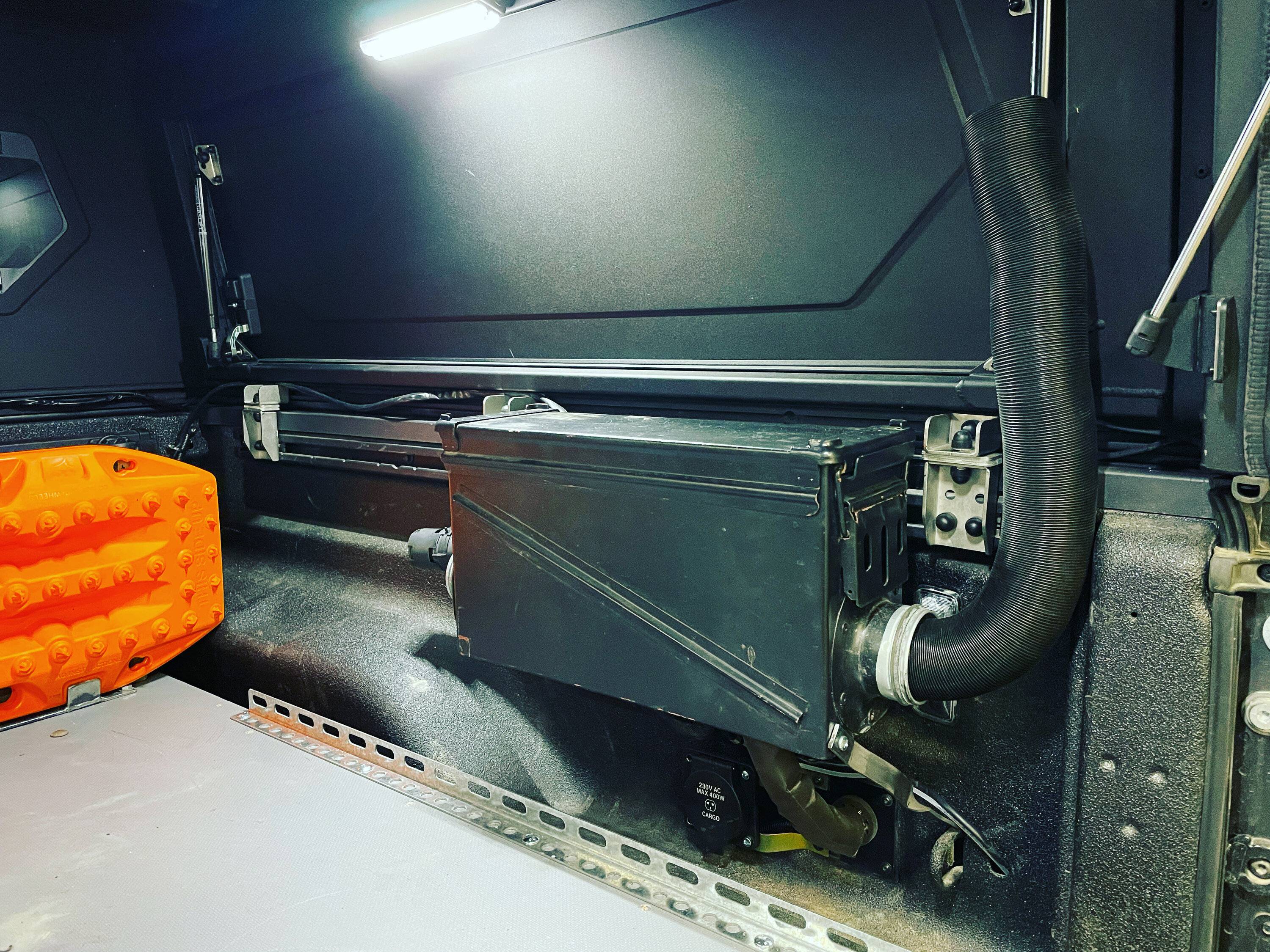

I have Eberspächer D2 for heating the tent, works much better than the chinese heaters.
I have external thermostat which i put to the tent for the night.
Originally D2 measure the temperature of blow through air. If it sucks the cold outside air, it will be hot in the tent.
-25°C (-13°F) was the coldest weather where i have camped, it kept the Alucab 3.1 warm(ish) during the night.

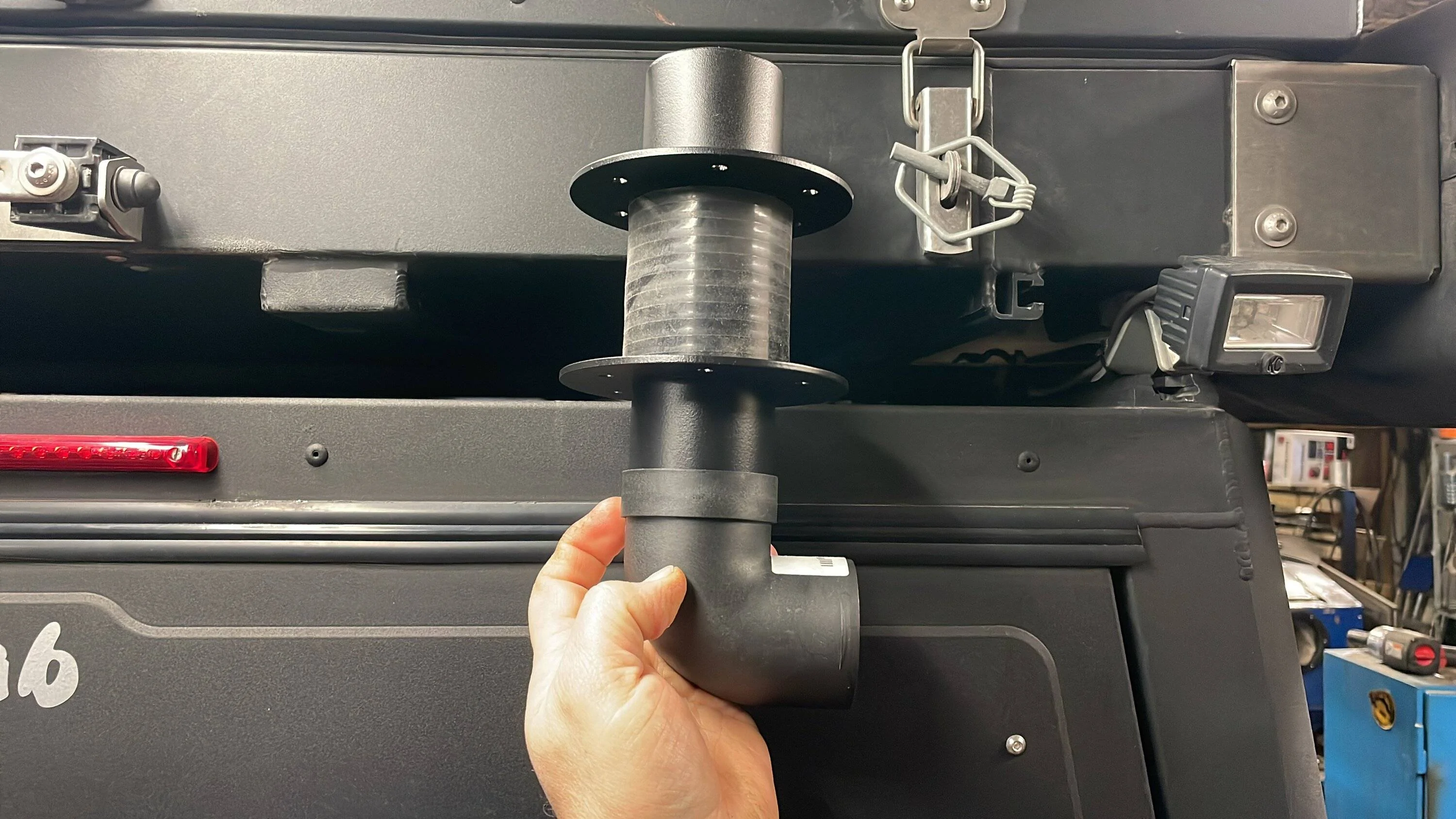

Heater is in the 40mm ammo box and in the lower picture is the parts which i used for getting the air to the tent.

Here's another Diesel Heater install from @JeeperFIN. Nice setup built in an Alucab and ammo can. Looks like the exhaust is routed through the Jeep bed sidewall. Nice job!
I really like this idea you have going on. I would probably find a way to bolt the heater to the roof of the canopy. But I'm really leaning toward a propex heater. Reason being is I think with 2 10 pound propane tanks I would have enough LP for 4 nights, then I dont have to dip into the aux tank. Although that is possible, it does add more complexity running a long fuel line to the heater.
