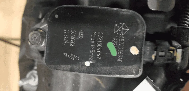

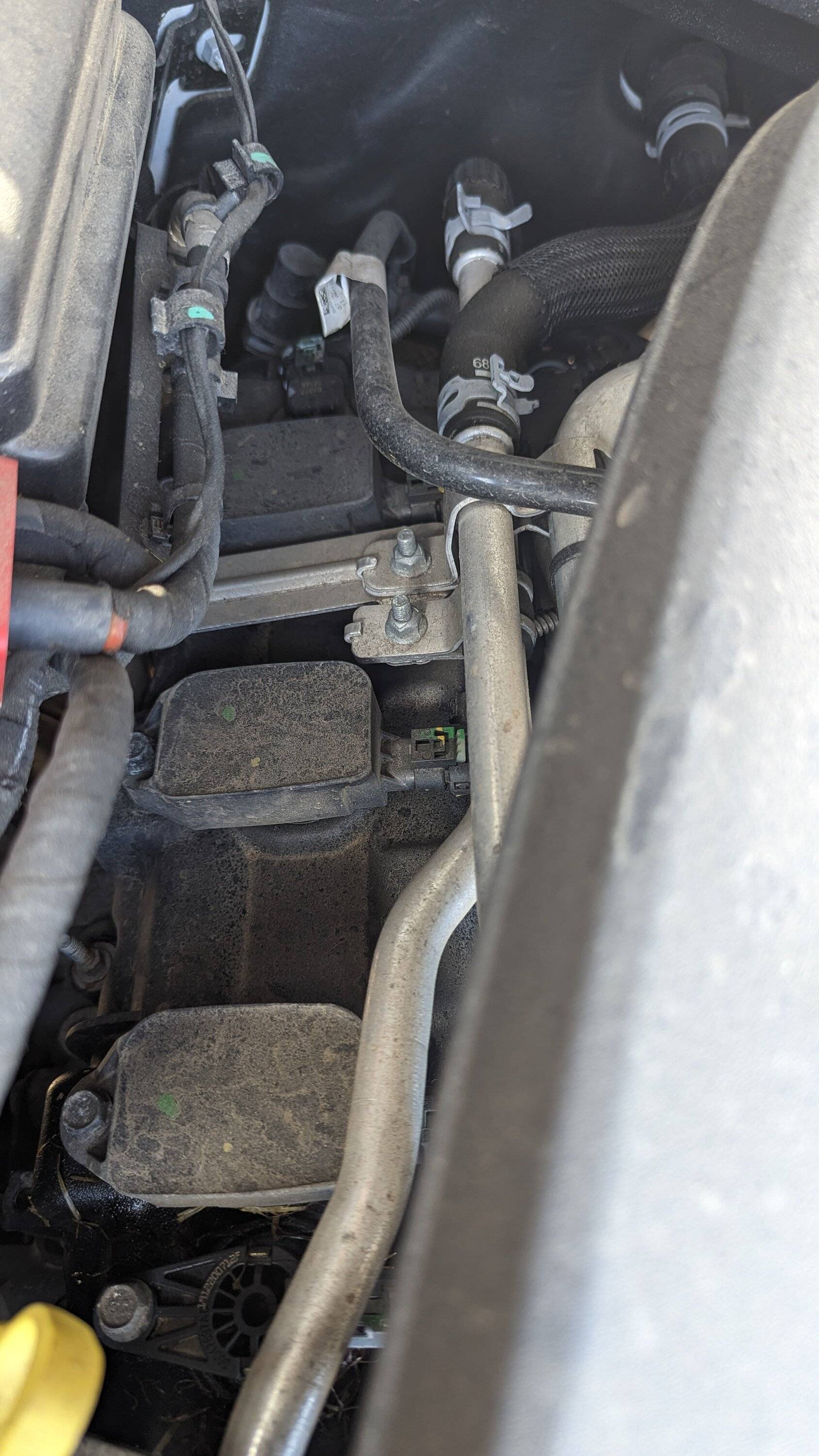

can somebody tell me the proper way to disconnect the electrical connector on the coil pack?
I pushed that white tab thing away from the coil pack, but could not get the plug to come off, i tried pushing down on the white thing, the black thing in front of it, nothing.
So I used a flat screwdriver between the coil pack and the lower part of the connector and popped it loose (or so I thought. I think what actually happened was the little bump/nub on the coil pack snapped off, so now the connector won't "click" back onto the coil pack.
So now I have 2 coilpacks that need zipties to hold the electrical plug on tightly.........FML :swear:
I shouldn't wrench on my truck anymore, but funds have been tight so I didn't wanna pay $500 for them to swap a coil pack. Maybe next time i should just pay it, lol.
After pulling the white safety tab back, pushing on the exposed black square tab should have released it. The problem is the connector was probably heat cycled stuck. I have done the same thing on some Ford fuel injector connectors before being ham fisted. Once you get the feel of one breaking loose, you get the others relatively easy.

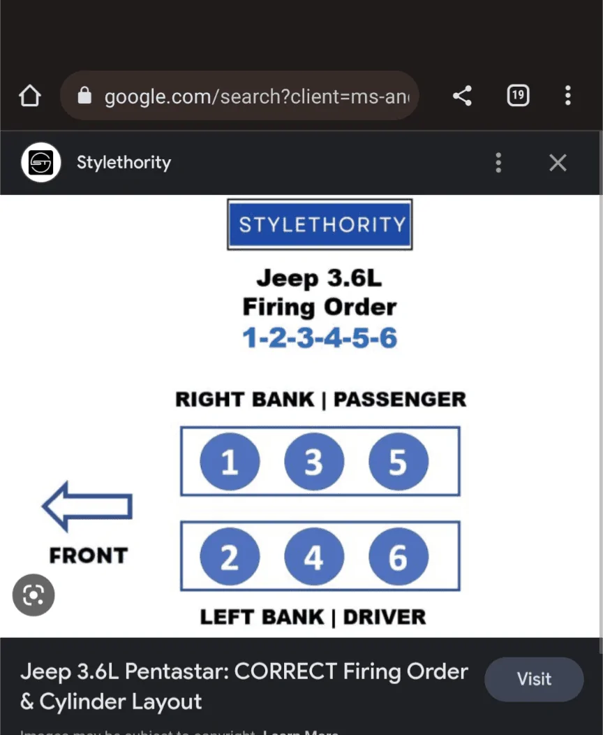

Issue fixed? I too have a misfire in cylinder 5 when accelerating above 5,000 RPM in fourth gear.
40,496
54,011
Have you done a freeze frame capture to see if it's ignition?
Has anyone scoped anything?
High speed, high load/high pressure often leans toward ignition.
