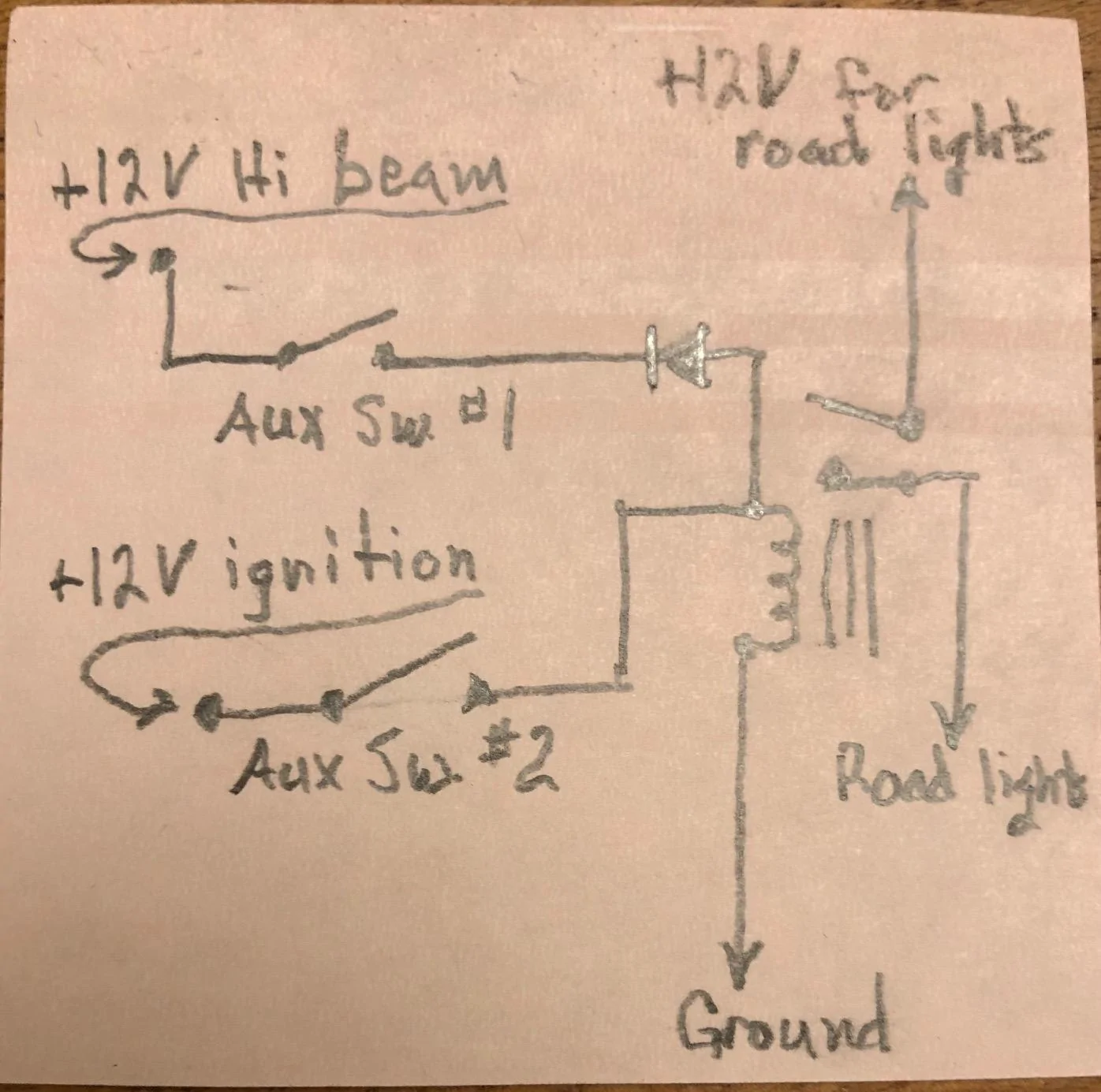

Since I think better in schematics:
Jeep Gladiator Help! How do I wire 6" bumper lights to high beam AND separate switch? 1646537384429
This is how I'd do it, since my aftermarket aux. switches are just contact closures.
I'm not sure if the OEM switches work like this, but I think they provide switched +12V. If so, then you'd need a second relay in place of the, "Aux Sw. #1," with that relay being controlled by, "Aux Sw. #1."
The diode is to prevent, "Aux Sw. #2," from powering the Hi beam headlights if you forget to turn off, "Aux Sw. #1."
This is essentially what ryanlsmith is proposing.
So now are you totally confused?
