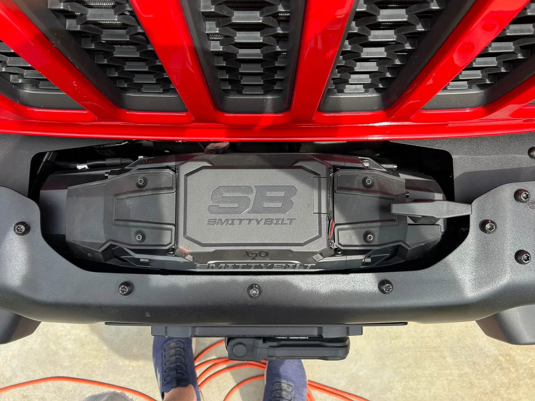

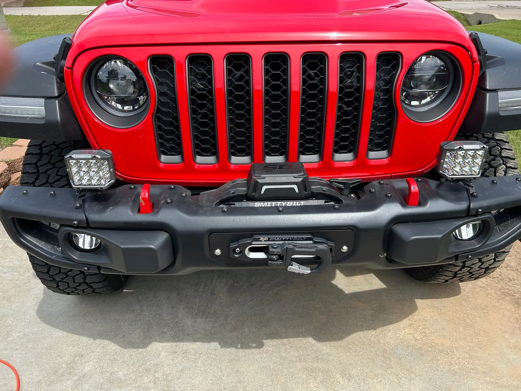

I replaced my plastic OEM front bumper with a steel OEM bumper on my Rubicon and it was fairly straight forward. I would recommend having a couple different lengths of socket extensions as well as a swivel adapter to help getting a couple of the harder to reach nuts on and off. I used a Grimm brand winch plate and a Smittybuilt X20 winch and everything fit nicely without any cutting or grinding of metal. I watched a YT video from Northridge (where I got the GRIMM plate) and that helped a lot.

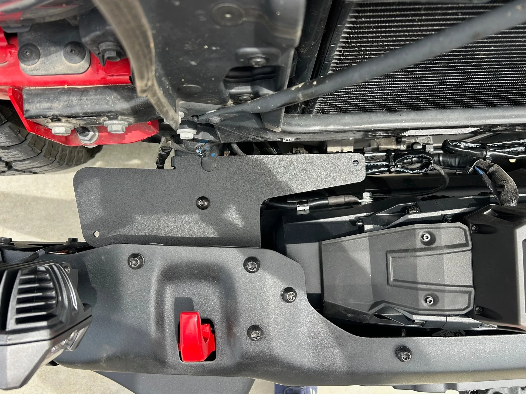

Where did you find the rear cover plates between the grill and bumper on the right and left sides?
Sorry for the delayed response! Maximus-3. They were a sponsor at one time not sure they still are but they do have a website. Listed under their winch accessories.
