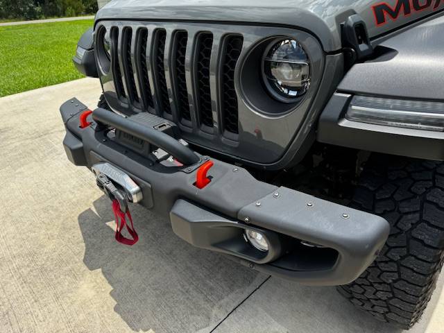

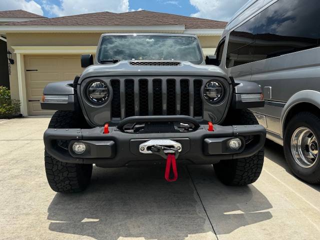

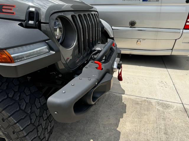

Nice. Are the review horror stories true? Missing bolts fog lights don’t mount up ?
Nope. At least not in my case.
Everything worked, everything lined up. The only thing that is true is that the plastic surrounds for the fog lights break during shipping as they are not boxed individually well... Those were the ones that I just purchased original ones to replace. The guys at ExtremeTerrain gave me a refund enough to cover them.
No missing anything... but those small bolts for the fog light housing are at pain to install...
Best thing is that everything is included...

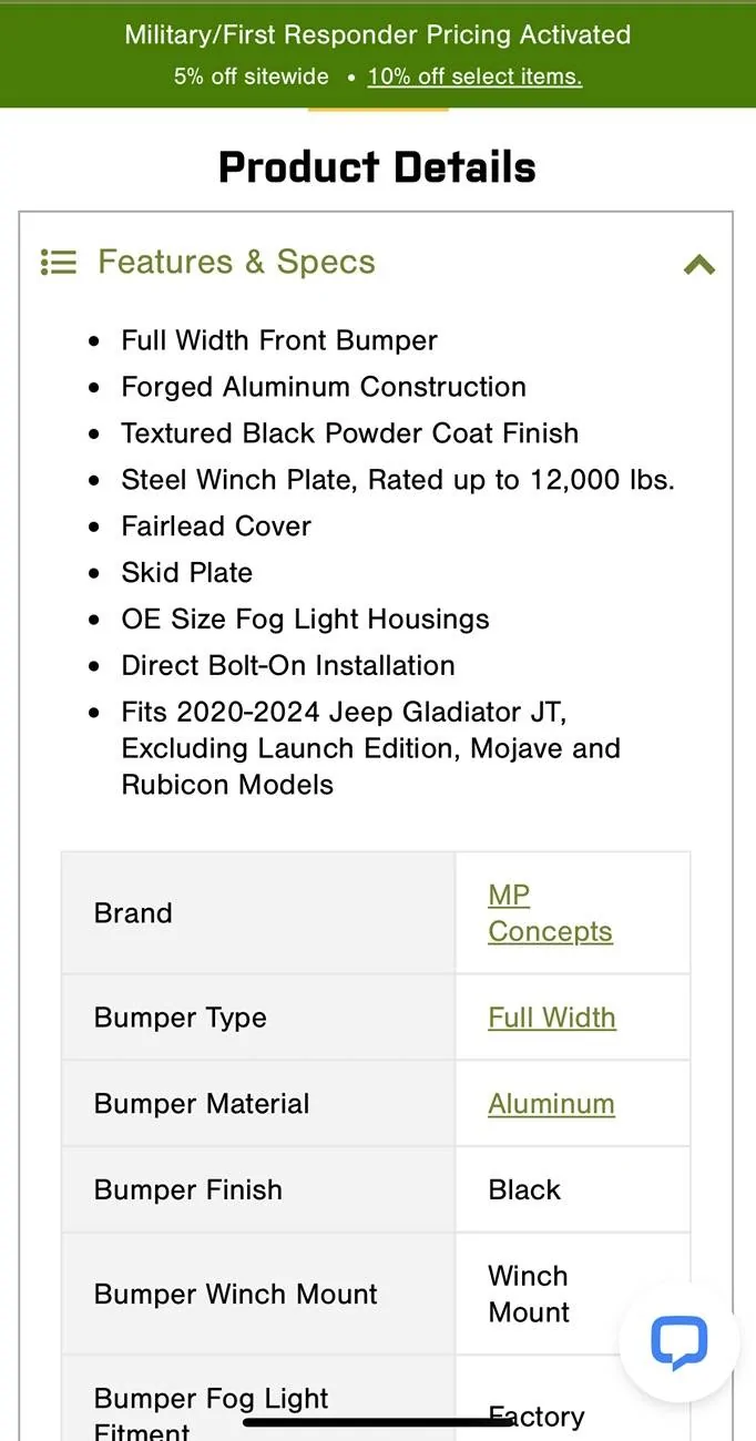

weird, xt says will not fit rubicon ?
Yes... and if you look, you will see my (and others) reviews having them installed in a Rubicon and Mojave.... mine is a Mojave and it was a perfect fit.

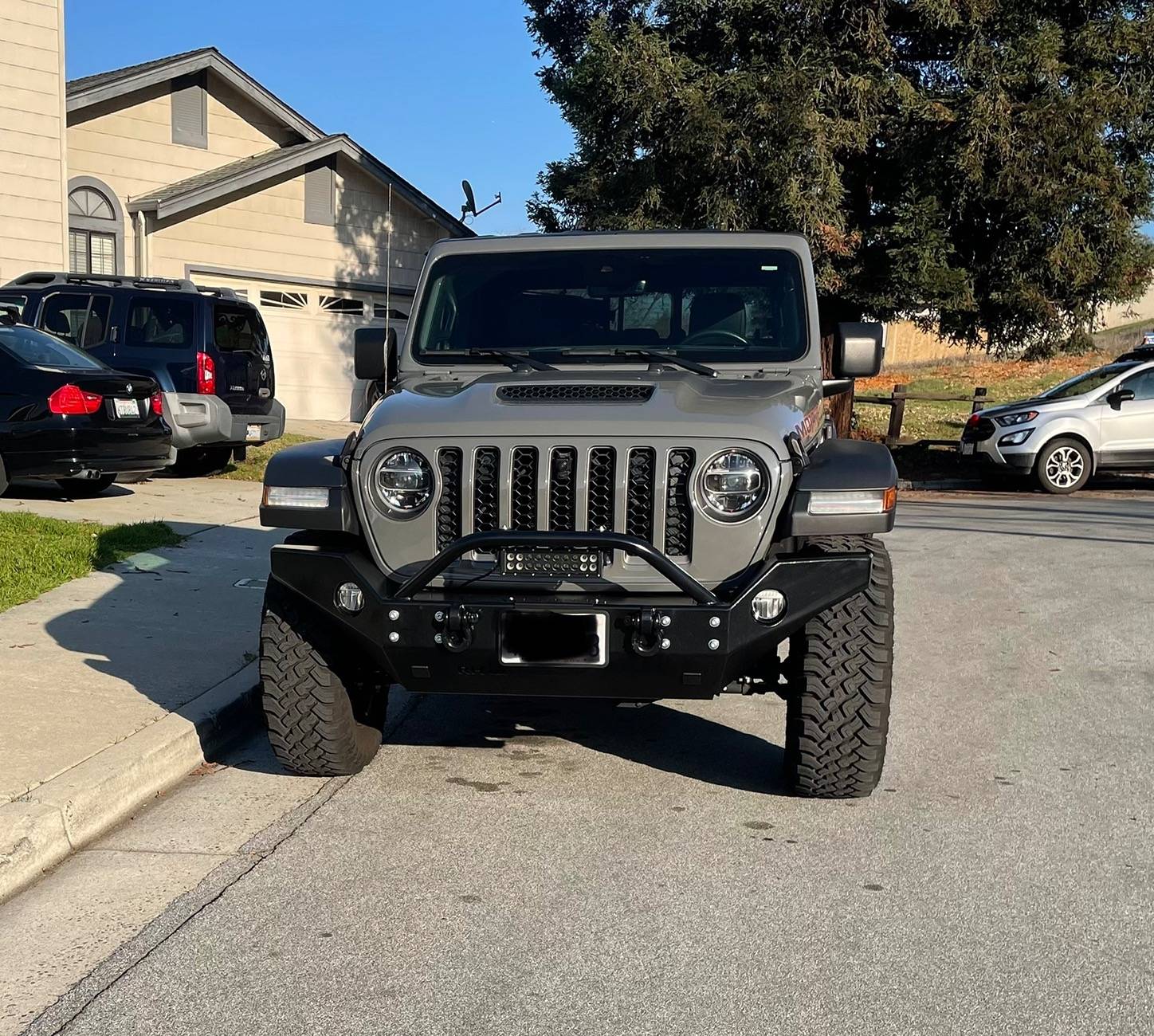

The Ebay bumper I bought for $385 was missing nothing. I seen nothing really difficult about putting it together. Just take your time and think about what you are doing , not rocket science. I was out to save weight as I do with tires /wheels for obvious reasons

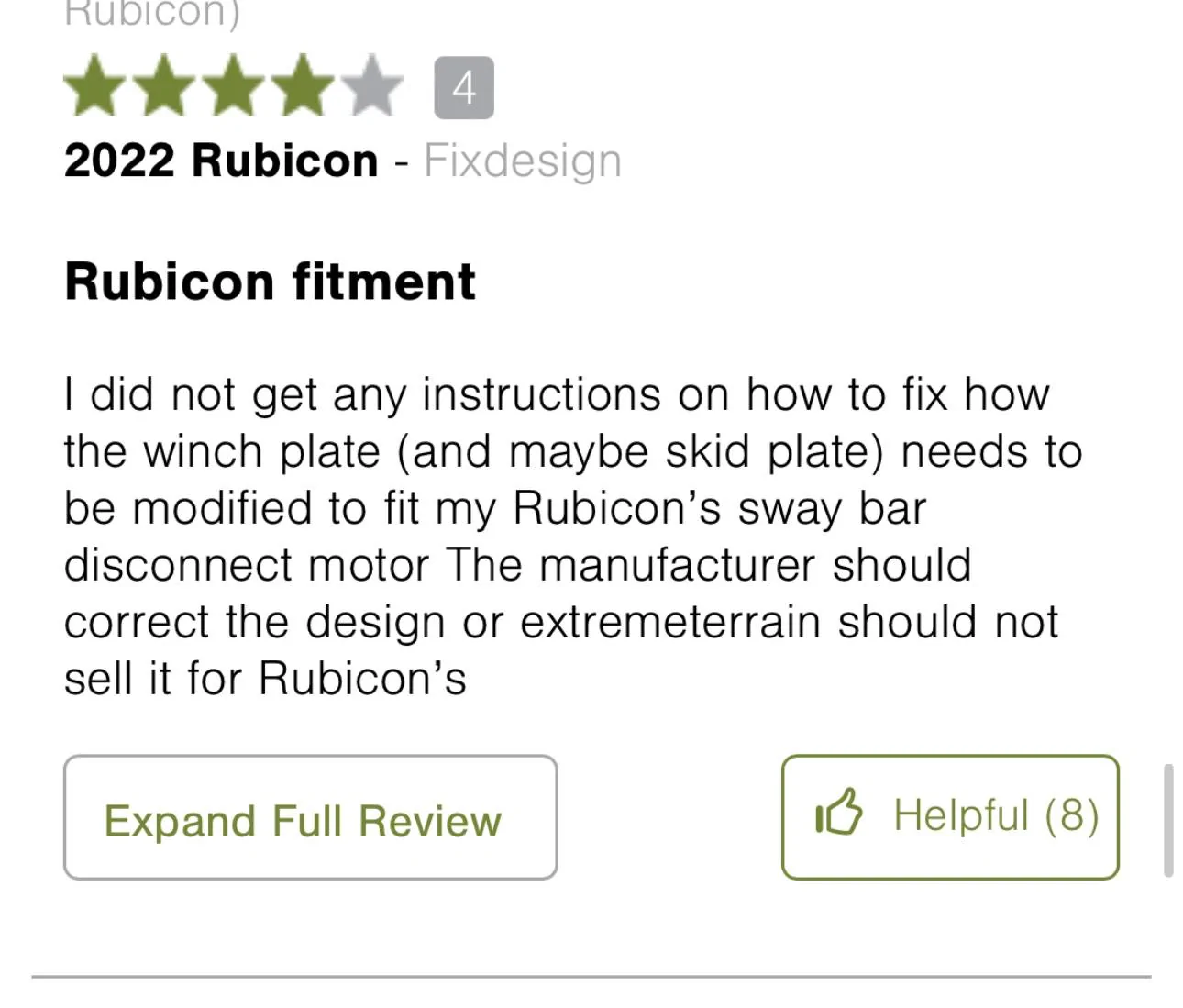

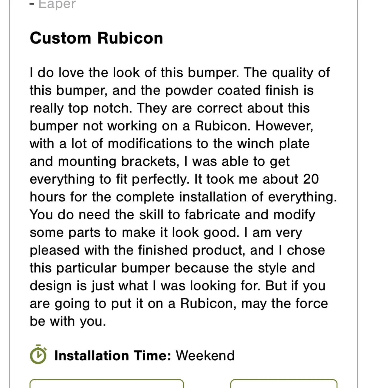

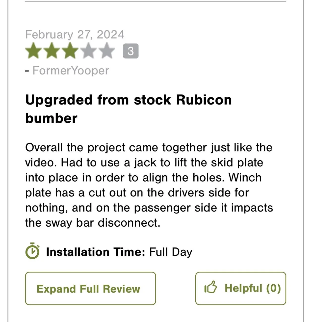

this is what concerns me. can you post a pic of the winch plate and where/ how it lines up with the motor for the sway bar disconnect?
if it is a simple matter of buying a different winch plate later on, so be it.
Jeep Gladiator help me choose a bumper? IMG_0337
Jeep Gladiator help me choose a bumper? IMG_0335
Jeep Gladiator help me choose a bumper? IMG_0336

Oh carp... Not having a Rubicon I did not drill into the details... I just read that they were able to install it on a Rubicon. 20 hours... man, that is a lot of work to make it fit then... the winch plate I mean...
My apologies for the confusion. :(
I can only confirm that I was able to install it in my Mojave without issues and without buying anything else.
