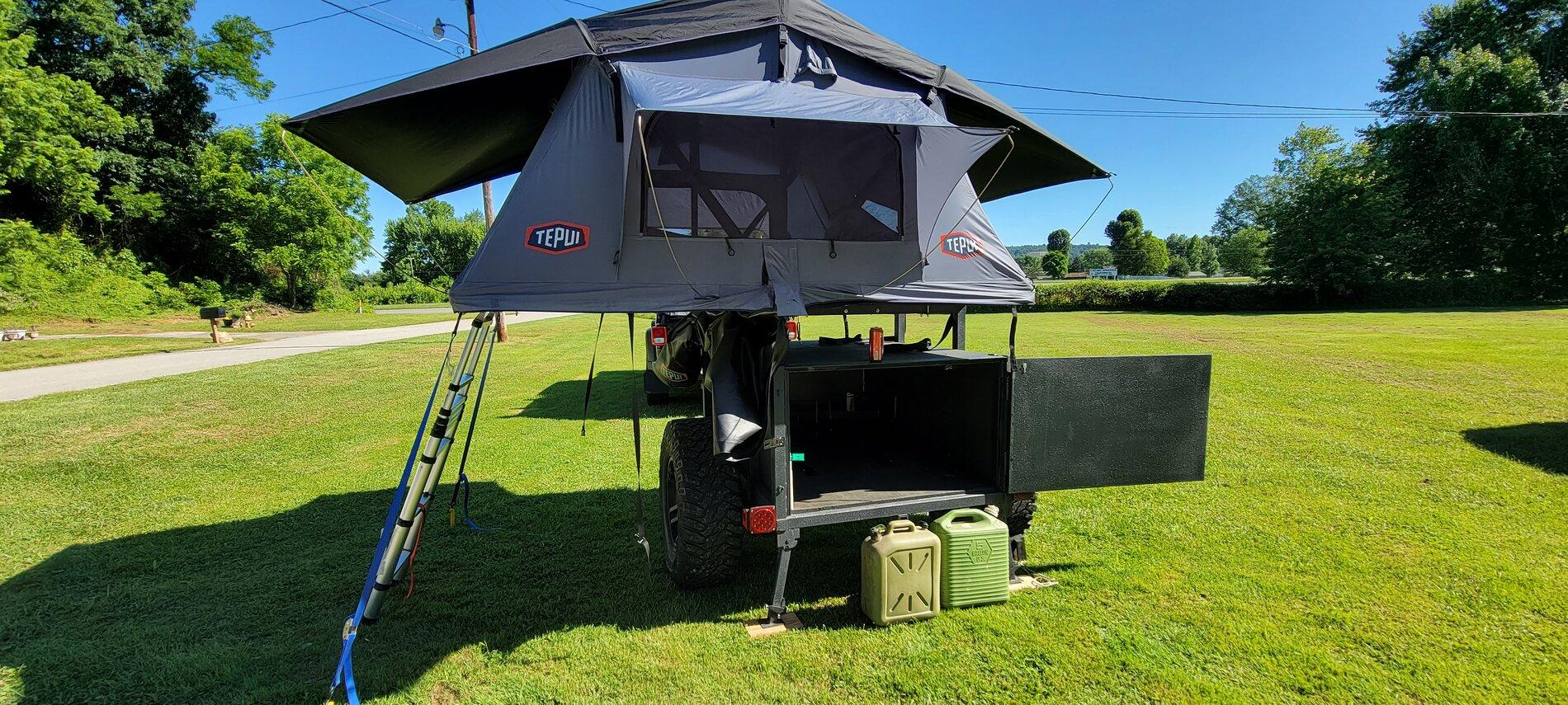

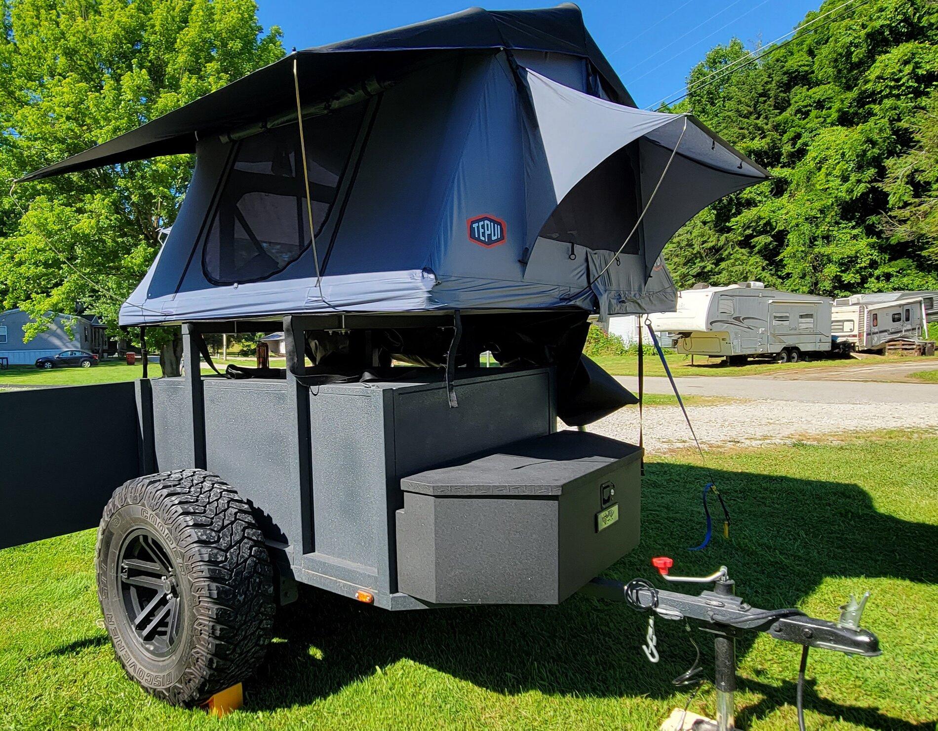

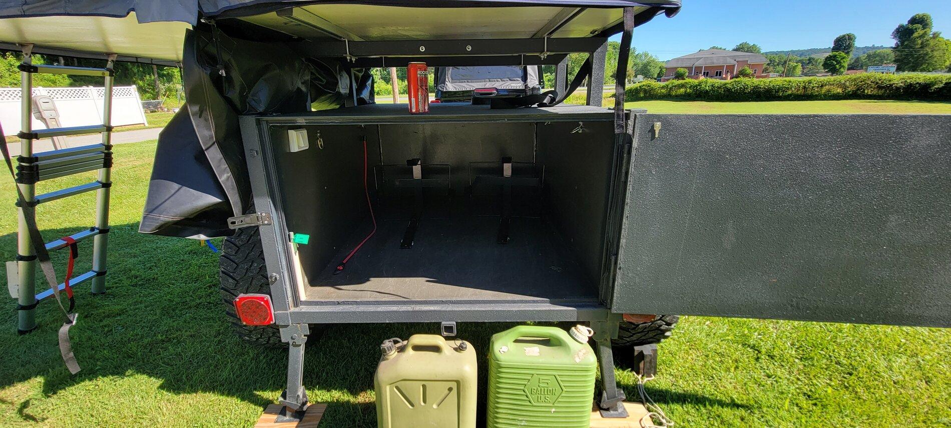

I got a rtt and offroad trailer.
Jeep Gladiator Help me get setup: Updates! 20210616_095404
Jeep Gladiator Help me get setup: Updates! 20210616_095314
Jeep Gladiator Help me get setup: Updates! 20210616_095305
So now I need to figure out how I want to setup a kitchen type pull out.
I'm also not sure about wiring. I saw someone on yt had a switch panel setup. "Lights" "Hot water" etc. I thought that made sense but I'm not sure about one aspect.
Let's say I tap into the power from the trailer wiring harness (think it is 7 pin) and run my switch panel. If I unhook the truck it's all dead (obviously). How could I wire something like that to then run off a jackery (w/solar) or similar?

I'm not an expert by any means but do play with it a bit.
I would suggest that you run your charge from the truck, via the 7 pin harness to a BCDC charge controller (Renogy and Redarc make them among others). From there you can run your lighting and fridge and also plug your solar panel(s) into the charge controller to help keep your battery's charge up.

so you mean (pardon the crude visual)
Truck-->trailer harness---> (trailer side of setup) Charge controller---->Lights, fridge etc
____________________Solar panels ^ (into controller)
ETA:
A quick search of that charge controller, looks perfect. So could I run that to a jackery or similar
Vehicle power goes to it via the trailer harness to keep things charged when connected but can add solar into it to charge while truck is disconnected. I just need a battery bank of some sort for it to maintain. am I getting it?
