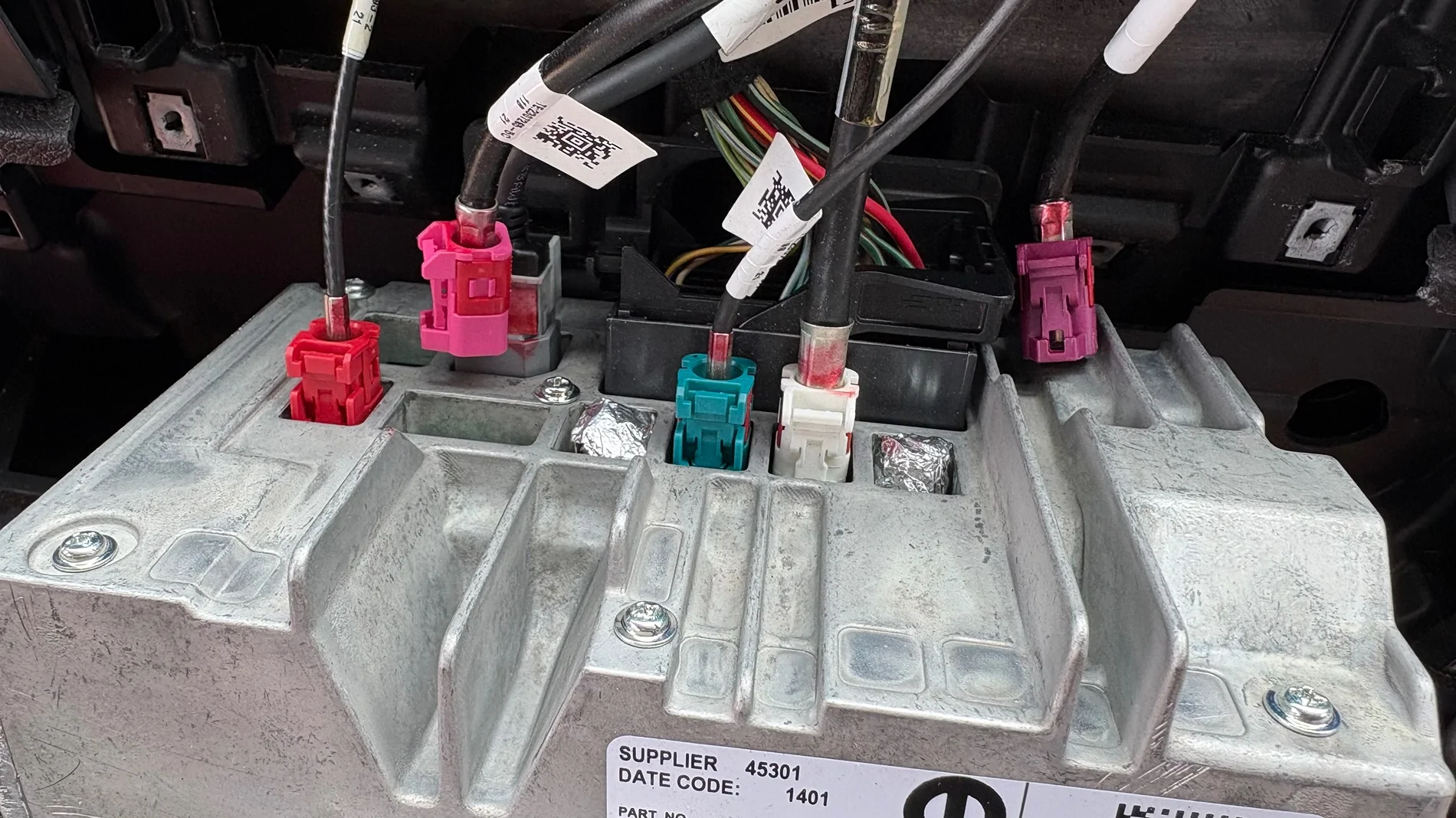

I’m going to just unplug the antenna from the LTE port and cap it with a 50 ohm dummy load to prevent cellular communication

Well, I had to go and unplug the pink one also…

The photos I took were after the antenna disconnect. Still have SiriusXM, Nav, and offroad pages.
HOWEVER, but this is a big one, I still get a 4G signal when I am really close to a tower, but the signal is very weak, and I can't tell if anything can send out. I tried Wifi hotspot, and when it shows no signal, it definitely does NOT work, but when it shows a signal near a tower, it tries, but my phone says "no internet".
If anyone knows of a method to actually check for signal, I'd like to know.
I can't figure out how it can get a signal out with both antennas disconnected. Not sure if has a fallback to the other antennas i.e. gps or sirius...

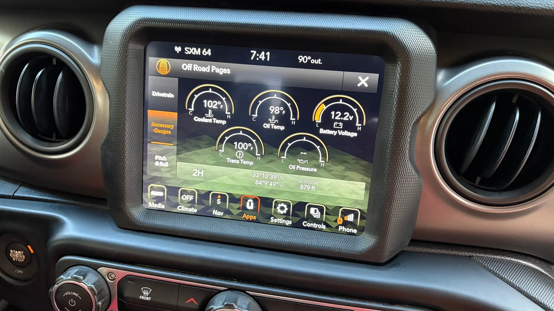

I even took the head unit completely apart and disconnected the ribbon cable that goes to the sierra wireless modem, and when I put it back together, I lost SiriusXM, offroad pages, and about half of my icons. Reconnected the ribbon cable, put it back together, put it back in, and still had no SiriusXM, or offraod pages, or any of the missing icons. I panicked, thought I screwed the pooch, but hooked up Jscan, went to the body control module, and die a "reset all ecu's" and that fixed it back to wha I had, whew...

I really don't want to lose my offroad pages, I find the gage cluster pretty good, I leave it there most of the time. I just need to verify if it can not connect to the mothership

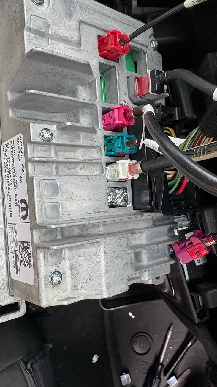

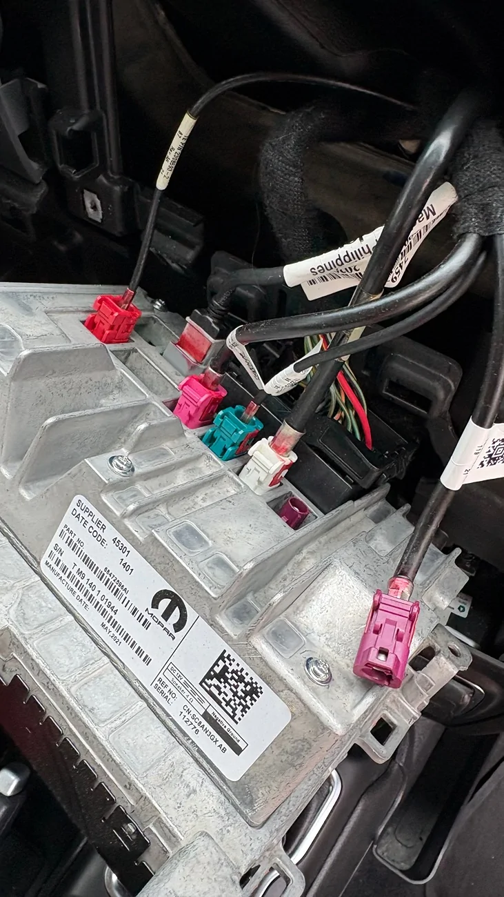

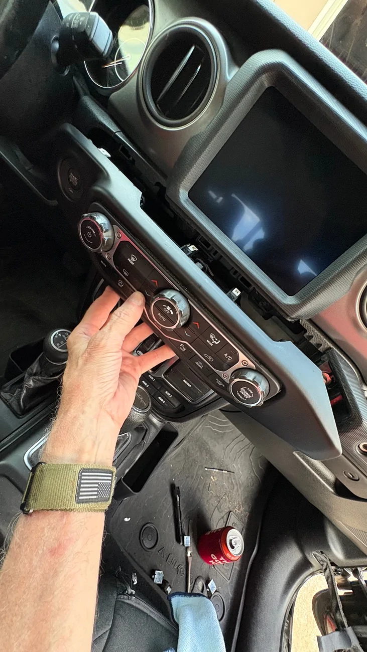

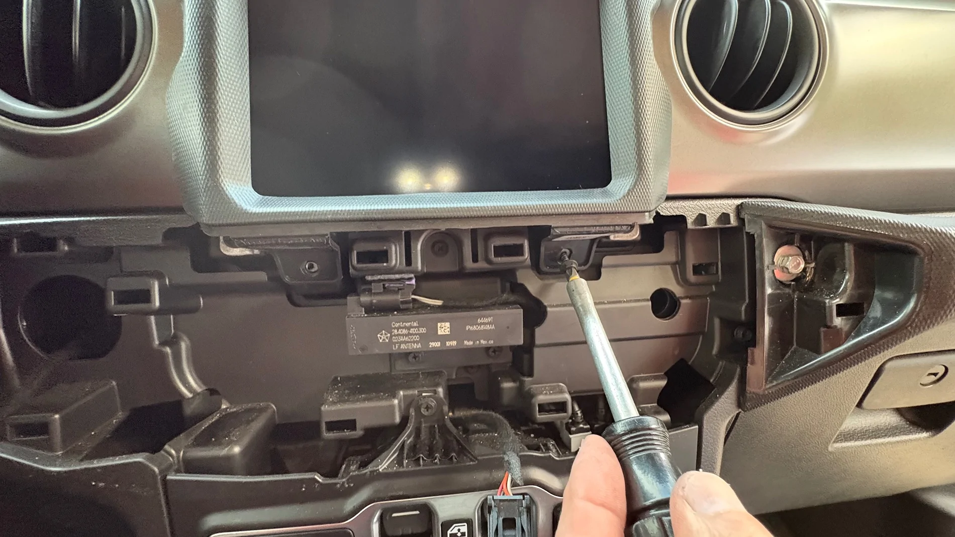

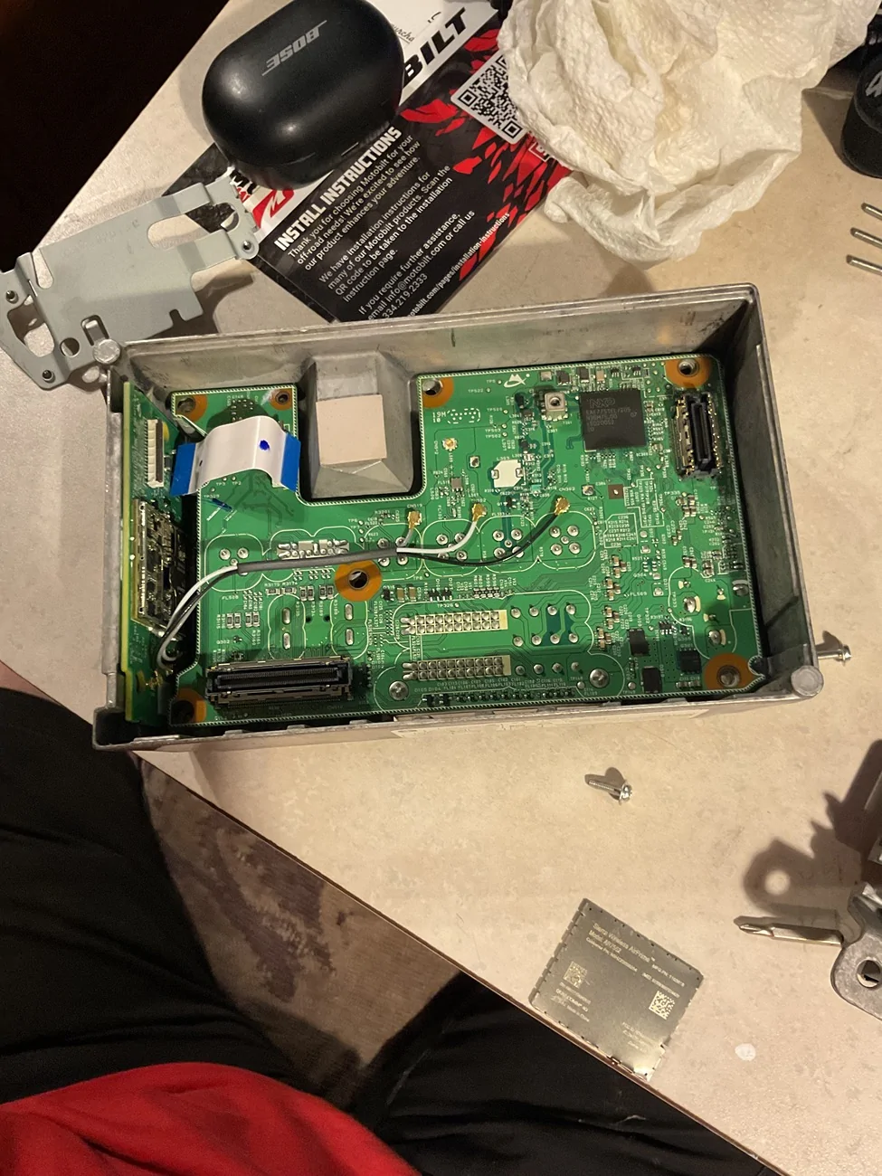

Update!

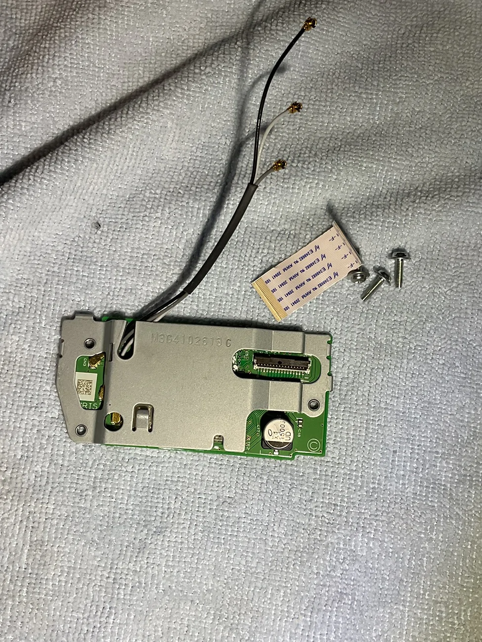

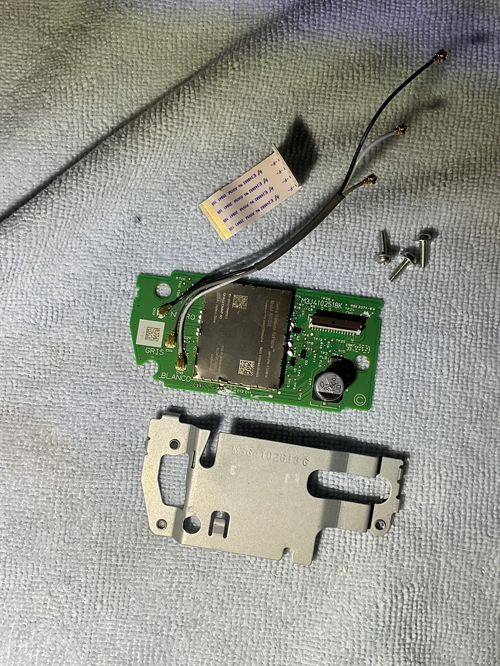

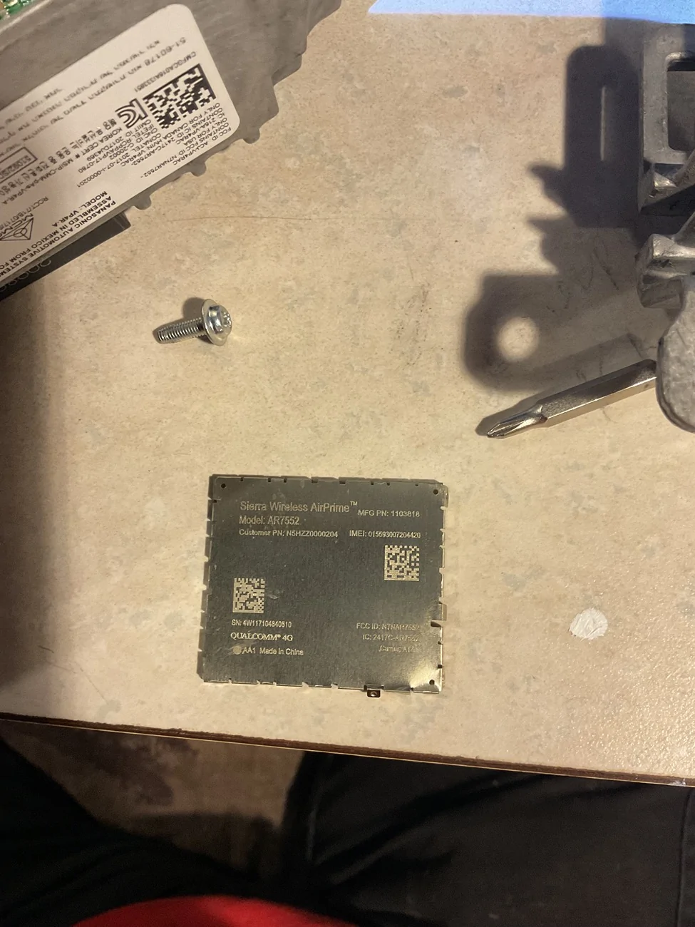

When I was near an area that had good signal, I would still get 4G, so, this is what I did: Disassembled Head unit, and completely removed the modem.
Jeep Gladiator HELP...Telematics Module Disconnect / Disable ? IMG_0254
Jeep Gladiator HELP...Telematics Module Disconnect / Disable ? IMG_0256
Jeep Gladiator HELP...Telematics Module Disconnect / Disable ? IMG_0258
Jeep Gladiator HELP...Telematics Module Disconnect / Disable ? IMG_0259
DiehardTory
DiehardTory
Dee
Jan 6, 2024
384
463
Mid Atlantic
Gladiator Mojave & XJ
Retiree x1 working on x2

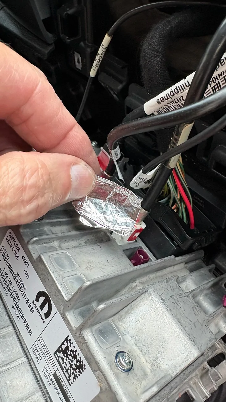

Thanks for posting really good info & pics... FYI - I discussed with my friend a Jeep Tech (fully factory trained and certified) who said "When in the shop and they connect up the diagnostic equip it downloads all from the PCM". The data goes to FCA/Stellantis at that time. I will most likely do the disconnect of the 2 wires at the head unit and get out the "tin foil helment" too. As you see I have 2 Mojave's and the 21 with the standard radio will be much easier than the 23.

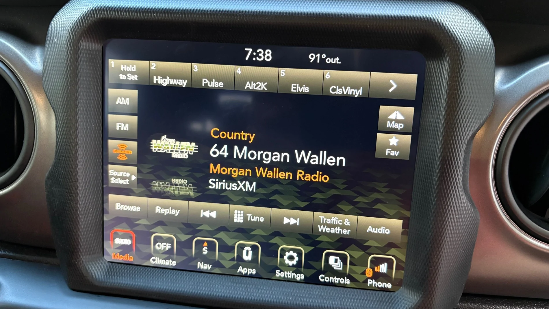

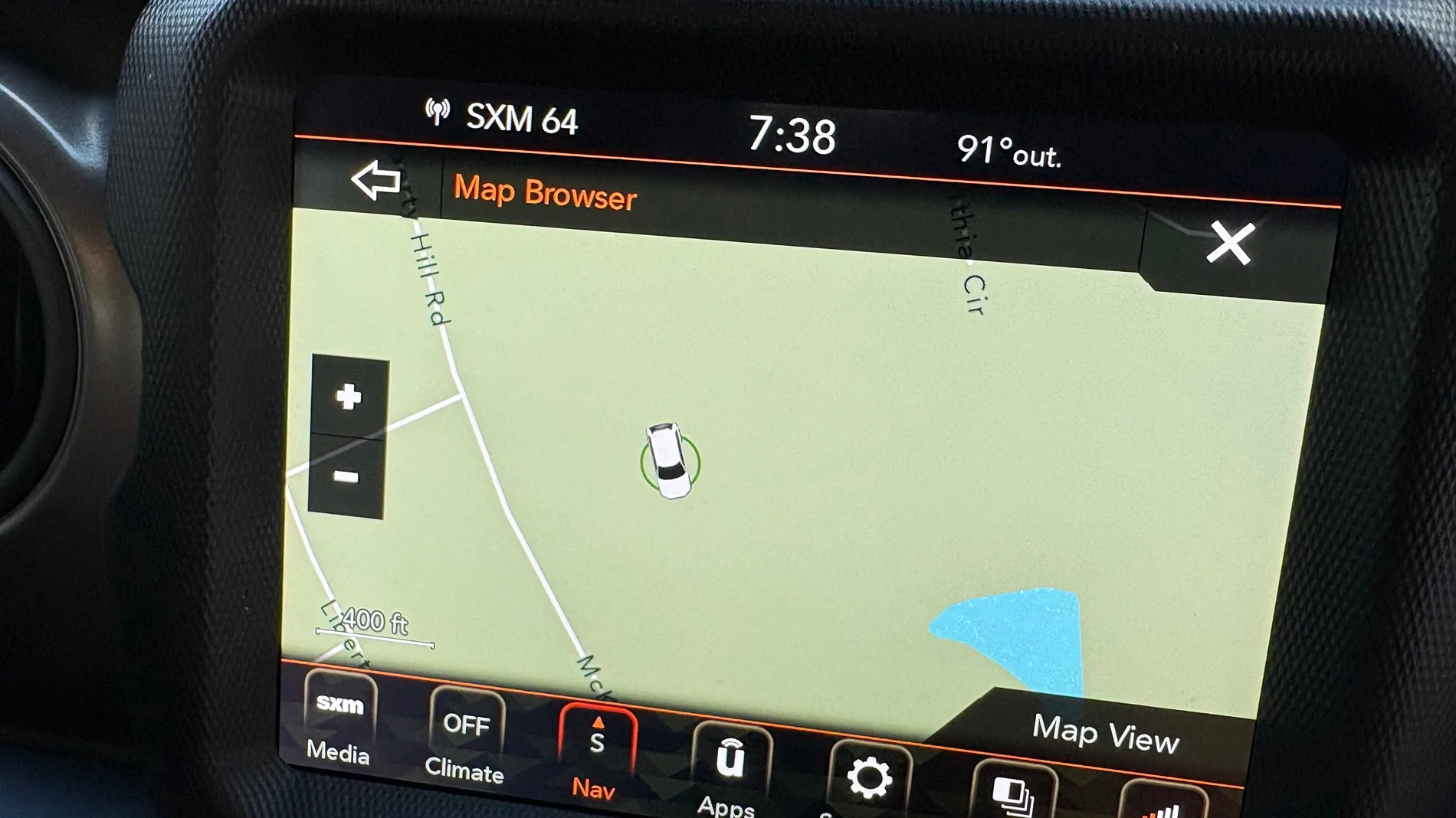

Update!
So, with the modem out, I lost all satellite comms, thus no NAV...
So, I put it back and removed the black and the grey micro coax wires that go between the modem and the main board, and now I have NAV back, BUT, if I am directly under a tower, and I mean literally under a tower, I still get a couple of bars, so I tried to do a "service call", and search in the the NAV system, both failed, so I'm thinking it is not capable of transmitting data, but not absolutely sure. If someone knows of a method to measure actual signal outside of the Jeep, and maybe data transfer, that would be cool.
I would try the hotspot, but I don't want to pay for a subscription, just to do a one time check.
Can't say for sure about the SiriusXM, as I HAD some stations during all this, and they stopped, says I'm not subscribed, but I bought the Jeep used, and it was active, so it might be a coincidence that the subscription ran out.

Thanks for all the info! I completely unplugged my modem, all 3 wires + the ribbon cable. The only antenna I plugged in into the back was the white AM/FM antenna.
At first, I also got the extremely basic home screen with many apps missing too. I might've been OK with that, but my front / rear cameras also didn't work. After a jscan ecu reset, I got my normal screen back, even with the modem still unplugged. Front rear / cameras work again, off road pages still works too.
Trying to do any uConnect things, I get "service not available" so as far as I can tell it no longer has any internet connection.
I do find it strange that I still have GPS signal though, even with with GPS antenna removed. The map still accurately shows my info. Is the GPS signal just strong enough to reach it even without the antenna?
