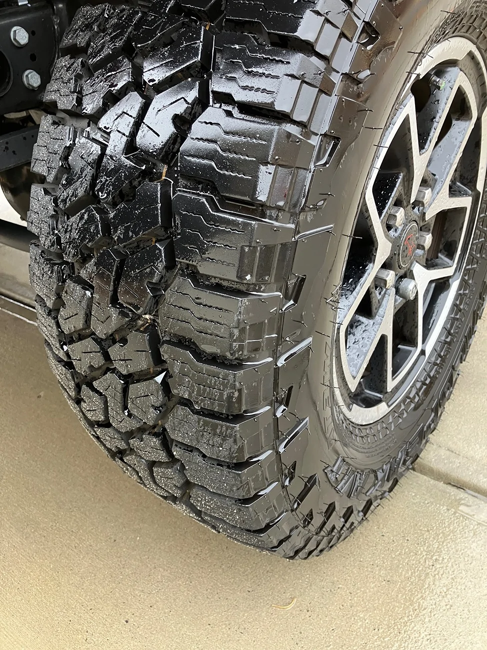

Aren’t those Falkens a pretty tame tread already? I could see making the swap from mud terrains, but wouldn’t expect much difference swapping from ATs.
This is the Wild Peak A/T 285 70 17 that came on the Rubicon. I’ve been running 35PSI cold, and I think I’m going to air down to 30lbs before I do anything else.

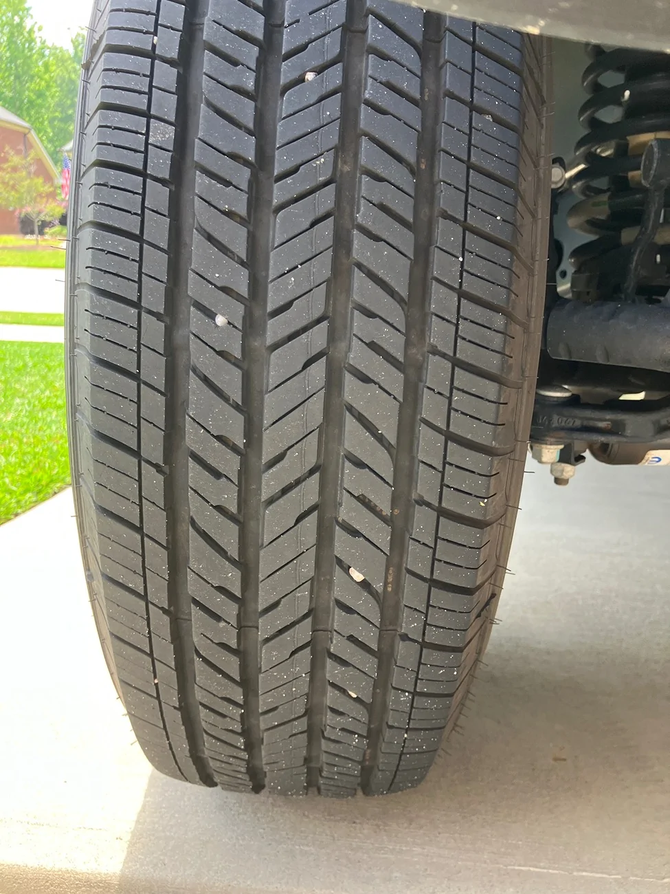

And this is what came on the Sport S. I believe they were 245 70 17 all season. They were just basic light truck tires. I’m pretty sure I ran them at 35 cold which I think is the spec. But the ride between the Rubicon is somewhat like a dump truck compared to the Sport S which I found to be pretty agreeable.
Jeep Gladiator Heresy? road tires on a Rubicon?  ETA- now a shock install IMG_4886
Jeep Gladiator Heresy? road tires on a Rubicon?  ETA- now a shock install IMG_4888
