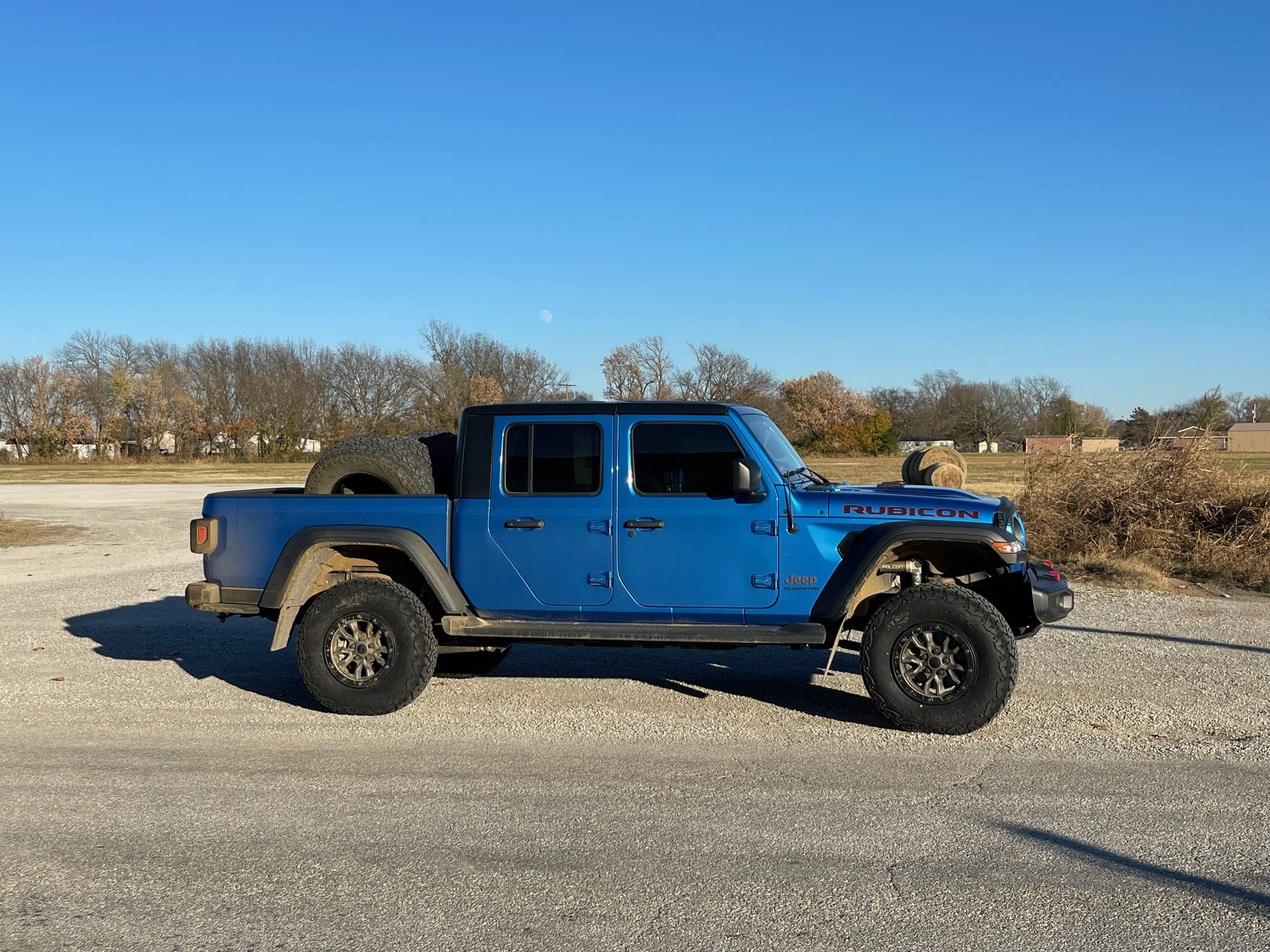

I installed the Clayton 2.5 Overland Plus kit on mine. It actually lifted my Rubi 3.5 inches. The attached picture is with 35" tires and 37s would easily fit. I bought the lift during one of Clayton's sales and got the Falcon 3.1 shocks on clearance because they were being phased out for the Gladiator. For the lift and shocks I paid $3,590 and installed it myself in the driveway with a lot of help from the forum, Clayton, and youtube. Clayton also offers a 1.5" Ride Right lift that might be worth looking at.
https://www.claytonoffroad.com/product/jeep-gladiator-15-ride-right-lift-kit
My understanding is that this lift comes with the same components as are used in the Overland kit but you only get 2 front adjustable control arms rather than all 8. Depending on how much the 1.5 kit actually raises your JT, you should be able to get by with your factory shocks but you might want extensions.
Before ordering my lift I had it narrowed down to either Clayton and Metalcloak and I talked with both more than once. They are both excellent companies and they are more than happy to help. In my case I went with Clayton because I didn't want to upgrade my driveshaft. No matter whose lift you order, it will be worth your time to call them up and ask questions. Without exception, everyone I've talked to about Jeep parts have been very helpful.

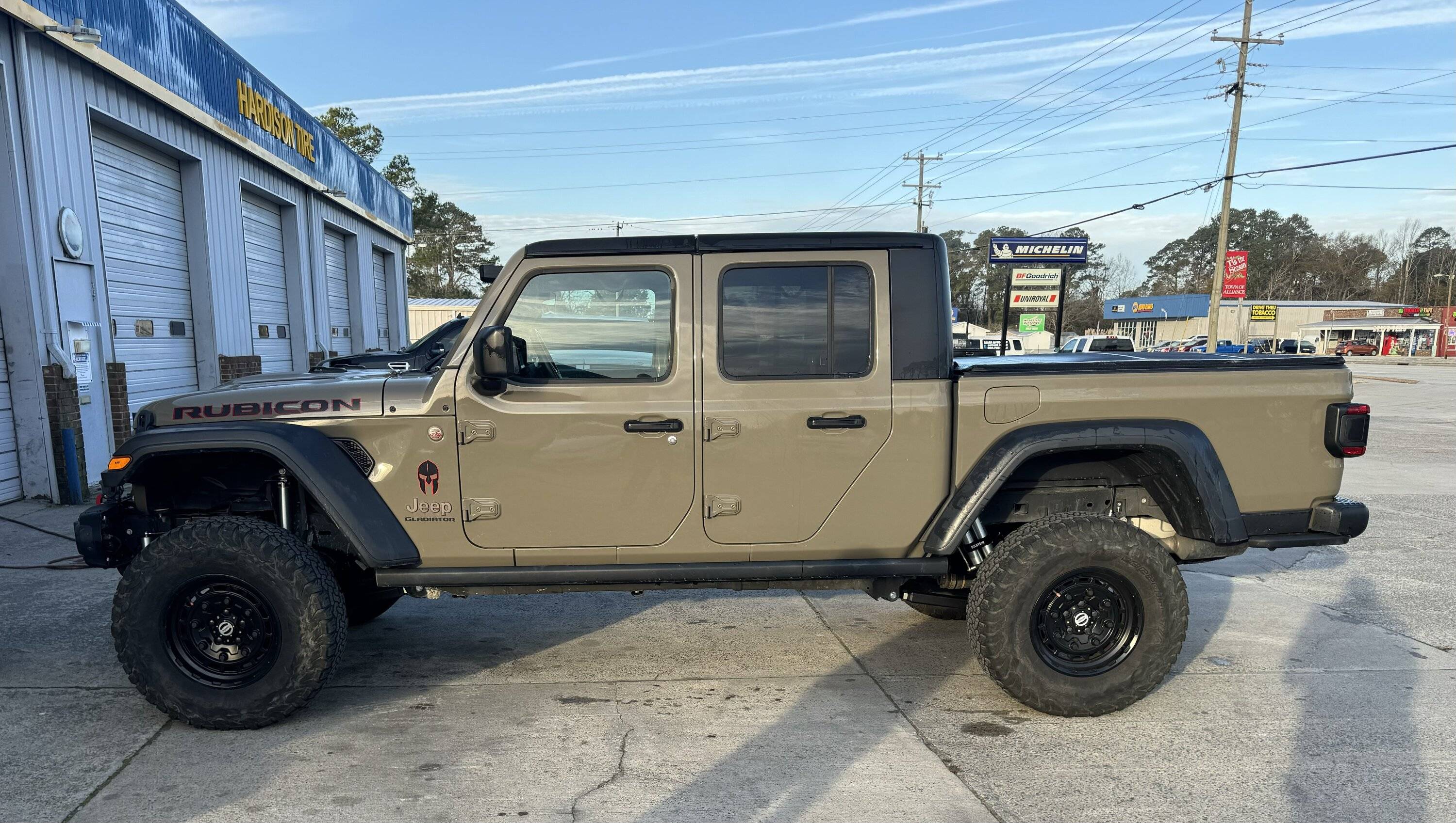

I have the Clayton 3.5 Overland lift I just put on last month and I am still on my 35 KO2’s. I will go up to the KO2 37’s when it is time to replace the tires, but I am not in a hurry to do so. I paired the lift with the Bilstein 5160 shocks.

I like the ride now better than with the stock shocks. It is definitely what most would consider a harsher ride, but I was not a fan of how soft the stock Rubicon shocks were. I like the way it rides and handles now with the lift on it, hopefully I will get it out on some trails soon.
Also it is the Clayton 3.5, not Metalcloak; both company’s make a quality product but I went with Clayton after researching and deciding on my needs. I was just shy of 40k miles when I added the lift and had taken it out offroading a few times when it was stock height on 35’s. Figuring out what you need before dropping the money on upgrades is the way to go.

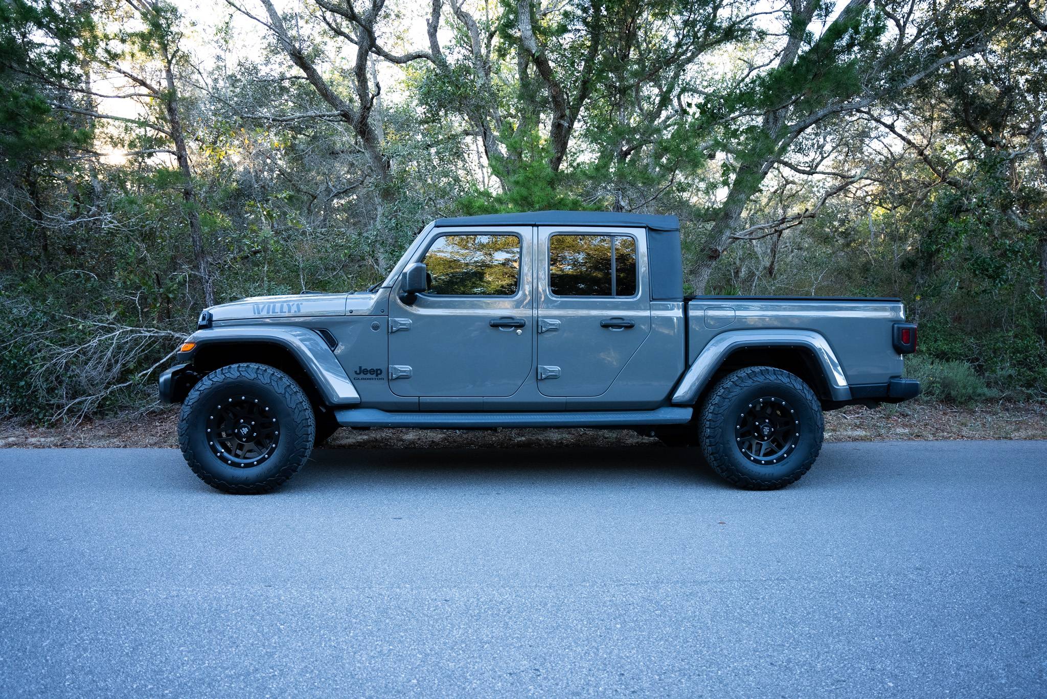

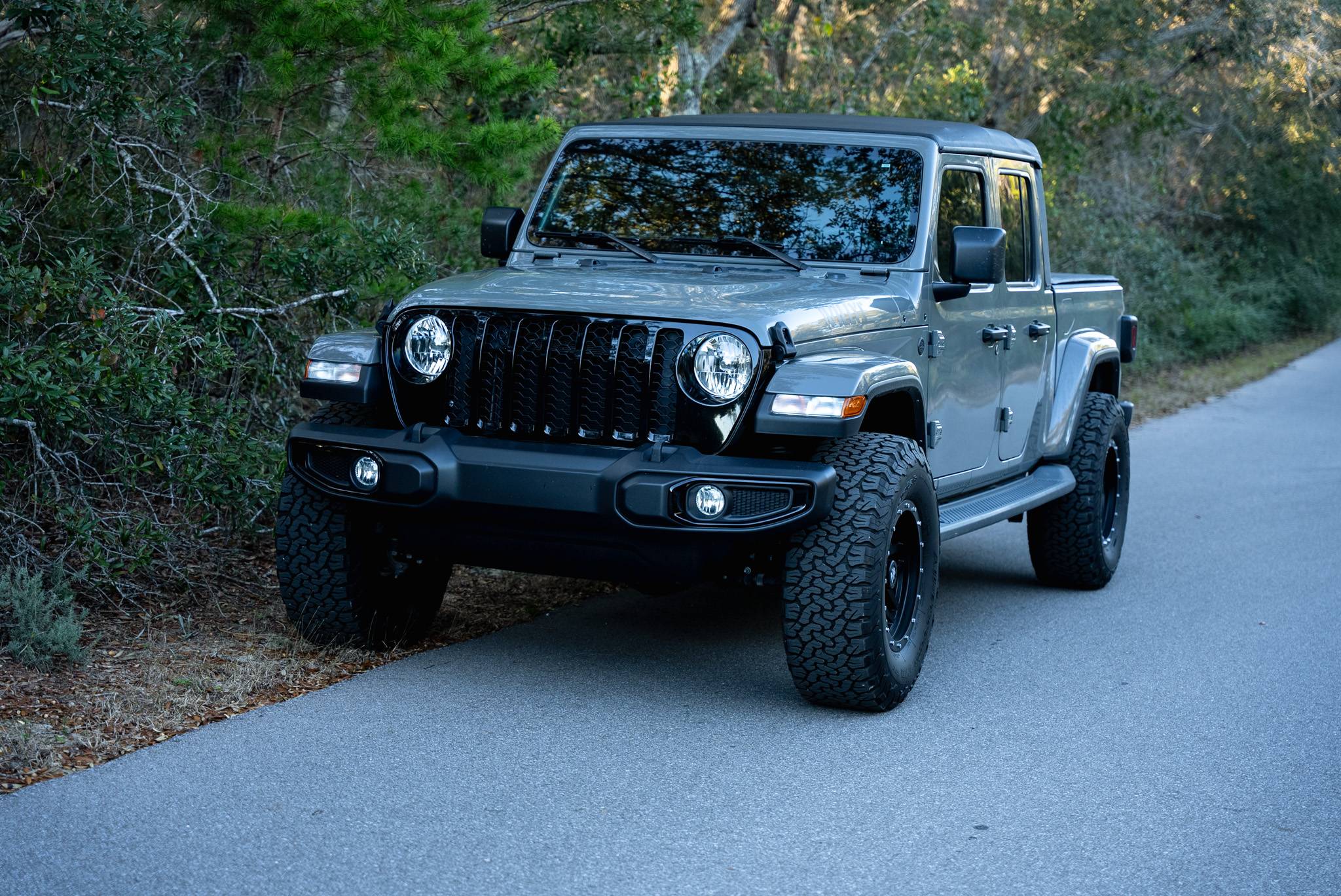

I just got a 2022 Jeep Gladiator willy's manual and it came with 315/70's BFGs. I would like to move up to a 35 to 37 inch in the future. I need a suspension lift that will not look too high and make my wheel look like a roller skate with the intension to upgrading tires later on. I was thinking suspension, re-gear, then tires. I drive mostly on road but want the capability to flex off road. I would even consider getting a kit with front lower control arms now and adding all other arms at a later date. My budget is $2,700 dollars as of right now. Thanks for any response in advance.

Drive it first, on road and off. See what it can do. Then decide what you want to do.
Most of these are more capable than the driver in stock form.
Adding lifts and changing parts just for the sake of doing so is not a good idea.
The higher you raise it and the bigger the tires makes your on road driving experience not as pleasant.
But, if it's just aesthetics you're after, you'll do what you want.
That thing is sweet-looking just as it sits. It's a great color, and I think those wheels and rims are perfect for it. Fill up the wells nice and look on the money to me.
Isn't the current size on there considered a 35" tire"? I think that is a great look without all the issues that come along with a lift. Who am I to say though? Now I want to replace my 33's with 35's after seeing this! I can do it without needing a lift though so a bit easier for me. Maybe when my tires wear out I'll bump up. Your's looks perfect to me.

Beautiful truck. Looks to me like it has already got some kind of levelling lift in the front.
