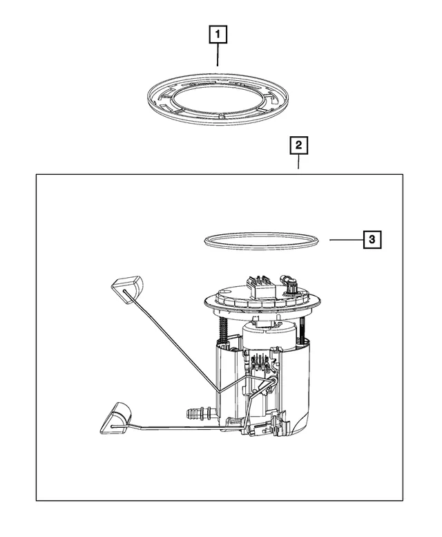

JT uses a lift pump

When you change fuel filter and cycle start button on/off till you hear tone change it’s that pump building pressure.
Got it - totally makes sense, loading the filter and lines up with fuel.

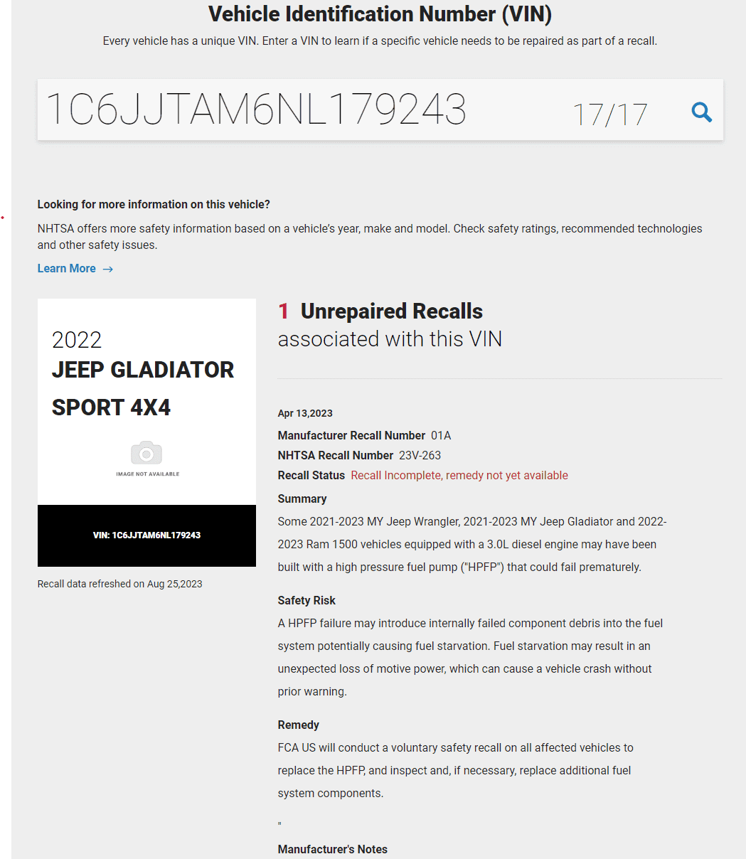

Not even so much the junk fuel killing them. It is the roller tip lifter getting sideways in the bore then eating itself and sending metal throughout the system ruining everything. Can you imagine running roller lifters in your traditional big block without a link bar? same thing.
Next question. That gets replaced to when the CP4 fails.

I do not know. I’m sure the tank gets dropped and inspected for metal. At $10k for a repair I imagine almost every component in the system gets replaced but don’t know.
