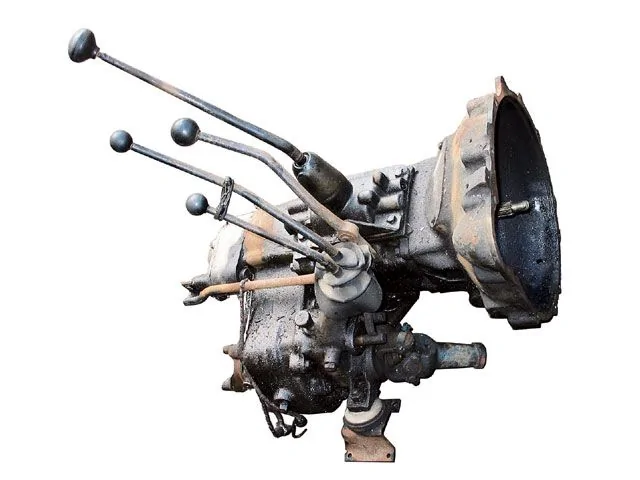

Things that are better with automatic control:
TV's, Dentistry, forestry, and card catalogs. Clickers are good! It's hard to get your tooth drilled if the dentist needs to rest halfway through. Trees are big, but not too, with modern machinery. Card catalogs suck compared to having all library's ever in your phone.
Things that are better with manual control:
Jeeps.
And
"I'm so excited I am going to take a picture of my 2020 automatic transmission", said no one ever....
Jeep Gladiator How hard is it offroading in a manual transmission? 154_0605_04_z+jeep_junk_parts+overdrive_18
