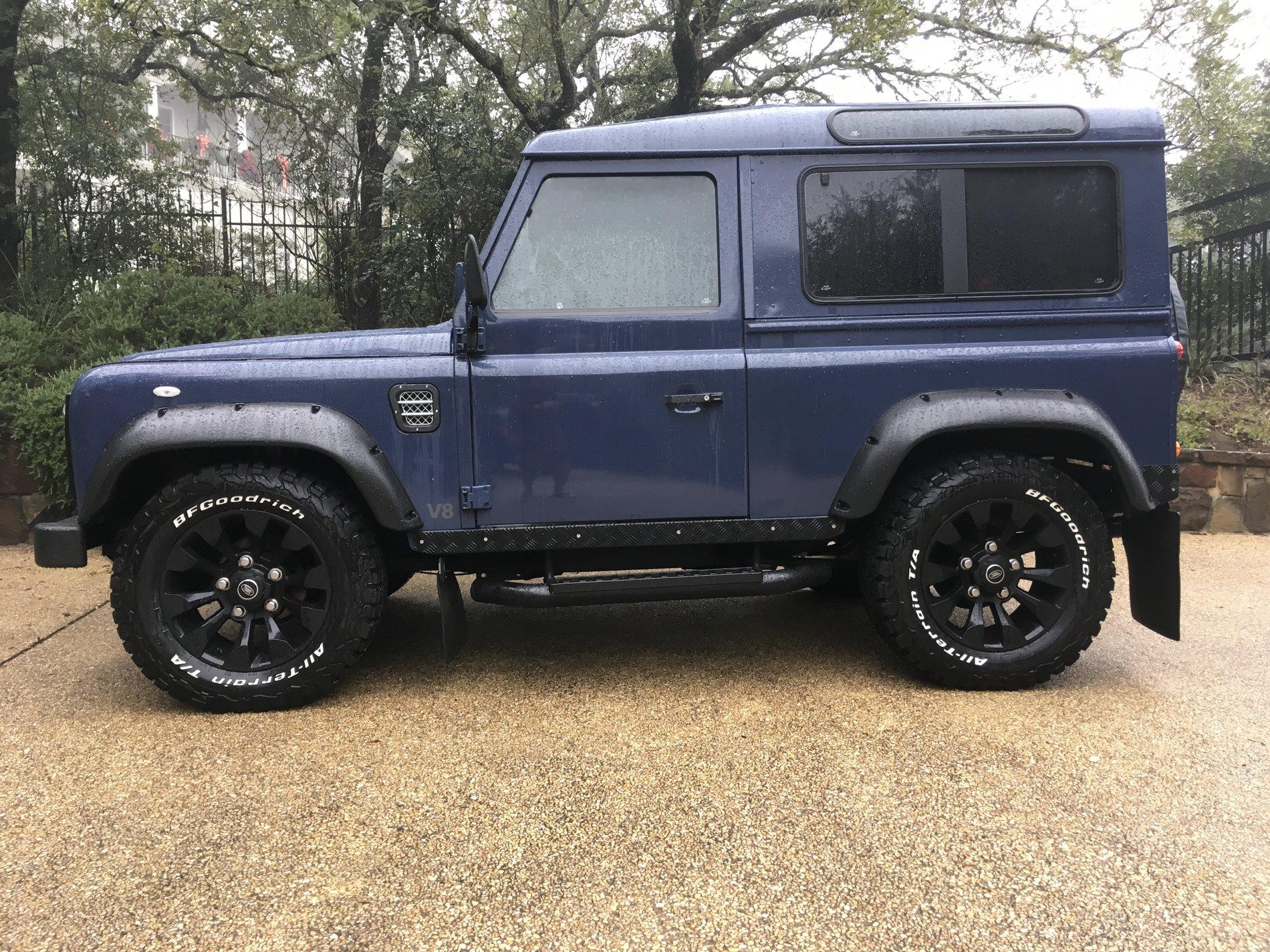

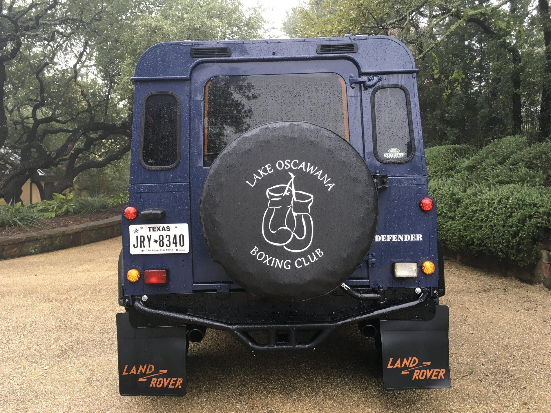

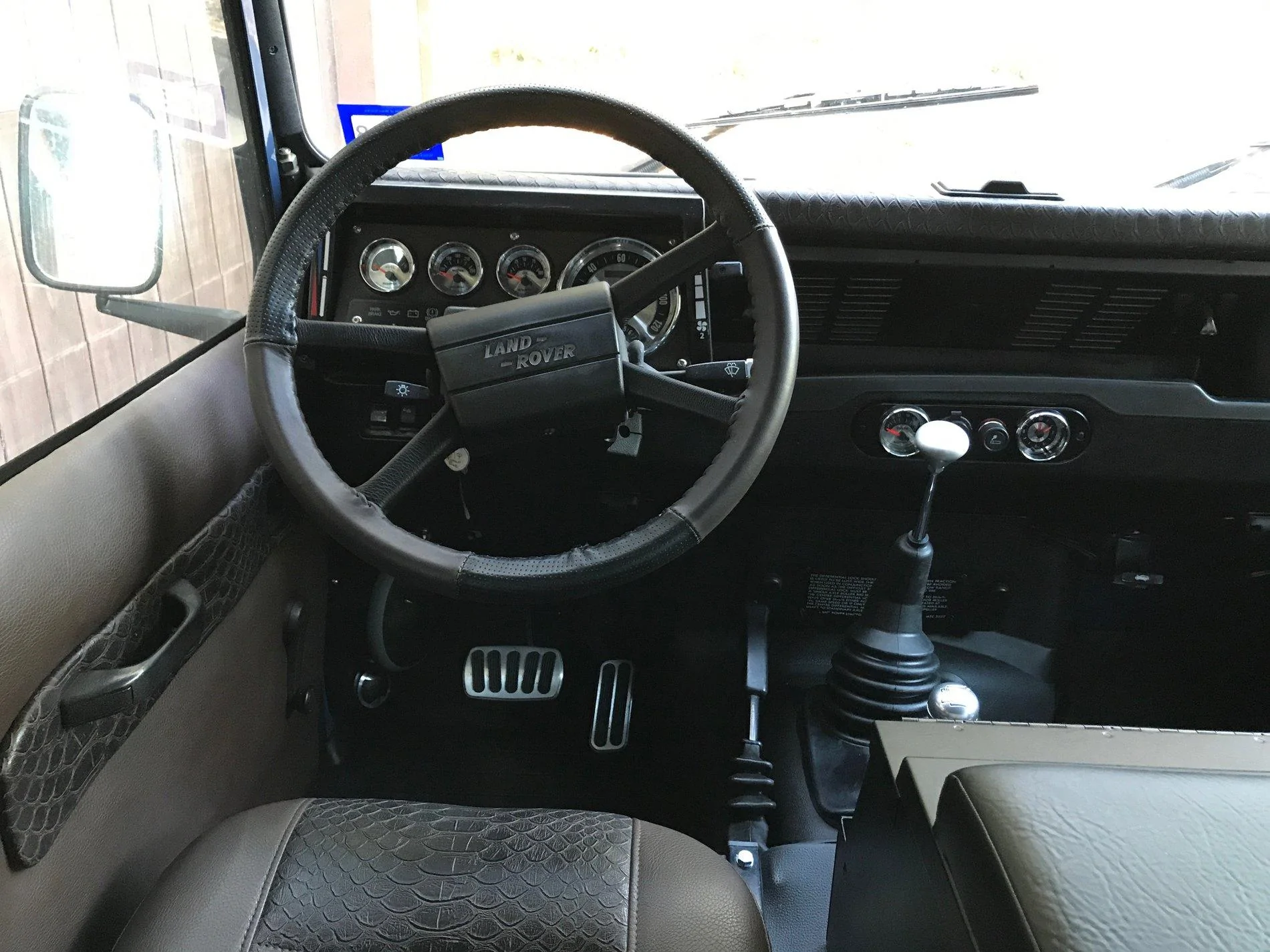

I completely agree with you on the driver engagement! My LR Defender had the anemic 19J turbo diesel with all of 80hp, but it had a sweet five speed and gearing that allowed it to go anywhere and a driver feel that was second to none. I replaced the engine and tranny with an LS and 6 speed auto from a 2012 Camaro. With over 400hp, it was a COMPLETELY different vehicle and I loved everything about it except the driver feel was completely gone.
