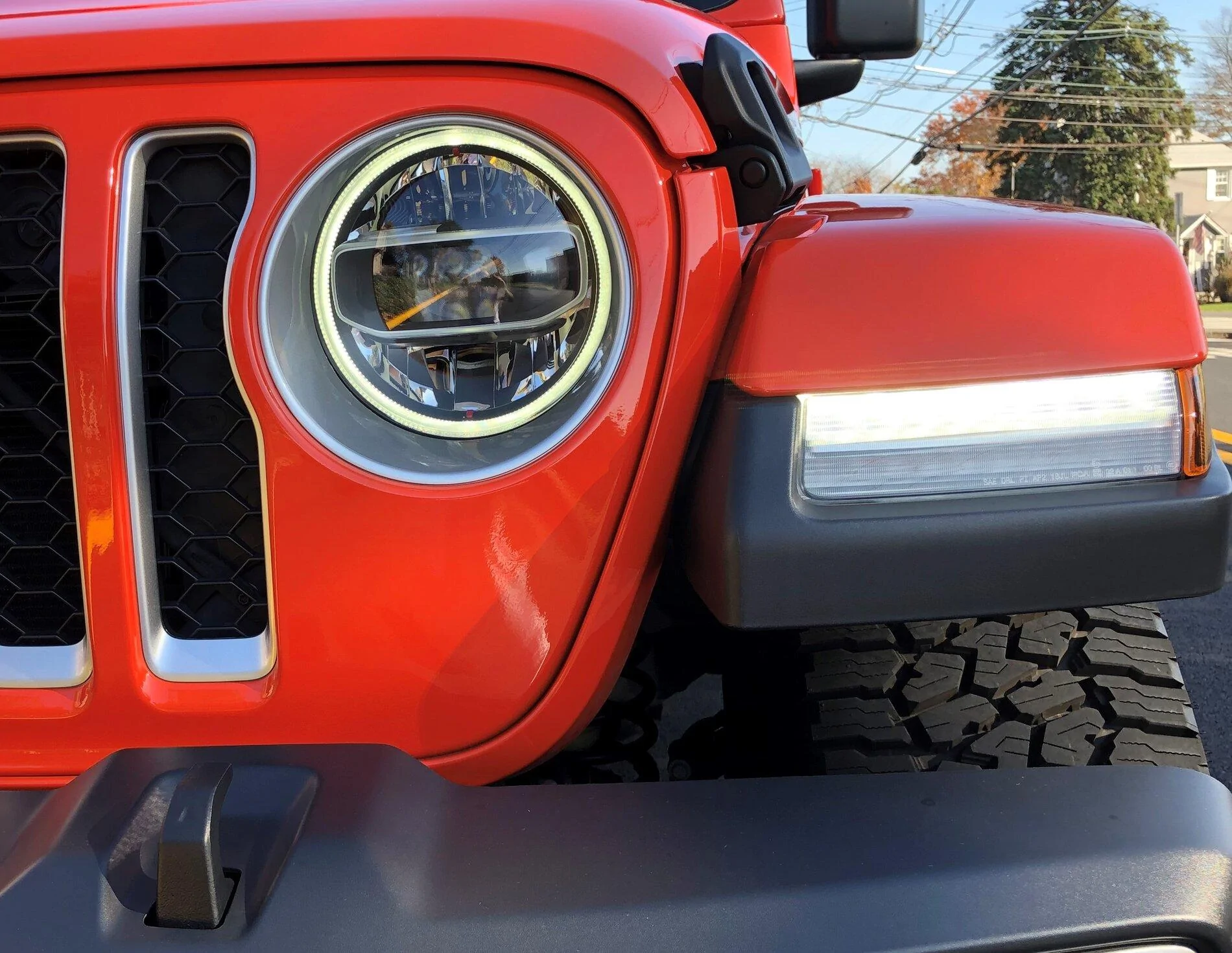

I have the Overland with factory LED lights, and no issues with the DRL's. They also have a ring around the headlights that comes on. I believe the DRL's come on automatically when it is put in drive. Park in front of something with tall glass windows and test things out.

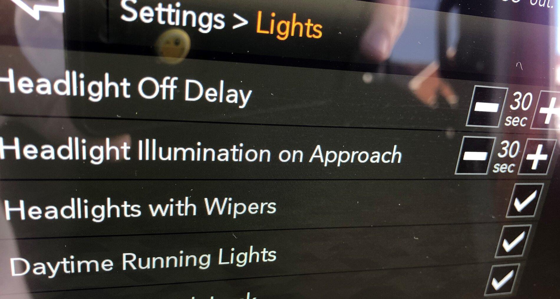

Well the setting for DRLs in UConnect did turn out to be the solution to my issue. I have to admit I never imagined that there would be a setting like that in the Uconnect menus. I'd better spend a little more time exploring all those settings.

I’ve got a 2021 Sport S with Max Tow and I also am not seeing the DRLs. The only thing I’ve done to stock is add Oracle LEDs headlights and replaced the DRL halogen bulbs with Oracle LEDs. The parking lights work and the DLRs come on in the auto setting but only at night when the headlights come on or when I manually turn on the headlights. The Uconnect setting is checked for the DLRs.

I got no DRL's with the factory halogens, all I got was turn signals. I bought some DRL/turn signal switchbacks and now I get brilliant white LED DRL's, with amber LED turn signals. Perfect for what I wanted. Now, if you want only amber DRL's and turn signals, they make those too.
