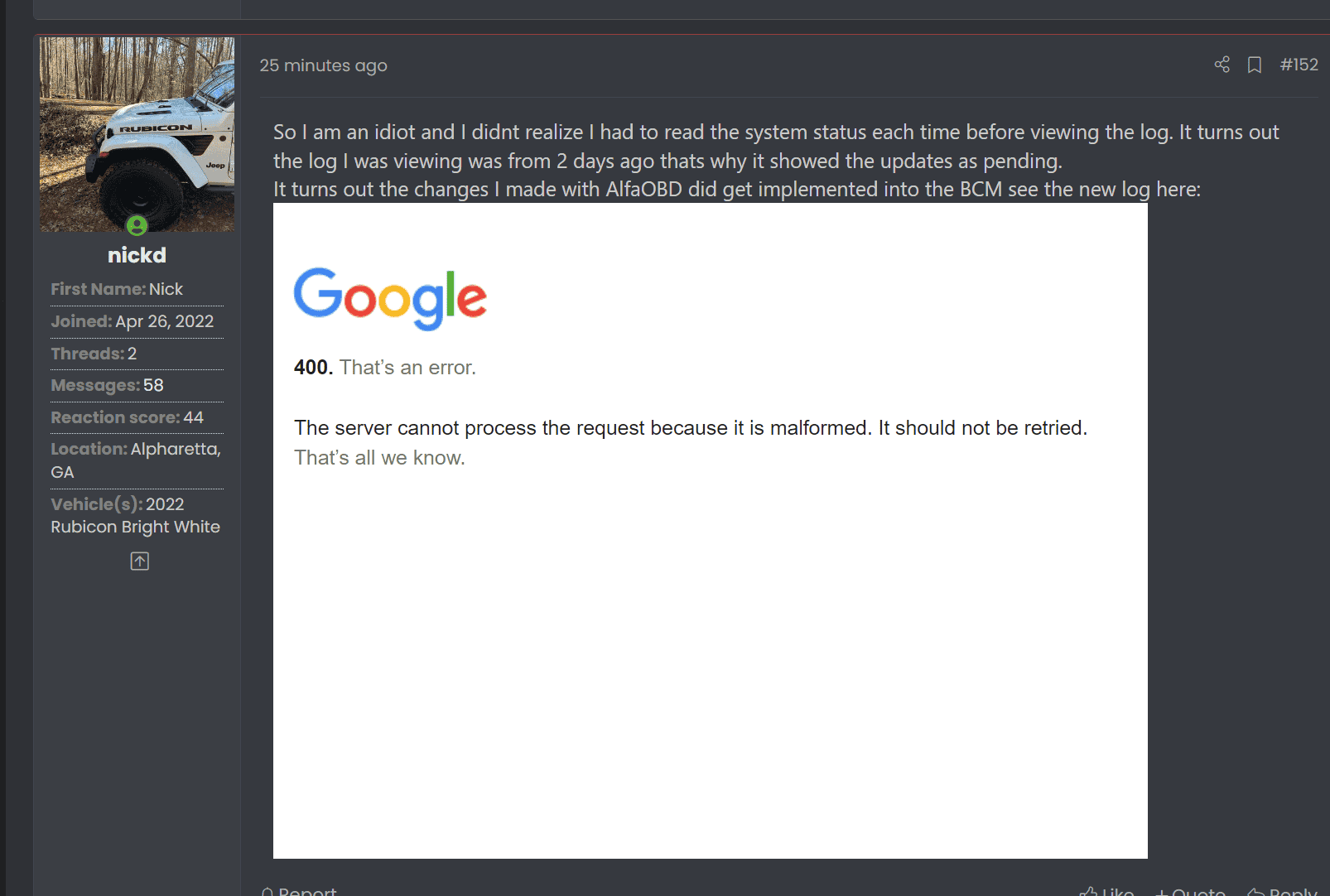

So I am an idiot and I didnt realize I had to read the system status each time before viewing the log. It turns out the log I was viewing was from 2 days ago thats why it showed the updates as pending.
It turns out the changes I made with AlfaOBD did get implemented into the BCM see the new log here:
Jeep Gladiator HOW TO: Add Factory Front Trail Camera to Gladiator (DIY Writeup) 1686681915727
you need to make the file public

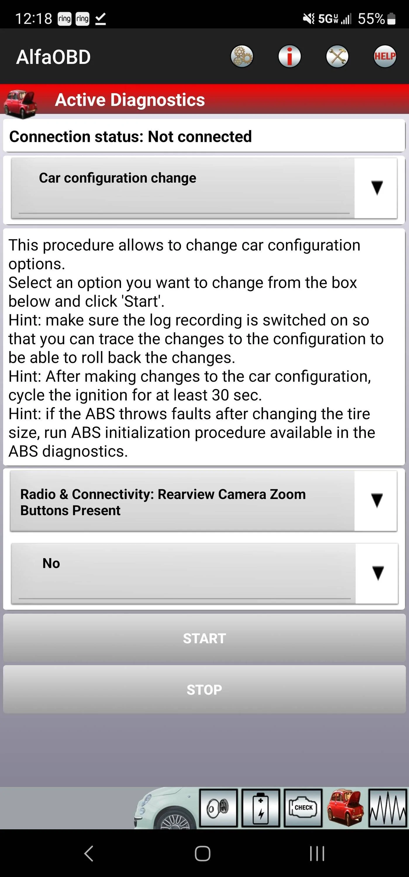

This is your Zoom button problem:
Jeep Gladiator HOW TO: Add Factory Front Trail Camera to Gladiator (DIY Writeup) Screenshot_20230613_121857_AlfaOBD
Set that to no. Your truck came with tow package it looks like. CVPM sends its own Zoom button. You need to turn off the tow package one.
