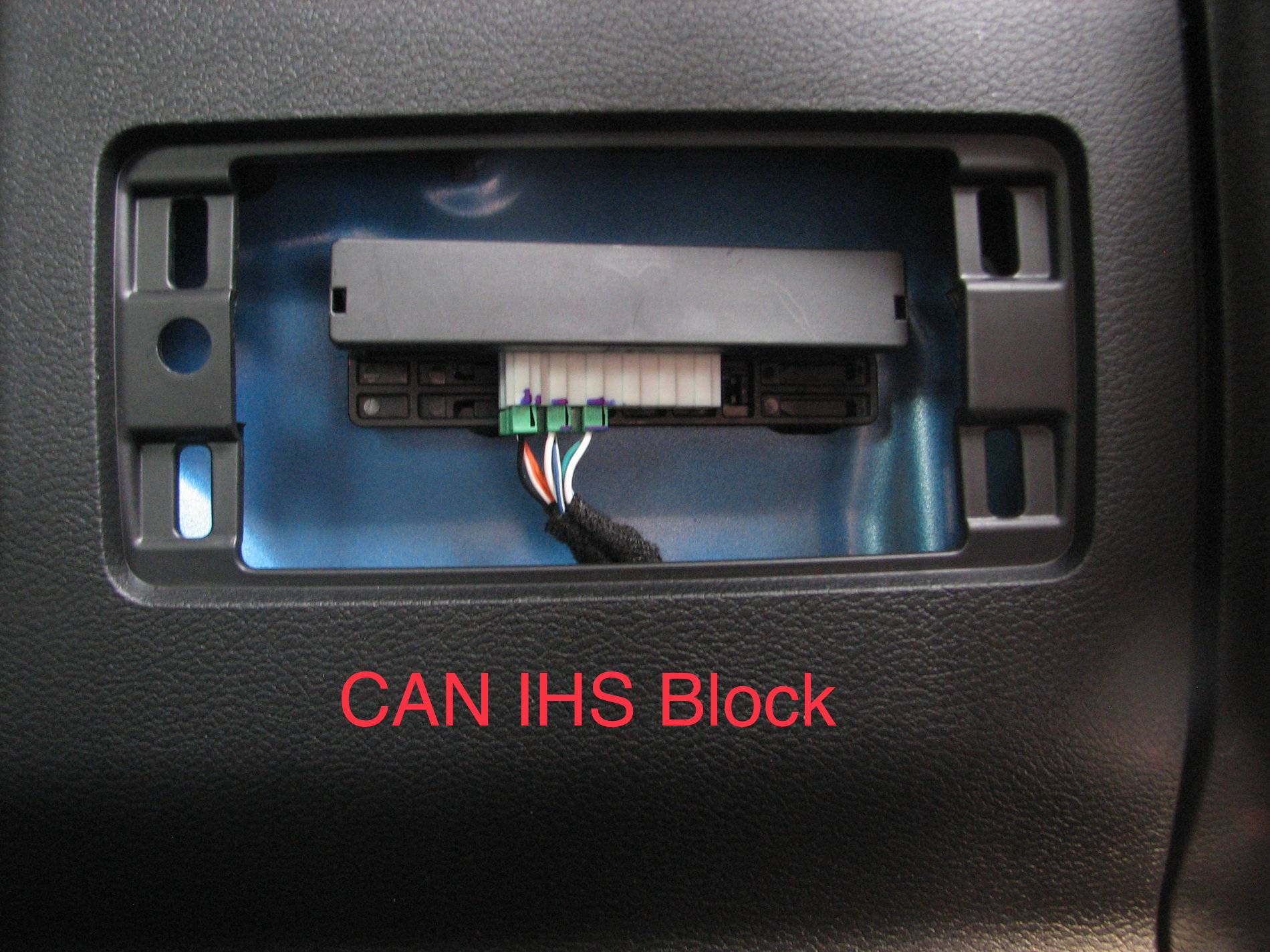

Also there are 2 can bus connection points on the back panel. I choose to connect to the one on the drivers side. I figured it didn't matter which CAN bus connection point I choose. The CAN bus has to be working correctly otherwise the backup camera wouldnt be working right?
It depends. You can access that though without removing the seat. There is a plastic port you can open up.

Do it EXACTLY as Jimmy pictured:
Jeep Gladiator HOW TO: Add Factory Front Trail Camera to Gladiator (DIY Writeup) 0bjngkj-
That is the driver side rear connection point.

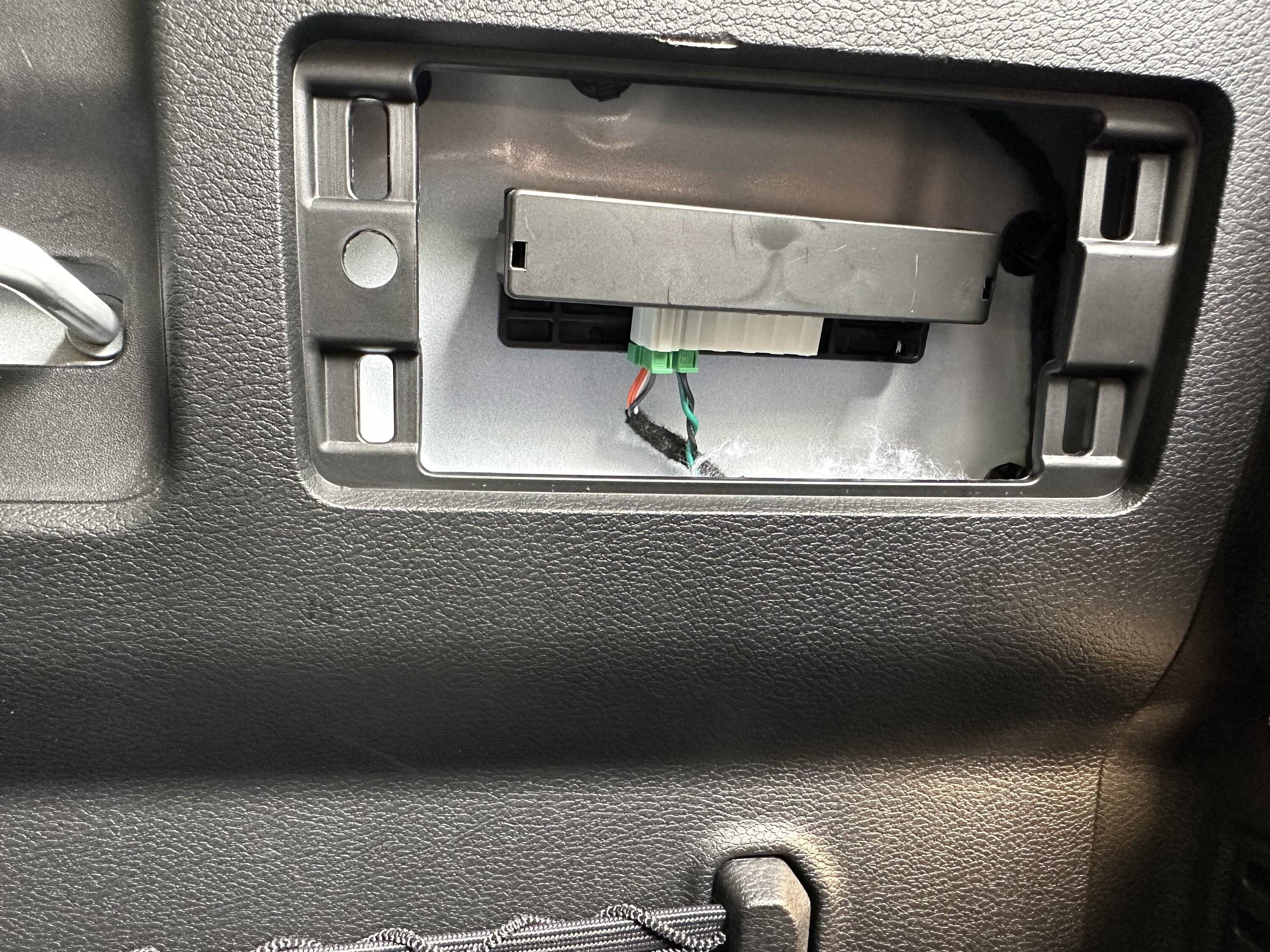

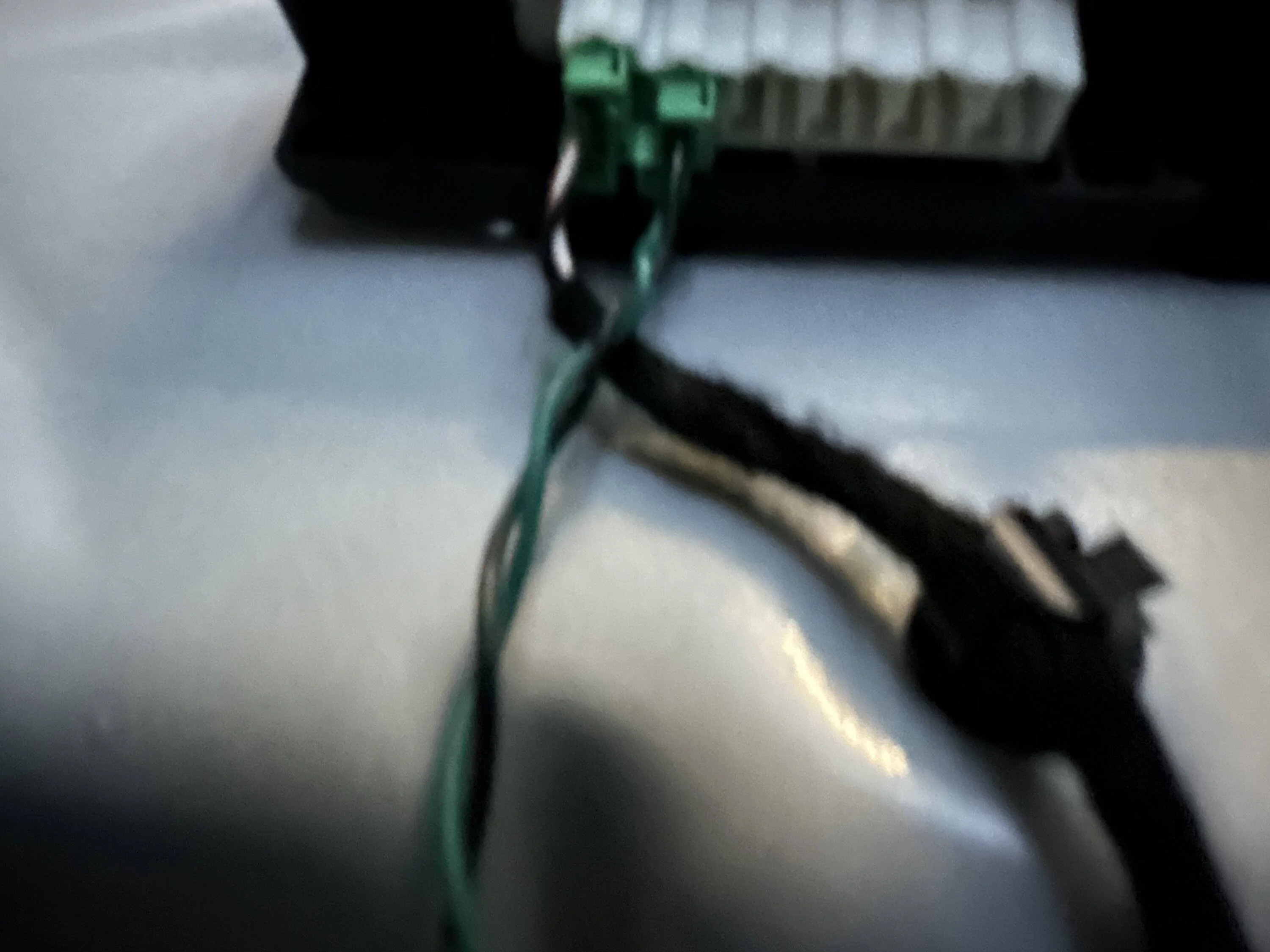

That looks like the drivers side which is what I used. I only had one cable plugged in there. My wire is the green and black one.

Is it possible your CAN polarity is reversed?

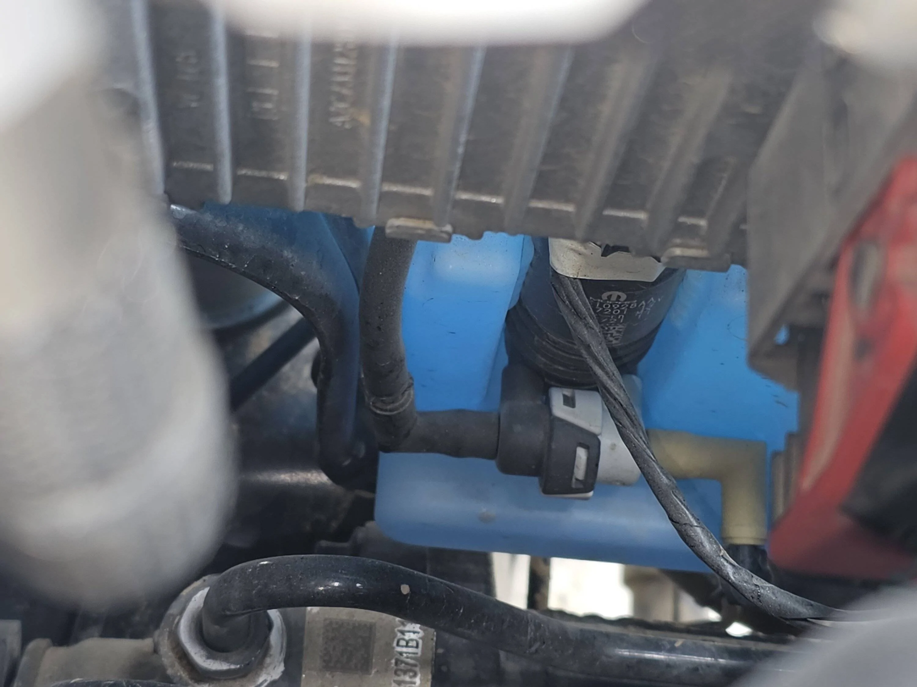

Silly one here but I wonder if you put the hoses on the pump backwards ....or the pump is in 180 degrees out of clock...
anything is possible.....

My pump looks the same. Makes no sense
As a Hail Mary you could disc both batteries ( look up how to if you don't know ) and let it sit 30 min, then reconnect. It will take awhile for the radio to get back to normal - your buttons to return etc.
I can't see how or why they would change anything here but it's possible.

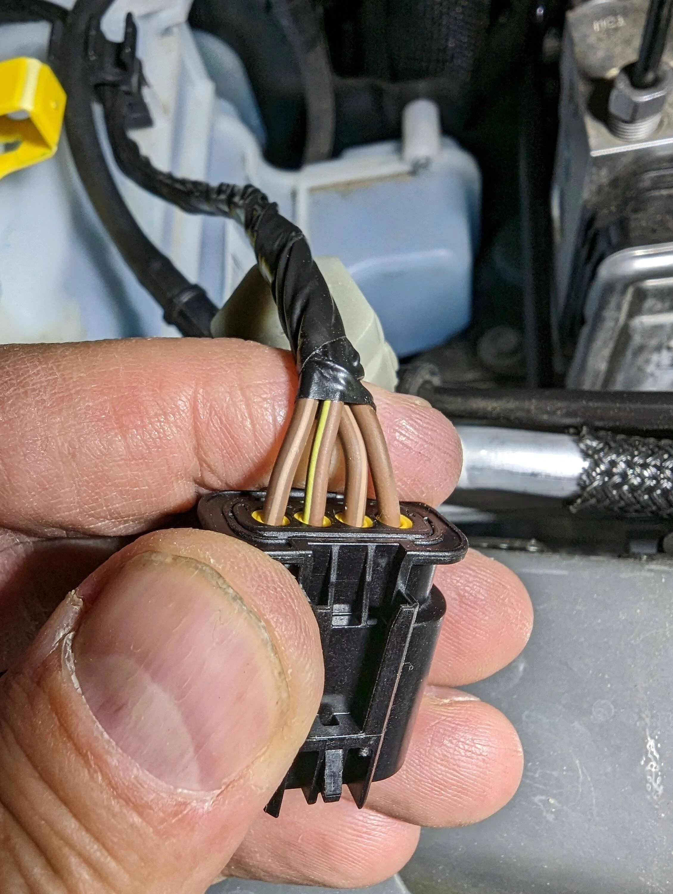

@vishnu's issue should hopefully be easy to track down.
Factory trailcam trucks have a reversed harness and then the 2 related settings:
Reversible Washer Pump Enabled: Yes
Connector A Pin 14: Washer Motor Control Right Rear Output Present/Front Camera Washer: Yes
Make damn sure you got that reversed harness ( easy to compare, get the one you replaced out and compare wire colors on the fender side connector ) and that you enabled that Pin change.
