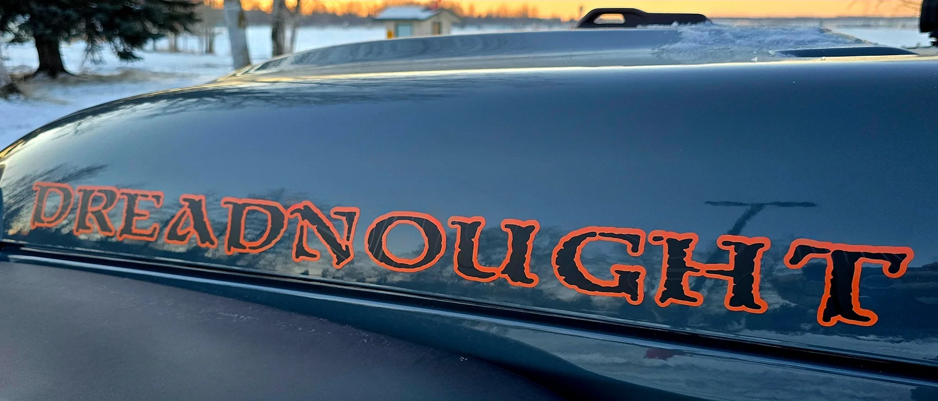

Yep. Heat gun and patience. Dont roast your paint. And definitely denatured alcohol to remove any residue and stop any ghosting from leftover adhesive.
You COULD use a 3M adhesive remover wheel, but theres always a chance it will damage your paintjob.
I removed my Mojave sticker about month ago (in a warmed garage. Dont do any of this under 40F). It came out rather well.
Jeep Gladiator How to best remove "Rubicon" lettering 20251228_153816[1]

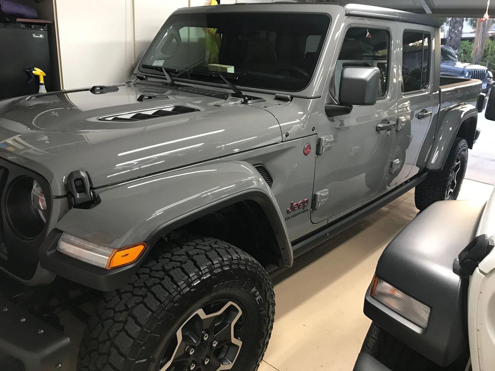

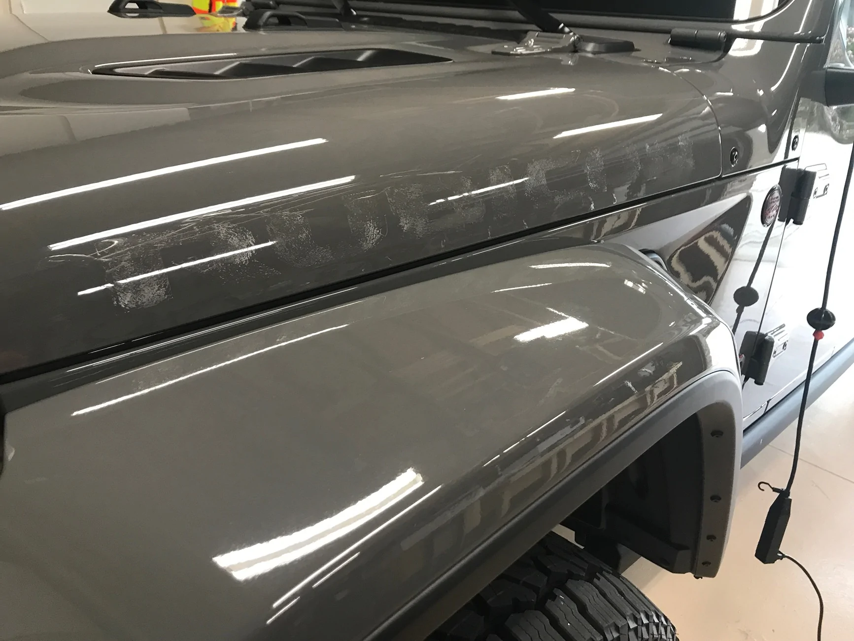

This was the first mod I did when I got my truck home. Didn’t want to wait and get ghosting. Low heat with a heat gun, go off, apply a good coat of wax.
